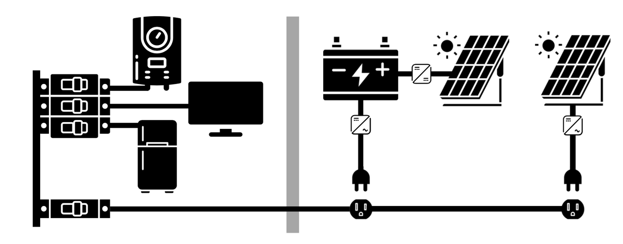

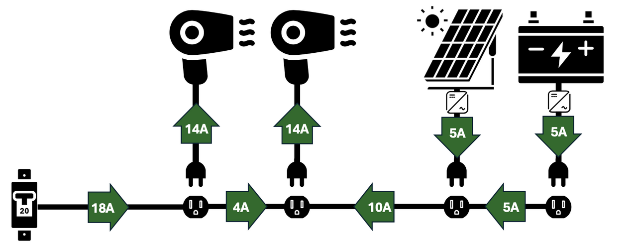

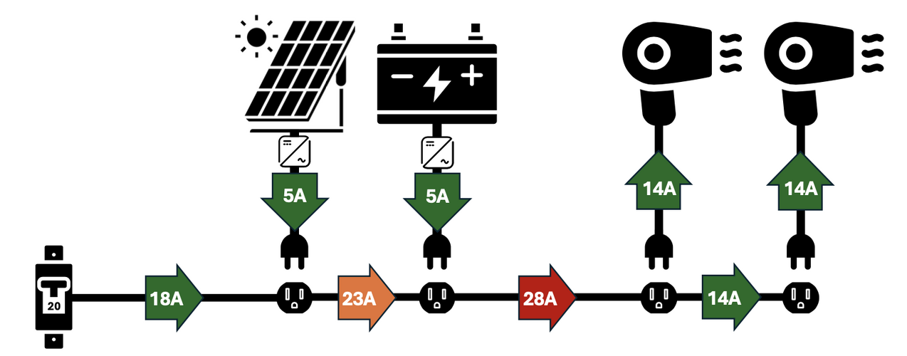

Another issue the codes are concerned with is breaker masking. This is where you put both a source and load on the circuit that bypasses the panel breaker. The way our wiring is done is the power path is grid -> meter -> main breaker -> panel breaker -> wiring -> outlet -> load. If you plug a source into a wall outlet and then run a load on that same circuit the panel breaker is not in the circuit. It only is if you run a load on a different circuit, in which case you actually have two breakers in the circuit.
This problem is present when it's operating normally. If you put the source upstream of the load then you could have both the panel power and generator source supplying downstream loads. There really isn't a good way to prevent this and whether it's safe is going to depend on the layout of the circuit.
It's shown in these graphics, the 14A loads being hairdryer as an example.
This first one is safe.
This second one could cause a fire in someone's wall.
I think what you're going to see is the NEC address this by having a dedicated branch circuit for a portable solar/inverter/generator. It might require a special plug (addressing touch safety) and being dedicated it'll have a breaker in the panel to prevent masking.
