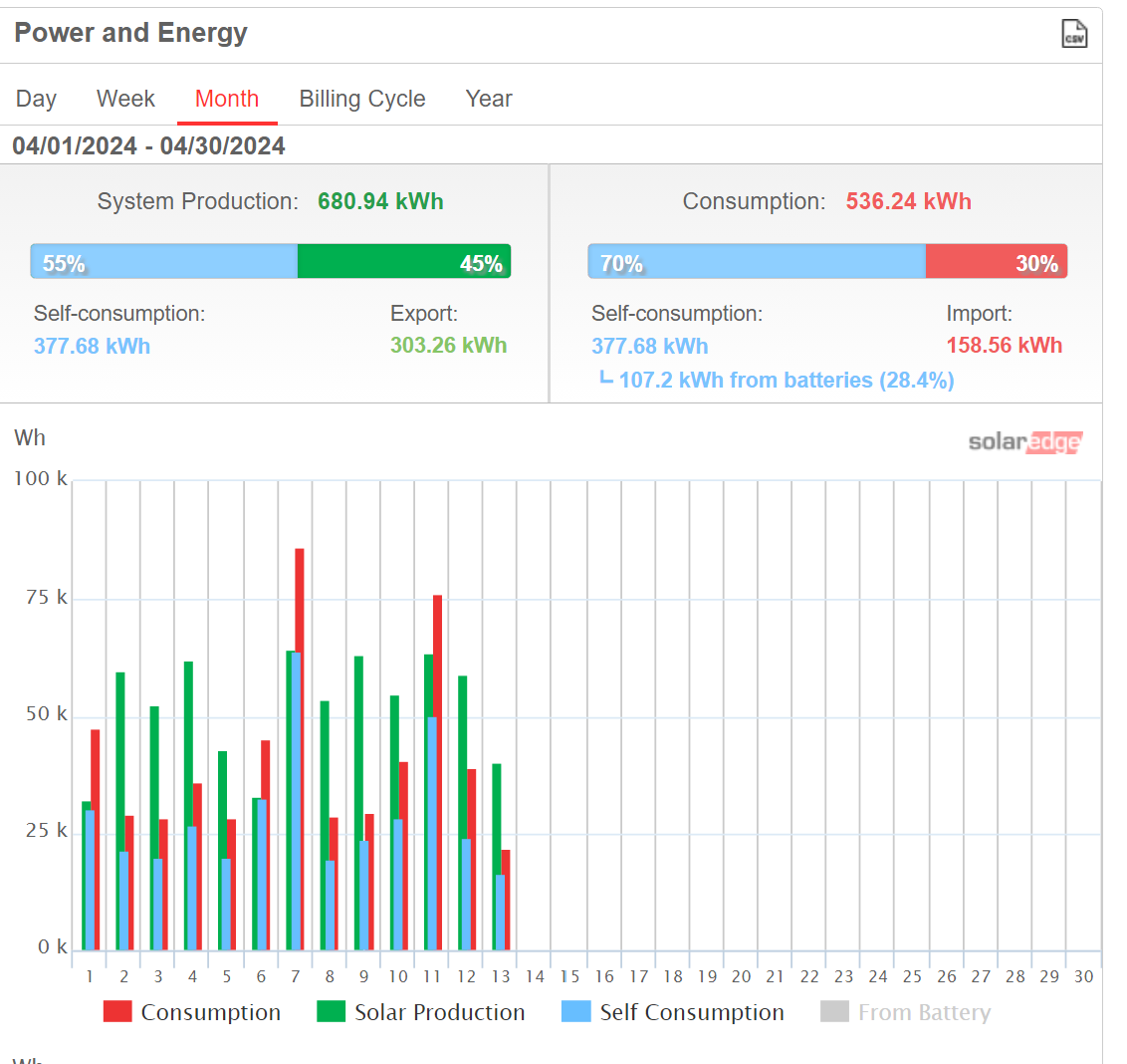

I converted my 3 prong Welder plug to a NEMA 14-50 plug using a GFI 50 Amp breaker and 6AWG wire to provide margin
I am expecting charging the Lyriq to utilize the reduction in consumption from getting rid of old AC's and replacing them with Heat Pumps
I wait until about 10AM to charge it. The Solar Panels are producing a lot and the batteries are fully charged by then. Unless we have driven a lot it utilizes the panels and batteries to recharge 20% (~60 miles)in 2 hours allowing the batteries to recharge when done to cover the night usage of thee house. I have the batteries set to discharge to 70% unless the grid goes down. Yesterday the Lyriq went down to 40% with lots of driving and it took us 5 hours to recharge to 80%. That used 20kWh more than we produced, but that was easily made up the next day when we didnt need to charge.
The real test will come over the summer, my first with two heat pumps. With just one Heat pump in 2023, we had a 1.9mWh surplus of generated over used. Also for 2023 with just one Heat pump, used for 2023 went down 1.3mWh's compared to 2022. Not expecting as big a reduction as the 2nd AC was a bit newer and a 13 SEER vs 10 SEER
Note, the 13th below is incomplete as of 5:30PM. This does not include the 10kWh of battery power available before it reaches the set point. That just means that the rest of the day is covered by batteries and part of the next morning
Since all the EV charging smarts are in the cars these days, I bought the highest rated level 2 dumb charger for $350
https://www.amazon.com/dp/B082LMVSLY?ref=ppx_yo2ov_dt_b_product_details&th=1
So far we are pretty happy with this.
We will have 1 EV I hope to be fully covered by Solar and two ICE vehicles; The 200 and future Tacoma. We should be ready for anything :)

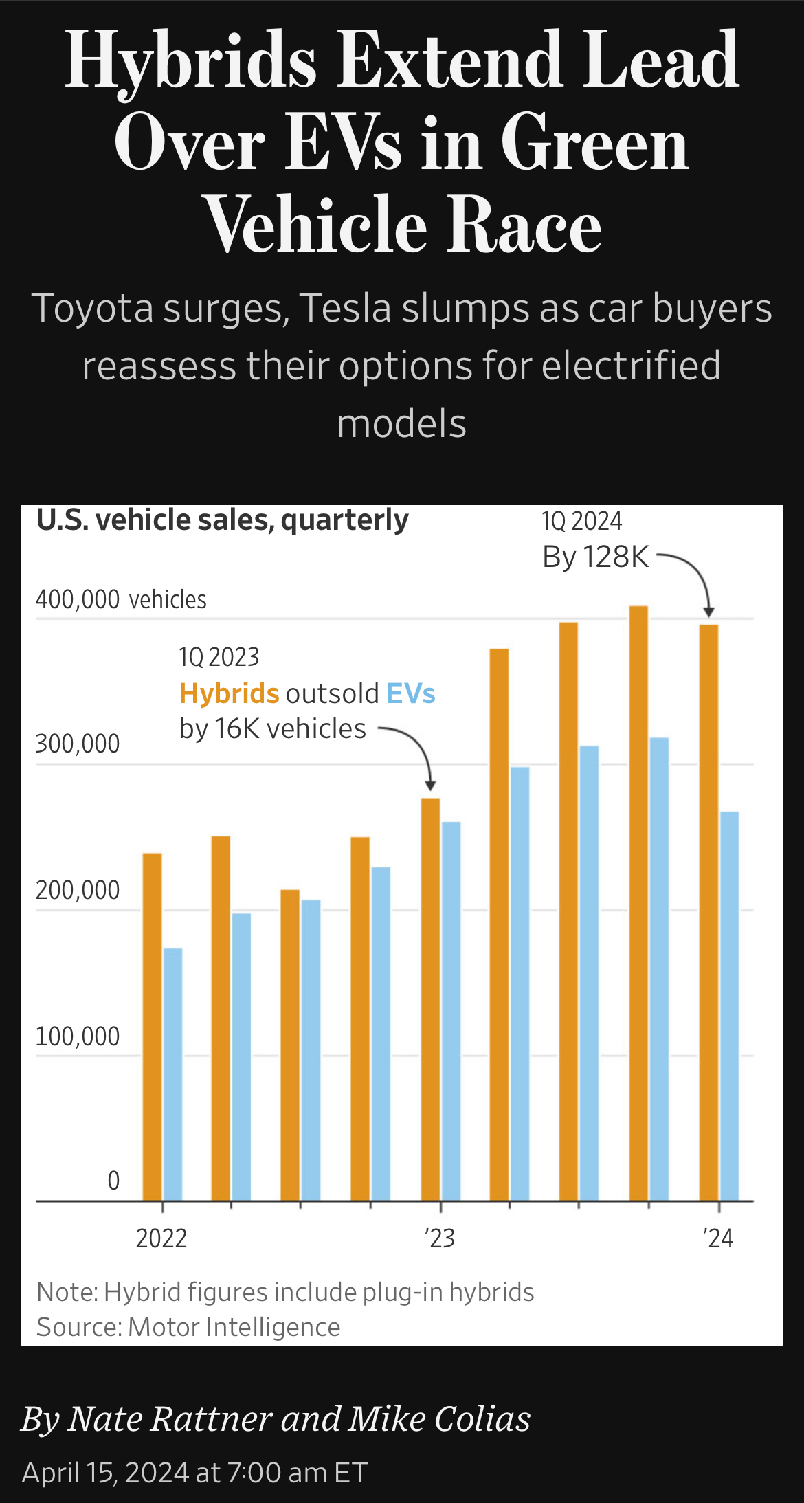

WSJ article from Monday indicates dealers may be interested in making deals if inventory isn’t moving as quick as they would like.
“Electric-vehicle sales further decelerated in the first quarter, as purchases of gas-electric hybrids remained strong, accentuating a trend that started last year.
Industry figures released earlier this month showed that hybrid sales rose 43% in the January-to-March period, while EV sales flattened, up only 2.7% in the quarter. Contributing to the sluggish EV sales were weak numbers from Tesla, which accounts for about half of the U.S. electric market, according to data from research firm Motor Intelligence.
Following years of strong sales gains, EVs have cooled in recent months. Consumers are leery of charging availability and hassles, and prices remain too high for many buyers, according to dealers and survey data.”
