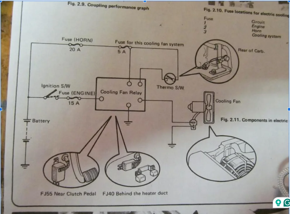

The carb fan is 100% key for hot restarts. Not sure if you're having a problem there, but a working carb fan makes all the difference in getting home for the grocery store or sitting there waiting for the motor to cool off for half an hour before you can fire it up again.

A brief glance at the carb fan under the hood: The thermal switch under the intake/attached to the EGR piping has no wires running to it. That's for sure an issue. No sensor, no fan. I'll need to check the system out. (Note: diagram is for an FJ40.)

If hot restarts aren't an issue you're in the clear for now - the fan only runs when the truck shuts down. Just ground the floating wire that used to go to the temp sensor and it'll run for a full 20 minutes at shut down.

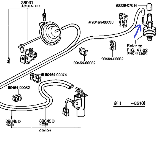

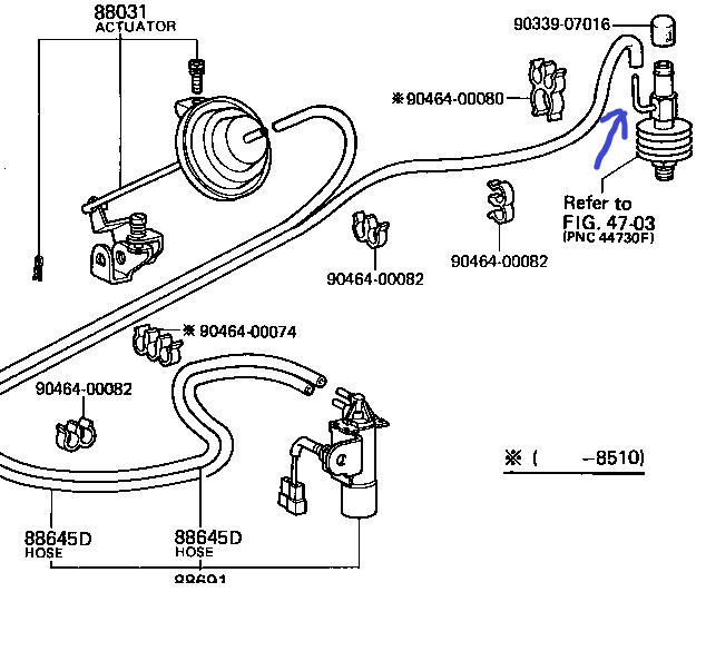

Are you talkin' about this fitting? (Blue arrow.) That's what I was pulling vac off of earlier. It was lower than I would have expected. 9-13 in Hg
That sounds like it's lower than it should be, despite the altitude? I was going to opt for pulling vac via the brake booster connection. (The larger vac fitting next to the blue arrow, to see if the numbers changed.) FSM calls for > 16.54 in Hg at idle...
What vac numbers should I be looking for at peak during a lean drop?
As an aside, the VSV pictured def doesn't have the female connector anymore. It was cut or chewed. (A truck that doesn't have AC probably doesn't need to idle up though.)
I’ve always seen 15-17inHg on decent 2Fs at this elevation. 9-13 is range is for sure low:
I never reinstalled the (non-functioning) AC when I replaced my motor. Nobody gets a free ride!
