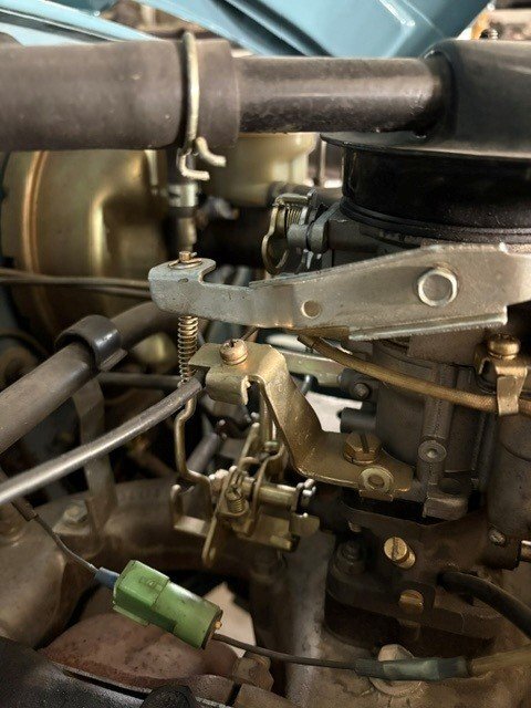

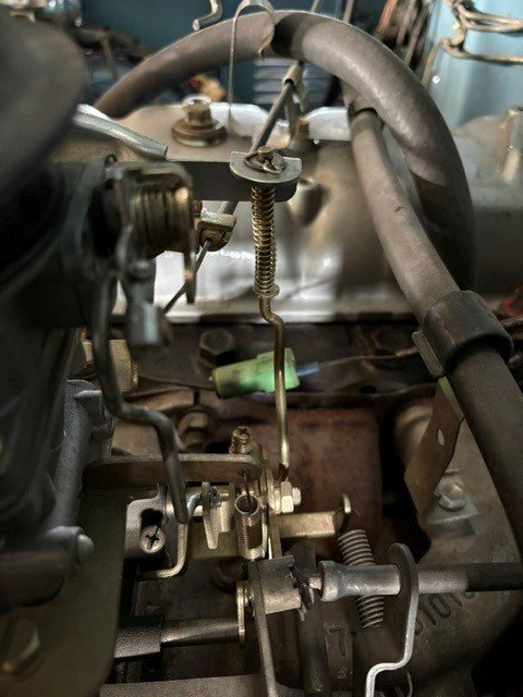

on further review of your photos it looks like the wire that goes to the fuel kill solenoid is attached to the choke cable holder. The wiring for the solenoid should route around to the front of the carburetor below the accelerator pump arm like in my picture.
I believe I have that bracket sitting with the old parts from the rebuild. I'll try putting that back on!
The wiring should be easy enough to reroute. Does the side matter?

It should go around the right side of the carb as viewed from the drivers seat.
3,131
@Capriblue45 nailed the choke cable issue. The brass ferrule on the cable needs to be held in place for the cable to operate just like bicycle & motorcycle cables. Bowden cable is the proper term.

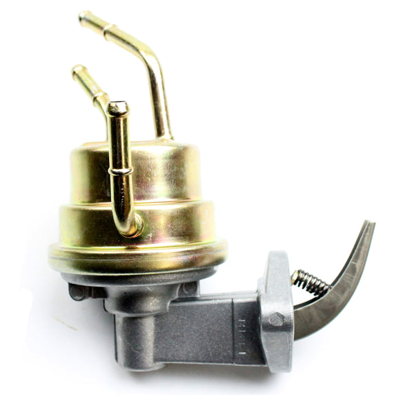

The fuel pump NEEDS the spacer, period. You can try running without, but the result is broken pieces of the fuel pump arm at the bottom of your oil pan and possibly damage to the cam shaft. Sometimes things get so caked with grease & grime that the spacer blends into the block and you can’t see it. Perhaps there was some wonky aftermarket pump that didn’t require it, but it probably wasn’t worth using. Buy a Koyosan or nothing at all.
Nope. Nope. Nope. Not period. Some do, some don't in my first-hand experience.
When CCoT sent me their new aftermarket offering ~20 years ago for my evaluation, I held it up next to my new (right out of the box) spare I had bought from Stevinson and immediately noticed that the arm was longer (stuck out farther) than the OEM one. I contacted Stephen McClung at CCot and informed him, and he replied that they would start including the spacer with their aftermarket fuel pumps.
I have replaced many, many fuel pumps on Fs and 2Fs over the decades and many hundreds of thousands of miles and some need that spacer and some don't.
The super easy way to determine that is as I described, hold them up side by side and see how far the arm sticks out.
If your old one doesn't stick out as far, and worked fine for however many hundreds of thousands of miles, but the new one sticks out farther, then you need the spacer (insulator in Toyota jargon) and need to source it before you put the new pump in. Otherwise cam > fuel pump arm, bend arm , no pumpy). If you didn't have the spacer and the new fuel pump arm sticks out the same as your old one, then you don't need the spacer. If you put in a fuel pump in with the shorter arm but with the spacer, then no pumpy either.

I know you have tons of experience Jeff, I’m not trying to throw you under the bus! On the other hand, the annals of Mud are littered with post after post of “Why did my fuel pump break immediately after installing it?” It’s up there with “I ripped all the vacuum lines out and now my truck doesn’t run, help!” type of threads that you see almost weekly. Additionally the Toyota EPC diagram shows the spacer, and Mr. T has a pretty good track record for correctness. I’ve found only one potential mistake in a description of an obscure and non-critical vacuum valve.

Being that I did cheap out on the fuel pump when I replaced it, is Cruiser Corp a reliable source for a replacement? It's a bummer they don't sell the pump with the spacer and gaskets, but they haven't done me wrong yet.
I have a sneaking suspicion this is the primary culprit, likely combined with some of the other common fuel-related problems, and of course my oversight of connecting the choke cable brace/mount after the carb rebuild (can't wait to see what I messed up there!)
3,131
Get a Kyosan from Cruiser Outfitters.

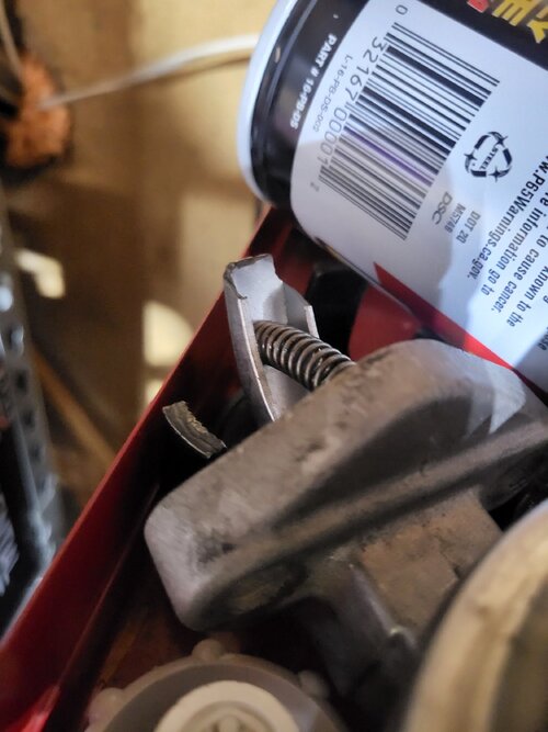

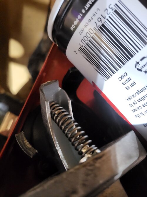

Looks like there's been a little snappage.
Kyosan fuel pump going in once it arrives, along with dropping the oil pan to get any shards out.
I'll update once that's done. One step closer!

Obviously that was one that needed the spacer.
Do you have a new pan gasket on hand? You will want the one piece ones, the four piece are a total PITA. When you go to reinstall the pan, clean up the gasket surface really well, then put some RTV sealant (I like blue Permatex) all over the mating surface. This is not to seal it, but as adhesive to hold it in place during installation. You'll need around a dozen or so clamps to hold the gasket to the pan while the sealant cures, at least a half day, over night is better. If you don't do this the gasket will want to spooge (tech term) all over the place during install, especially both ends and you'll end up with oil leaks.
You DO have to seal all 4 corners with a good blob of sealant just before install, this is in all the manuals. Don't tighten the bolts so much that they deform the pan! You can always come back and torque them a little more later if needed.
A 2F will drip for days and weeks while the pan is off. Be prepared for that when working under the motor and for while the pan is off. I like to use a big piece of cardboard that I can toss out when done.
