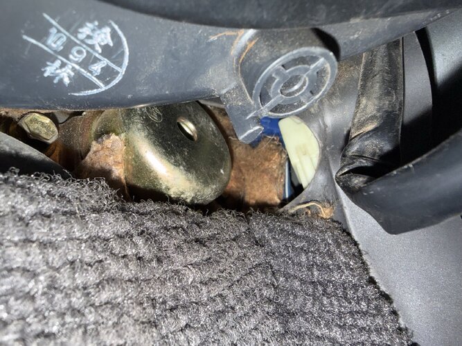

Got it. So I likely have a vacuum leak that is causing the loud sucking noise?That is just the distributor vent
Thanks, the hose is correctly going to the distributor cap so assuming the missing filter may be the cause of the loud noise its making.No. 60 series distributors are vented. There are two hoses, one to the clean side of the air cleaner housing (which always has somewhat of a vacuum when the engine is running) and the air is sourced from inside the cabin under the glove box. There is supposed to be a filter on it like a plastic fuel filter. If the the hose doing the sucking is connected to manifold vacuum then it is hooked up wrong.
The purpose is to keep the inside of the distributor dry and free of condensation.
