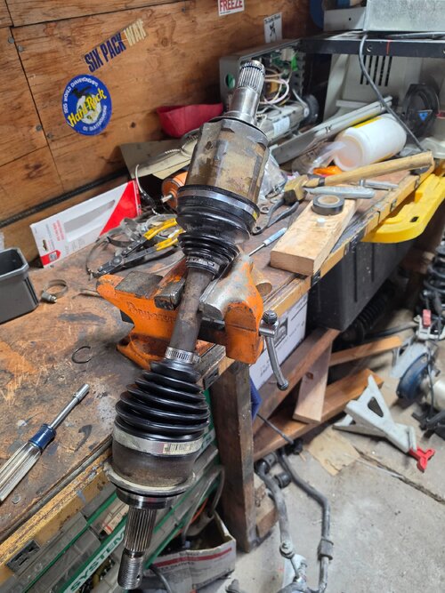

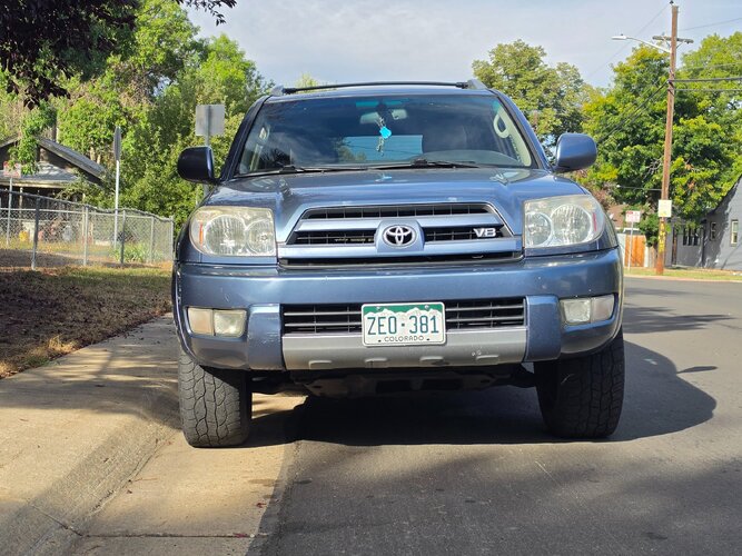

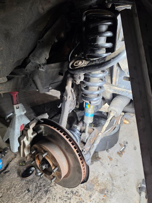

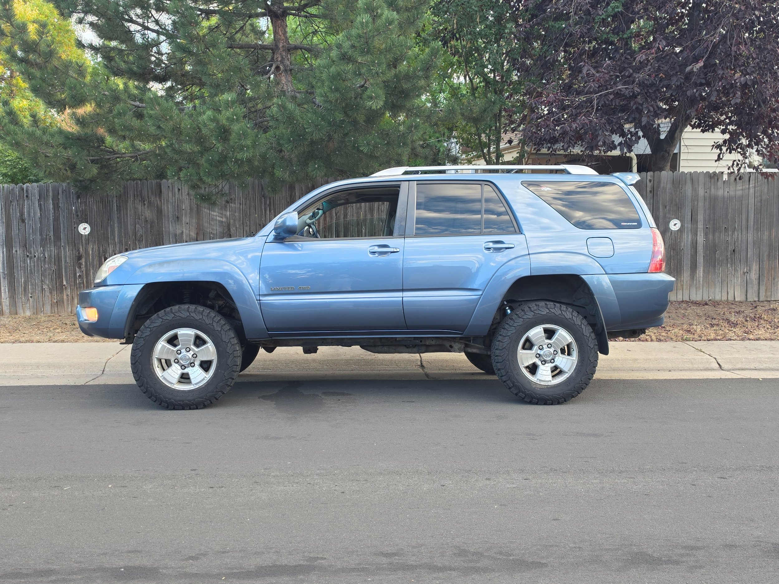

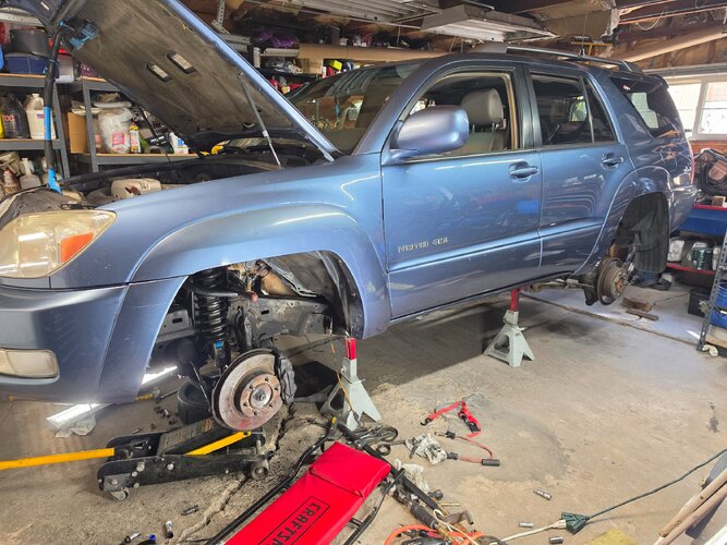

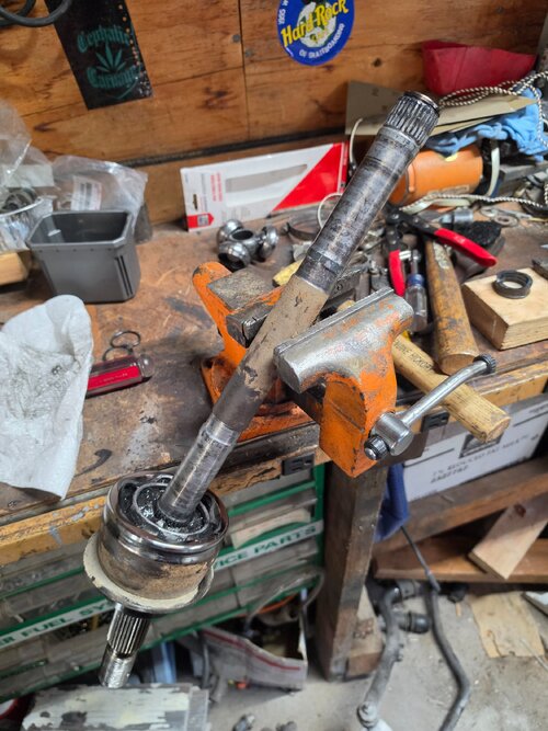

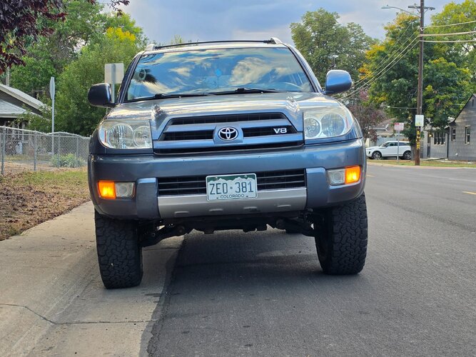

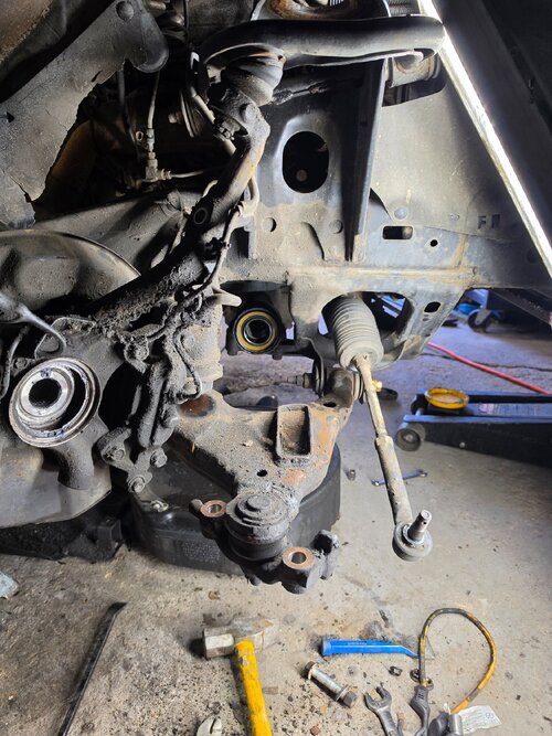

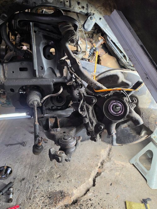

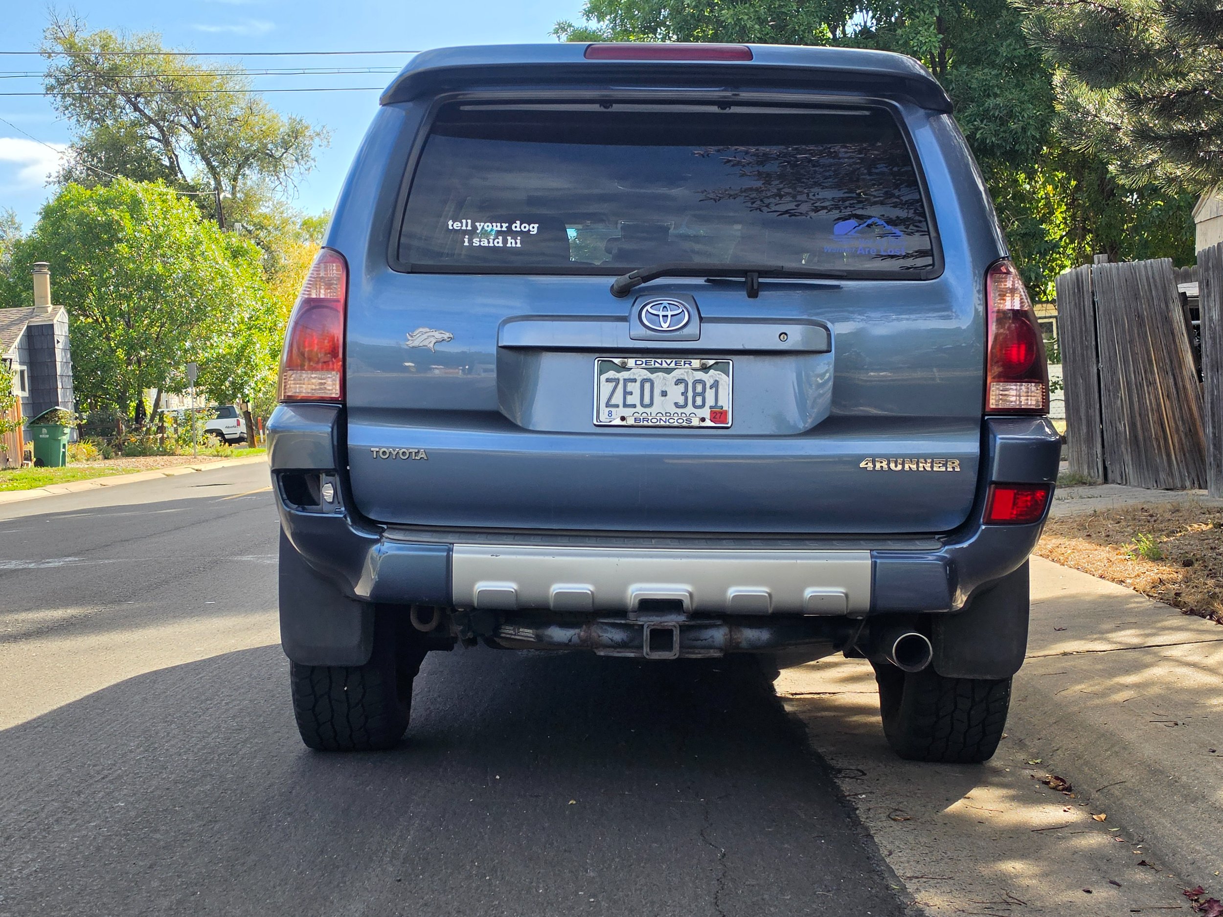

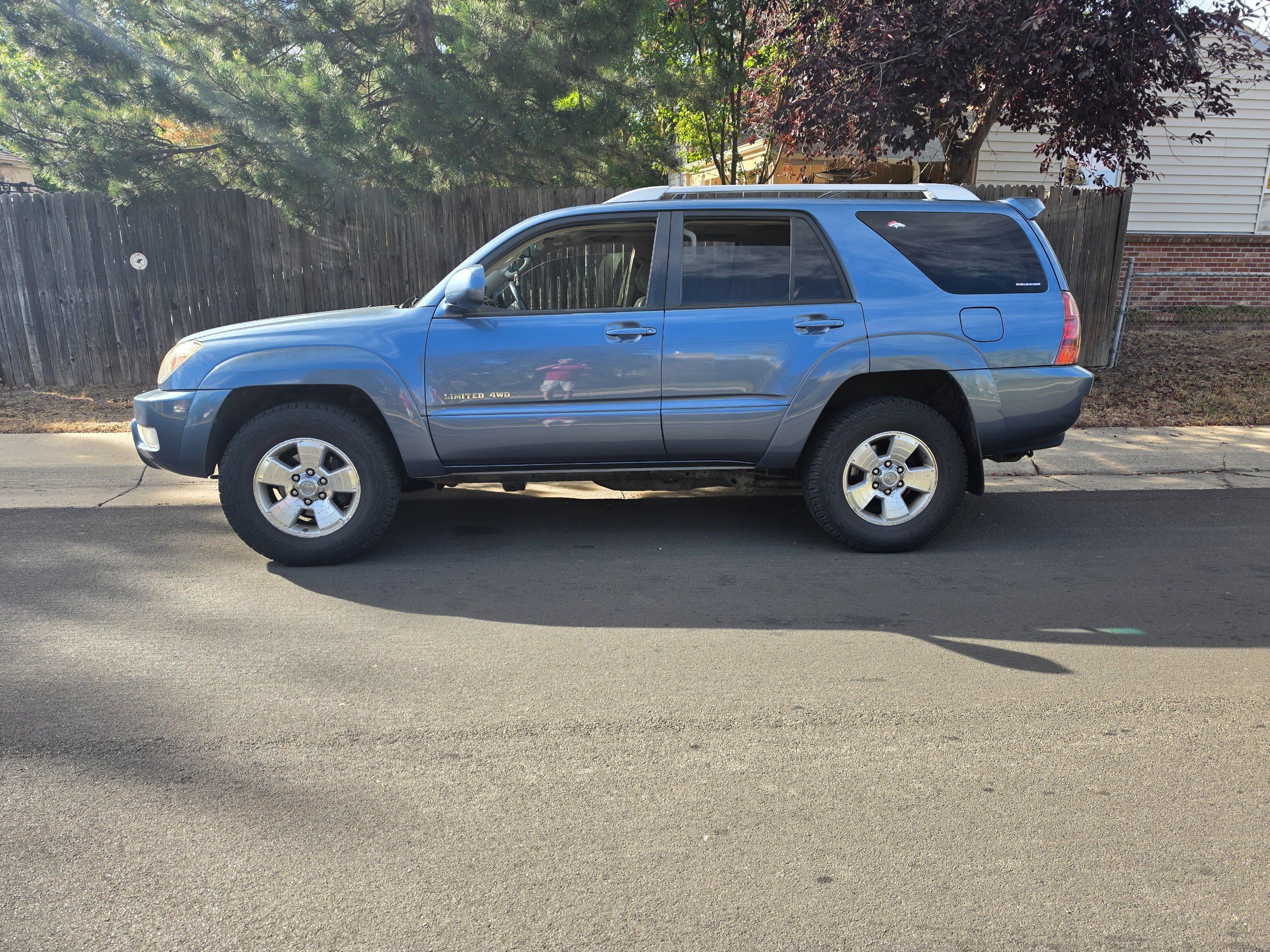

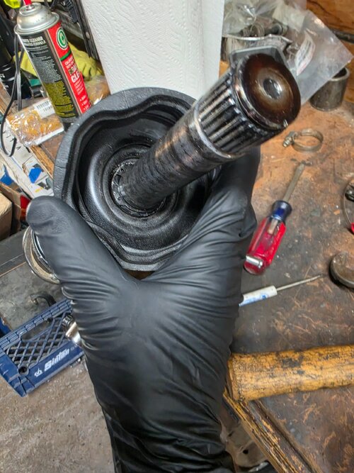

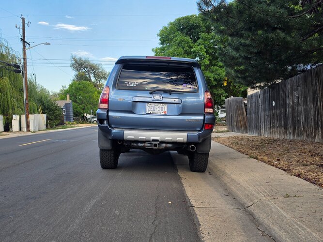

Finally after 7 years of owning her she gets a lift and cv axle reboot last weekend. 2 full days of work. Before and after pic's. Did the stretch mod on axles, I ended up having to run out to Yoda Jim's to get another cv since it had after market axles. All in all in went quite well. I ended up with more lift than I wanted since this my wife Julie's truck,but she loves it. Total numbers with moving up to a 275-70-17 AT tires i ended up with 3 1/2 to 4 inches in the rear and just over 5 in the front. And to my surprise the cv angles aren't to bad. So her maiden voyage will be tomorrow for the Spooky Night run.
