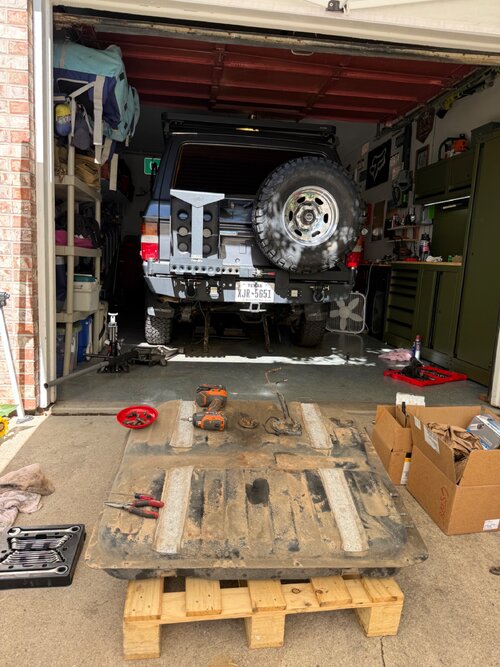

Not yet, I've been in Steamboat unable to get back down to the front range to work on it. Planning to get down there not this weekend but next and do Jim's fusible link replacement kit, new pump and sock, fuel pressure regulator, and some BG44K. If I had more time I would do them one at a time to try to figure out what the culprit is but need to get it up Steamboat so I can enjoy it. The three hour drive west will be a good test though.
4,782
Removing the gas tank can be a bit of a bugger with a little danger thrown in. It’s been a while since replacing the fuel pump on my truck but I think having a floor jack made the job easier. Where will you be doing the work?

Likely at a buddies house in Fort Collins. We have a bunch of tools including a floor jack so I expect us to be set but any tips or guidance is welcomed.

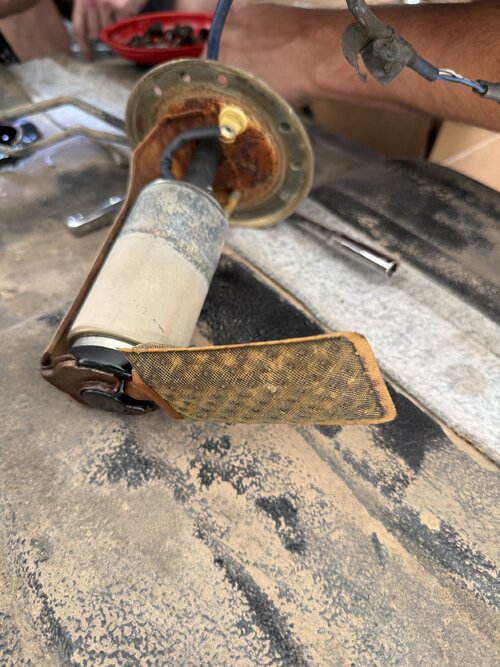

Honestly, if you haven’t done so, pull the tank, clean it & clean all vents & fuel line inlets. Pressure in the tank isn’t a usual vapor lock symptom, but not venting, or hard core suction will do that.

It’s rusty :/
Not good. Best thing to do, as @gr8fulabe said, is get the tank cleaned out. I would go so far as to have it chemically cleaned by a shop that does that sort of work in a dip tank. Others may have better ideas.

Well I did new fuel pump and sock, fuel pressure regulator, and the gmc charcoal canister. I smell of gas no doubt. Fired right up and drove great home from my buddies place although it felt a little underpowered. Tank will have to be cleaned or replaced another day.
Need to test it on a longer drive. However I also need a new tensioner pulley and power steering belt before I can feel confident driving up to the boat. Belt is fraying and pulley is not holding tension at the moment and is not straight. I think I may need a new tensioner pulley mount. Curious if anyone knows where I can get one of those. 😬

Now that you have a new FP and press regulator you should check to make sure you have at LEAST 22psi for 5 minutes after shutting the engine off. This feature is designed specifically to prevent vapor lock. The procedure is in the 3FE manual page FI-47. If you go that far into trouble shooting you might as well check fuel pressure too. Pages FI-45 to 47. Please update with any results, thx.

Fuel injection is kool! If the FI system does not pass the engine off pressure check it could be a leaking fuel injector as an example for trouble shooting the pressure issue. Which would be right in line with the rust found in the tank (yes it would have to get past the filter). Fuel injectors can be tested also. Anyway, that is one suggestion.
