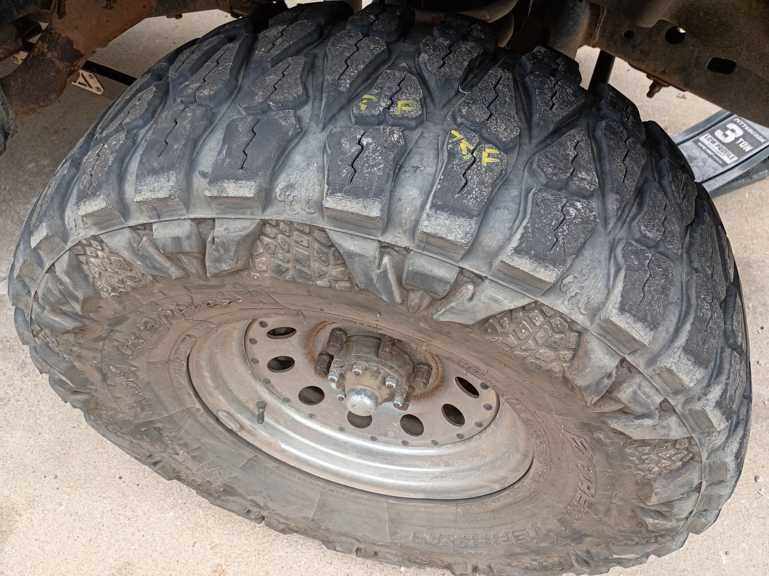

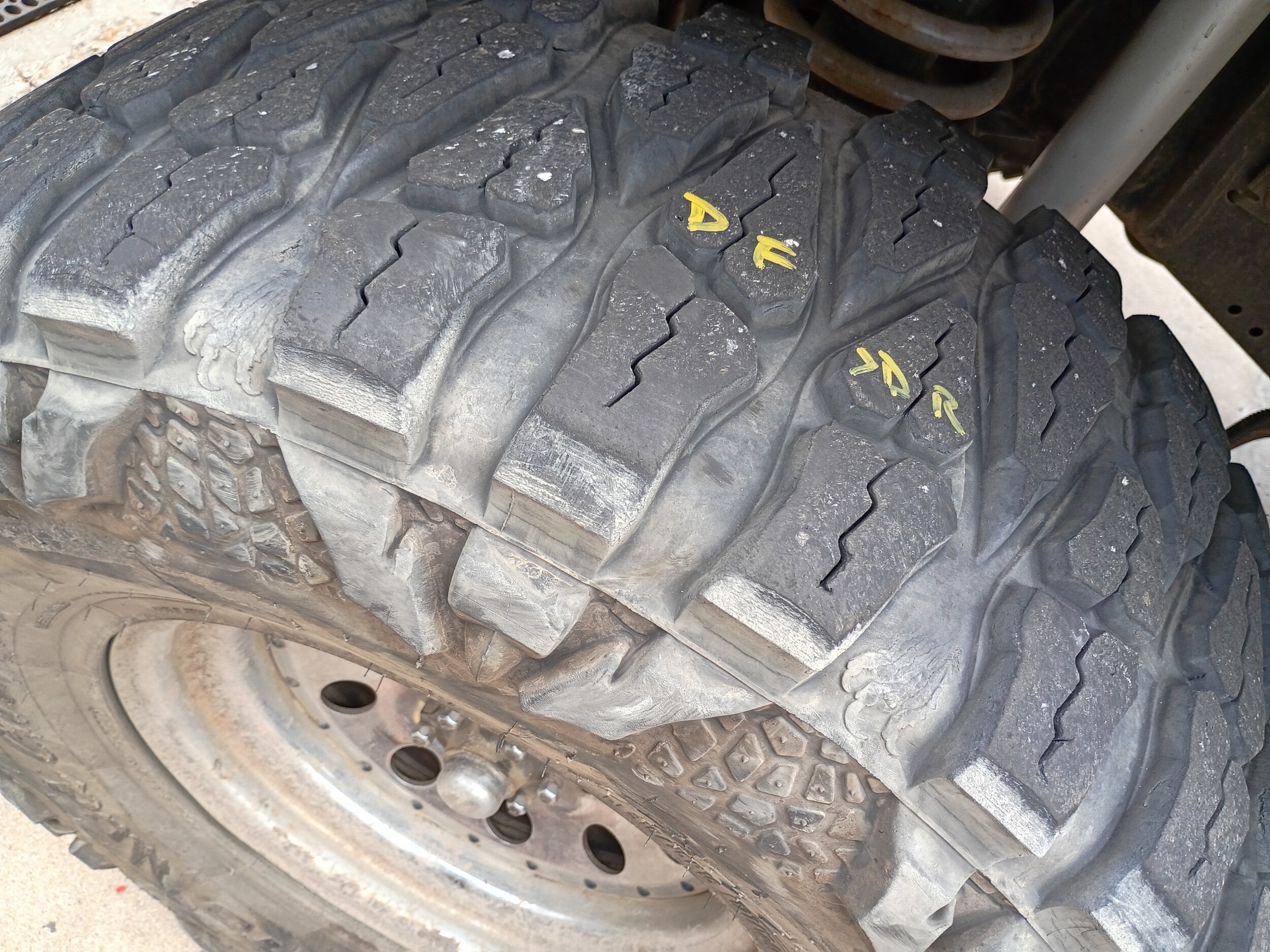

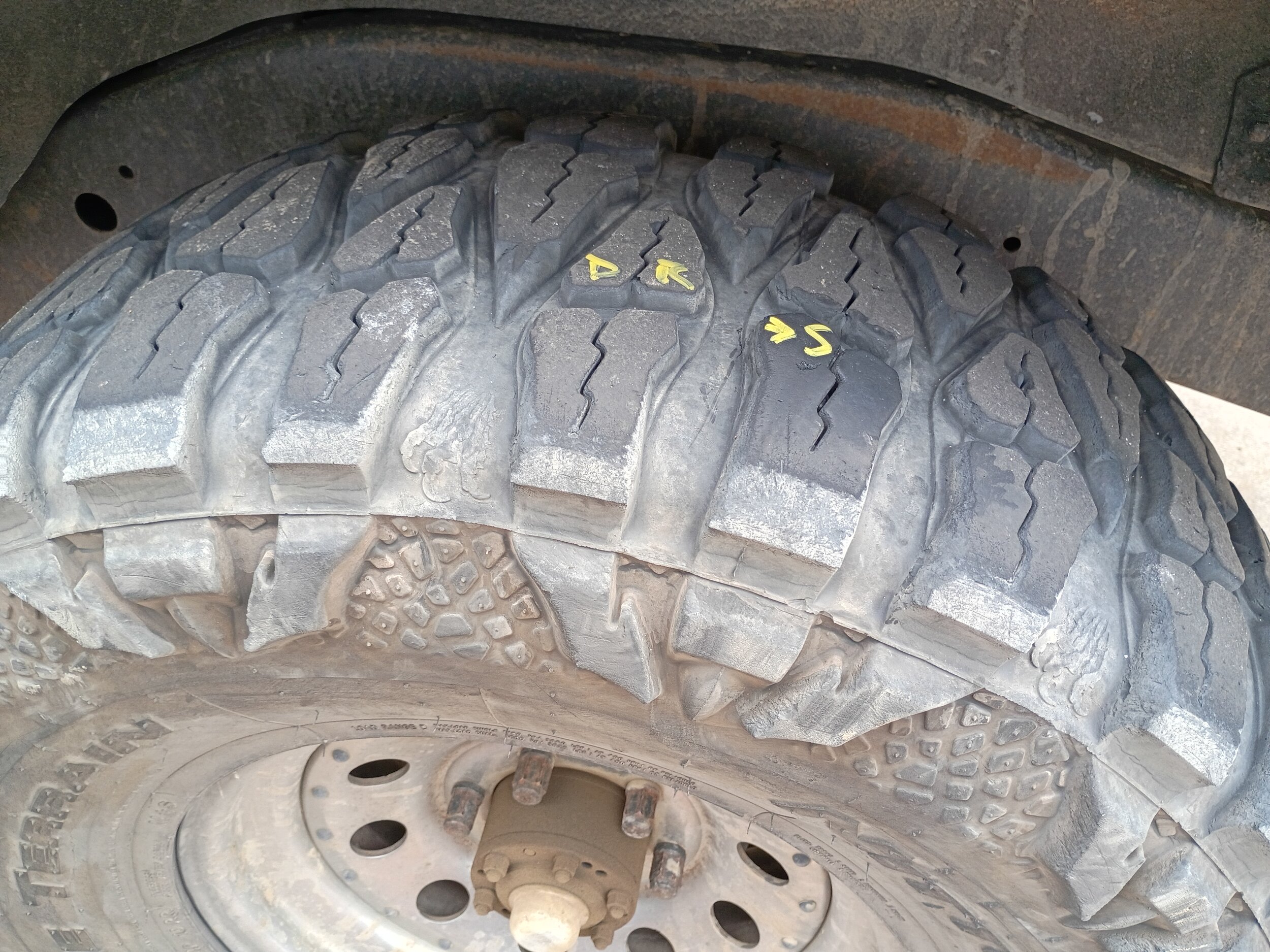

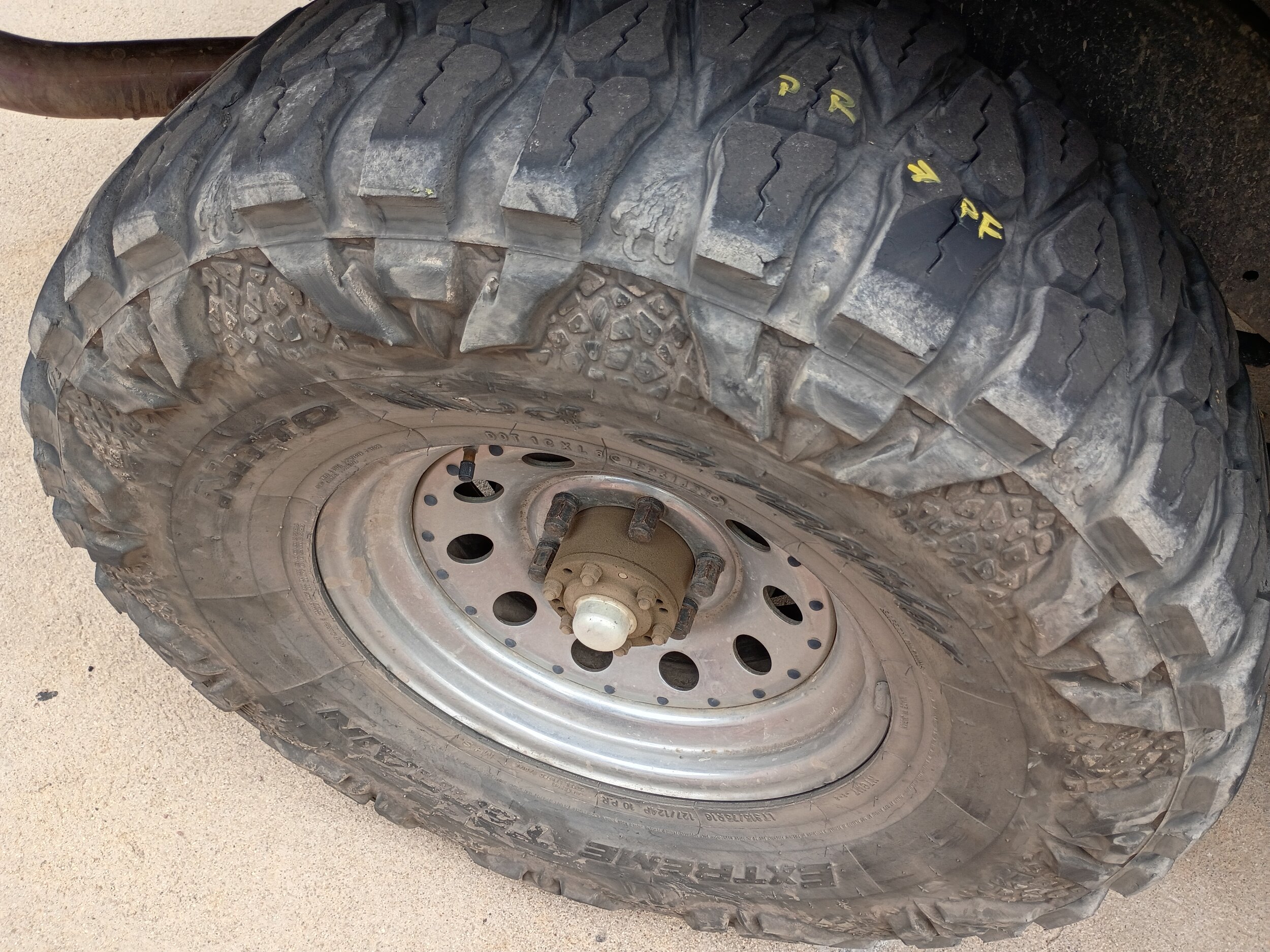

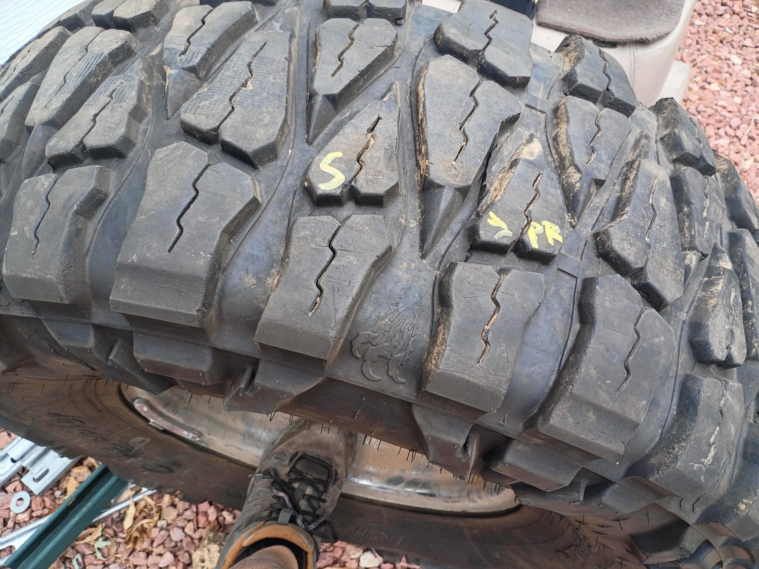

How about some analytical rotation?
758 miles since last rotation
5 tyre rotation including spare, trying to include traditional rotation pattern with special accomodations to excessive wear patterns
1. Passenger front move to driver front: reversing rotation direction to balance wear on left side, sharp feathered edge of lug
2. Pass rear to pass front: even wear with minor chunking from auto locker, move forward to promote heavy, even wear
3. Spare move to pass rear: even wear on lugs, rotation direction to lightly feathered edge on left side of lugs
4. Driver rear to spare: heavy chunking on rotation \ left side of lugs due to auto locker, time for a brief rest
5. Driver front to driver rear: even wear, move to rear for some auto locker abuse

Gnarly man. Have you tried tires with a significantly different tread pattern to see if the wear pattern plays out the same way?

Wear pattern is similar with other tread designs and compounds, mostly due to the locker and hard usage. I'm not upset about it, just mitigating damage
But no, never weighed it, just educated guessing. My heavy wear comment was referring to typical front tire wear patterns from the weight of the engine and steering

Is there more wear from engine weight and turning scrub on the fronts? Or - in a part-time 4wd truck like my 60 - on the rear tires from being rear wheel drive the majority of the time?

I still run drive flanges and FT4wd, so the fronts see more typical wear (even load across the lugs) but the rear tires experience more chunking and harshness from the auto locker. So in essence, I use the weight of the engine to counterbalance and smooth out excessive wear when the rear tires start getting too beat up. if that makes sense
60wag
2,718
Every vehicle Ive owned has had the fronts wear faster than the rears, both front drive and all wheel drive and my 60s that were rear drive - 95% of the time. Its braking that causes most of the tire wear. The brake pads/shoes back this up. I measure the tread depth of all the tires and when the fronts are measurably thinner than the rears, they get rotated, with a crossover to reverse rotatation to reduce cupping of the tread blocks. The tire with the least tread becomes the spare.

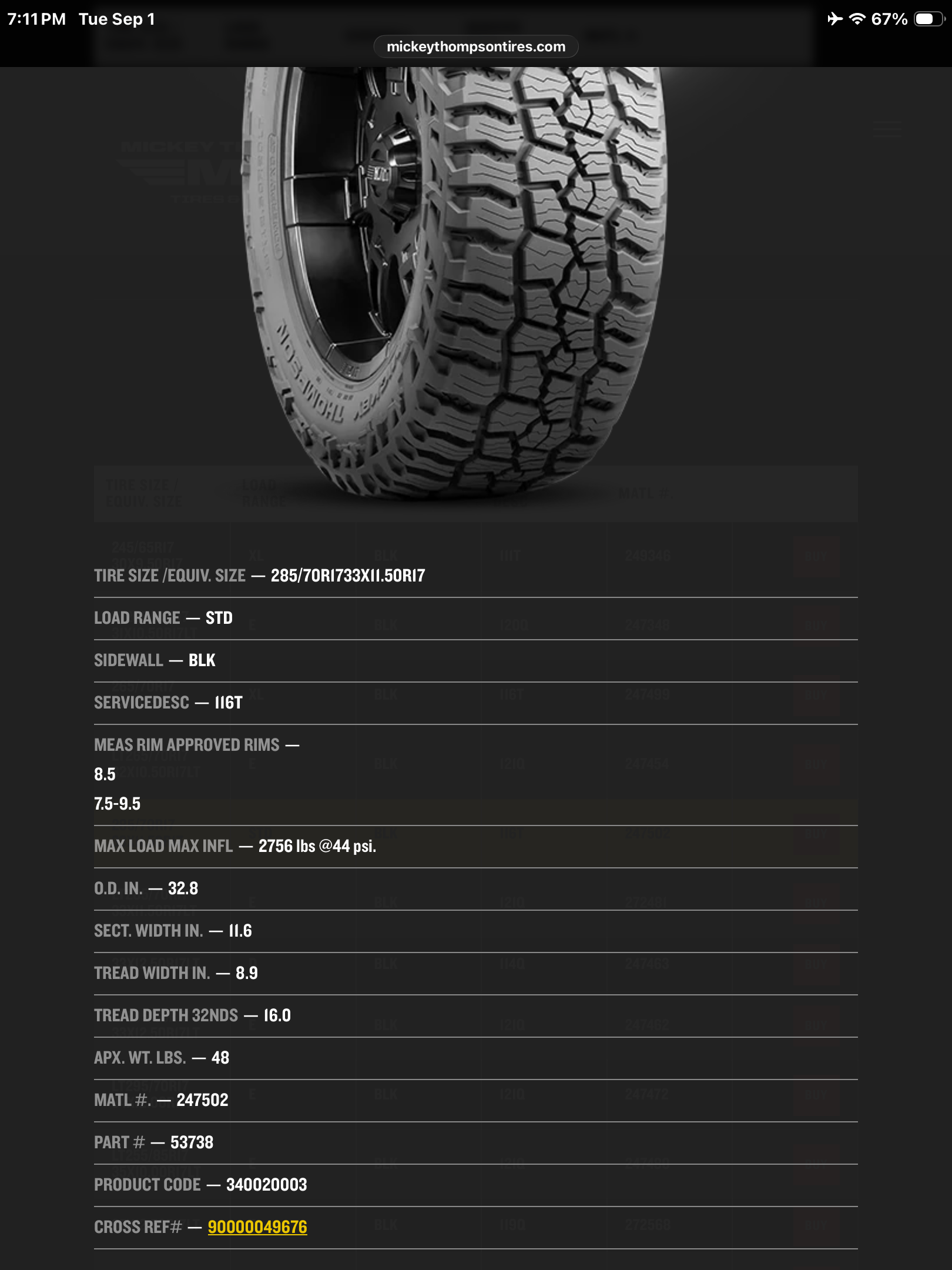

Who's wheeled regularly on ST or XL rated tires over LT's?
I tow regularly so I've always run LT tires but Bridger's new to him 4Runner could benefit from lighter tires as long as they hold up offroad. What's the thoughts of those who have.
The Mickey Thompson Baja Boss is offered in a "STD" load range but still advertises 16/32" of tread which is more than most in that category and OK even for a LT tire.

Half inch of tread you say! Their max load at max pressure tells me the sidewall on them is THICC, BEEFY, and STIFF. Give them a shot!
I'll try pasting a screenshot this time of the spreadsheet calc using your tire @Corbet and I kept the front & rear axle weights constant:
Those specs say ~48# per tire. Mickey T might be playing with how they got the tires registered with the DOT or other Gov authority.
How do LTs of the same size compare in weight?
