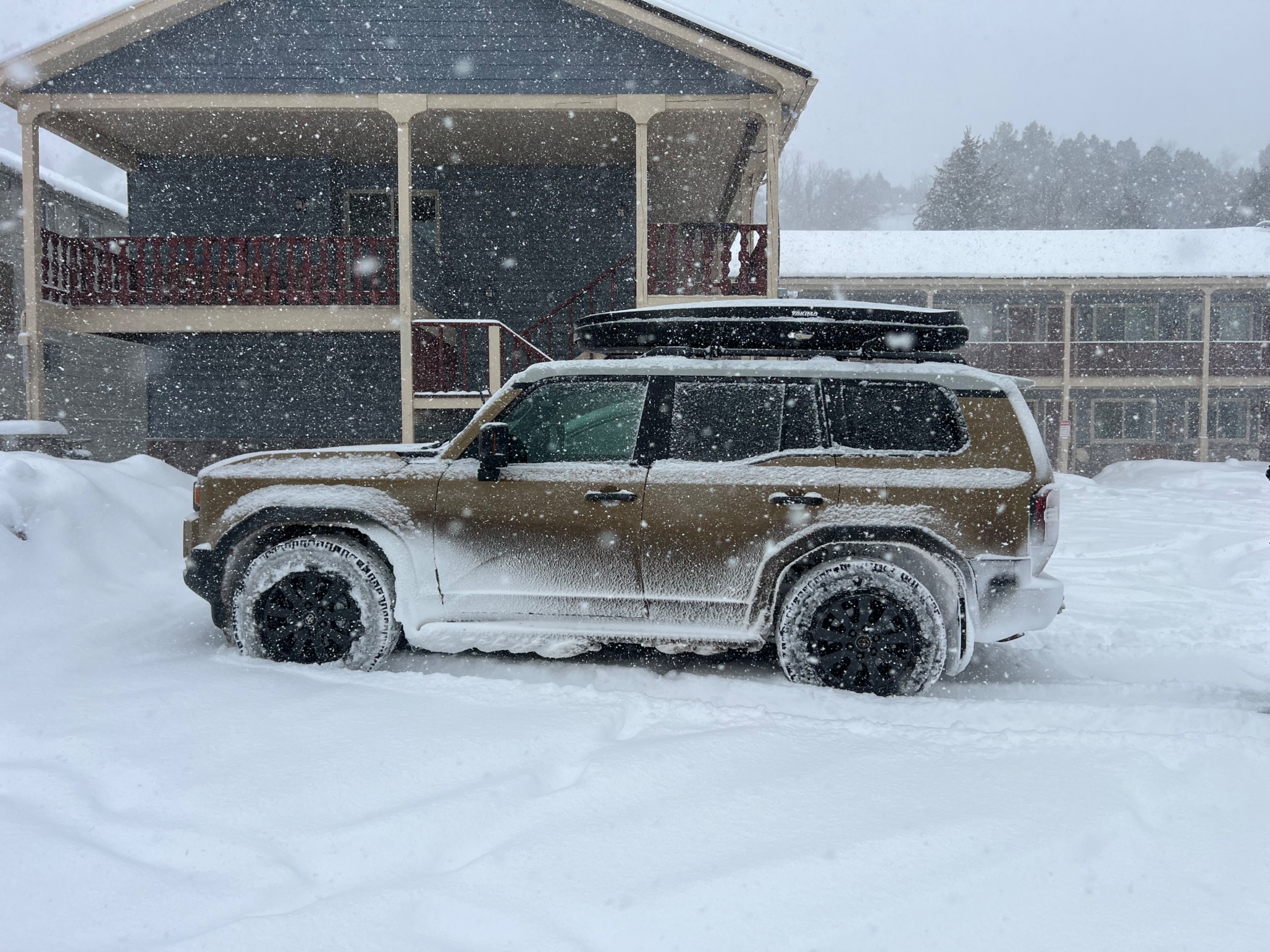

Just did Durango to Ouray on 550. Probably the worst visibility I’ve ever driven it in. Toyo Open Country WLT1 snow tires did great. Predicable cornering and braking.

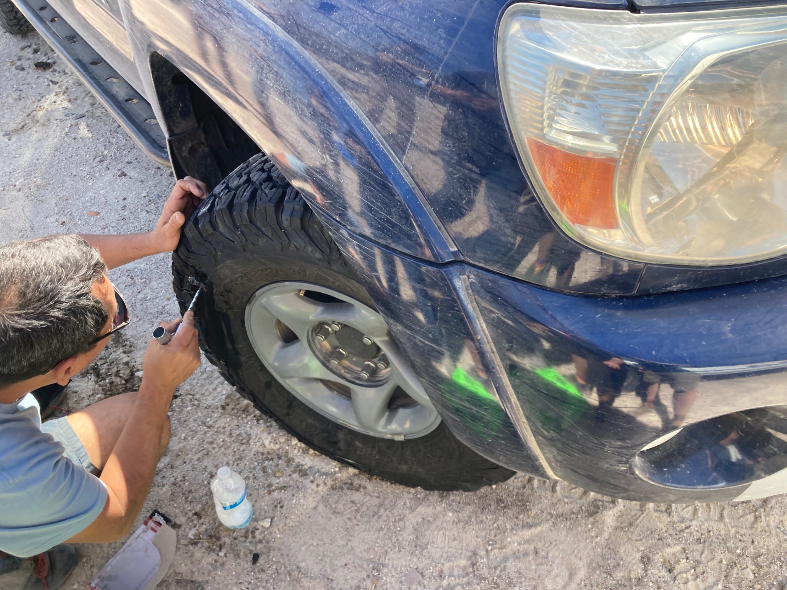

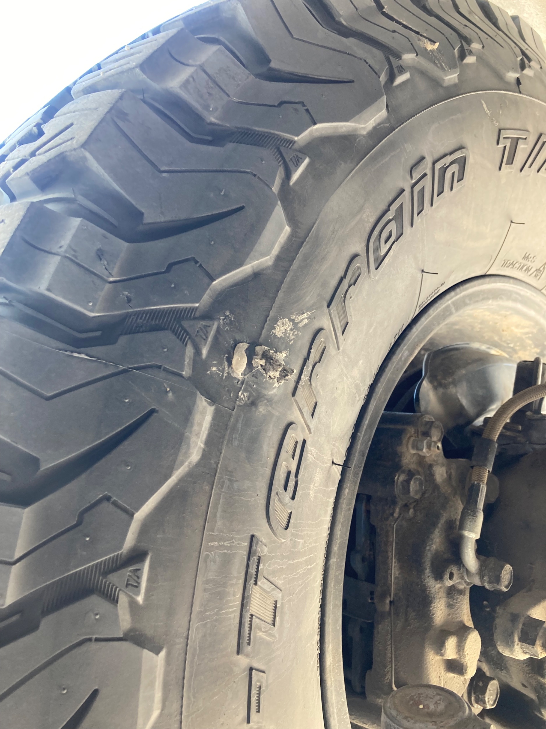

I’m an A/T person. I’ve always been a fan of the BFG ATs. Just to play devils advocate I’ll say that side wall strength, and how a sidewall holds up is 50% tire design, 40% user, and 10% luck. During the 2023 Baja XL we had nine trucks in our group with several different types of tires including ATs and MTs. We did over 2,000 miles down the peninsula to Cabo and back, 80% off road. We had two tire failures, both were BFG KO2s and both were sidewall punctures.
I don’t know what this means but maybe something along the lines of sh*t happens.
I still think the BFG AT and MT are some of the toughest tires out there but sometimes you just have bad luck. The desert is a ruthless place.
You're probably right.
I've kind of always thought there was some correlation to the vehicle, too. By that I mean it seems sidewall cuts on BFG happen to lighter weight truck, like that Tacoma you show and my old mini truck. The reason for that might be the heavy sidewall (and especially with load range E) tend to force us to air down more to get the squish, which exposes the tire more to snake bites pinching between the rim and road and being pushed really flat over a sharp object. You notice the cuts are usually on the shoulder where the tread transitions to the sidewall, right where a tire becomes vulnerable. With relatively "weak" sidewall tires, like Duratracks, you will see the splits at the rim or in the middle of the sidewall as often as higher.
It's just a working theory. Shrug.
I mean, ultimately it's not like any tire designed for a road vehicle can be as strong as an implement tire so 2-ply or 3-ply and rubber thickness can only vary so much. There are things the designer has to do so it can be mounted on a rim, be tolerant of the heat build up and what-not that will force choices.
