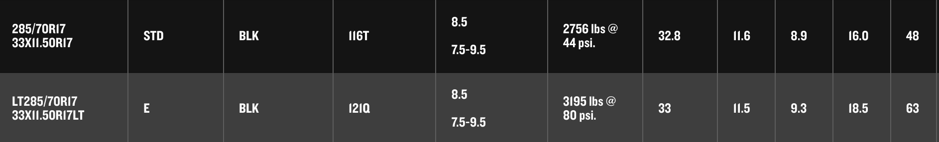

The same tire in a LT is 63lbs, 18.5/32" tread, "E" rated.

oh 63# is a lot more than 48#. About 31% more. The max load 3195# is carried by a higher max pressure 80 psi of the LTs. So it could be argued the LT sidewall carries less of the load. Using the same logic, more of an LT's weight is in the tread.
I wonder if the STD sidewall might be better for off-roading. If a sidewall carries more load with zero pressure, then is it stronger & tougher?

Well I can't see 2.5/32" of tread adding that much to the total weight. I'm sure there is more to the overall carcas of the tire. Both rubber and belts/cords.
My personal fear always with tires is a sudden sidewall failure occurring when I'm already at my max limits preventing me from flopping while perched on some kind of shelf road. So I tend to error is the side of durability over ride quality if faced with that decision.

Makes sense. I think of rubber in tires being there mostly for traction and air holding/sealing. The other "secret" ingredients, the belts/cords and their arrangements, are what I imagine carry load when there is little to zero pressure in a tire. Thick enough rubber will eventually carry loads, but then the tire would be much closer to straight up solid like on a forklift. I realize it is actually a more complex composite structure, but since manufacturers hardly share design details I have to simplify how I imagine tire components' functions.
I am also concerned in situations like you're describing. I definitely want to know if I can rely on my tires.
So if a sidewall can carry a greater load with less tire pressure, like that STD Mickey, then I imagine the sidewall has more belts/cords. But a lot of people say LTs have stronger sidewalls than lesser rated tires. It is all very confusing.

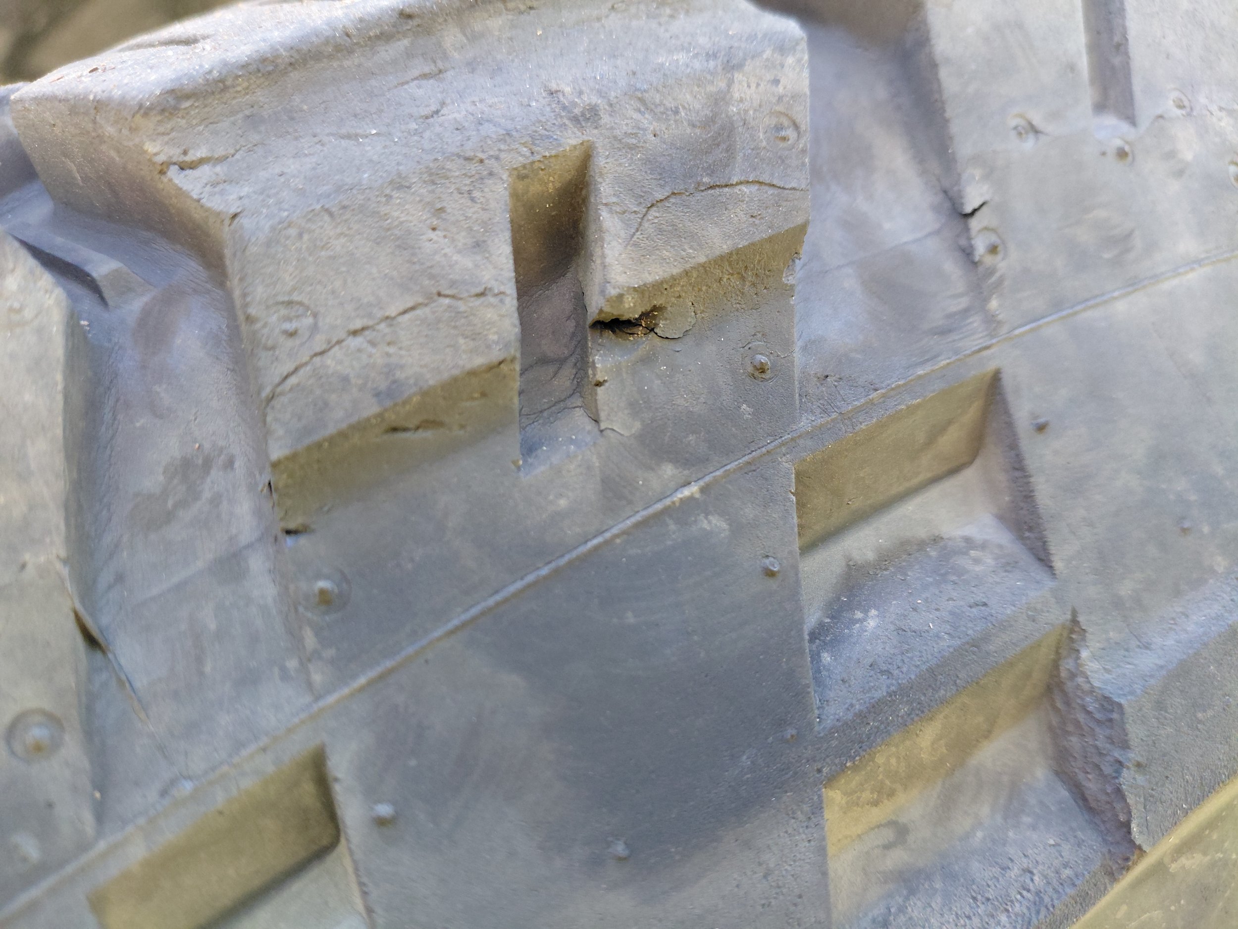

They are way more sticky and work really well in the snow and rain on the road. I definitely feel more planted while driving. But I feel like I've been driving snow tires everywhere and just wearing them out like a dingus.
And they're getting chunks taken out of the tread all over. This is just one as an example.
I didn't have that problem before with the previous Grabber's. I am wheeling a bit more and harder. But still, I don't think that's normal.
Is that normal for other guy's and gal's?

I don’t know, seems like par for the course in Colorado. Decomposed granite and hard, sharp rocks and loose stones are a perfect recipe for chunking tires. I’ve run lots of different types of tires and I get chunking.
