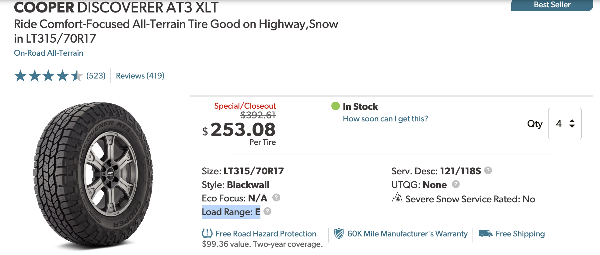

Little off current topic, but on generally on topic, the load range got me looking at my recent purchase to confirm....
Snagged 5 of these, loved them on my other vehicle, they are close out, so act fast.
Quiet, grippy, all around tire wears like iron.... Wanted to stay 16, went 17", but options are drying up faster than Lake Powell in a "35" for 16s.
@Johnny Utah approved.
Cooper Discoverer AT3 XLT LT315/70R17 Load Range: E (on topic)
$ 253.08
WITH ROAD HAZARD!

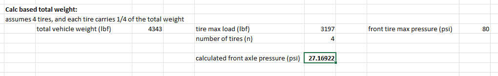

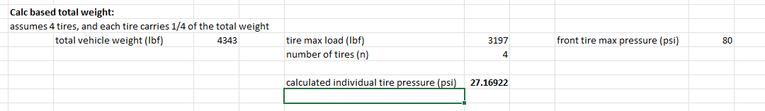

For the fun of using the spreadsheet, I would estimate 27 psi is what might work for you @Wild-FJ
Based on uncle google, I did assume your FJ weighs 4343 lbf. The Toyo tires are supposedly rated to a max single tire load of 3197 lbf at max 80 psi. Answer obviously changes based on more specific values like if your FJ weighs a lot more.

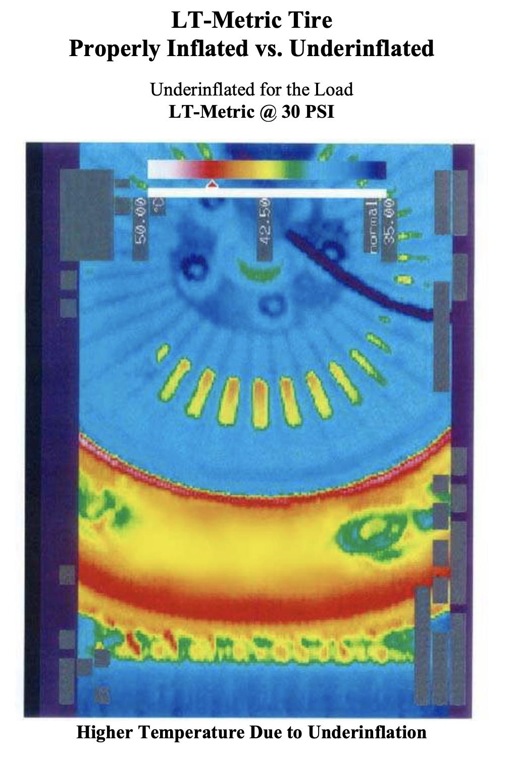

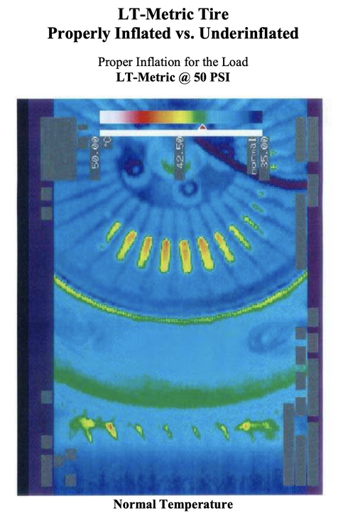

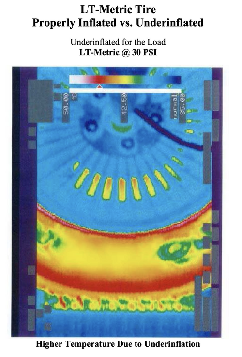

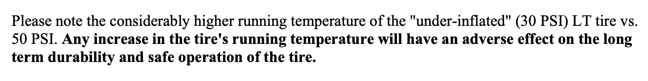

Is this going to be under inflated? Toyota suggests 32 psi on a P-metric but one presumes they do this to achieve the axle rating under worst case conditions, at GVWR and cornering.
Is it a good idea to assume your worst case at 1/4 of total GVWR, for example? If it was simply a matter of 25% of the total then they'd have given something much lower than 32 psi in the first place, right? That 38 psi calculation is like-for-like replacement and 27 psi strikes me as more than a slight tweak in inflation. LT range C would be 50 psi max, range E is 80. But those don't change the adjustment, just the tire's max load. Both would be 38 psi suggested replacing a SL.
I'm throwing this stuff out because on a public facing forum you might want to be careful of engineering recommendations you give. Sidewall flex heating is not totally hypothetical.
From the Nitto NTSD-12-011 tech note. They do cover themselves with "inflation for the load" which very well could be at full load, they only say it was equivalent (they don't say it was the same, though it's implied by saying proper and under inflated) for both.

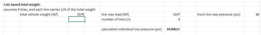

27 psi calculated out for vehicle weight 4343 lbf as uncle google provided. If GVWR is used from google, 5570 lbf, then 35 psi comes out. Folks are welcome to use the publicly available math. It is available in many places not just this forum. I am only sharing what is publicly available. My estimations are not anything that must be done. Just for consideration and discussion.
Screenshot of the math using FJ GVWR:
To be even more clearer, I am not here providing engineering advice. I do understand there is a gray area. I have stated some primary assumptions, I only did it for fun (not professional advice, I am not being paid anything), and everyone takes responsibility for their choices. I have no authority to tell people what they choose to do. I am just some dude on the internet.
