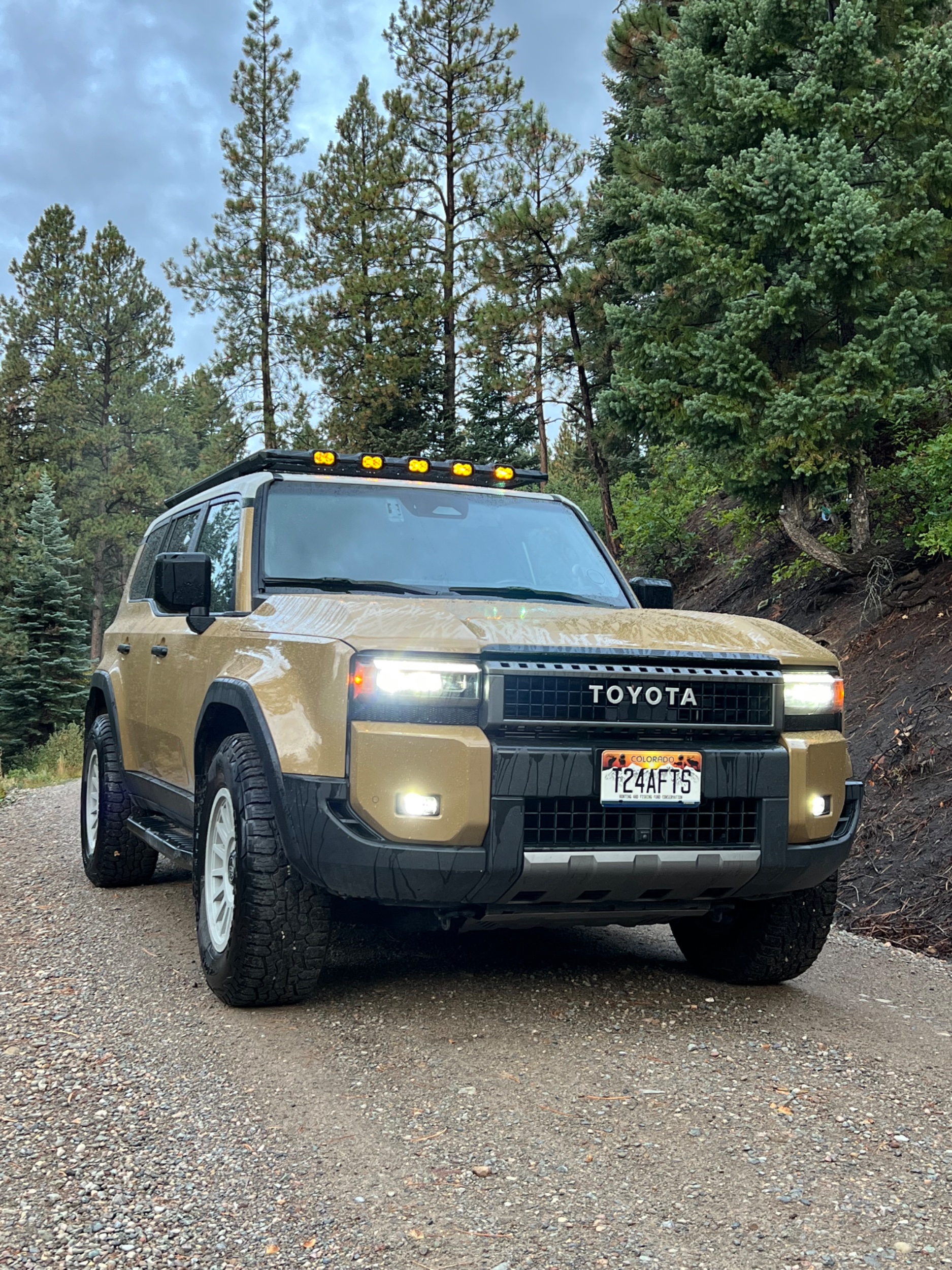

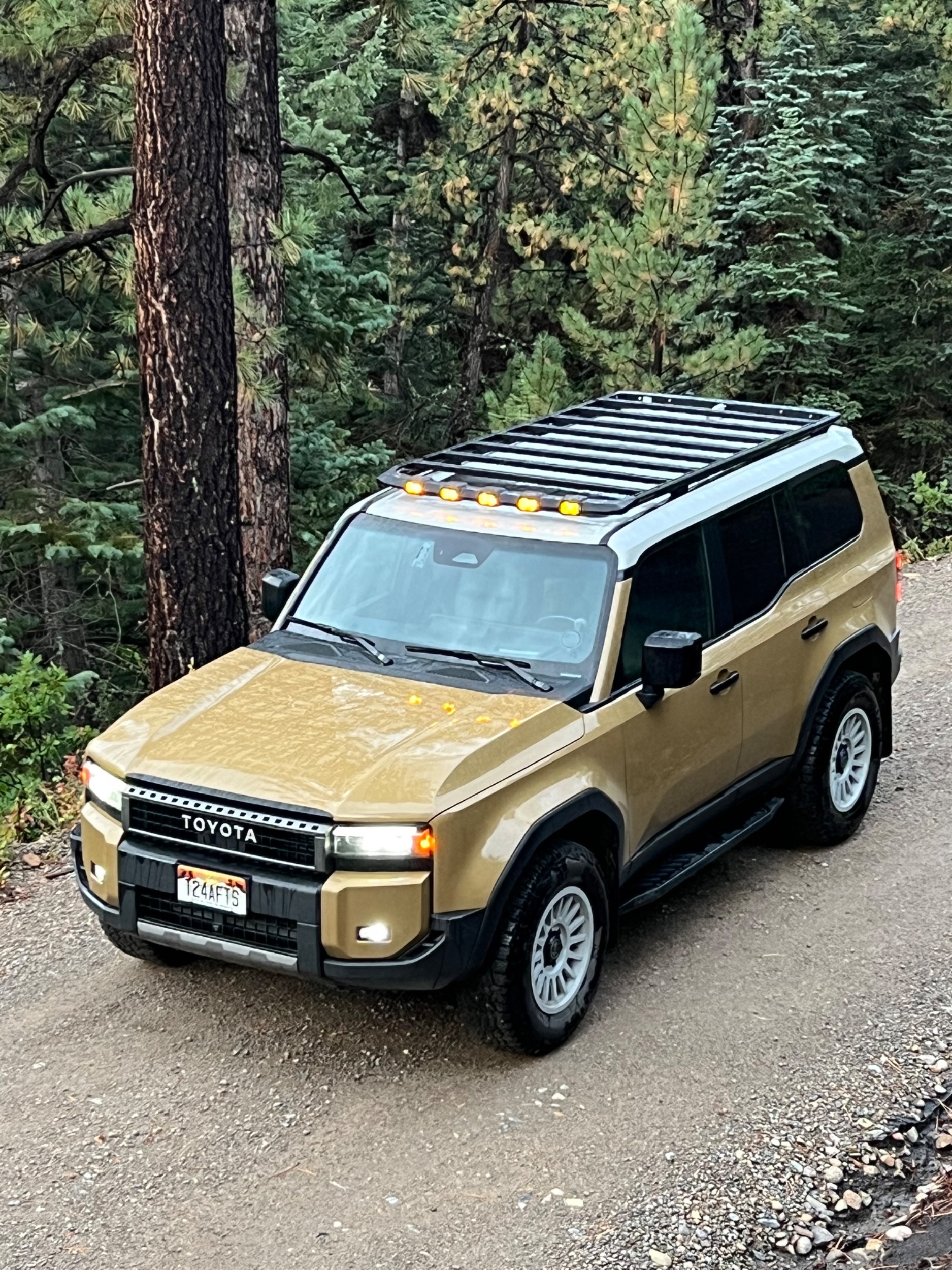

Installed a LandCruiser 250 Kuat DEK roof rack with the light bar option from Diode Dynamics. Lights have an amber backlight and 15,000+ lumens on white mains. Kuat is also offering this for the GX550, 4Runner and Tacoma currently. So far wind noise is minimal. I don't see 50MPH+ unless I leave town. My max so far is 65 and didn't notice muchwith the roof/shade closed. Sunroof open is noisy at speed. Weight rating is 300lbs dynamic and 1000lbs static. Rack is all metal. Extruded, t-nut design that most racks have adopted. Load bars can be positioned anywhere front to back. Did the install at the Gruntled Garage in Durango. (friend's shop)
#KuatDEK
#DiodeDynamics
I like the overhead light look.

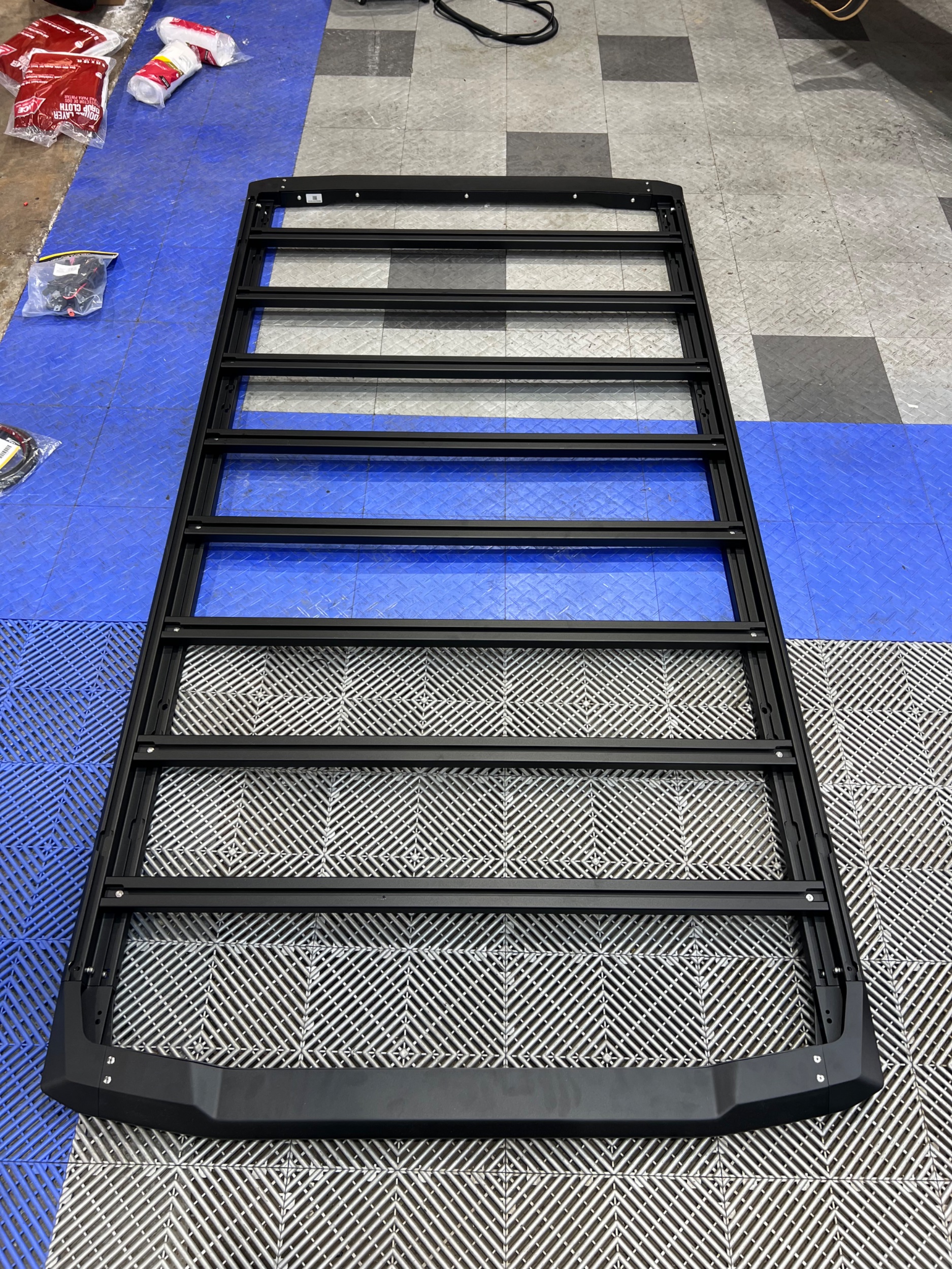

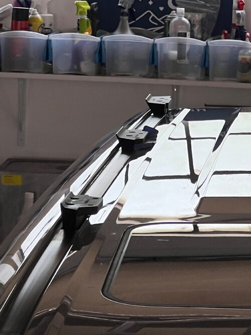

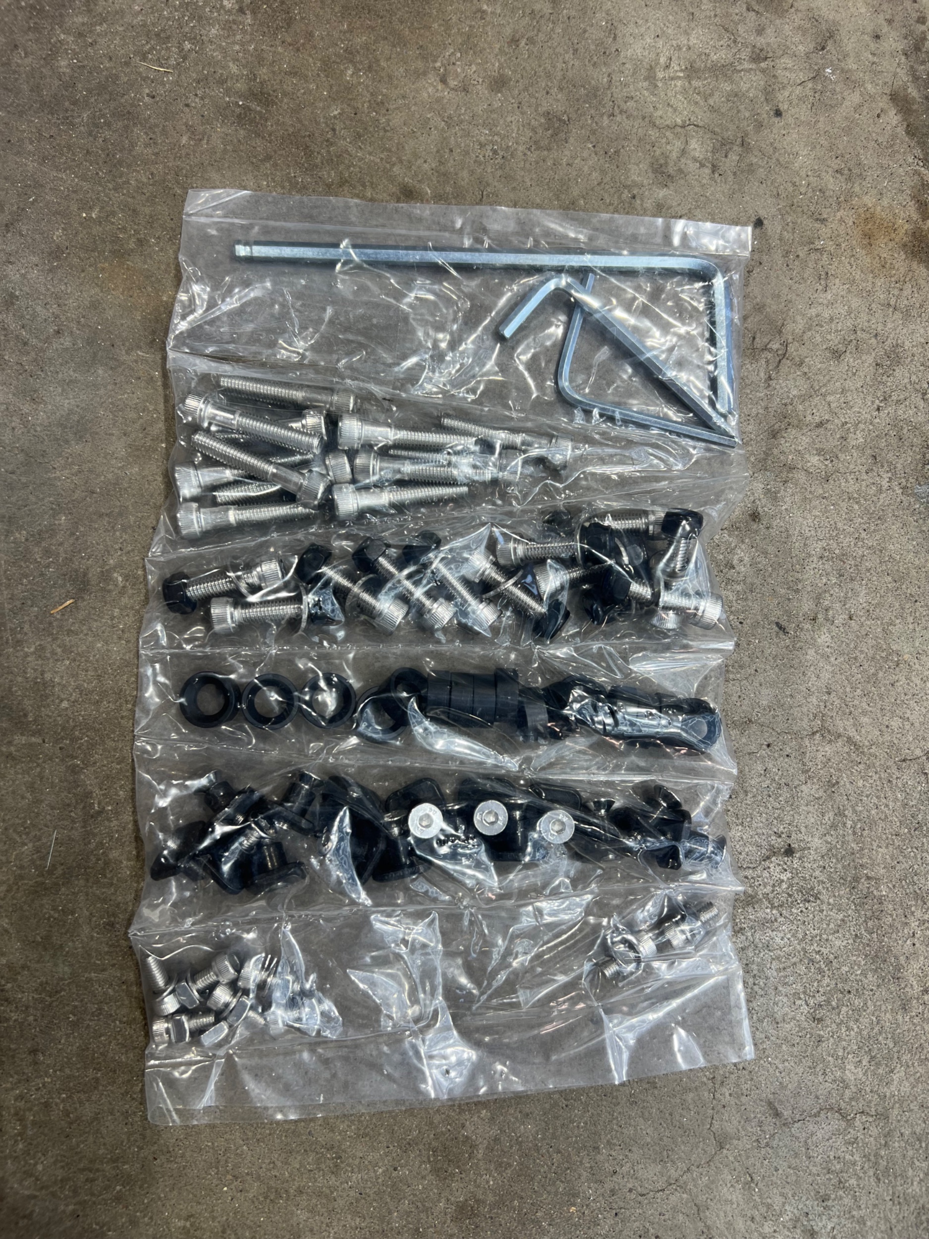

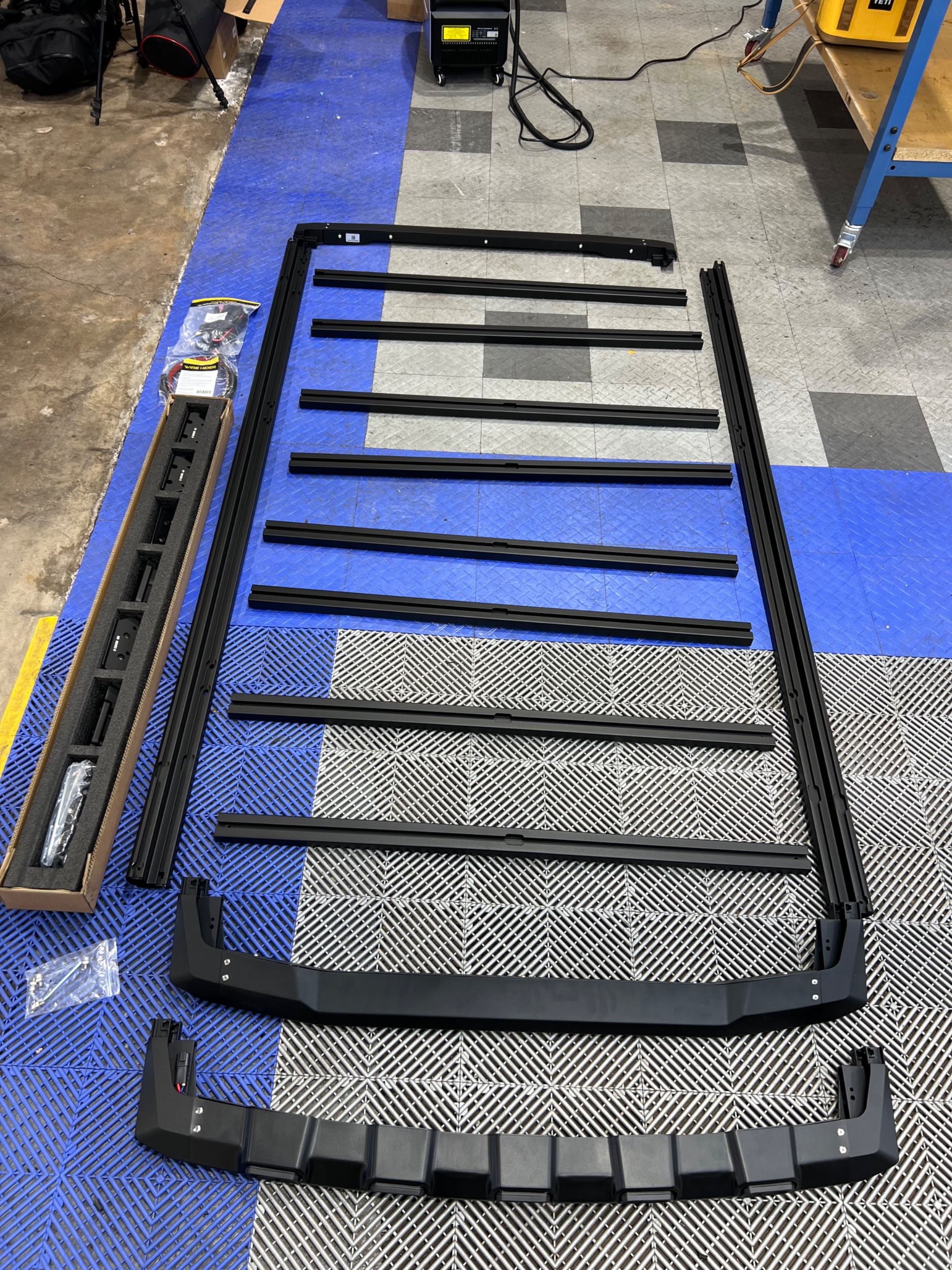

Rack laid out on floor for preassembly

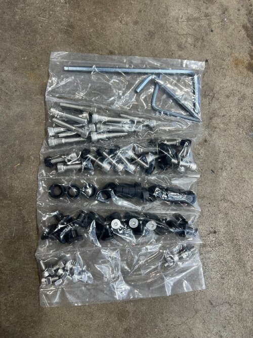

Well organized hardware kit.

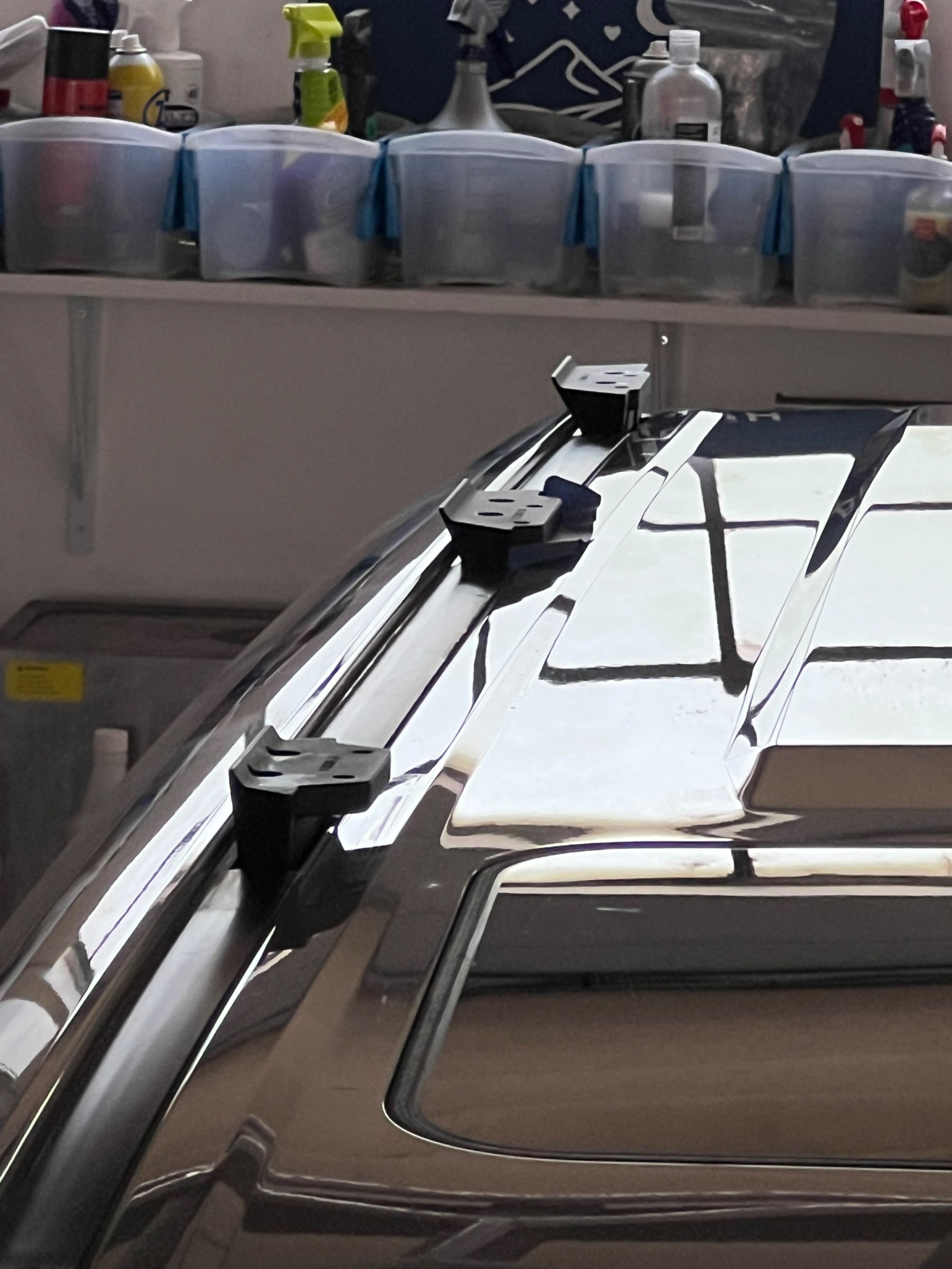

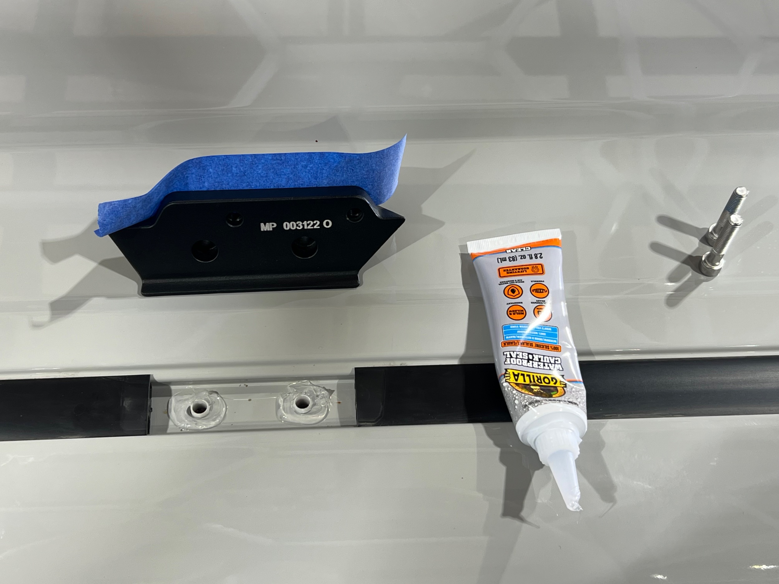

Sealing the mounting feet, blue tape is holding in the nyloc nuts that you won’t have enough space to insert once the foot is bolted down. One could argue this is a flaw but it is part of the super low profile design.
Driver’s side feet bolted down
Rack assembled and ready to set on the 250

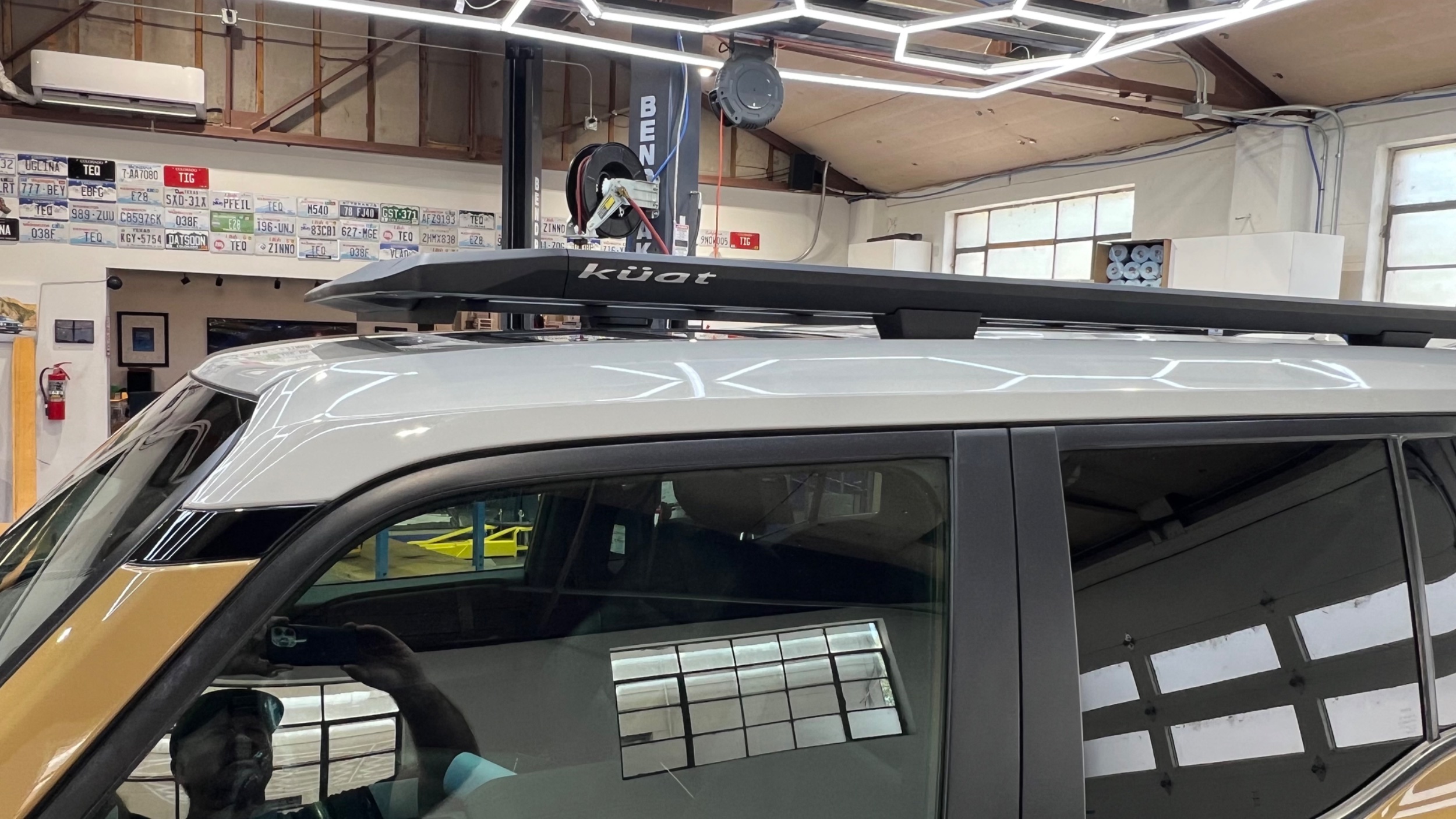

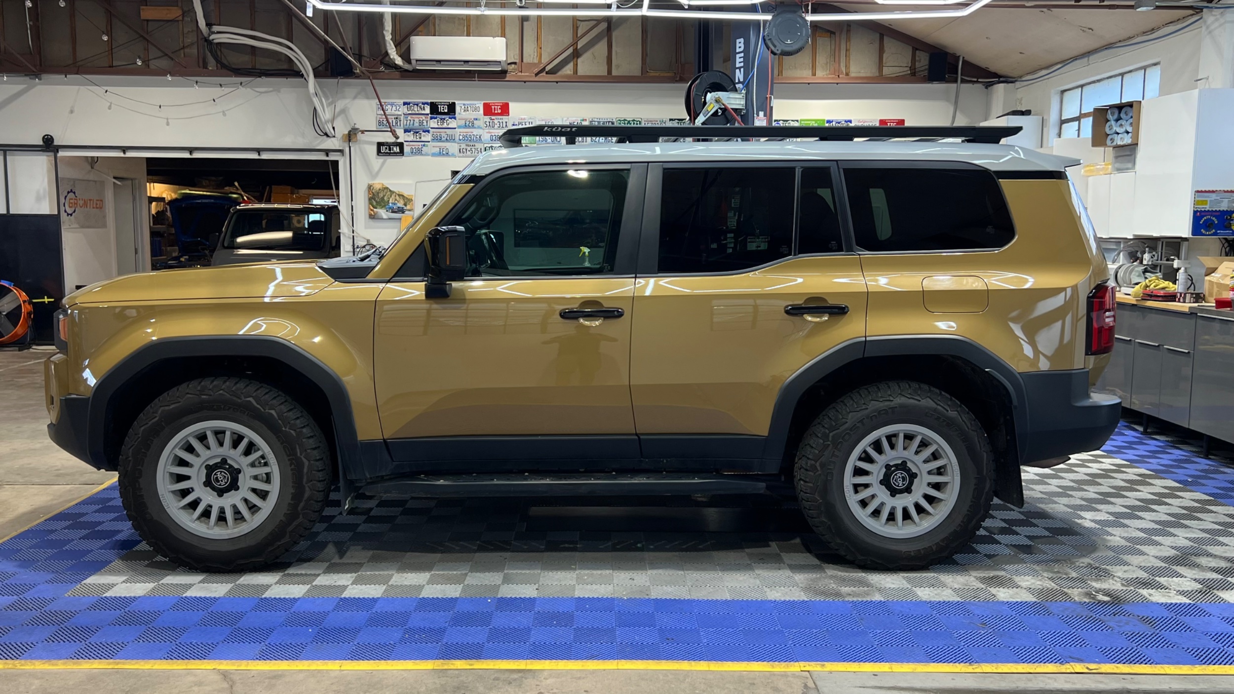

Couple of profile shots without the lightbar

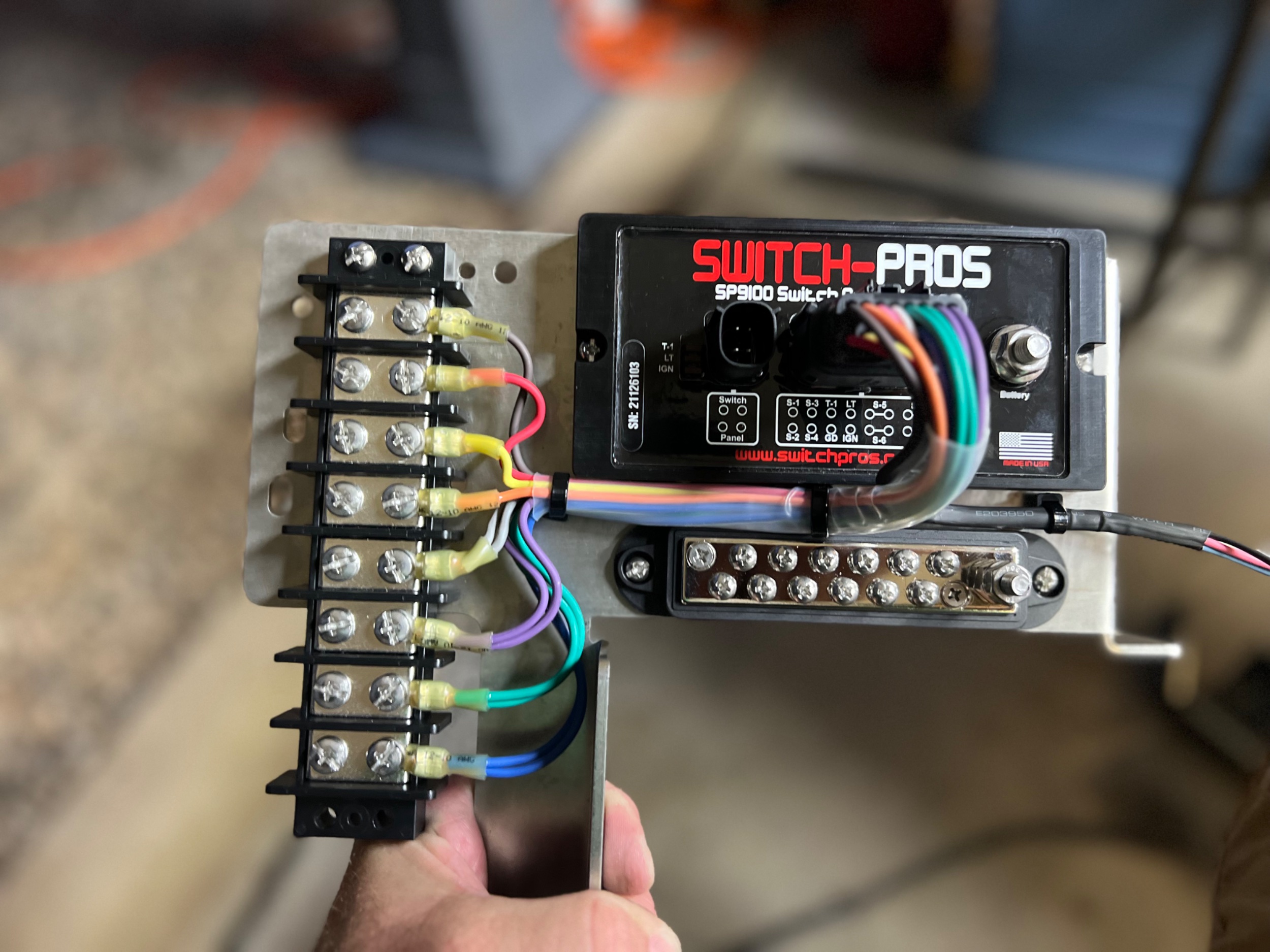

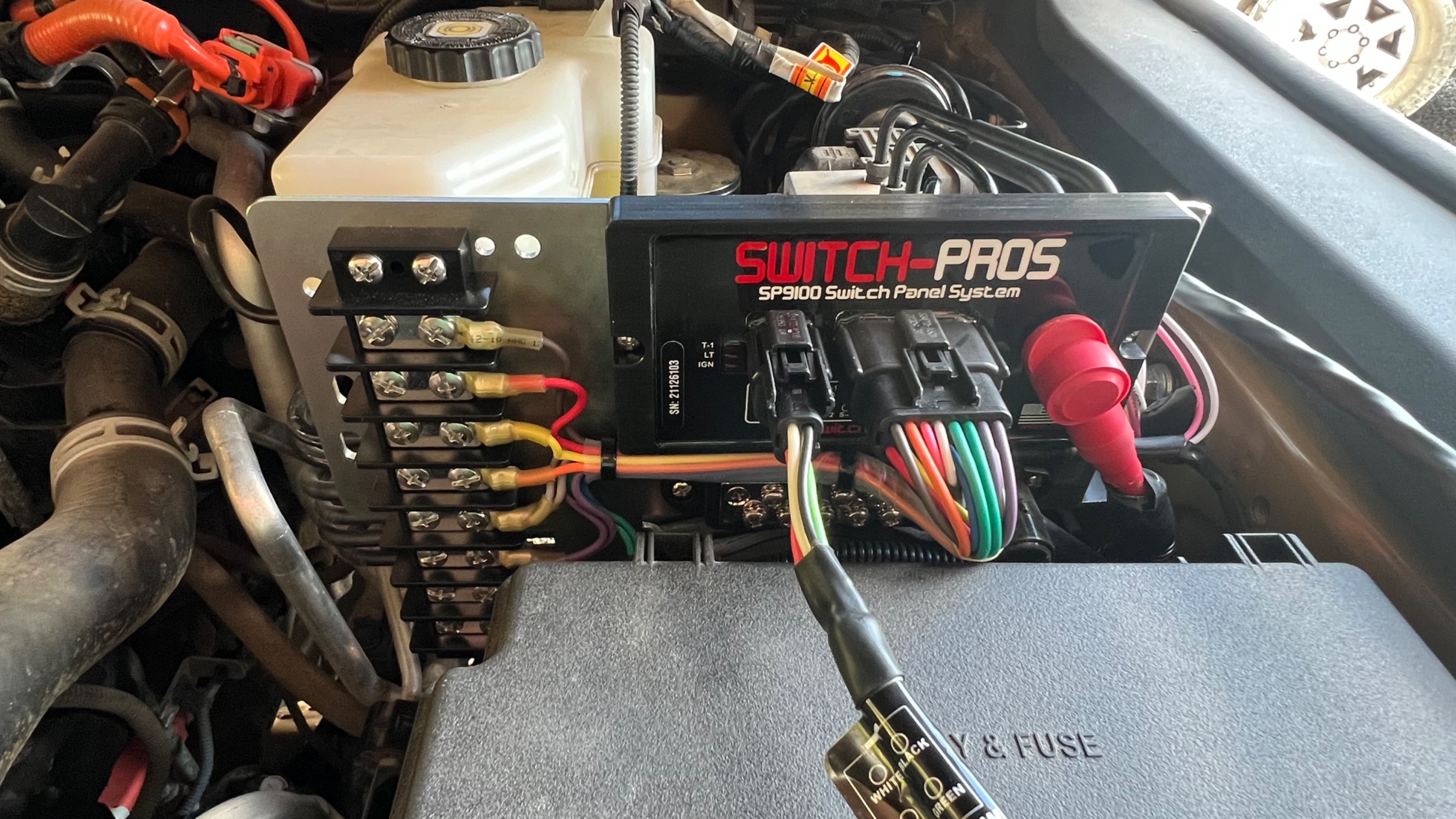

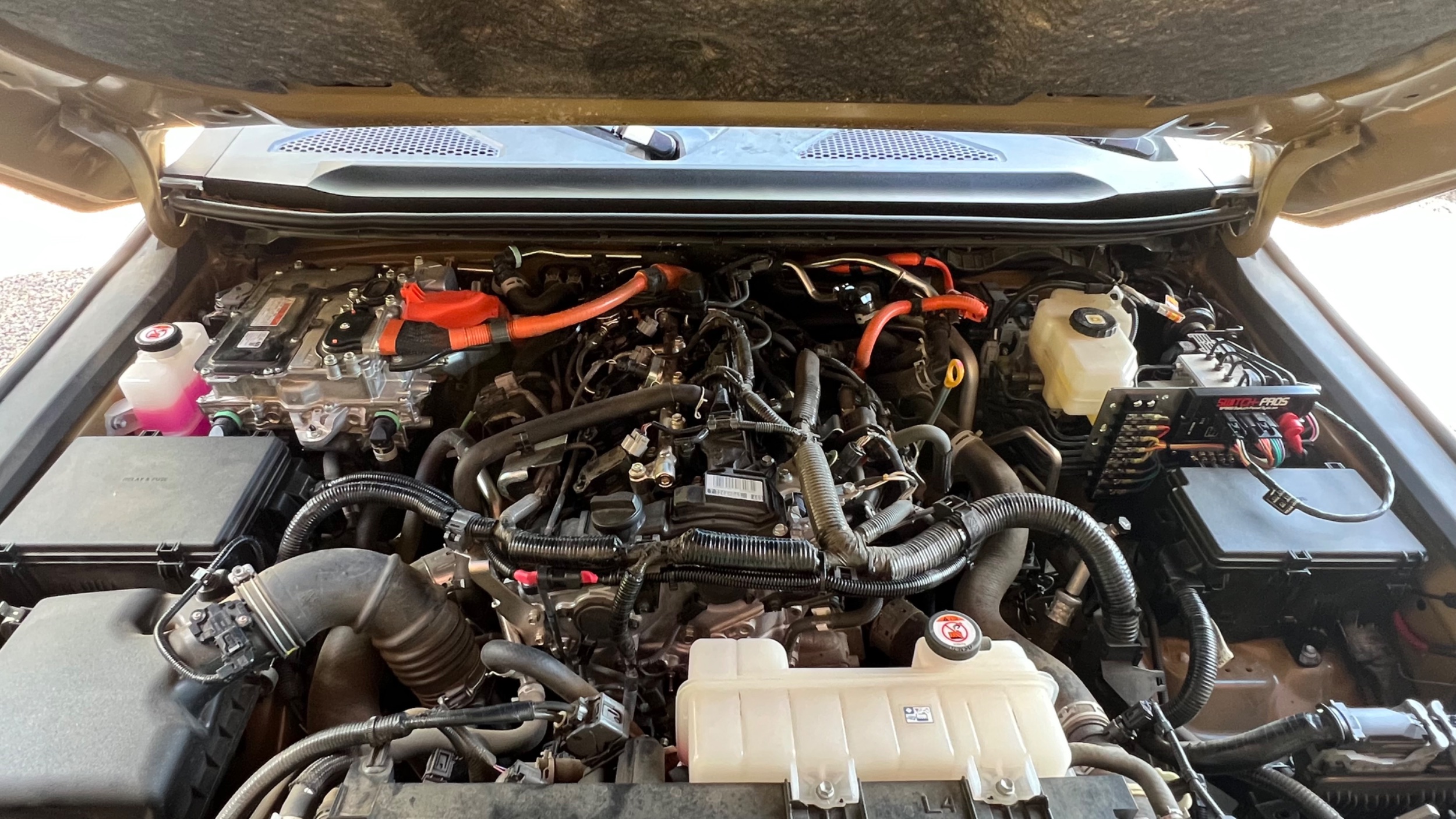

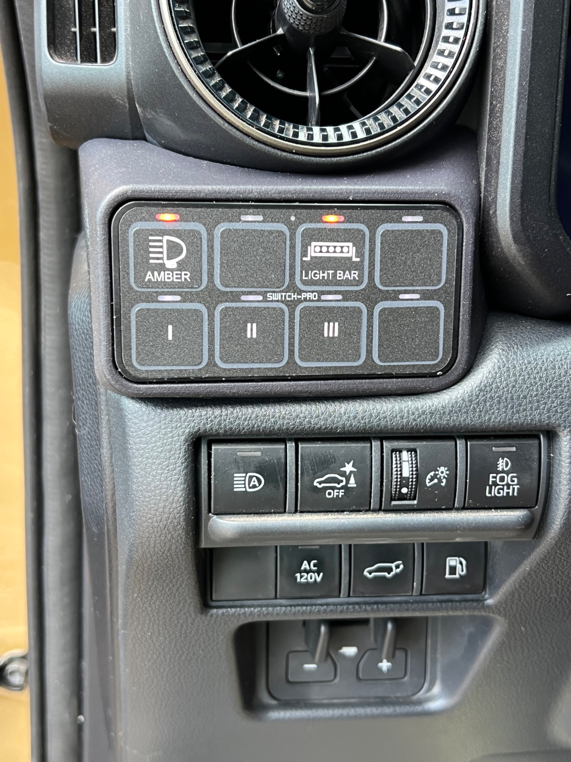

With the Kuat rack I needed power for the lights. The rack came with a very nice harness but a boring universal switch. I could have sourced a OEM switch but decided to install a Switch-Pros system. I’ve had this for a few years and planned to install it into the 80-series. But the availability of a custom dash bezel to hold the switch panel made the decision pretty easy. At some point I’ll probably want to add a winch to this truck and I’ll have to run power from the rear of the truck. I tried my best to make this install as reversible as possible. I’ll have to replace a couple fuse block covers to do so. But the actual fuse block boxes are still factory. If I run winch power I'll move this over to it in the future.
SDHQ bezel. https://sdhqoffroad.com/products/sd...70084&pr_ref_pid=8142492893284&pr_seq=uniform
Completed Switch Pros install
Mounted the Switch-Pro to a Slee driver’s side bracket.

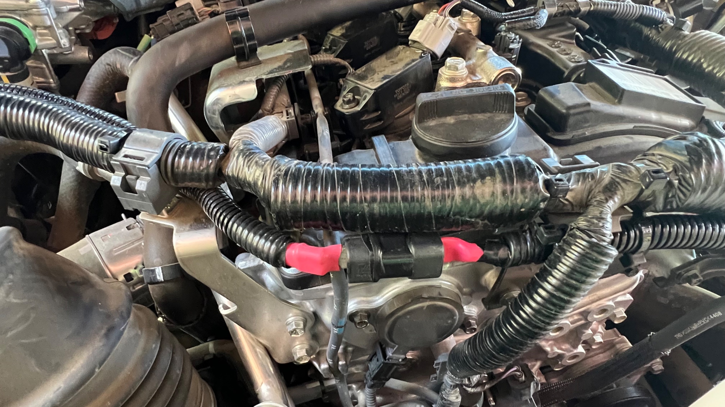

Inline 125amp fuse, included with switch pros. I had to extend the main 4awg power cable to cross over the engine.
Used some bus bars to terminate circuts as I only have two current needs. Didn't want 6 pigtails hanging out.

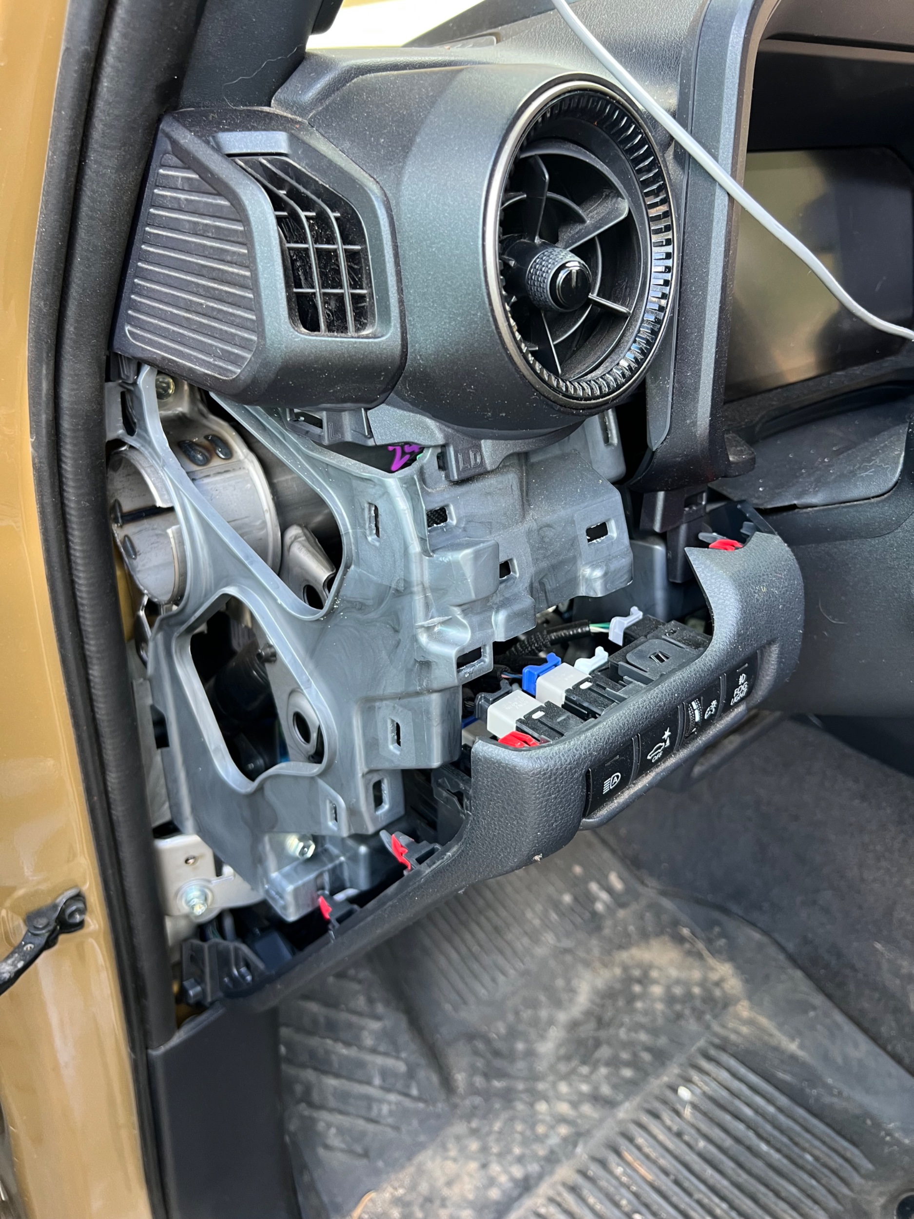

Dash was pretty easy to access. Except for the fasteners. Small hands would make it easier.

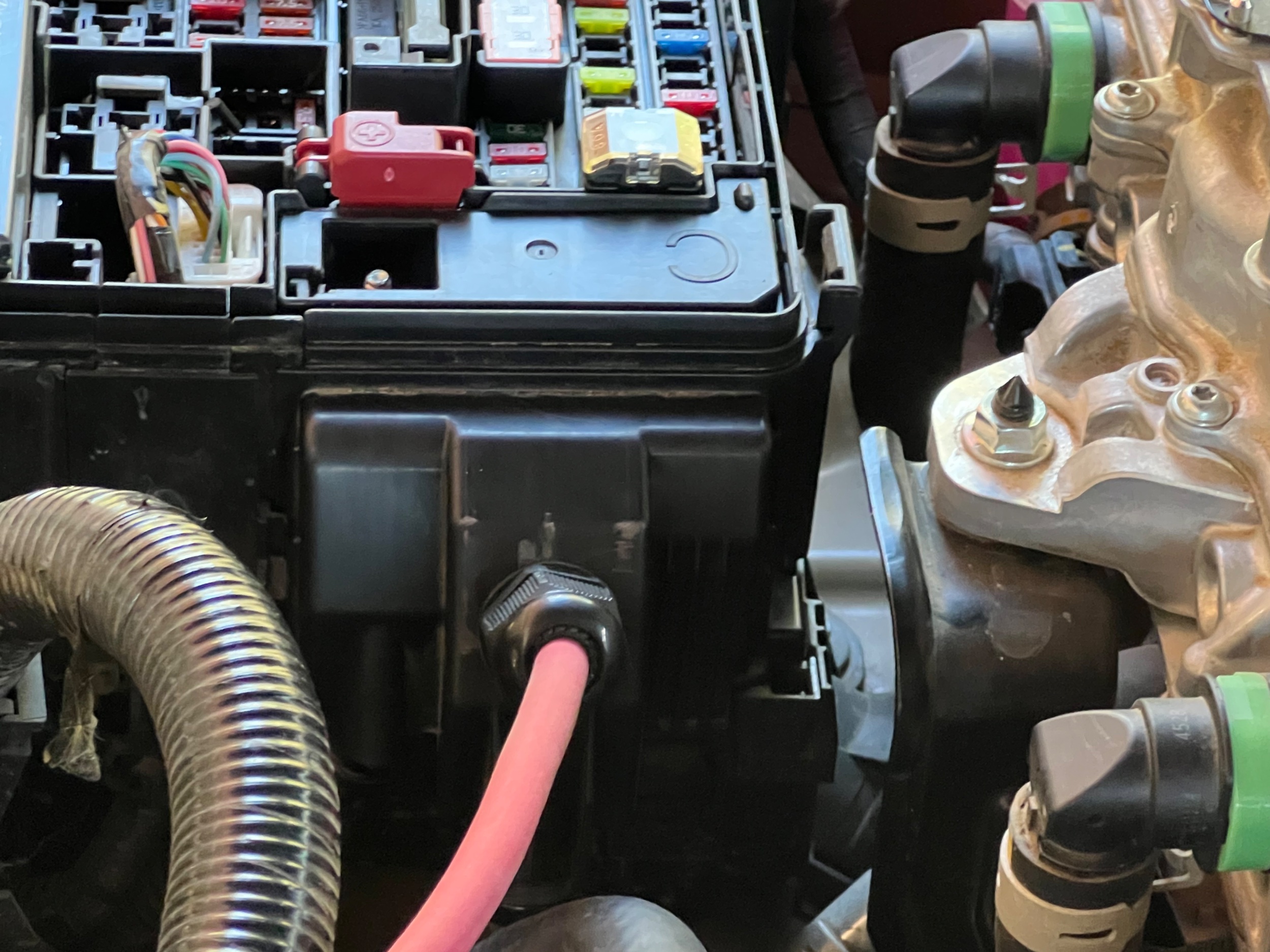

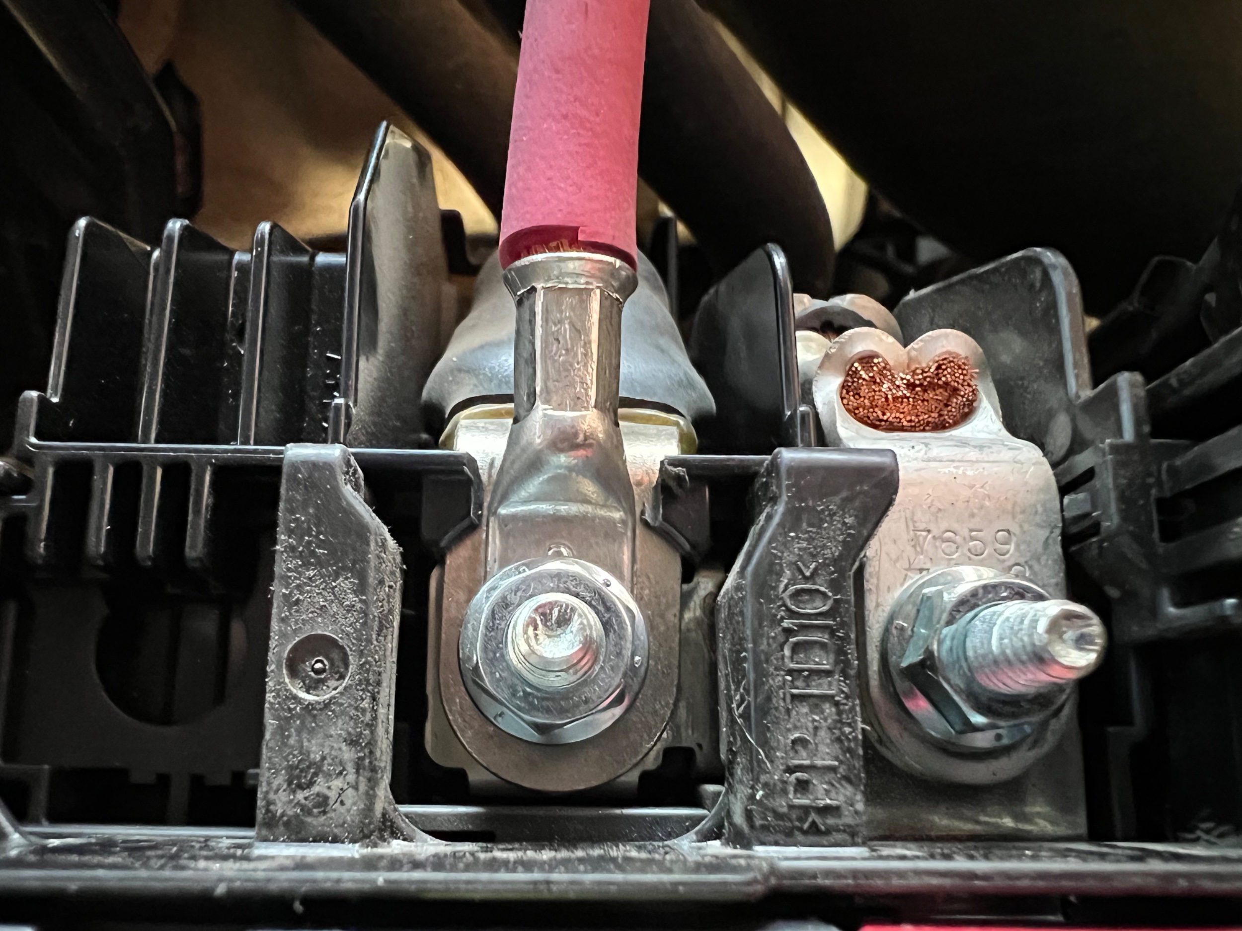

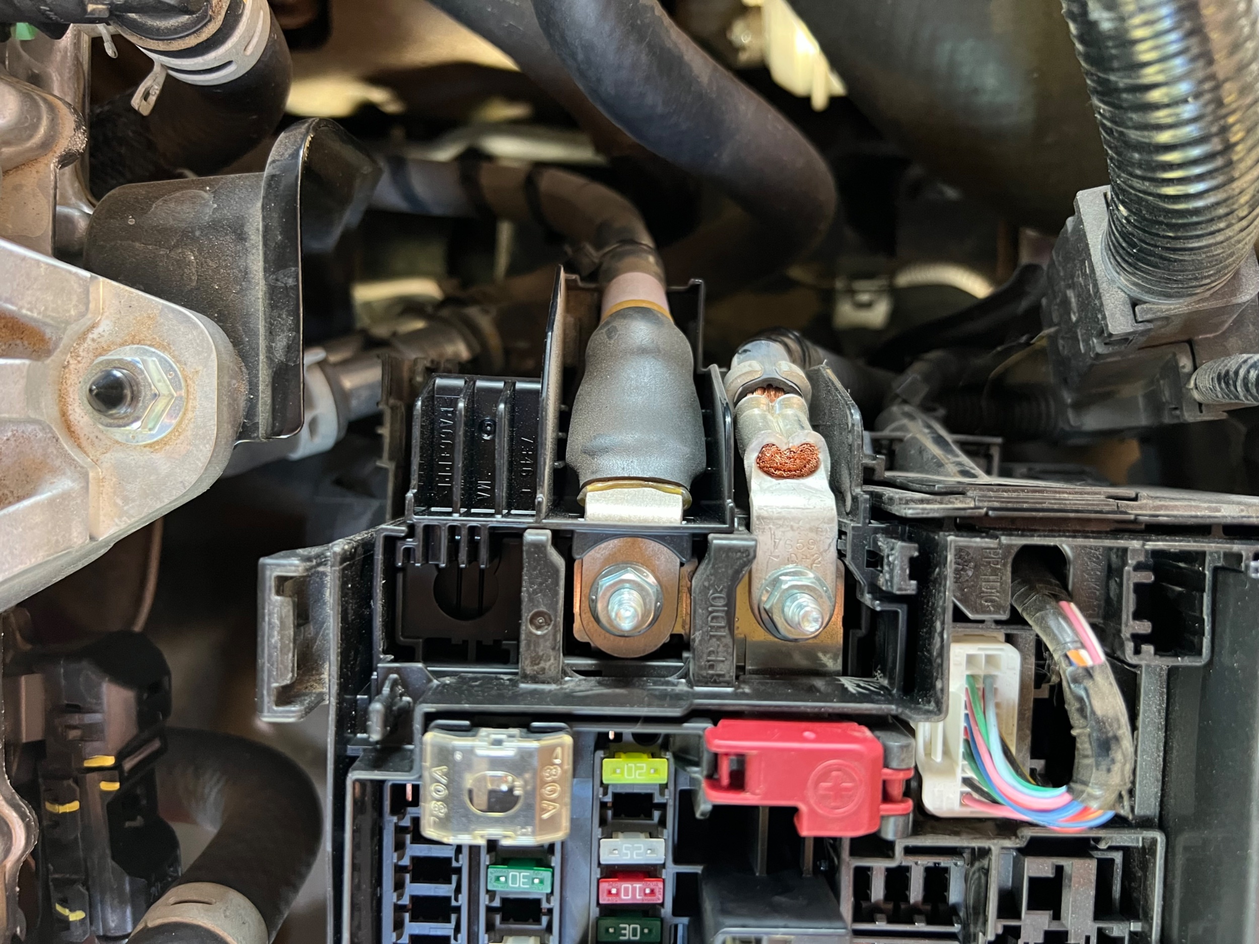

I tapped the passenger side fuse box for power.
Had to trim some plastic to get the terminal lug to sit flat. Also picked up a hydraulic crimp tool to properly connect the lugs. You can see the hex shaped crimp here.
Passed the power supply through the terminal cover. Backside took extensive dremel work to clearance.

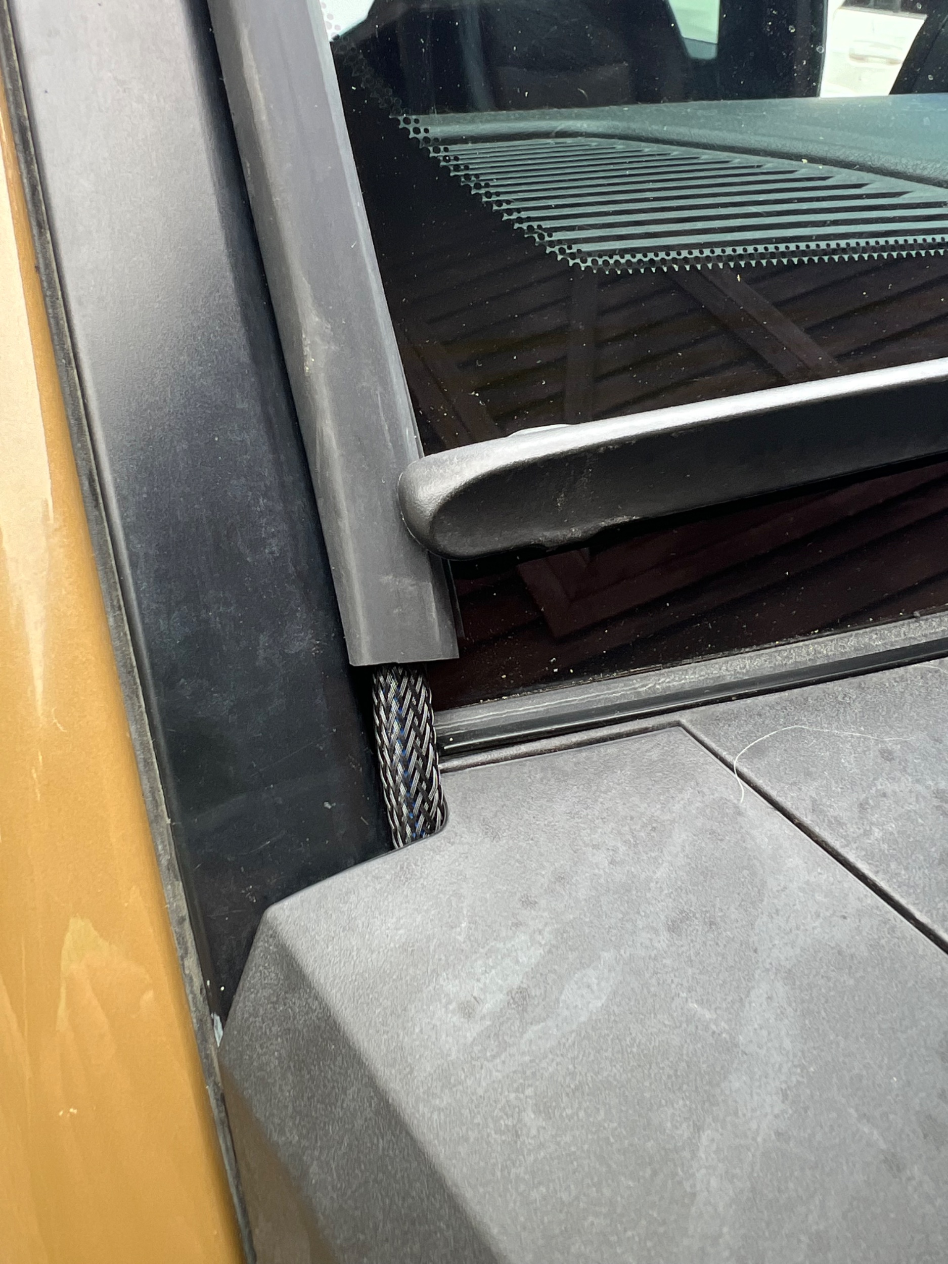

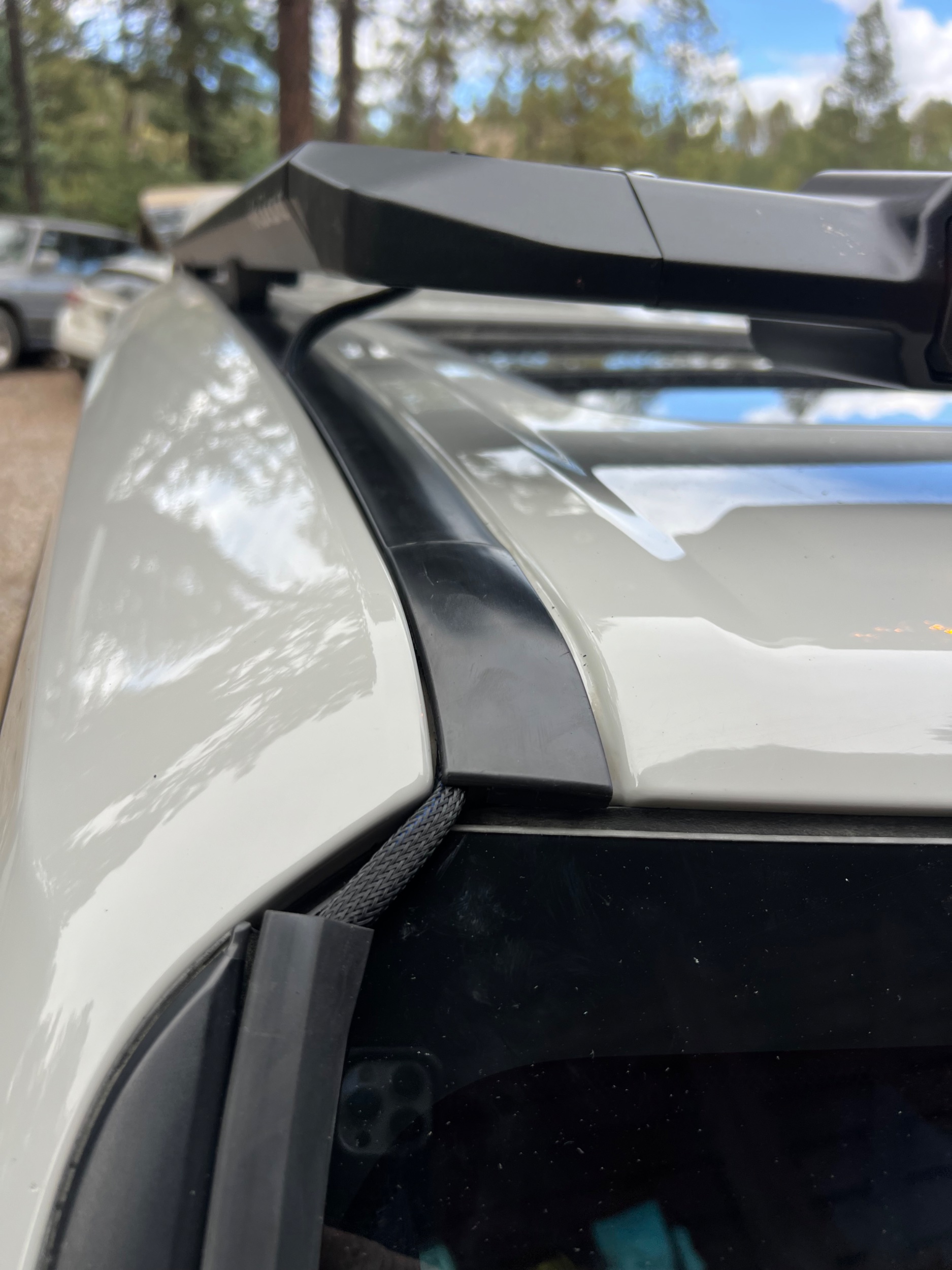

Cut up the supplied harness from Kuat to wire up the lights
Kit came with the rubber trim to hid the harness. Slight contact with wiper.

@Corbet, curious about the rubber gasket to hide the wires. That's a clever solution. Are they fairly sizable wires (as in they couldn't be snaked behind a factory trim)? Think it'll hold up to snow scrapers? I've found over the years, at least with mini truck/Tacoma stuff, that often the people who come up with them are in SoCal and what-not and sometimes things like winter don't cross their minds. Always keeping an eye out on novel ways to get from topside down, not everyone wants to poke holes in their sheet metal or toppers for antennas, solar panels, etc.

@DaveInDenver. The 3 wires bundled together are a little smaller in diameter than the 4 AWG main power cable for the Switch-Pro. So pretty sizable. We’ll see what winter brings but I like this solution over pulling the windshield trim. It seems like the more you remove OEM things they don’t like going back on. I can say that for the roof channel trim above that I hide the wires in. We don’t get as much morning ice on the windshield as you’d think. I’m pretty gentle when scraping.

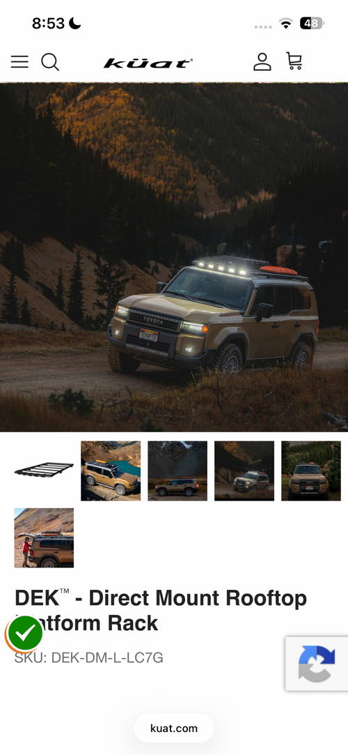

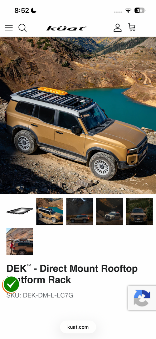

She’s featured on Kuat’s website now.
Couple examples

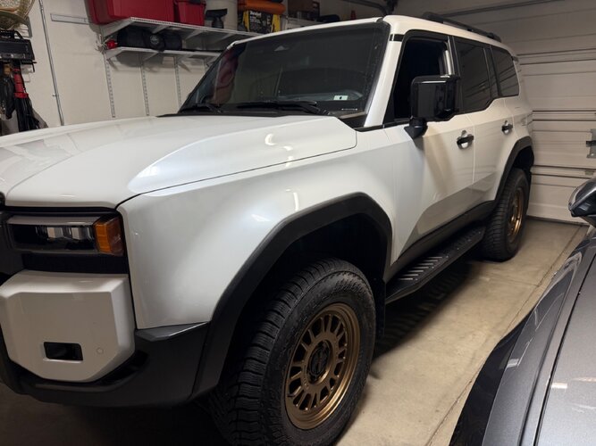

Off with the running boards on with the sliders. Slee Offroad sliders to be exact. We all know the quality of product that Slee provides so I won’t dwell there. Install was pretty easy solo. I got the lighting kit but will wait for better weather. I’d had enough laying in the cold snow & ice for the day. If I had any criticism of the design it would be the overall length front to back. I’d like them to terminate closer to the wheel wells. Front is OK rear could easily be an inch or more longer.
