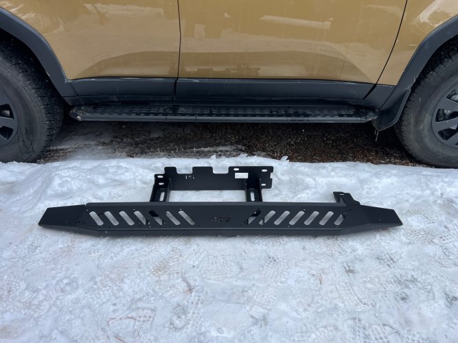

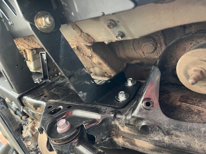

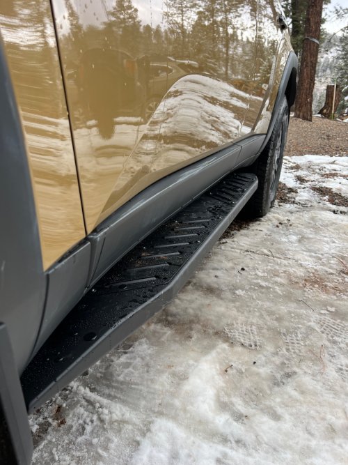

Off with the running boards on with the sliders. Slee Offroad sliders to be exact. We all know the quality of product that Slee provides so I won’t dwell there. Install was pretty easy solo. I got the lighting kit but will wait for better weather. I’d had enough laying in the cold snow & ice for the day. If I had any criticism of the design it would be the overall length front to back. I’d like them to terminate closer to the wheel wells. Front is OK rear could easily be an inch or more longer.

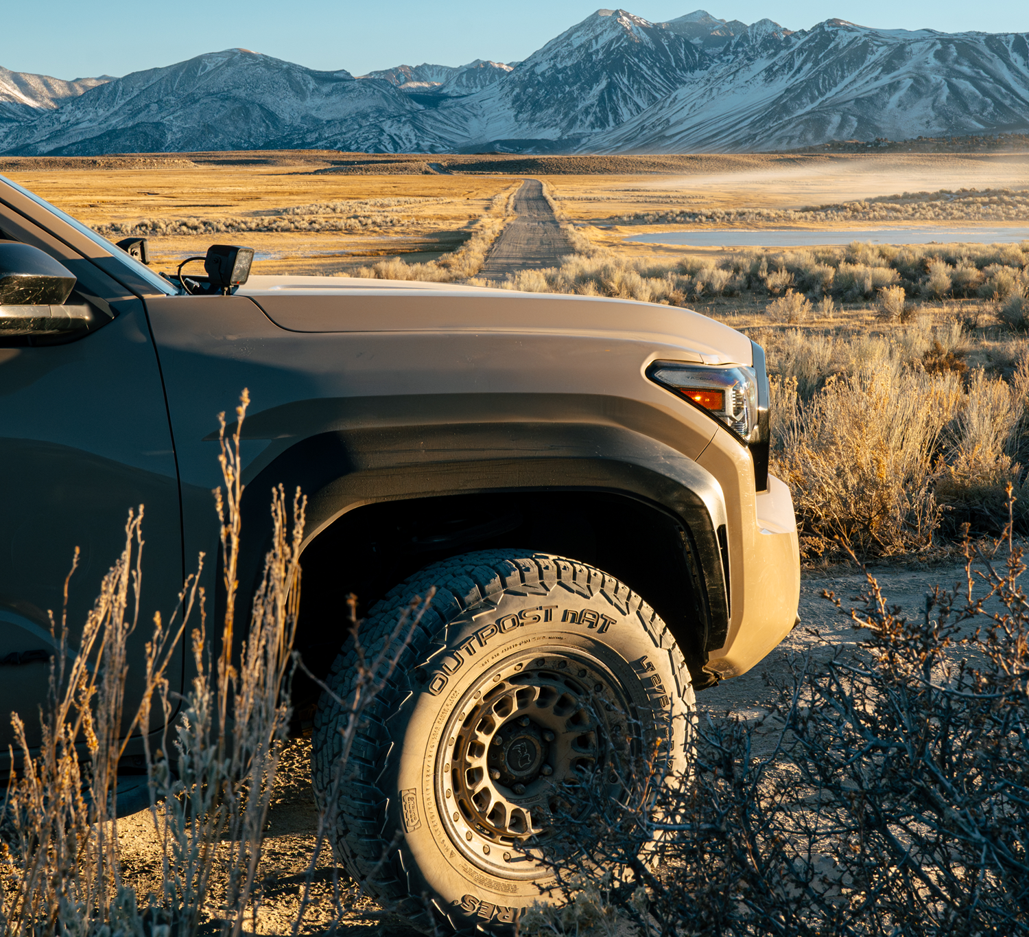

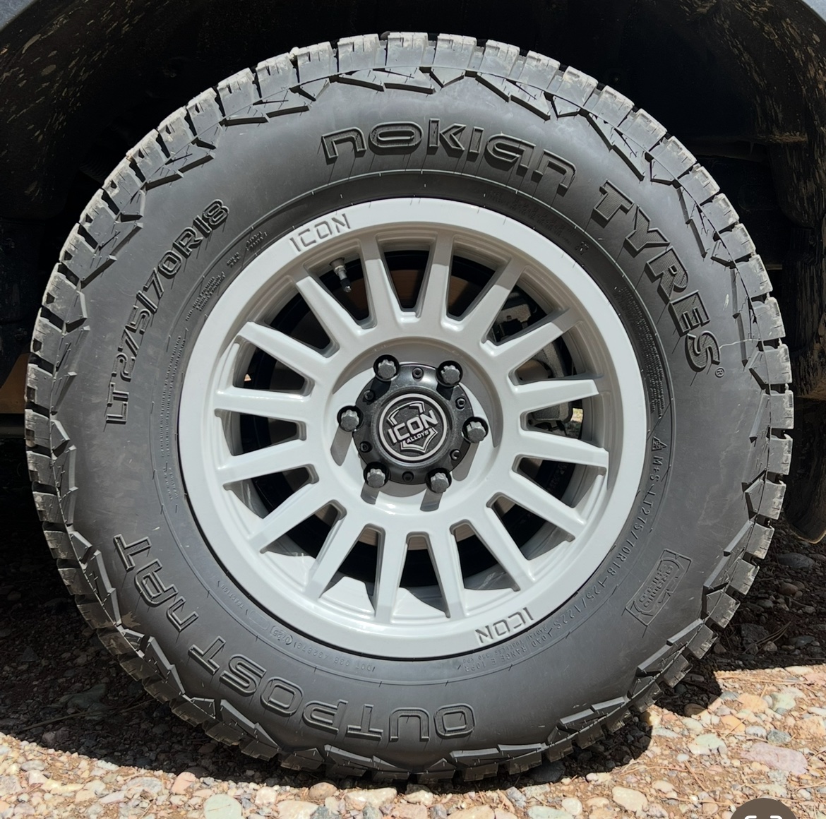

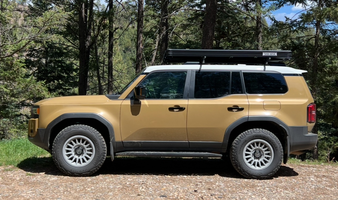

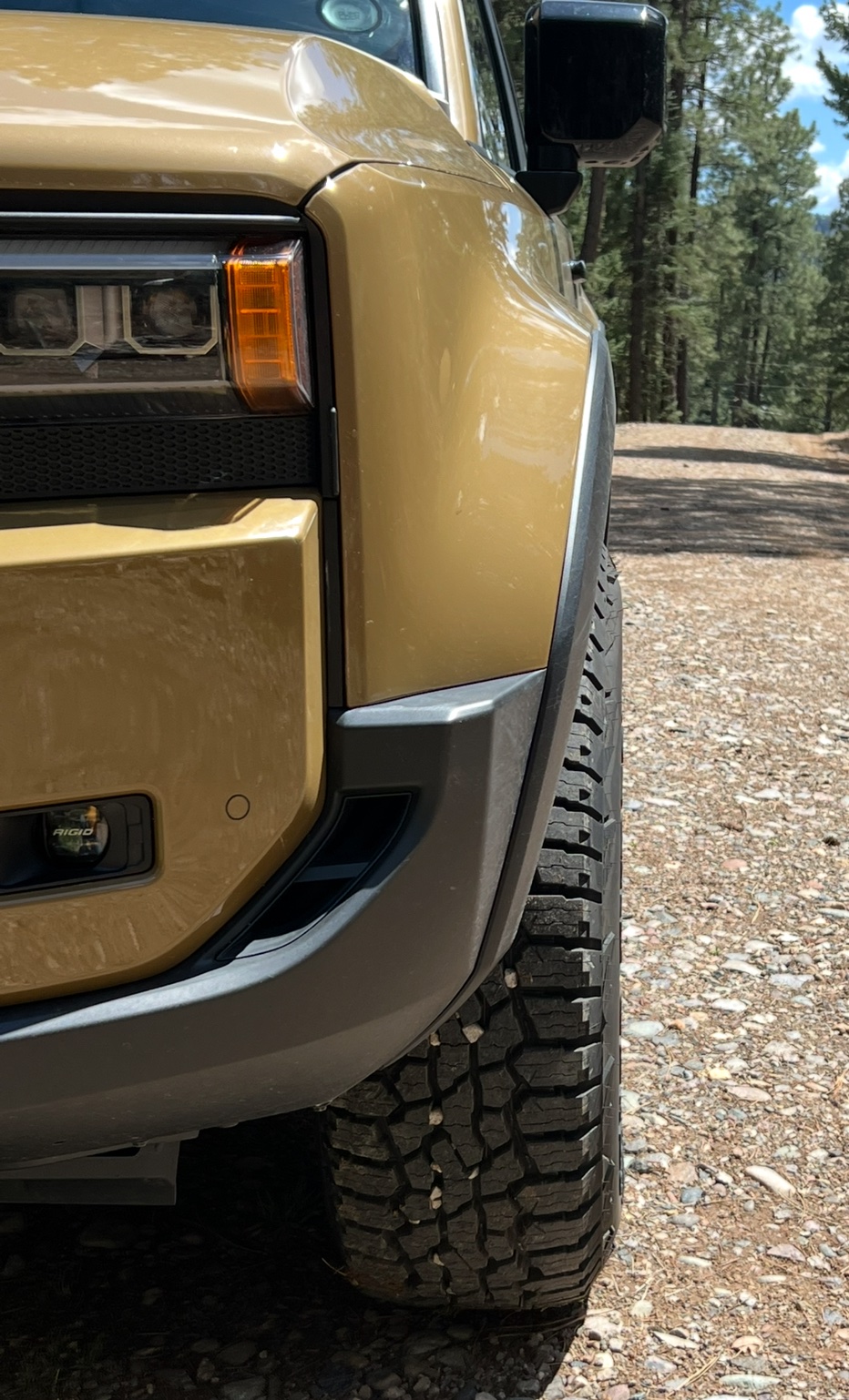

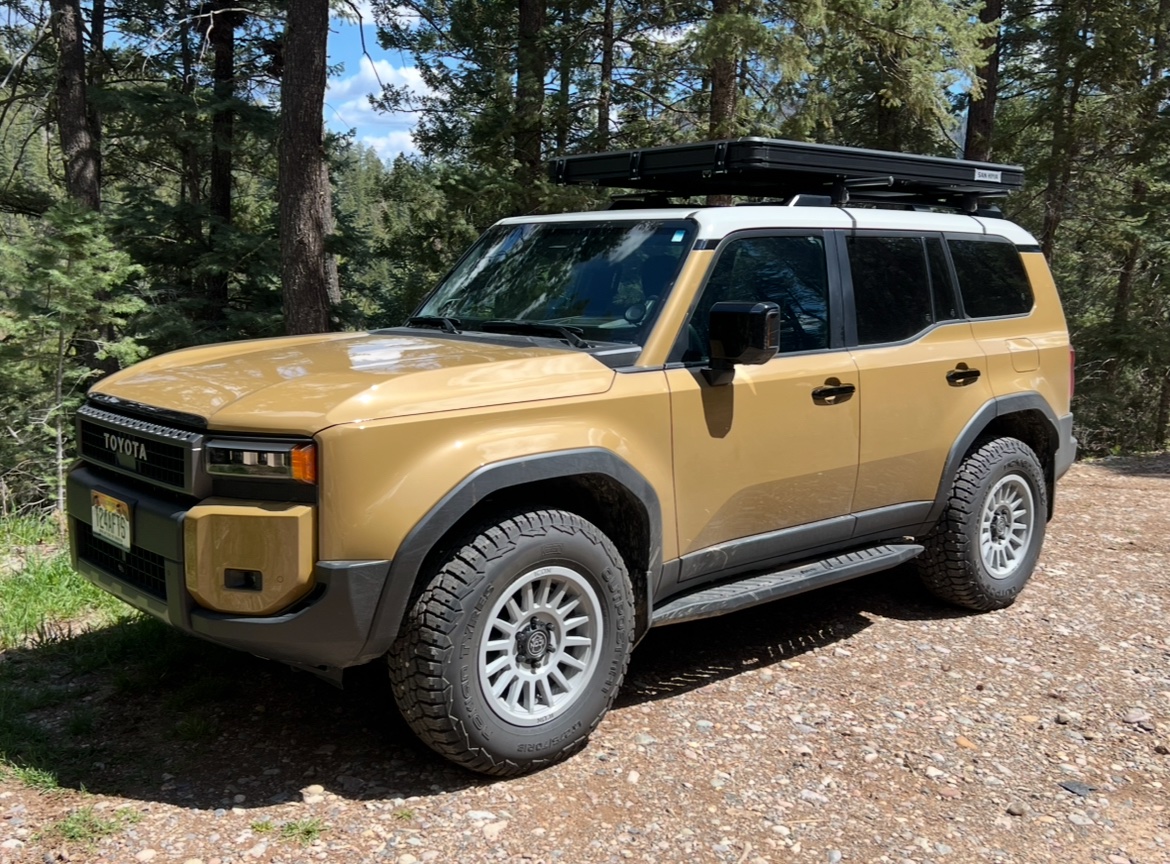

Summer wheels and tyres went on this week.
Icon Recon SLX 18x9” +40mm offset. Custom Powdercoat to match the roof. It’s a really light grey. I’m really happy with the results.
Tyres are Nokian Outpost nAT LT275/70r18
I’ll note this has about 450lbs of weight over stock as it sits in the photo.
It was important to me that the tyres are inside the top of the wheel well. That made wheel choices pretty slim as a +20mm offset is far more common. Factory offset is something like +53mm.

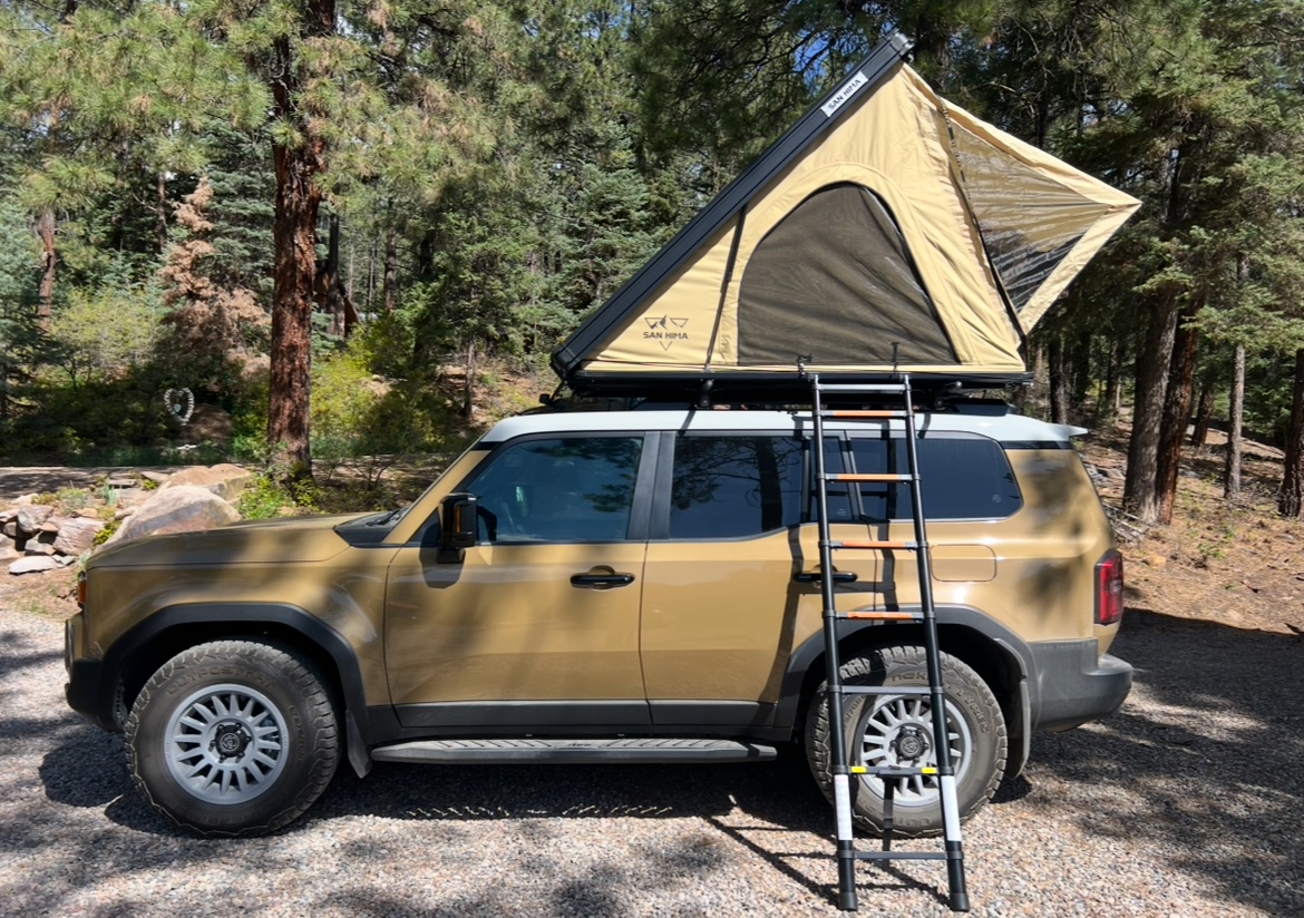

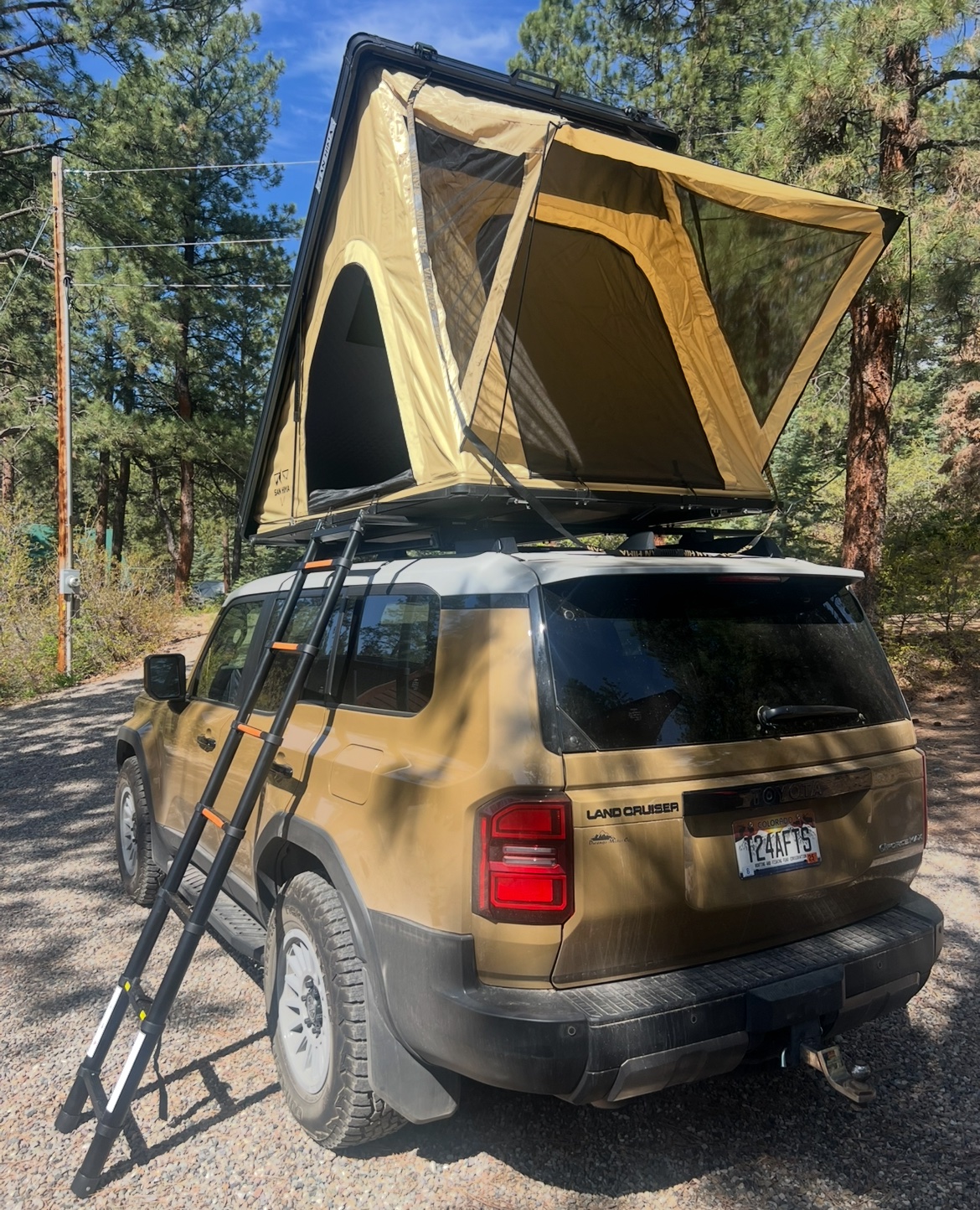

So obviously I added a RTT a couple weeks ago. With the Alaska trip coming up it was clear Bridger having his own tent is the best solution for the family.
This was the cheapest, lowest profile and lightest clam shell tent I could find. It was under $1200 to my door off Amazon.

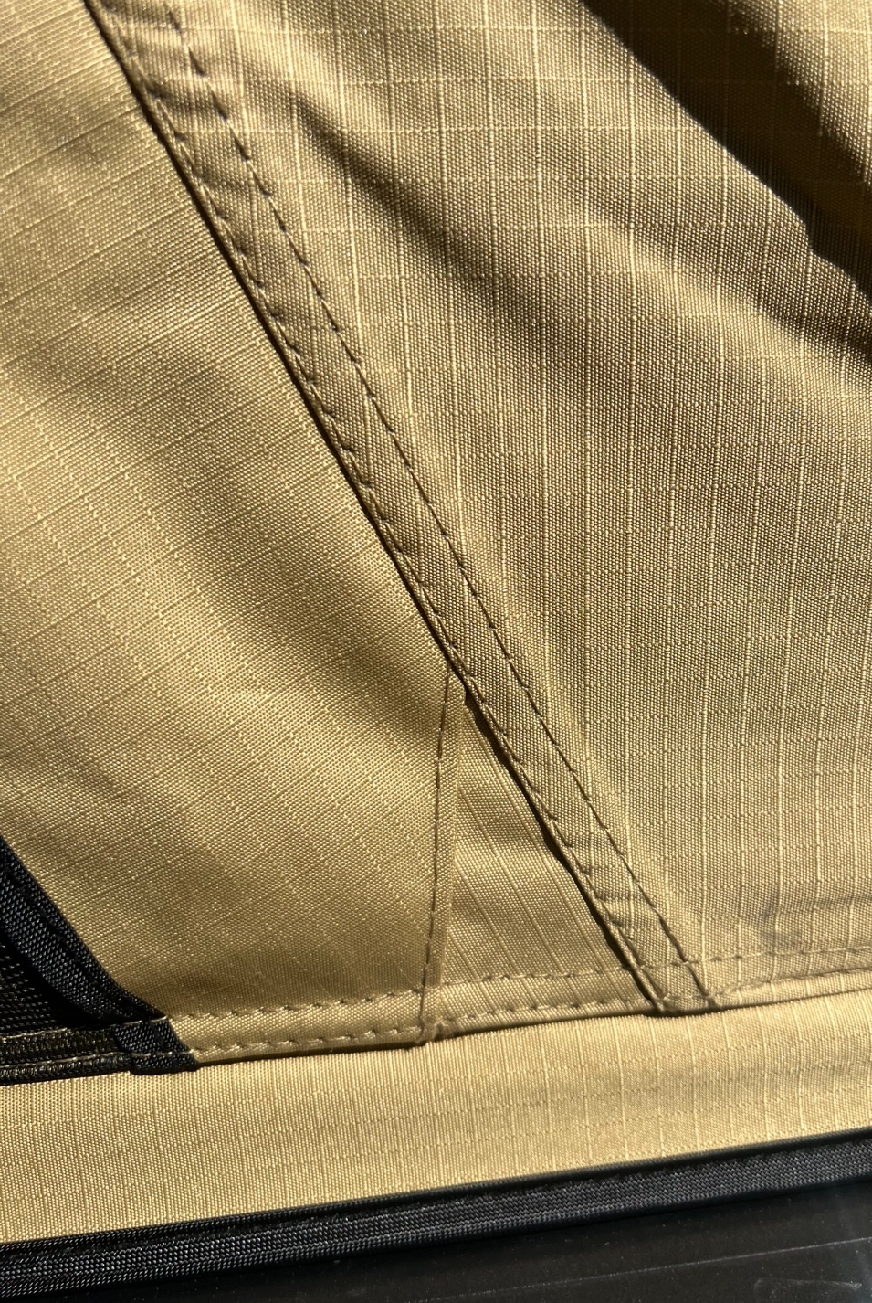

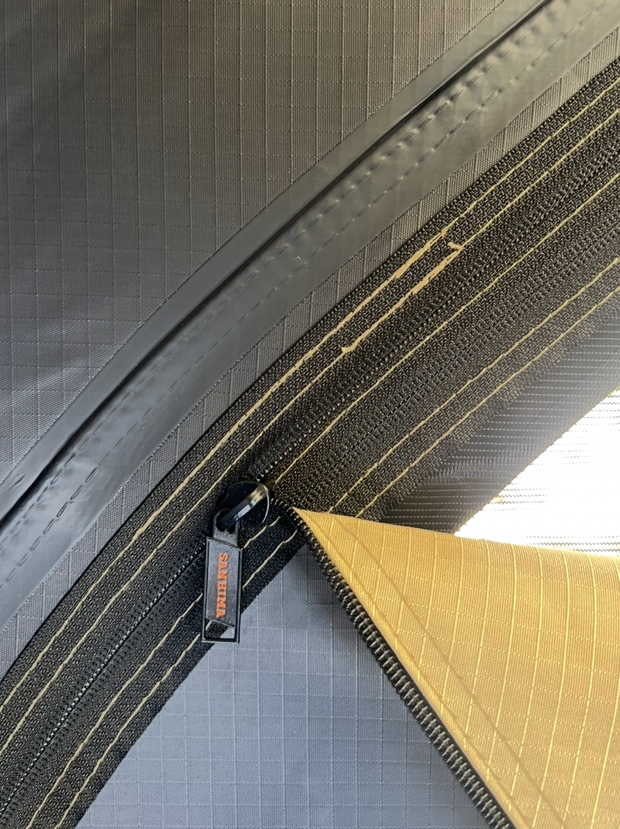

At only 4.5” tall and 135lbs it seemed to be the best solution. Seam quality appears very good. The fabric is a blackout design which is desirable for the endless summer days in AK. At 6’ I fit it in but definitely wouldn’t want to share. The 2” mattress is lacking. Adding a thermarest should offer decent comfort. Closing the tent with a lightweight summer sleeping bag, deflated thermarest and deflated camp pillow is a challenge. The ladder will not fit inside. It came with an LED light strip that should work fine with a small usb battery pack.
When we return from AK this may end up on my 80 for solo missions. That would save me the hassle of moving the big Eezi-Awn off the trailer all the time.
I don’t like how the doors fold at the bottom. You have to climb over the screen and fabric for entry/exit. Other than that I’m satisfied with initial quality and design.
I do like how the gas strut is enclosed inside the hard shell in travel mode. While you lose a little width verse other tents in this class I’m less exposed to damaging them on trees when wheeling.

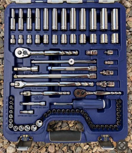

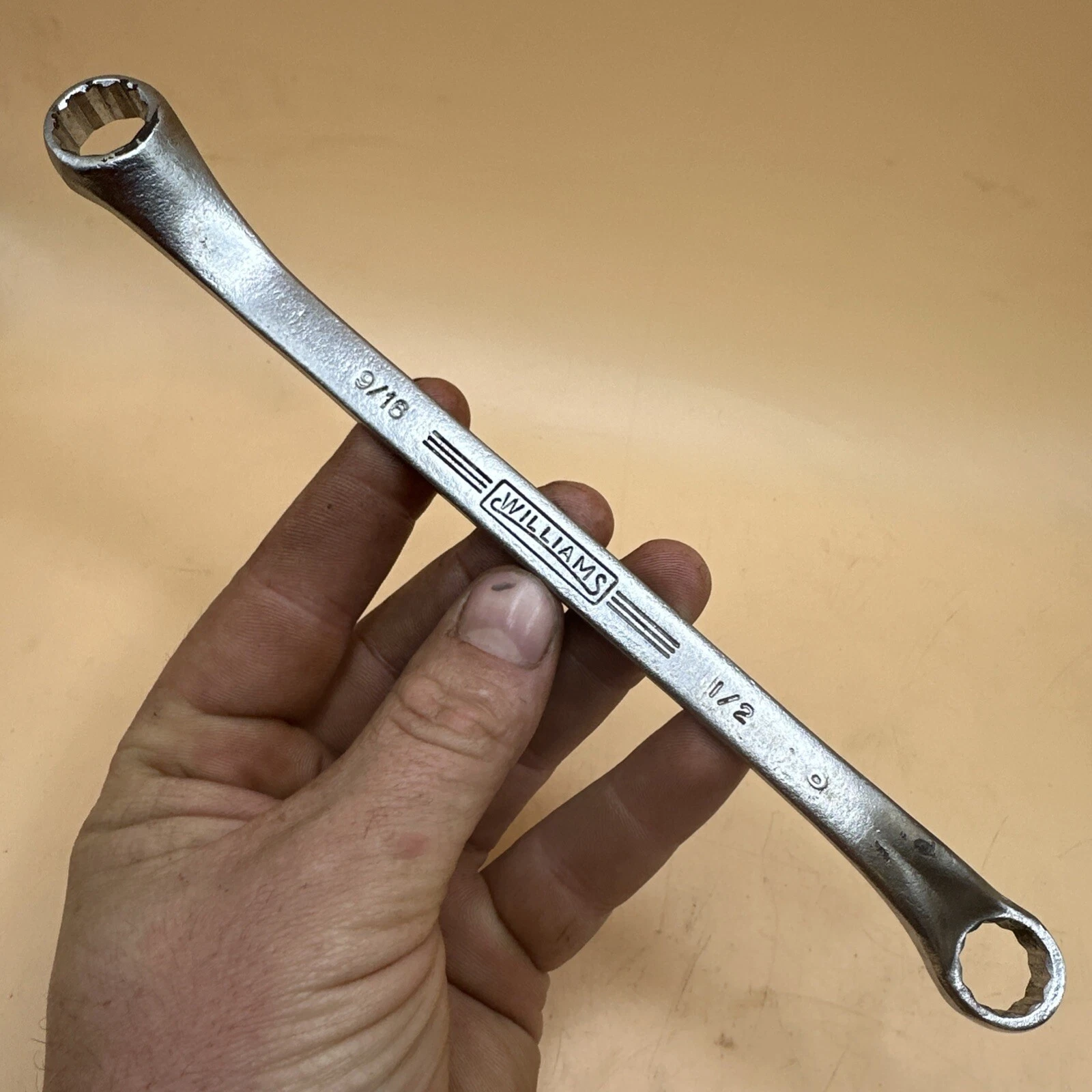

I hate moving tools/gear between multiple vehicles. Seems like I never have what I need. So I picked up a tool kit this week to live in the LC250. Williams is part of SnapOn. Marketed towards industrial applications they seem similar with BluePoint in terms of quality. Made in Taiwan. This is an all metric kit part #50611B.
Pretty basic kit with 1/4” & 3/8” drive tools. Box wrenches and screwdrivers. Should be sufficient for minor fixes. Hate not having any tools with me.
Blown plastic case. They rattle, might need a tool roll.
Lots of tools included

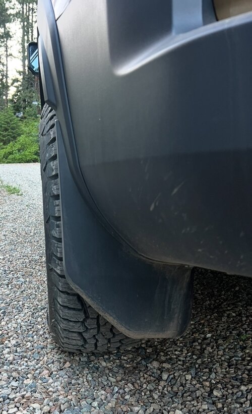

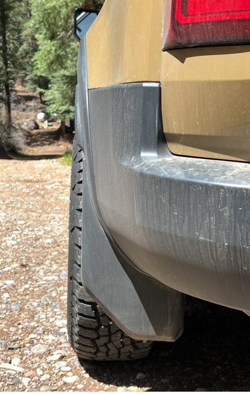

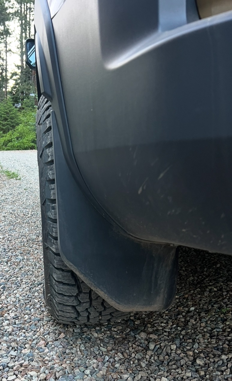

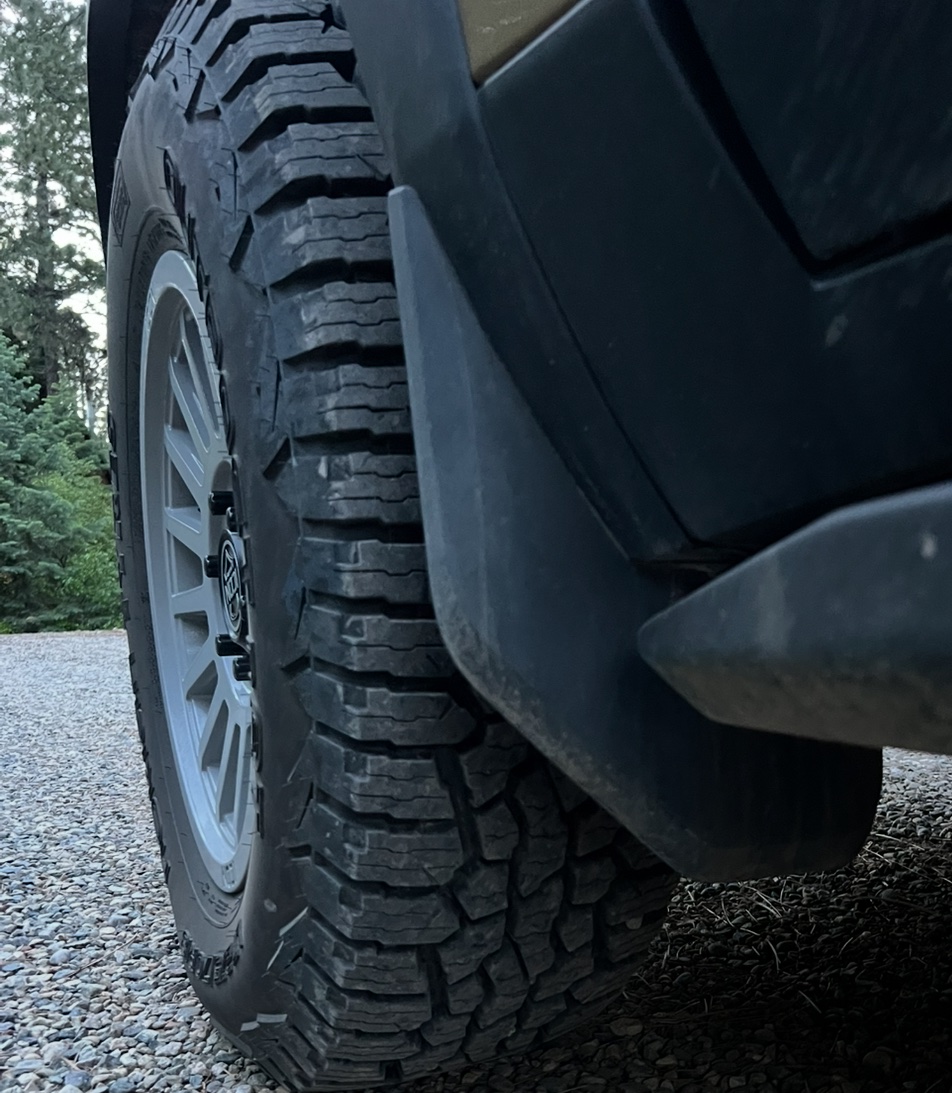

In an effort to save my trailer from rock hits I got some wider mud flaps. They don’t hang as low so it could be a wash overall. I have rubbed the OEM flaps on rocks wheeling. So should improve that.
Fronts
Williams is a brand of tools that has been around since 1882. The old tools are collectible. Williams got acquired by Snap-On in 1993.

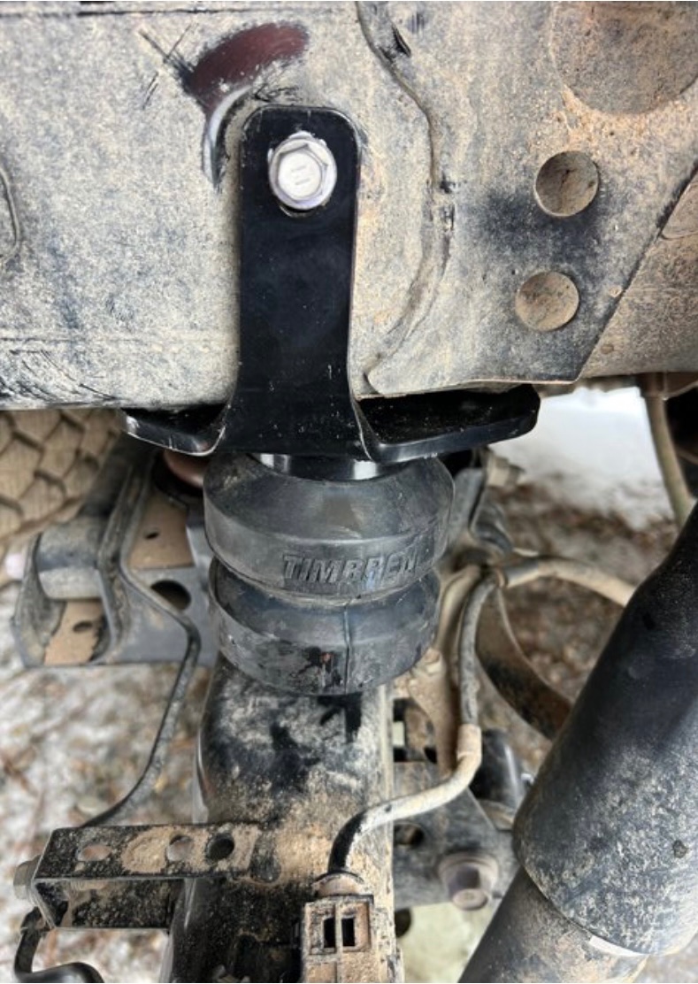

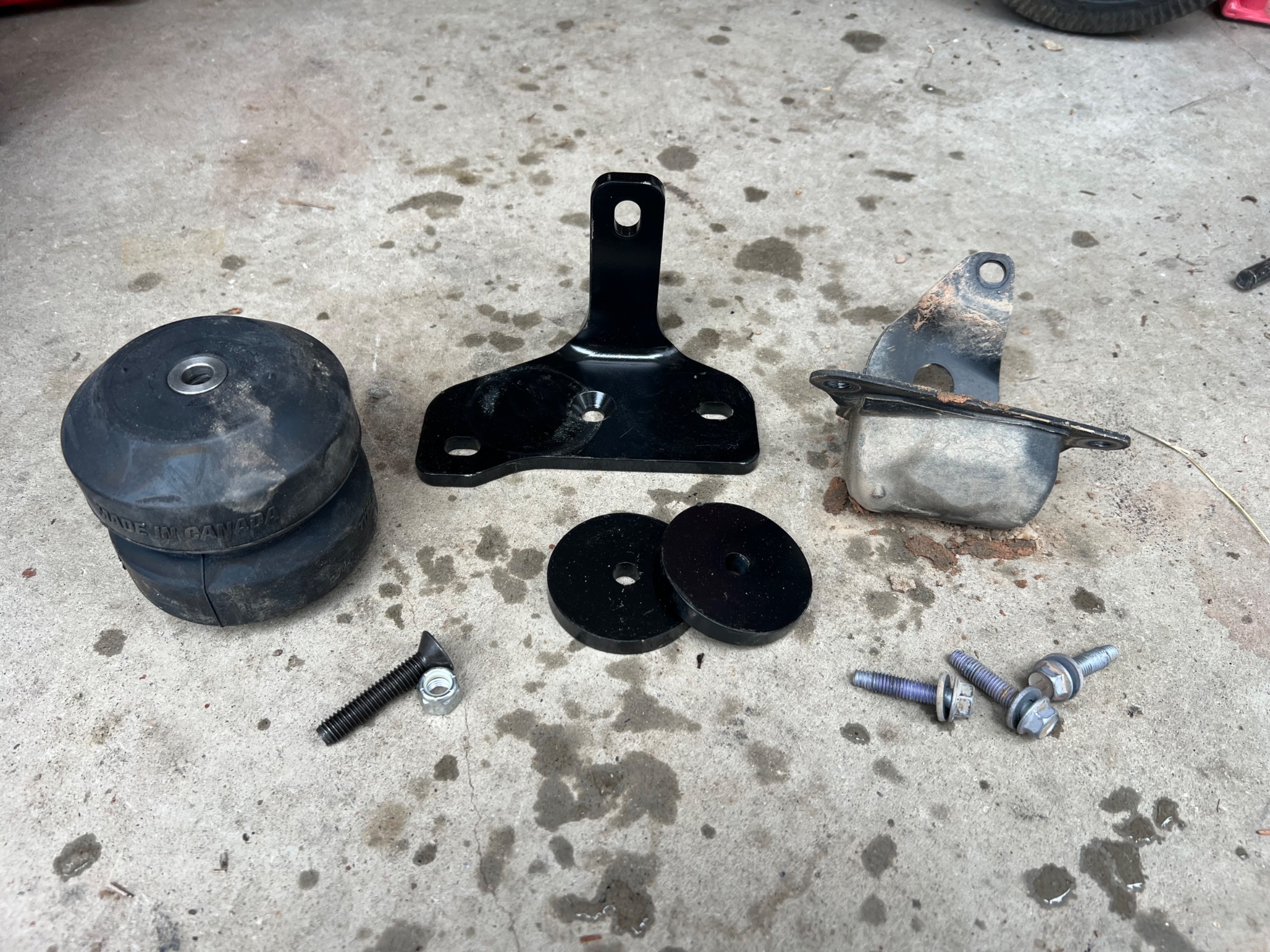

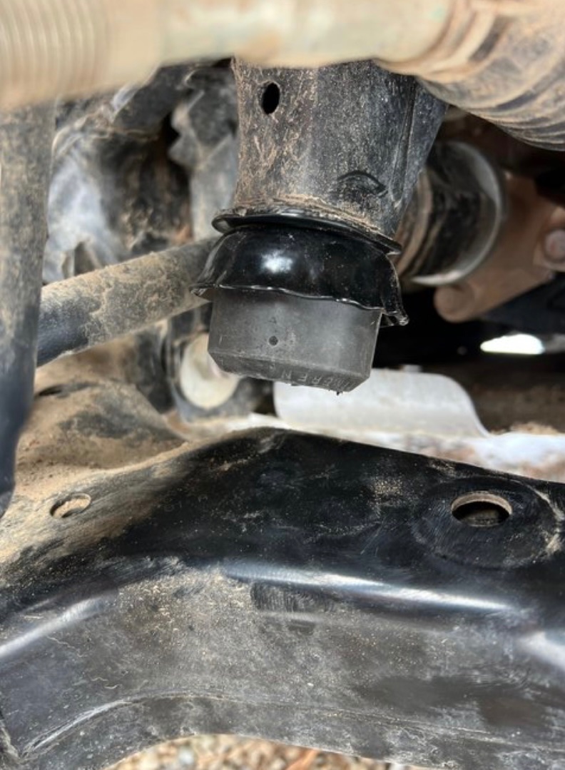

Timbren load enhancement and bumpstops.
I actually installed these a while ago and forgot to post but now I add feedback from the last 15000 miles.
Rears are designed to add load carrying ability and are working as advertised. Prior to adding them my Sasquatch trailer wouldn’t tow completely stable. It would wag the dog a little. Now everything is solid and the truck sits as it should when loaded and tongue weight is also added. Love them for what they are, a simple inexpensive solution. But I’d rather have longer stiffer springs that could take the weight. Downside of the Timbren’s is that they are super progressive in spring rate and the rebound can be more that the stock shocks can comfortably dampen
Front, I removed these after a couple days. They are simply too big for the stock springs. The weight of the truck is always on them so they are acting more like helper springs and the shocks can’t slow down the rebound making the ride quality poor. With a longer spring I assume I’d like them.
At some point I assume that I will swap in some stiffer springs. But I don’t want to ad more than 1” in height. Plus some Slee/ADS shocks. The Alcan was hard on the stock suspension. Way too much for it and I’m spoiled in the 80. I don’t plan to wheel this truck hard but would still like to hits stuff at speed without bottoming it out constantly.

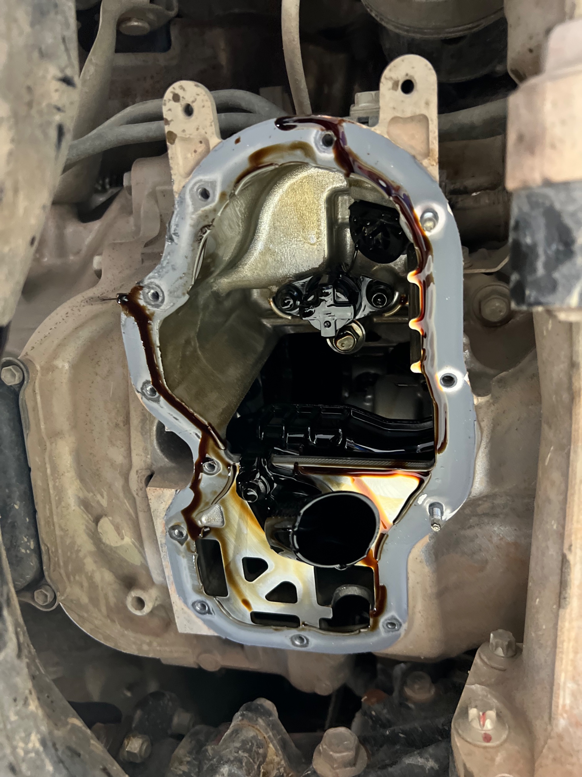

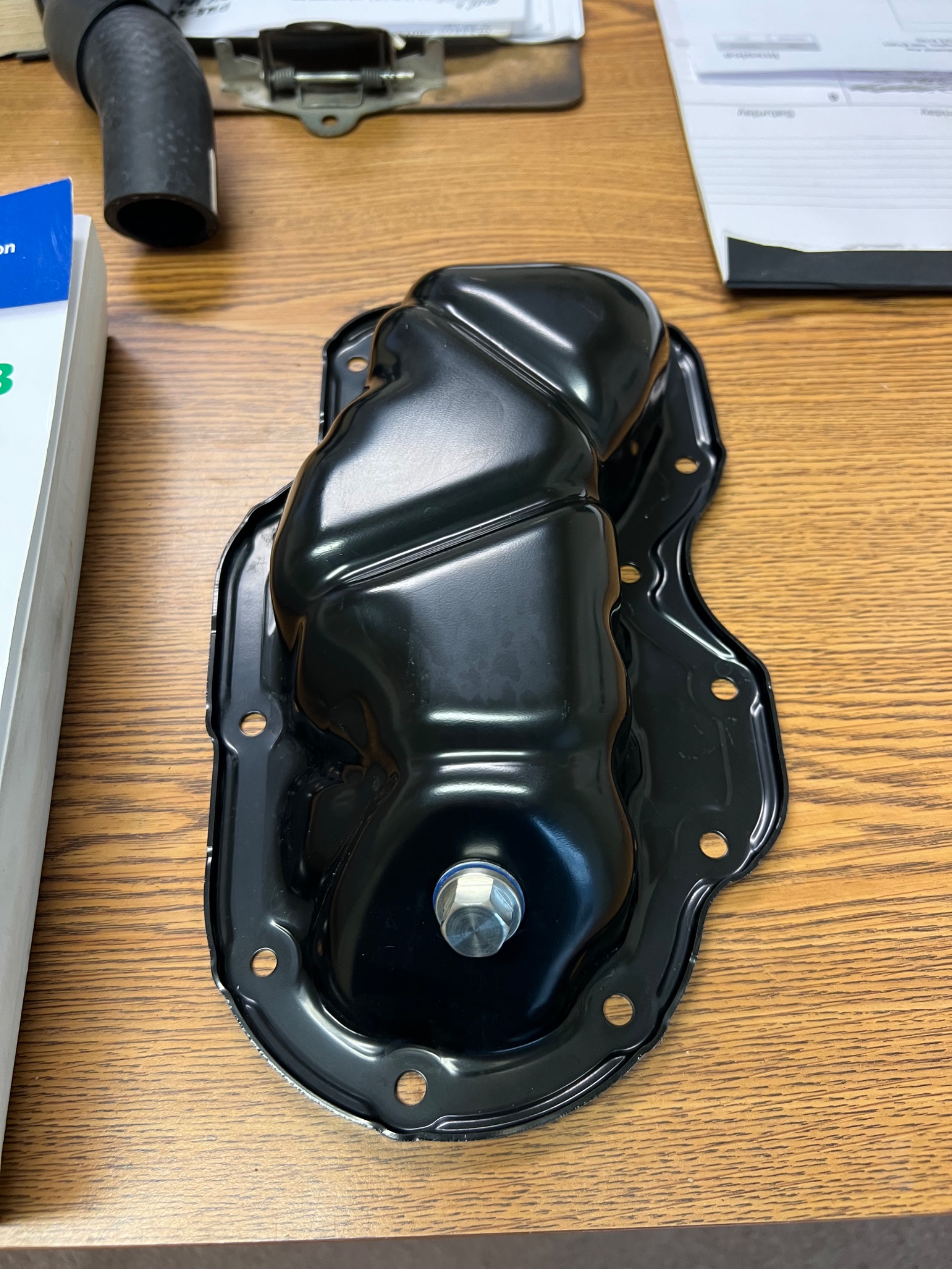

Thats neat you're in the milepost!!!! Why did you need a new oil pan?
10,095
Kendall Toyota of Fairbanks stripped my drain plug during the 20K service. I’m just lucky it held oil all the way home. I didn’t know about the damage until the 25K service. Then out of a stroke of luck Bill (Bill’s Toy Shop) was able to source the only oil pan on the continent. My local dealer said they couldn’t get one and didn’t know when on would be available. Bill is like the Robbie of New Mexico and is located in Farmington. He was the one who built my 1FZ.
Wow that's insane! I stopped going to the dealership for oil changes because of stuff like this and have been using a highly regarded local indy shop for ~5 years. The last time I dropped off my 80 for an oil change at the indy however, they kept trying to upsell me into a very expensive "comprehensive" inspection. I declined, they called back, declined again, then I finally relented for a less comprehensive inspection because they said they'd comp the oil change. I noticed they didn't change the little sticker in the windshield, and it appears they never touched the oil at all. And of course the inspection had a laundry list of things on it that were "critical" - even though most of the items they found had already been replaced within the last 10k miles. It seems nearly impossible to find any competent and reasonable shops these days!

I generally change it myself. But we were on the road and I had my "free" services to use so I did. Marianne used to ask why I do all my own vehicle services. She learned long ago why, this just reinforced it. The experience kind of sucked but it would have been much worse if I couldn't get a new pan. I called Kendall's GM directly and her service manager agreed to pay for the repair without much resistance. In hindsight it kind of explains why it took the guy so long to do a simple service. At this point transmission services are about the only thing I don't do myself, well depending on what vehicle we are talking about. And the last time I had the Outback's CVT serviced the pan starting leaking shortly thereafter.
Bill did a great job with the replacement. Took steps the dealer never would have like pull the pan at the end of the day and let it drain overnight so that he could get a good clean service to reseal with the FIPG. I'm sure the dealer would have pushed this out the door in under 2 hours and I would have had a weeping pan. He was happy, he got full book for the job. Would have charged me half that if it was out of my pocket. Bill discovered the drain plug had three crush washers on it when he forcibly removed it. I changed the oil prior, and can confirm that was not the case prior to my visit to Kendall.
I'm having the Nokian Outpost installed tomorrow on my 2026 LC. Your post was good info..thanks.
