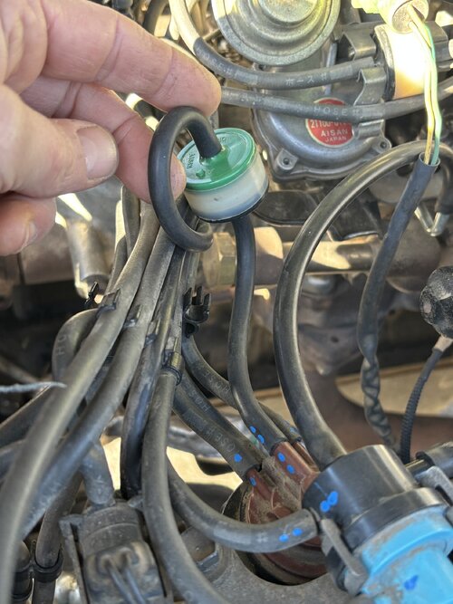

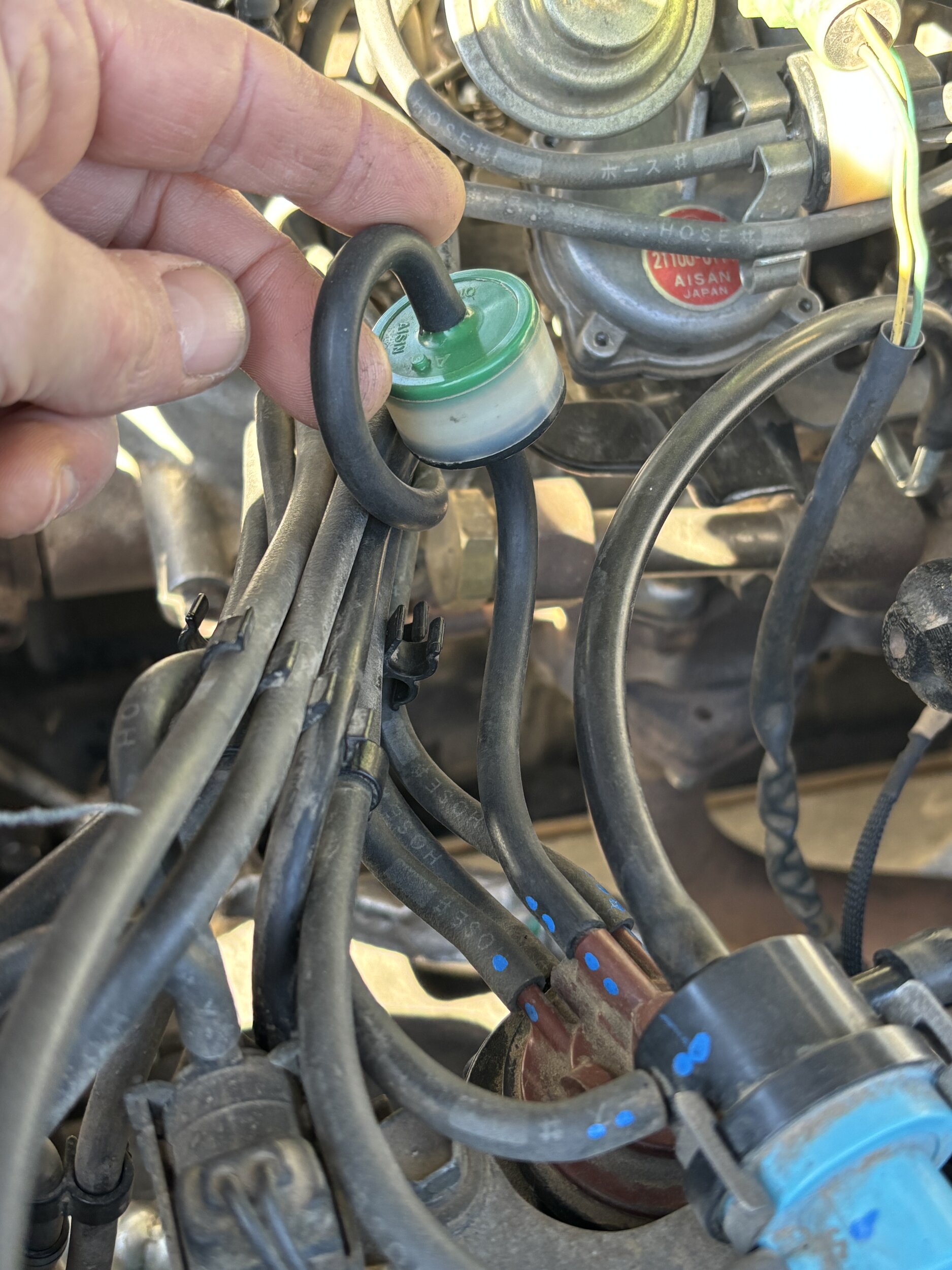

As far as vacuum routing all I have is.
1. Brake booster
2. Vac advance from the distributor
3. Gas evap (right now just venting to air)
Evap canister is probably bad anyway if it’s original, replace with AC Delco, I think it’s the VC-120. Takes some creative plumbing which is spelled out on Mud.
4. PCV (venting to air, soon back to the carb hat)
5. The big line from the left side cover to the carb spacer. I do not know what that one does!
#5 is evap. If the black & white valve on the drivers side is still in place it’s guaranteed bad and leaks vacuum. Get the black/blue 80 Series valve from City Racer to replace it. Did I say that already a few posts above? I forget.
The distributor vent system is worth reinstalling. Otherwise the dizzy apparently generates ozone (O3) inside which causes corrosion. That’s per Chenoweth, hidden somewhere deep on Mud. The valve for that is another black/white vac thing exactly like the evap one over by the carb, it normally clips to the underside of the air cleaner above the dizzy and has some other plumbing that you can find in the FSM. You’ll have to find a new spot or fab a bracket for it with your new air cleaner setup.
On the carb side. Is the one electrical connection on the AISIN carb a thermosensor for the carb fan?
Fuel cut solenoid. Necessary. The other end hangs below the carb fan when it’s not connected.

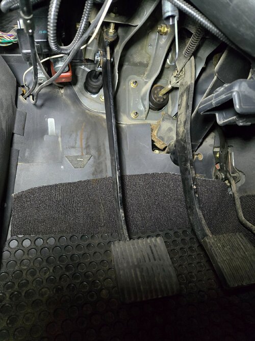

Throttle linkage looks complete with nothing removed for the weber.
The horizontal rod between the firewall hanger/bracket and the carb has two arms coming off of it. Short arm towards the firewall, long arm at the carb. If it’s backwards your acceleration will be dismal! Also I found recently that my long arm had somehow gotten bent and was rubbing on the throttle return spring on the carb - in fact it was getting stuck. Sticky throttle are exciting! Keeps you on your toes! Just make sure that when the throttle rod operates that it’s clear of the spring.

I thought the HAC circuit is an on/off arrangement rather than something that continues to adjust the mixture as altitude changes. The switch over point is something like 3500 ft so anything from Denver to a high mountain pass is the same “high” altitude setting. The truck could likely be set up to run well without the HAC. I wanted to to have all of the OE systems intact so I kept it.
3,132
It has seemed continuous to me above 4000’. I drove to Omaha a couple years ago and watched my A:F gauge like a hawk. The change happened at almost exactly 4k’, just like the manual said … but it was slowly changing prior to that. I think 4k is fully closed off.
Replicating the HAC changes are easy for the dizzy. For the mixture it requires changing jets. As it stands with my stock jets, I can “tune” the HAC with VTVs on the vac line- much easier than swapping jets when I drive to the mountains.
I carry a green one (50cc) and a red one (25cc, out of 80s mini trucks) depending on how the A:F looks. Or, above a certain altitude, I just run a straight hose. I keep the VTVs in my door card pocket and they take about 30 seconds to change.
The other vac hoses on the HAC also contribute air to the carb post-venturi, but the top one flows the most air.

That is correct, it is on/off. IIRC from the factory emissions manual, it is set to add around 3° of static advance at about 4,000 feet elevation, so pretty much anywhere in Colorado it is advanced.
Generic knowledge: Old school distributors (as in pre-computer controlled) have three ways to advance the spark timing. First is static advance, which is where you rotate it in your F or 2F engine and then tighten it down. Second is vacuum advance, which is controlled by whatever is making the vacuum. Some stupid years had a vacuum RETARD which is stupidly retarded, but was for emissions compliance. Third, and here's what Jim (@Cruisertrash) is talking about above when he refers to "curve" is centrifugal advance, where the spark timing is advanced by RPM, and this varies a LOT and where Jim Chenoweth's expertise is, pretty much expert.
3,132
I have had a number of phone conversations with Jim and among the subjects was the factory venting on later 2F distributors. He never said anything to me about ozone or corrosion, but rather that the factory setup, where the clean side of the air cleaner housing (which always has a somewhat vacuum whenever the engine is running due to the difference in pressure from the clean side to the outside) sucks air into the distributor cap which comes from a hose that comes from the glove compartment. This is mainly to keep the high voltage cap area dry!
Like I said, the ozone tidbit is something I dredged up from the long-ago depths of Mud. Whatever the case may be, the dizzy vent system isn't "evil smog equipment sucking the power from a 2F" - it's harmless - and I think too many people rip it out when they desmog. They see a vacuum hose and they start seeing red and foaming at the mouth.
HAC advance is 6 degrees per the manual. I know that supposedly the valve is either on or off, but in my real world driving experience with an aid/fuel gauge I've seen it have some variation within the "open" setting. That's with two different HACs in fact. It could have something to do with how they operate as they age, I don't know.

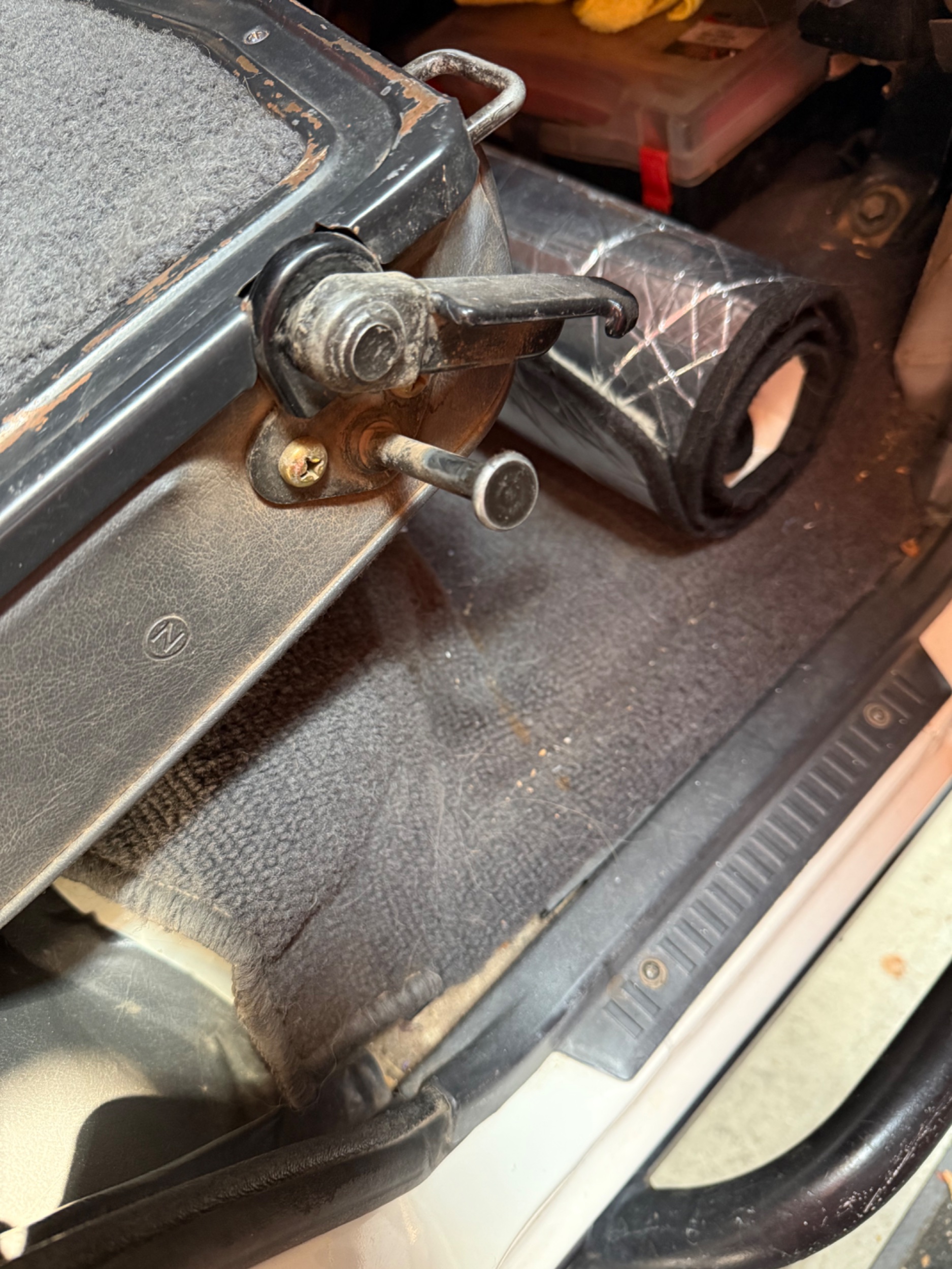

Is there supposed to be a rubber bumper on the rear seat upright latch posts? These things murder my shins whenever the seats are down.
3,132
Nope, only on the catch where those posts lock into. Reproducing those little rubber things is what accidentally started my side business making Cruiser parts!
You can try wrapping those posts in something - fuel line taped on perhaps - but that precludes using the original bumpers (or my repros).

My original had some sort of fabric tape. I wonder why not powder coat it? hm.

I dont mind the bare metal. I just always forget about them and they poke your shins really well.

All the posts were originally painted fwiw. The paint may have had a slight texture to it, but I haven’t ever seen fabric tape on them. Where did you see it? Maybe that only happened for a small year range and I’ve somehow missed it.

@KC Masterpiece I’m not able to look at my ‘87 right now but the picture of your back seat latch pin does not look like a stock part. The picture of the 62 version looks like what I remember mine to be. Anyone else with a late model 60 to verify? What do you think @Cruisertrash?
