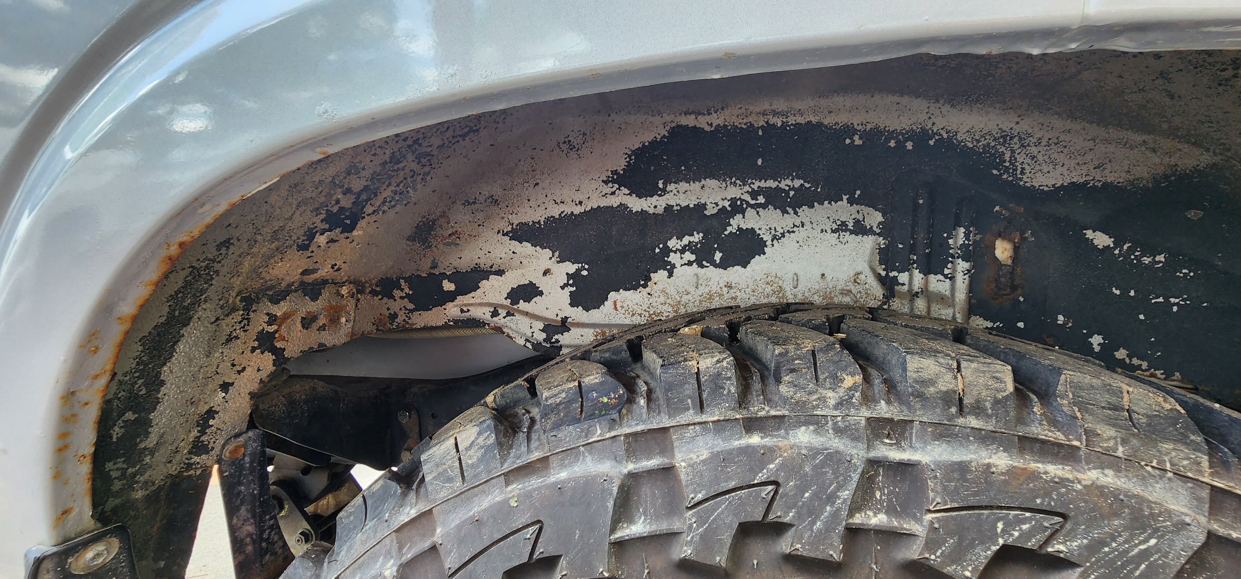

Thanksgiving weekend we gutted the truck from the windows down. There was no observable rust or bondo work on the roof so I opted to leave the headliner in place. The headliner is in great shape and I did not want to deal with the hassle of pulling it. I did consider the need to add sound deadening to the roof, but I assume that 90% of the road noise translates through the doors, floor, and rear wheel arches.
Here is a slathering of pre body work photos showing the worst of the rust areas. This will be a photo heavy thread.

Interior after everything was pulled. Note the big old rust holes at the rear seat mounting points. This is where the rust came through the body near the wheel well spot that Jason calls the "fingers". Now I know where all the road noise was coming from on the long highway trips. Thankfully there were no additional rust spots discovered on the floor.

Day 4 - 8hrs.
Some surprise bondo work on the fenders over rust. Clearly the prior body work was done in a rush. The work here rebuilding the fender contour really impressed me. Jason also found a bondo repair behind the driver rear mudflap.
