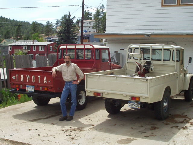

Before I sell mine (yes I intend to when I buy my 250 series this year) we should do a side by side photo shoot, just as Steve H and I did with our 45s in my driveway several years ago. He remarked that his beautiful 45 was too nice to drop a load of wood or gravel into the bed as mine was rougher. Remember that Steve?
Kevin I just noticed your odo at 164k. When I bought my rust-free Arizona truck in 2011 it had 163k. Mine now has 220k and you've seen what that much mag chloride has done to my frame. It took many hundreds of thousands of more miles to do that to the body of my 1976 FJ40, but the frame on that one wasn't near as bad since back in those days they just used conventional sodium chloride.
