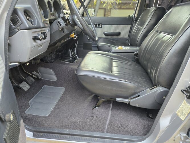

New front belts and mid carpet complete.
Working on the front this weekend. It has been very slow going with small cuts. I am terrified of messing up the shifter hole locations. A few hours in and I just can't get it to lay right on the passenger footwell. Any carpet install tips? I am sure this is fitting a bit different being aftermarket and with the 1/2" of deadening product. Even if the fit is not perfect it looks way better than the old stuff.

No tips, just watching so I know how to do it when the time comes. Seems to be a lot of info on Mud from folks who have installed the “dnp” carpet kit (same product as other places).
Also … you ran 240 miles in 74 hours straight? Is that what I’m reading? I’d be delirious! Quite the feat.
Thanks! I have read all of the threads on Mud. Just fussing trying to make it perfect. It wont be, but its being refeshed for use, not to be a garage queen.

Mud is recomending removing the extea jute from the front section to help with fitment. Going to give that a try!
