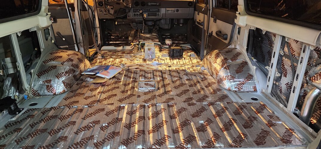

Kilmat done! Well at least the body. I will do the doors at a later date the next time I pull the cards. Tiny rust spots were all cleaned up and primed. That was quite a few hours of work.
Once I got less fussy about perfect seams and overlaps the process went way faster. Not 100% coverage but that is not needed for this product. There are just under 2 boxes of kilmat 80mm used in these photos.
