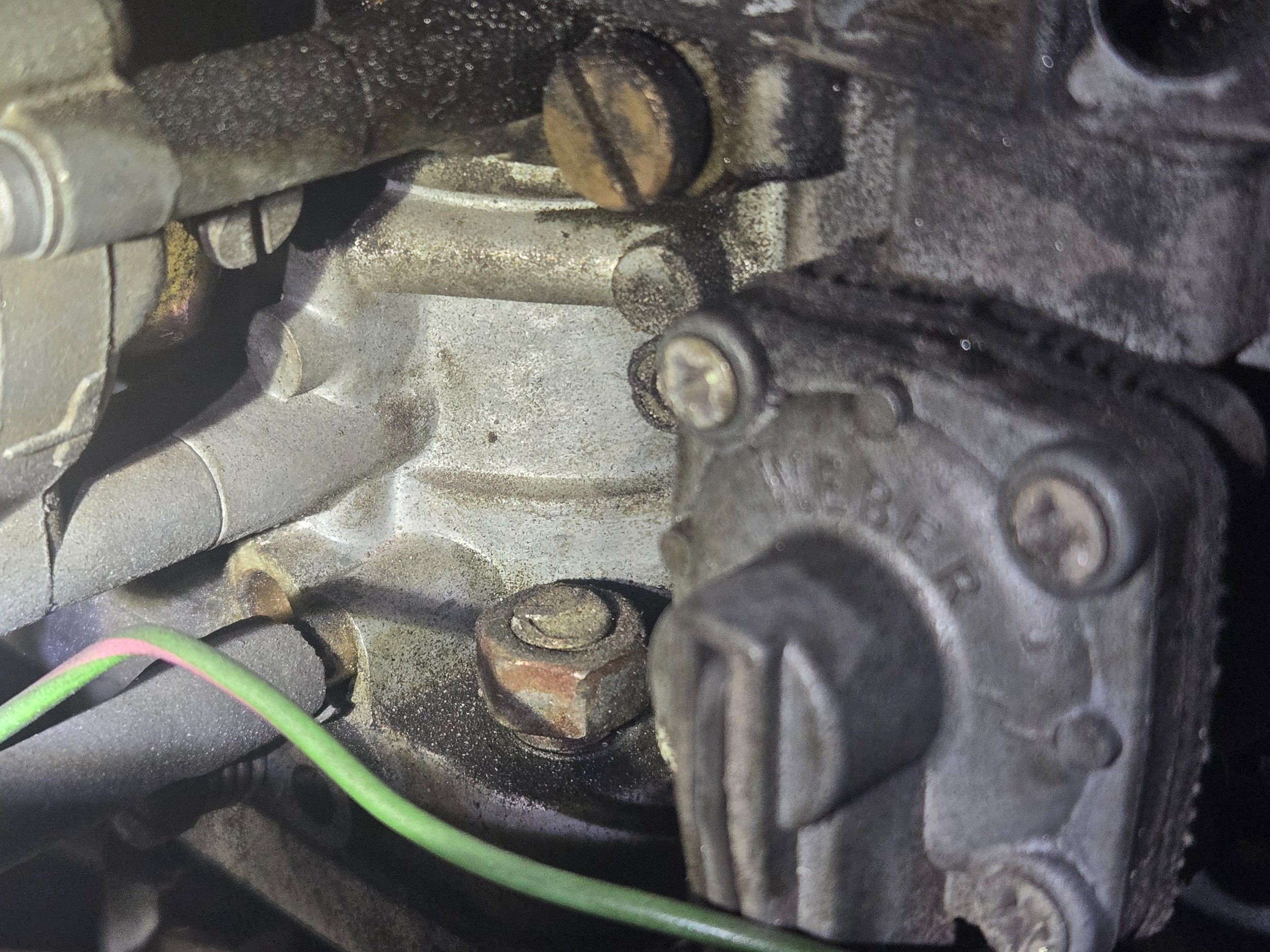

Drove home fine.
We have a few things going on. But I am going to classify this as a "contributing factor".
The other 3 were all finger tight...

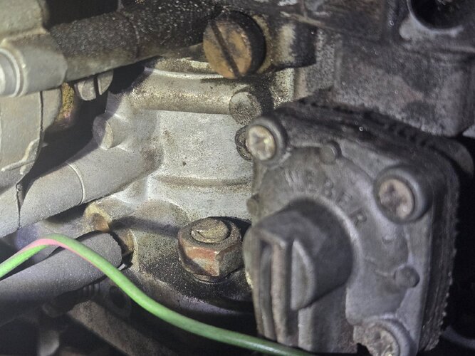

Turns out the truck runs much better with the carb actually bolted to the intake manifold.
Had that happen to me right as I got to the top of Imogene pass several years ago. Truck wouldn't hold idle and kept dying, but would stay running at about 1200rpm with the choke out. That was less than ideal trying to engine brake in 4Low down into Telluride. I would have much preferred idling down the mountain at about 700rpm, thank you. So I rode the brakes all the way down stopping at Tomboy to let the them cool down for a while. Got into Telluride and took the highway back to camp in Ouray and it took me about an hour to find three of the carb hold-down nuts spinning freely. Huge vac leak. Truck was right as rain once those got tightened.
I now check the carb nuts way more often than I'd like to admit.

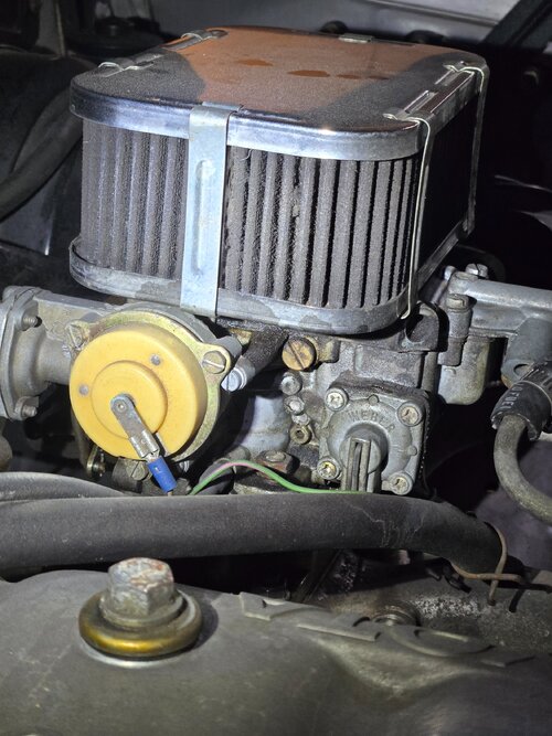

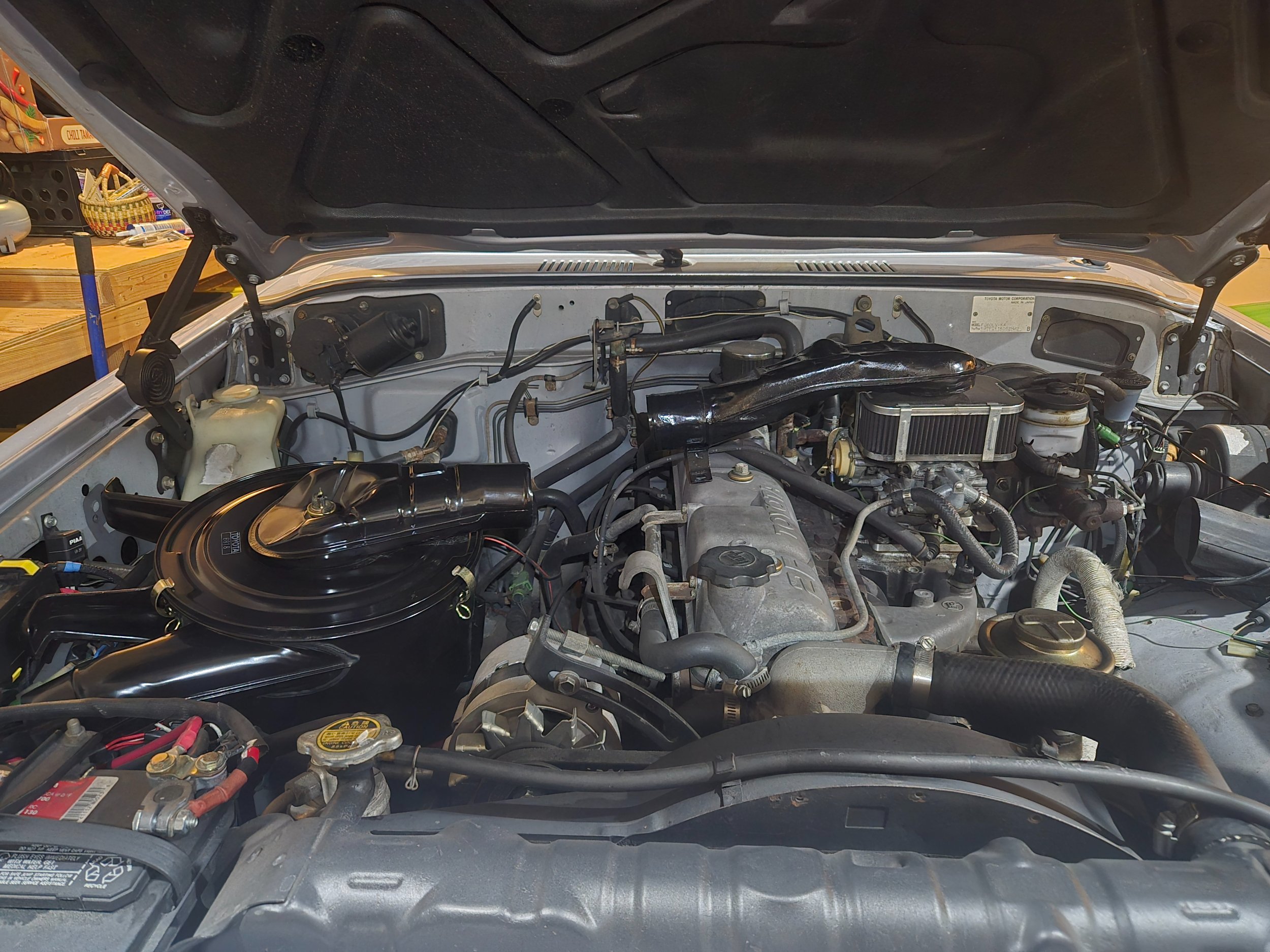

Slowly getting the last bits for the return to factory carb. Cruiserteq has just about everything else I need other than relocating the fusible like replacement kit. The ac lines might need an adjustment for the air cleaner to fit. Lookin sexy.
There are a few other odds and ends in the engine bay that are on my to do list.

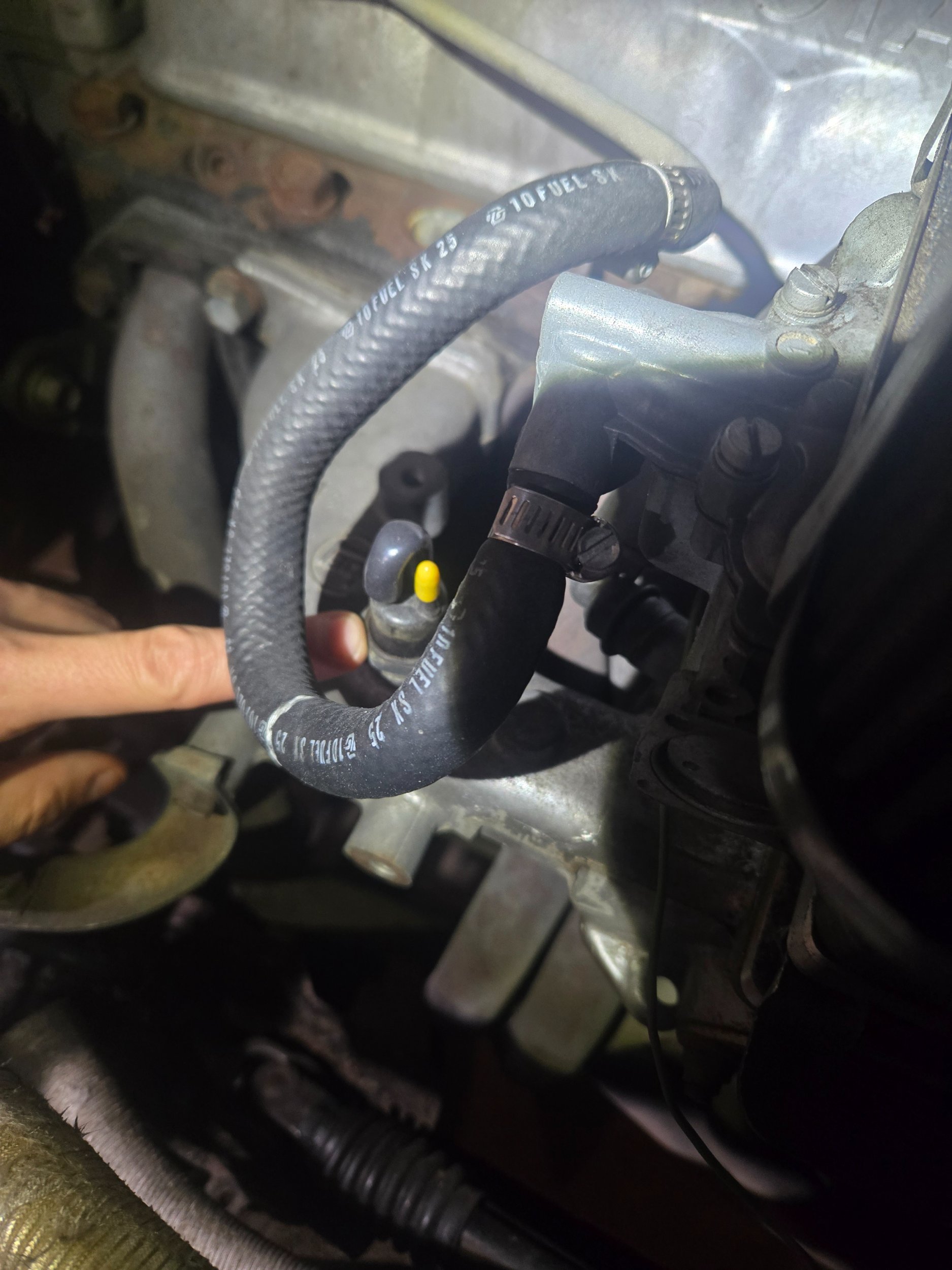

These hard line clips have some corrosion. Trying to source replacements.

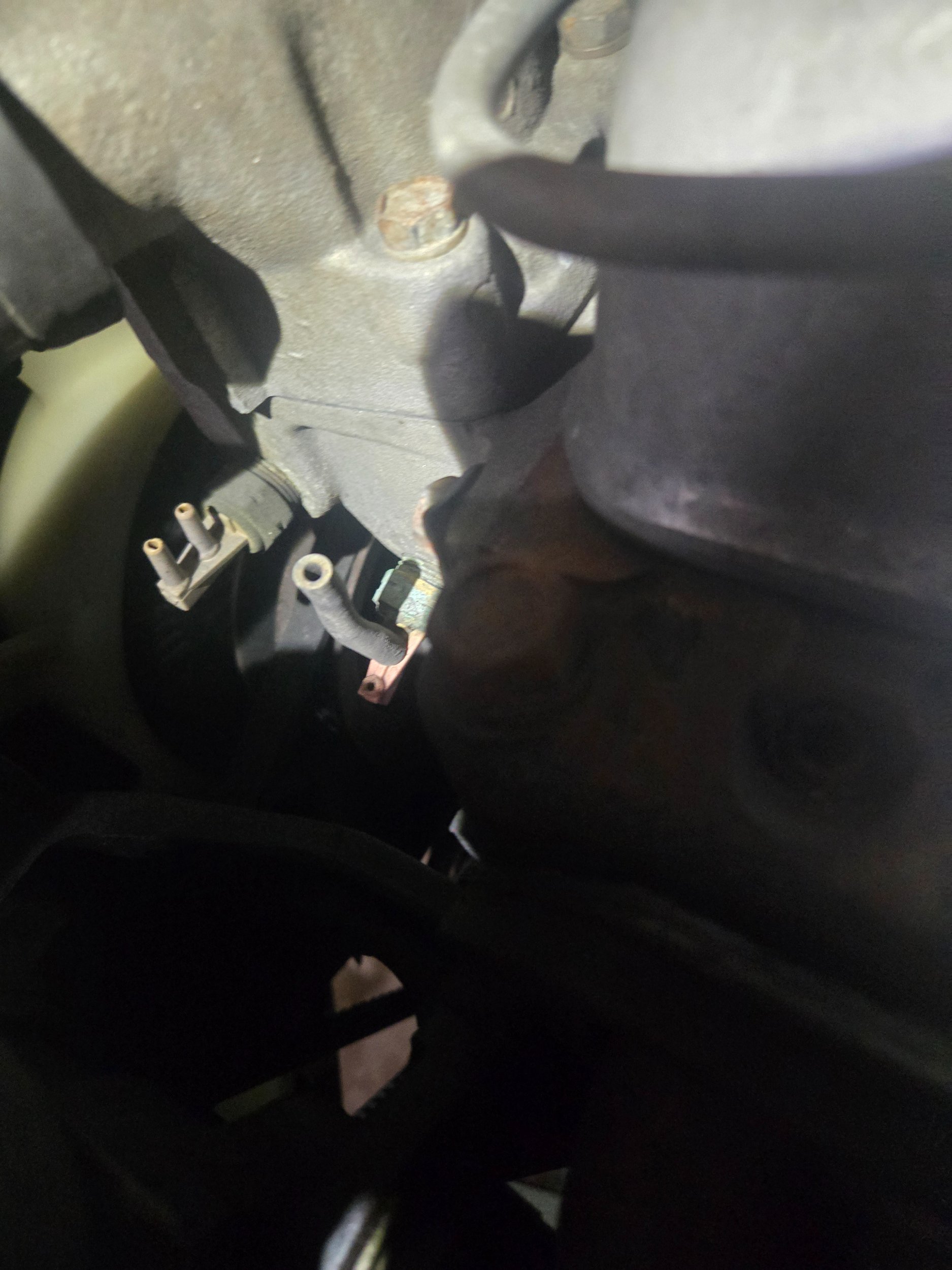

Also trying to locate a better plug solution for this port on the intake.
Ditto with these ports. There has to be a cleaner deamog solution out there.

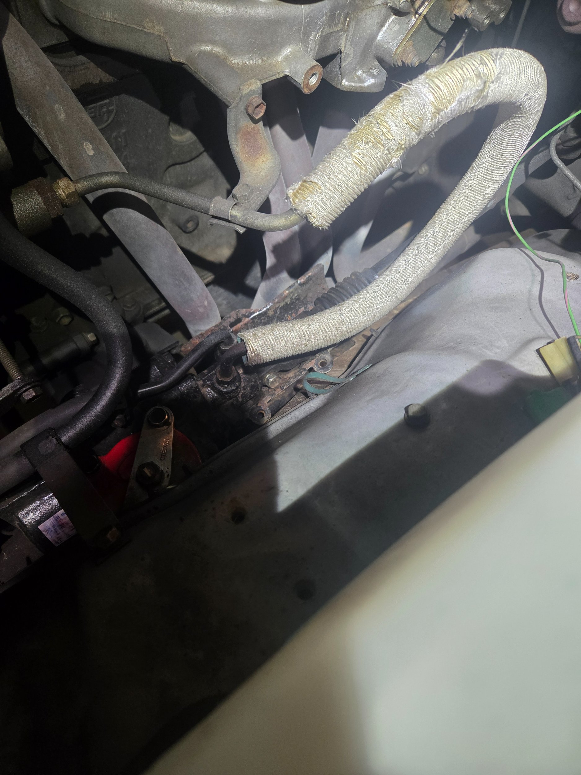

Need to modify the top half of the steering shaft cover to fit with the 80 box. Wondering if I should add some insulation on the lines being so close to the exhaust.

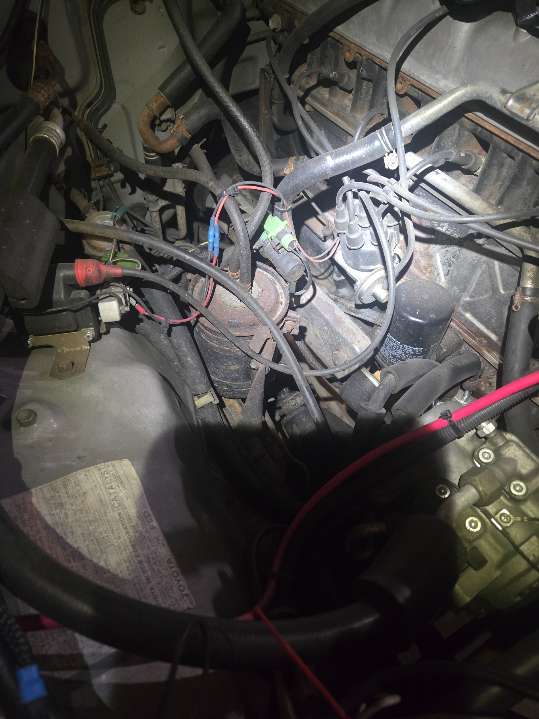

And figure out what's going on with the ignition. I believe this is an OEM distributor.

Toyota sells the intake vacuum source in different variations: one, two, or three nipples. Get the 1x variety. I don’t know the part number but Toyota calls those a “gas filter” and they’re on all the 80s vehicles.
The two BVSV ports in the t-stat housing can be plugged. TLC Performance sells some plugs. I suspect they’re Toyota parts though, line the air rail plugs for the head.
The ignition wiring looks like some monkey business. That green connector with the spade in it - there’s two coming off the igniter and they’re opposite, one male one female. I know one drives the tachometer. The other I think is the signal for the dizzy to fire maybe.

Engine is original to the vehicle and the indent is there. I need to research the difference between the big cap and small cap distributors and why it would have been swapped out. Ignitor is also on the list to return to OEM configuration.

If it’s a points-type distributor maybe it’s this one?
8,967
FJC man is correct, that isn't the original distributor. The 1980-up 2Fs had the large diameter fully electronic distributor with the indent in the side cover to accommodate the size. Also, the stock distributor has two vacuum advances, one for high altitude compensation and the other for regular ported vacuum advance. And as others have mentioned, that isn't the stock igniter.
3,055
If that’s the original engine the lifter side cover would have an indentation to accommodate a “big cap” distributor. Your distributor is a small cap variety. Your ignitor isn’t original equipment either.
Good eye. That looks like a non US “medium cap” dizzy used through the 80s and 90s, still available brand new. Single advance diaphragm and the cute little octane adjustment on the other side. Folks put those in 60s when they desmog, they’re supposed to have a more appropriate advance curve for a truck with no EGR. There will be points in there, though “4Cruisers” on Mud can convert them to electronic. He can also add a dual vac pot for advance and HAC. I see a ballast resistor so definitely not a stock igniter.
Look up on Mud some of Jim Chenoweth’s testing of advance curves. The 2F dizzy gets all in pretty quickly which is appropriate for the EGR setup, but can ping with the EGR removed. The medium cap non-US (might be GCC specific) dizzy has a slightly slower curve for the trucks without EGR. Or have Chenoweth recurve a US bit cap dizzy. Fair warning, he’s got a long list. Or at least he did when I got my dizzy recurved.
KC’s looks more like the -61080 with the octane adjustment. These two dizzies are siblings though.

I will probably keep this dizzy, and try to return to an OEM igniter. Engine has not had pinging issues as it is currently setup.

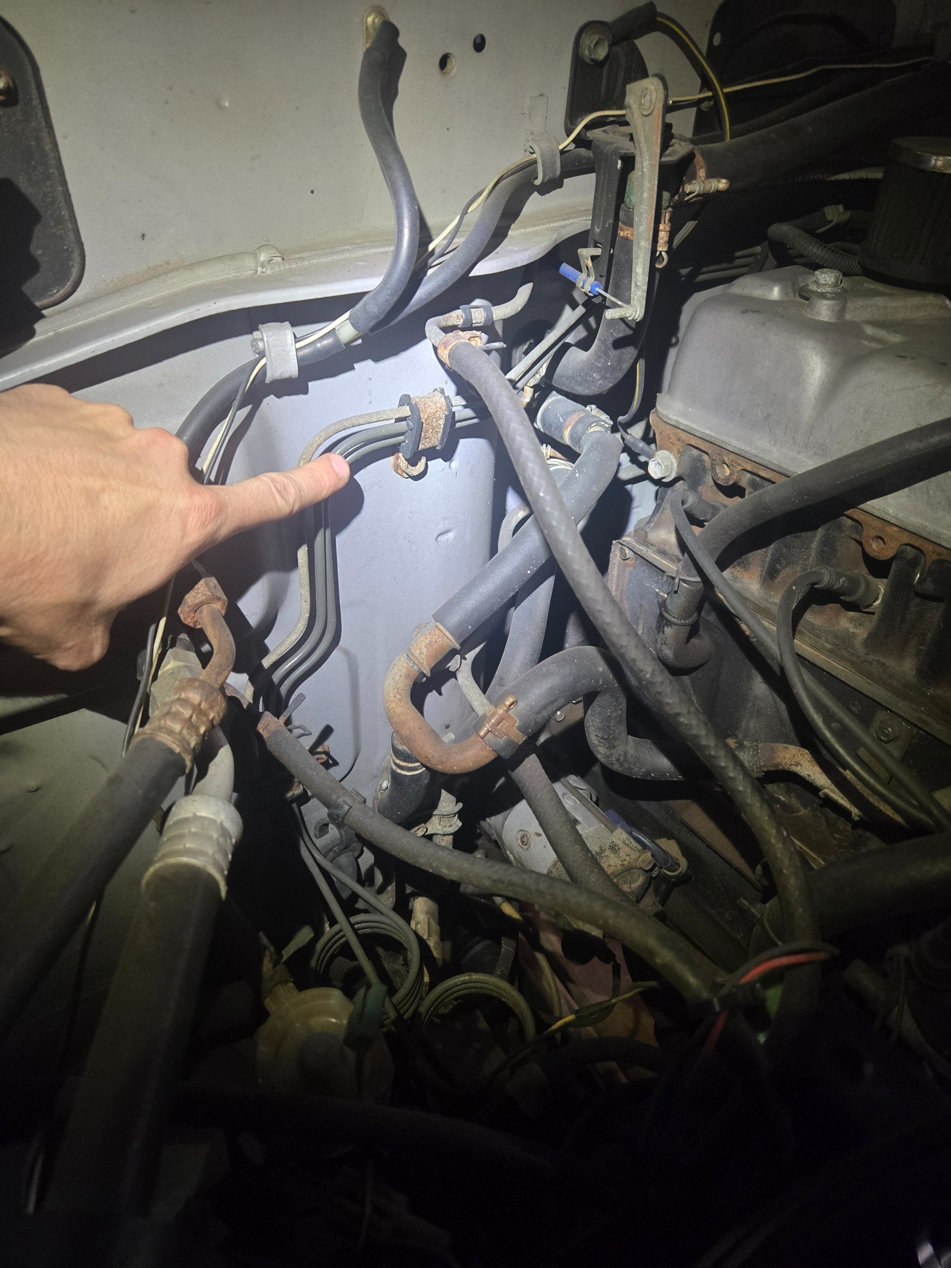

What are thoughts here from the CO crew on the HAC system? Right now I do not have one. I have driven all the passes on 70 and over independence quite a few times with no issues. Is it worth restoring? As far as vacuum routing all I have is.
1. Brake booster
2. Vac advance from the distributor
3. Gas evap (right now just venting to air)
4. PCV (venting to air, soon back to the carb hat)
5. The big line from the left side cover to the carb spacer. I do not know what that one does!
