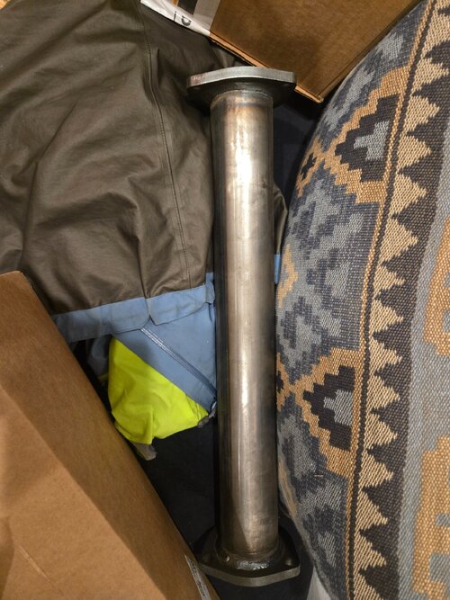

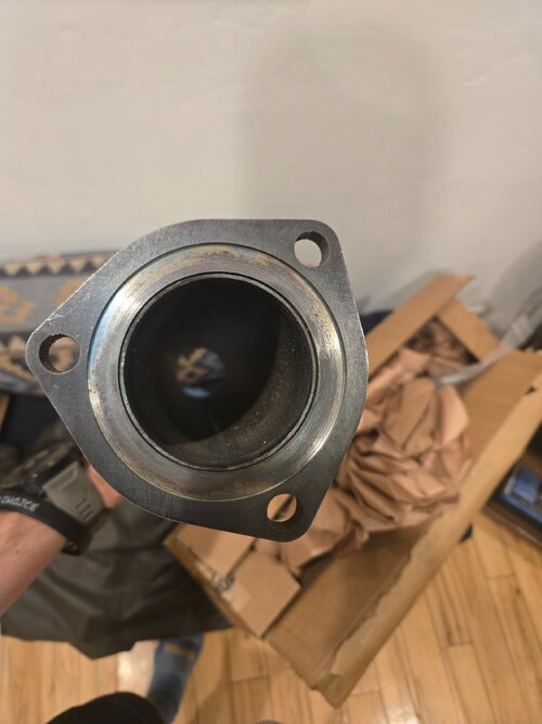

New catalytic converter looks super high flow. Crazy engineering team over at manafre. 20250911_201520.jpg20250911_200303.jpg

I don't understand why some hate on Man-a-Fre; they have good products.
I agree. I also know is fast to weld up, but this was on backorder and got here 5 days. At least I can now confirm if my tick noise is from the leaky cat.
9,804
hey the flanges looks correct, thats nice and worth the price of admission right there.

Ticking is gone! The cat was definitely making some noise. Sounds like its full of sand. Quick install even fiddling a bit with the bolts.
Slight tick still but I belive it is the classic 2f sewing machine noise. Not pingy or as metallic. I can hear a lot more from the engine with all the sound deadening.
