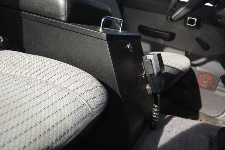

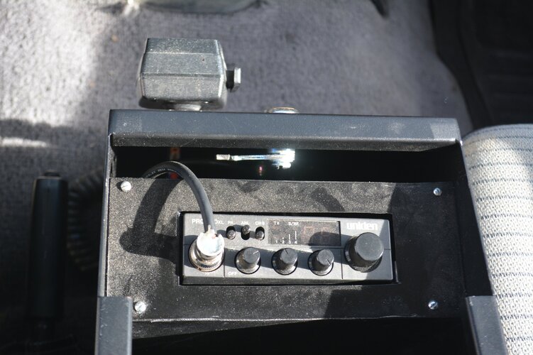

From when I had my 60 for sale here earlier this year, this is my CB in my CCoT center console. Mounting this CB and the power switch it took at least as much time and effort as installing the center console itself. To get the mic connector to fit I had to fab a right angle connector. I fabbed the plate to hold the CB.

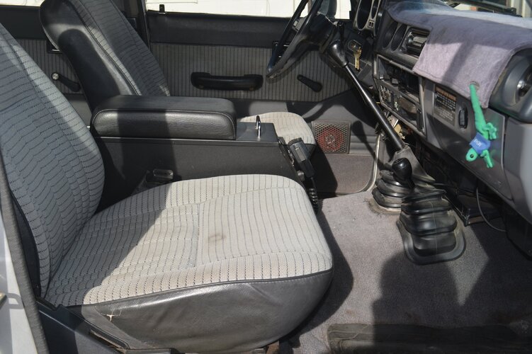

Here's another couple shots of the CCoT center console. The lizard used to be sold at the City Market in Moab and had magnets in his little feet. For me it was a tradition to buy one every year I went to Cruise Moab when they were still sold there in the early 2000s. The lizard went to his new owner in Utah with the rig. 🦎
