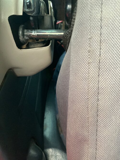

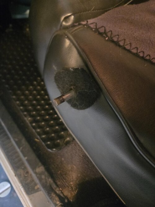

@KC Masterpiece I’m not able to look at my ‘87 right now but the picture of your back seat latch pin does not look like a stock part. The picture of the 62 version looks like what I remember mine to be. Anyone else with a late model 60 to verify? What do you think @Cruisertrash?
My seats have been recovered, so it is quite possible that the stock latch pin was replaced.
3,132

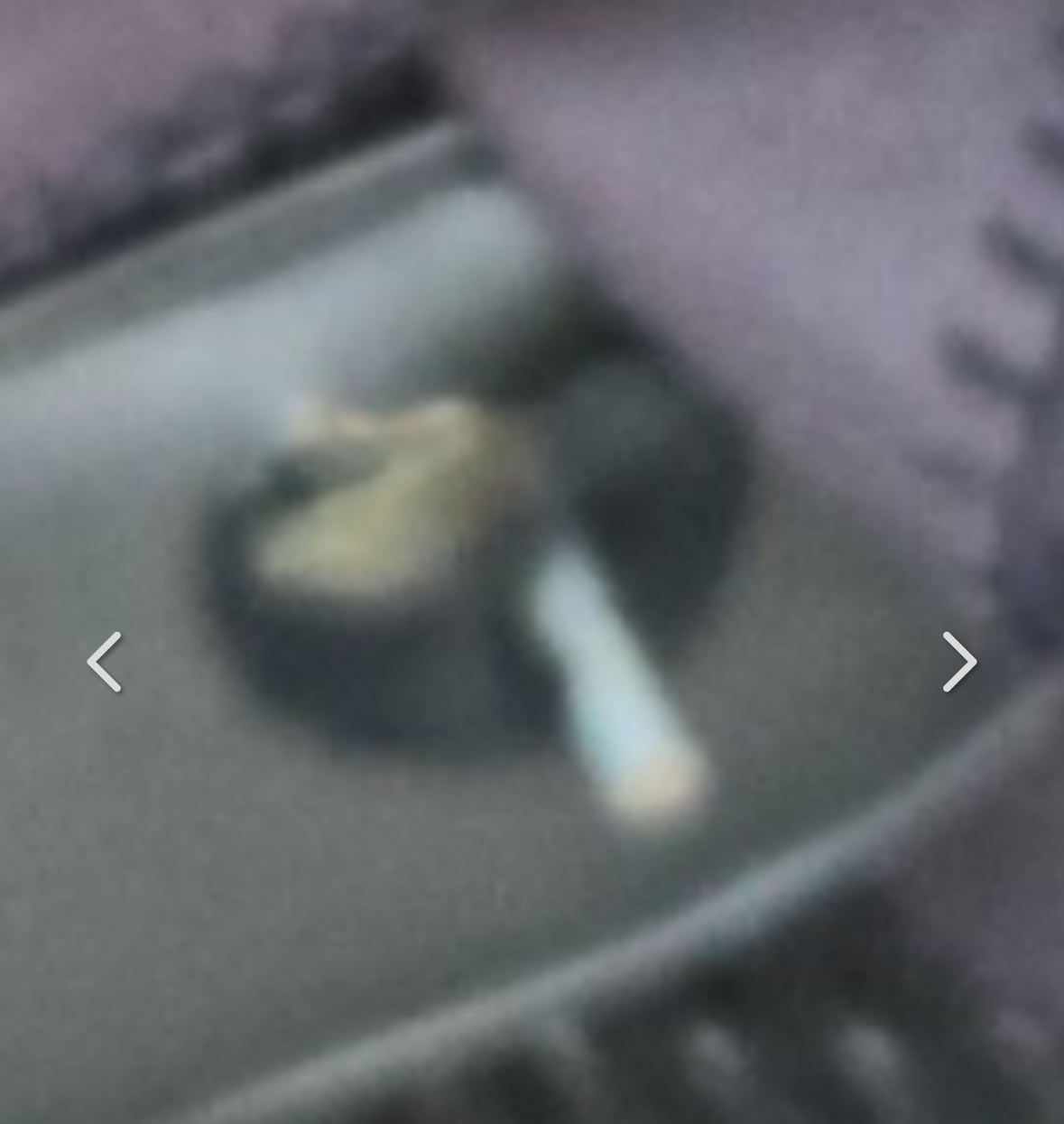

@RDub I think we need a better photo from @KC Masterpiece
Looks like some footage of Bigfoot to be honest. What @Crash shows is what I have as original equipment from 1982, and I’d thus argue those posts remained the same through the entire 6x run.
Kevin I have spares if you want me just mail ‘em.

Non Bigfoot photo of my setup. You can see how this will really eat your shin.
I cant feel any threading for where the OEM bolts up, so not sure what's going on in my seat back.

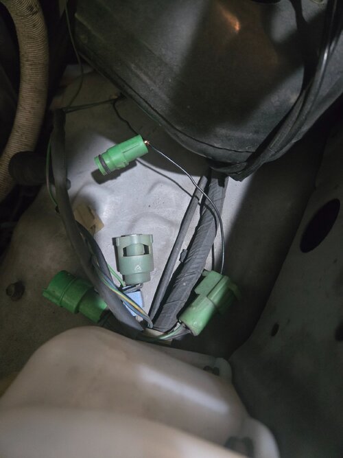

Just dug around under my hood and found the white ground wire/connector to the thermo switch was broken, right at the switch. As I handled it, the other end of the wire broke right at the base of the connector. I wonder if there's a way to get these green (very brittle) connectors apart to solder on new wire? Or should I just delete it and run a new solid wire to the thermo switch? (But, kind of like keeping things stock)
3,132
If the thermo switch isn’t hooked up the fan should run for the full 20 mins after shut down. So it should run anyway. Make sure you have 12V at the plug to the fan. It really does temp a lot with hot starts.
Also there’s an issue some people have with the float bowl emptying into the intake manifold after a hot shutdown. Most people don’t experience it but there’s a few of us. When you restart all that puddles fuel will cause some black smoke out the tailpipe. No known cause or solution.
