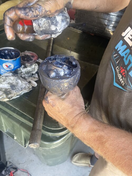

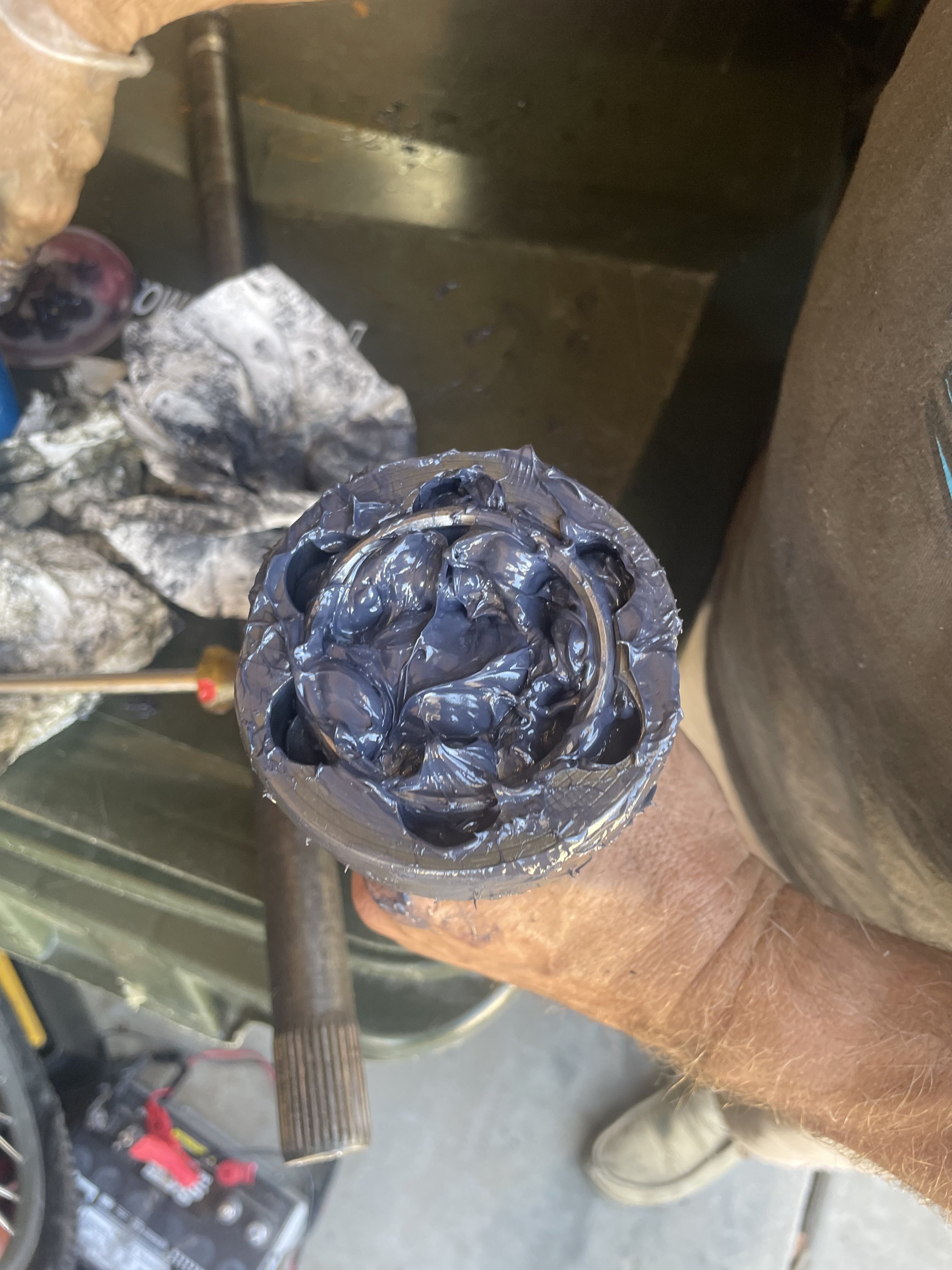

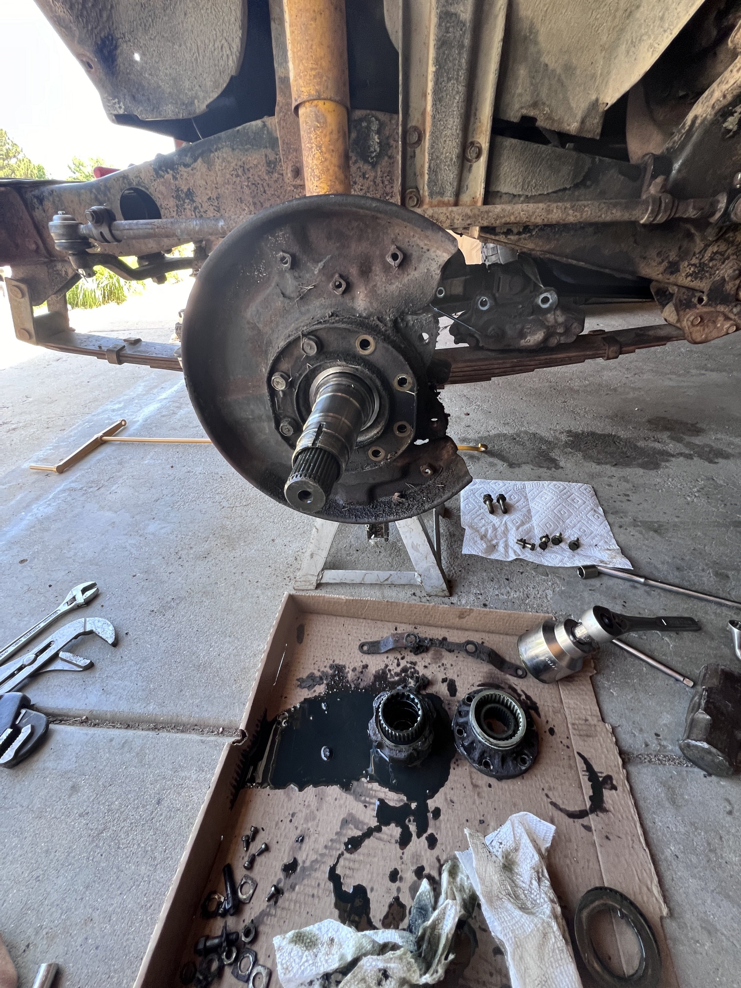

The Jedi master showing padawan how to fill a birf.

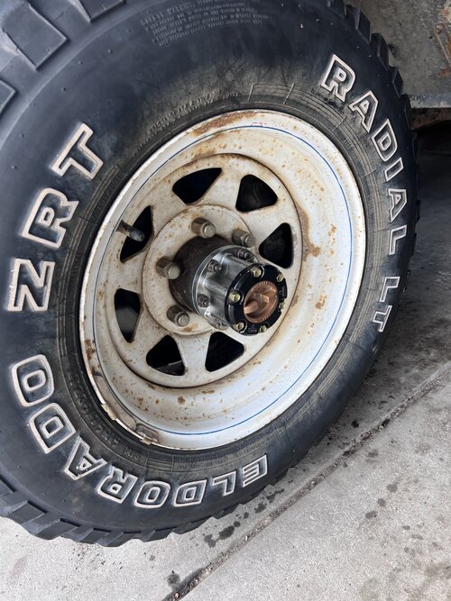

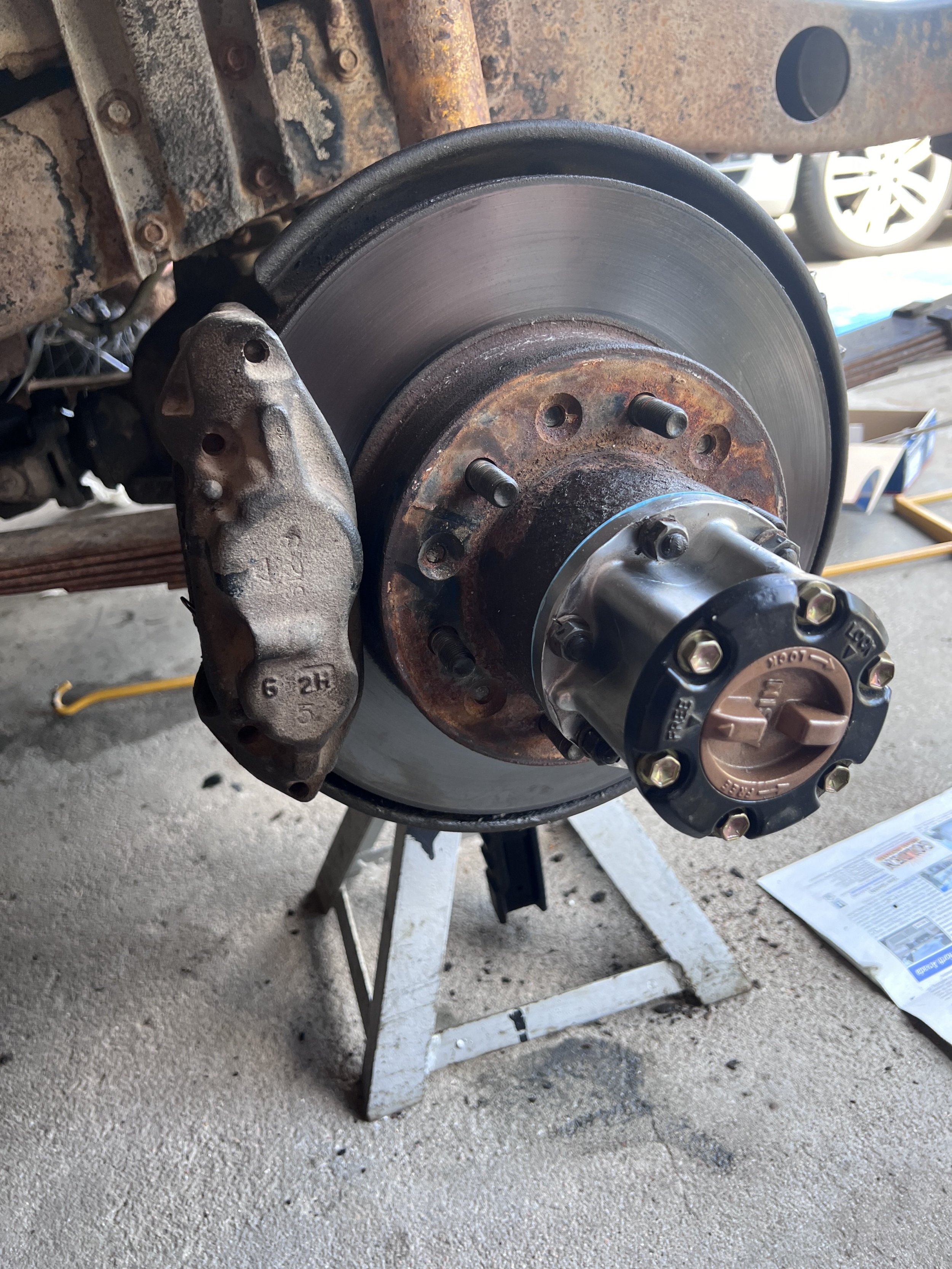

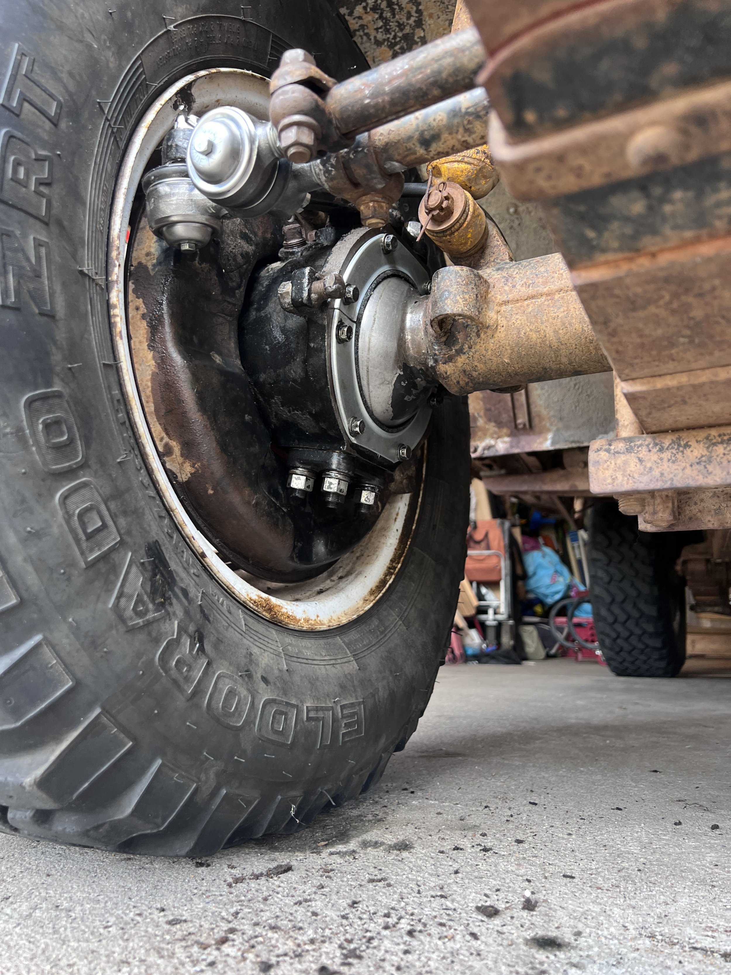

Put on some new old stock long body 55 asco’s converted to aisin’s I had stashed.
Thanks to Kurt and cruiser outfitters for the tre’s and knuckle rebuild kit!

i like the bare metal look
i actually cleared them on the 76 to keep them from corroding and keep that bare metal look but i am ridiculous in a lot of ways

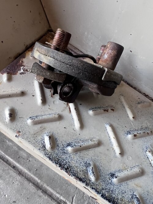

right of passage right there for any toyota owner!
love the aisin/asco hubs nice touch!

I usually don’t. Do people normally paint them?
555 recommends that you paint them.
I like the bare metal look too. I need to replace ours. I'll probably clear them once installed.

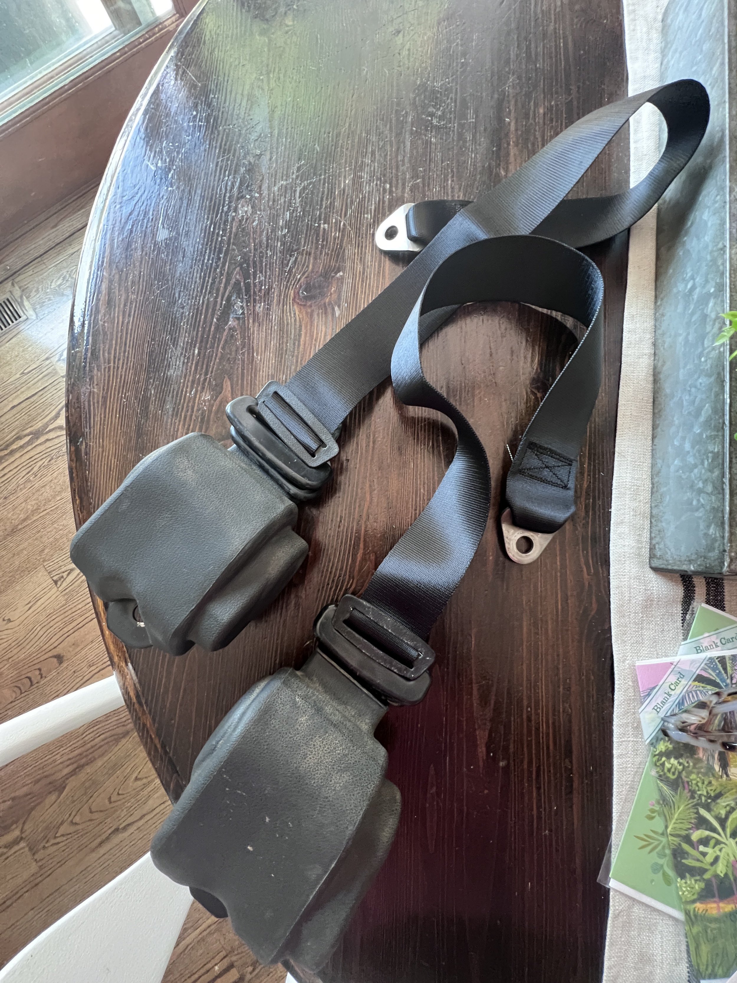

New seat belt webbing. Not sure I took a pic of the old frayed seat belts before I sent them in

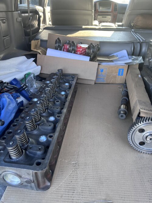

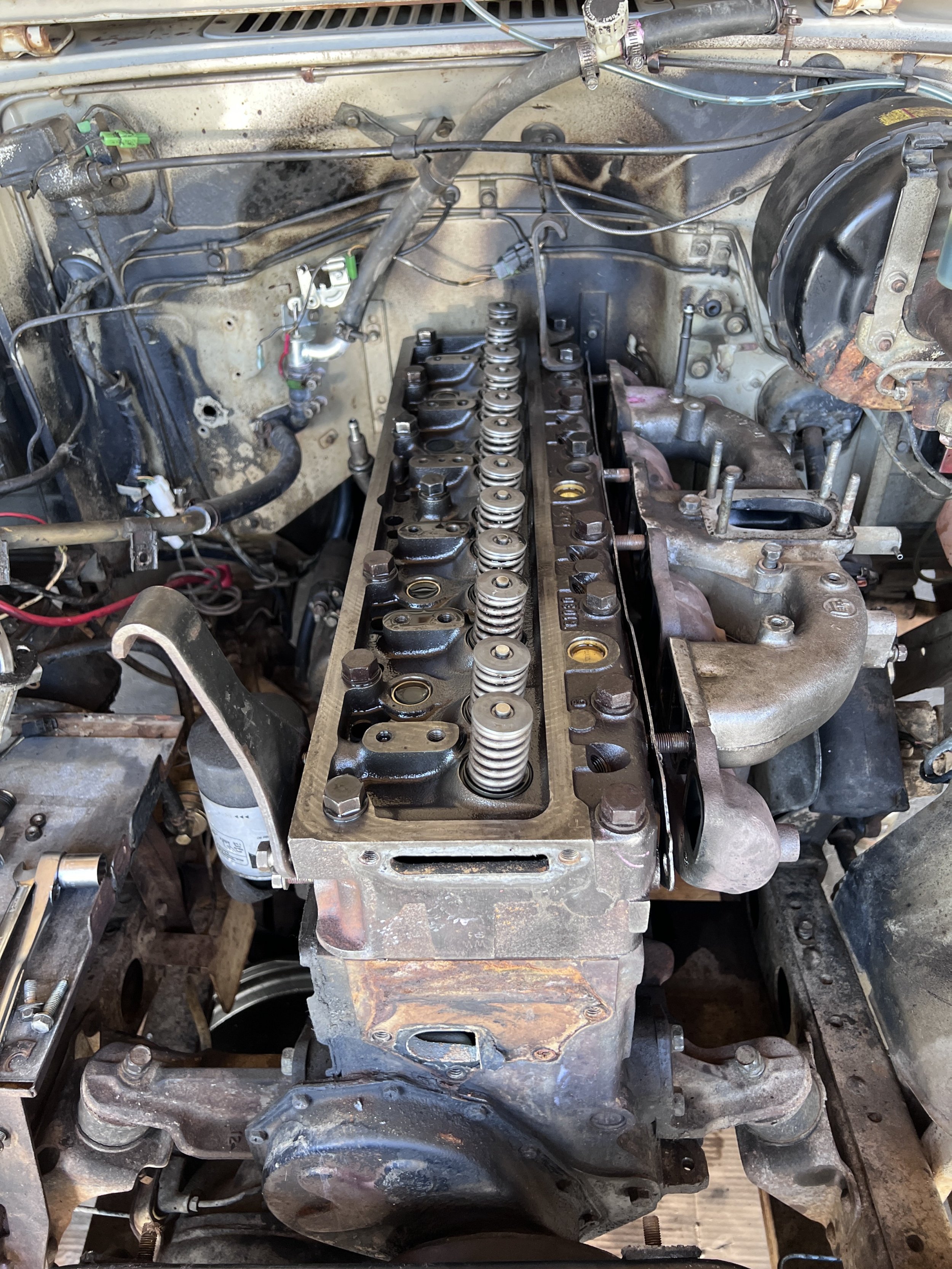

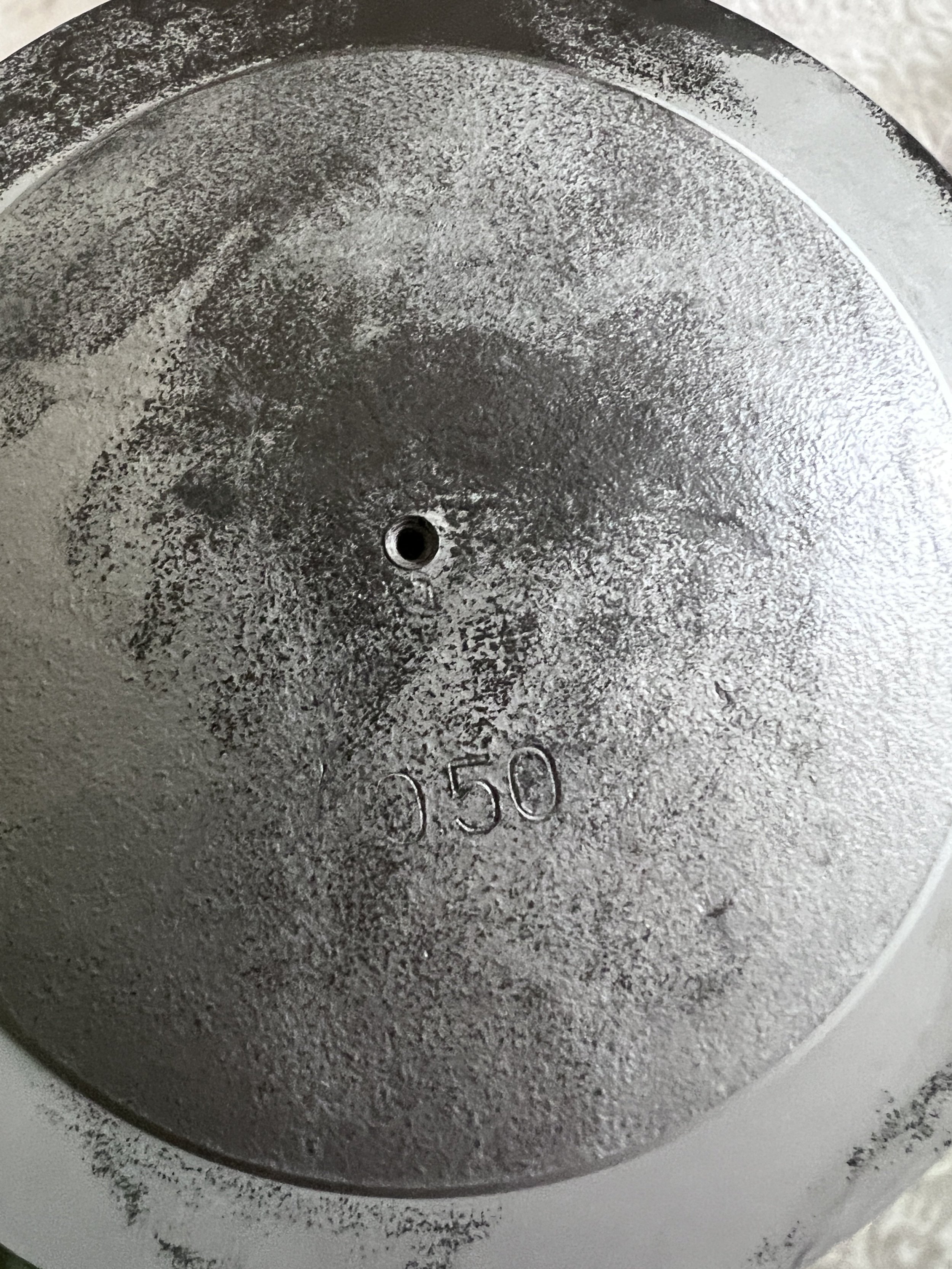

I found some NOS .050 dome pistons so it’s time to strip everything down and take it to Gunn. Wyatt is at scout camp so I might have to wait til he gets back for the help

I'm not sure i'm quite ready to give up on my rebuild. Did a compression test and it's got 120 across the board now. A couple might be closer to 115 but i have an old craftsman compression dial. Rings seem to be seating some but I still get a fair amount of smoke at start up but once it's warmed up it's barely visible. Power seems to be pretty good remembering back to 2F's. I might drive it more and see in a week or two.

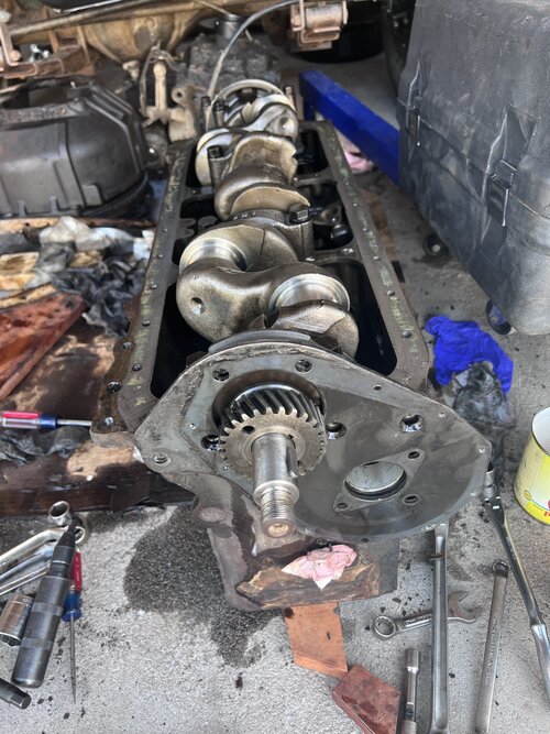

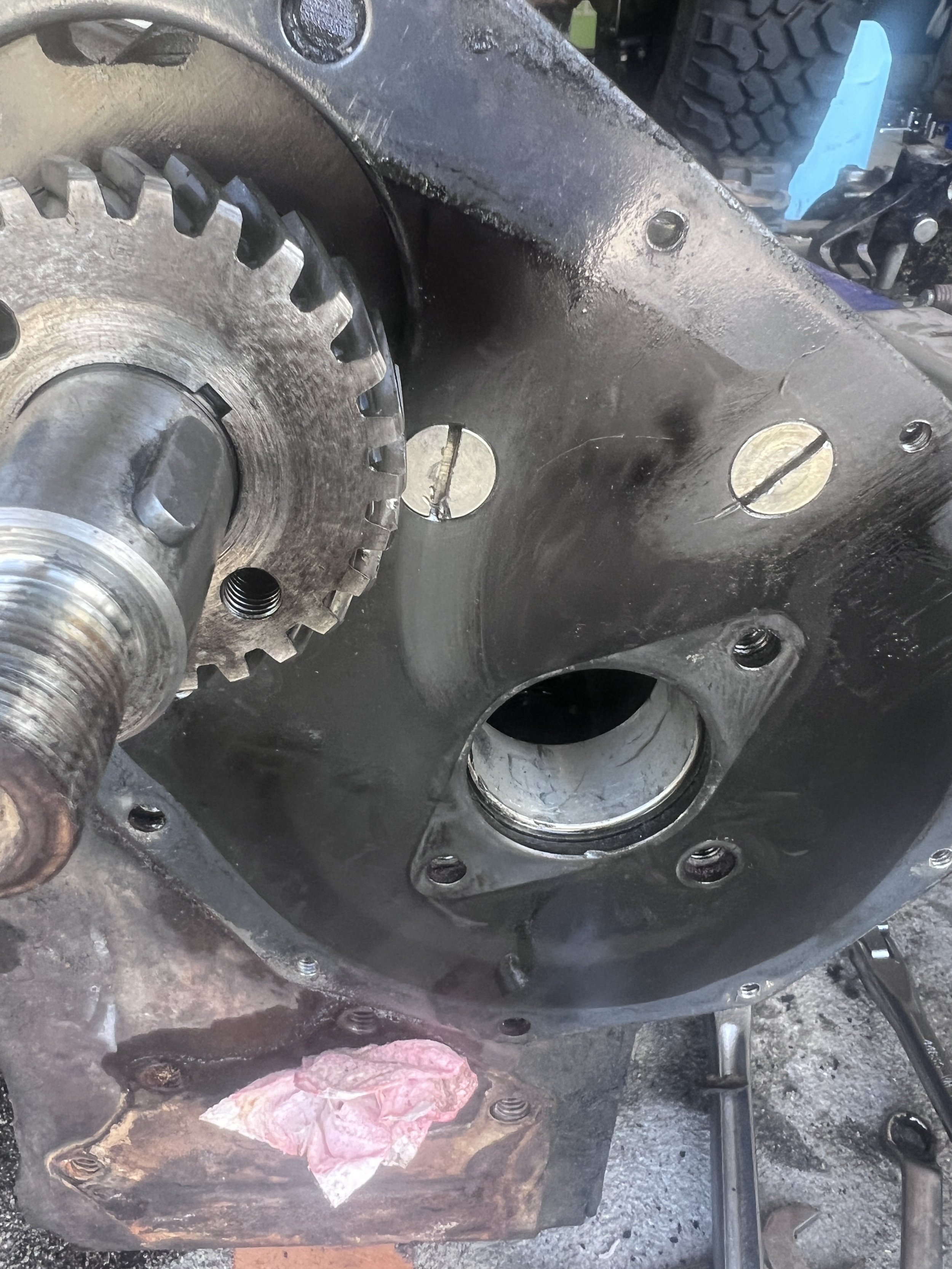

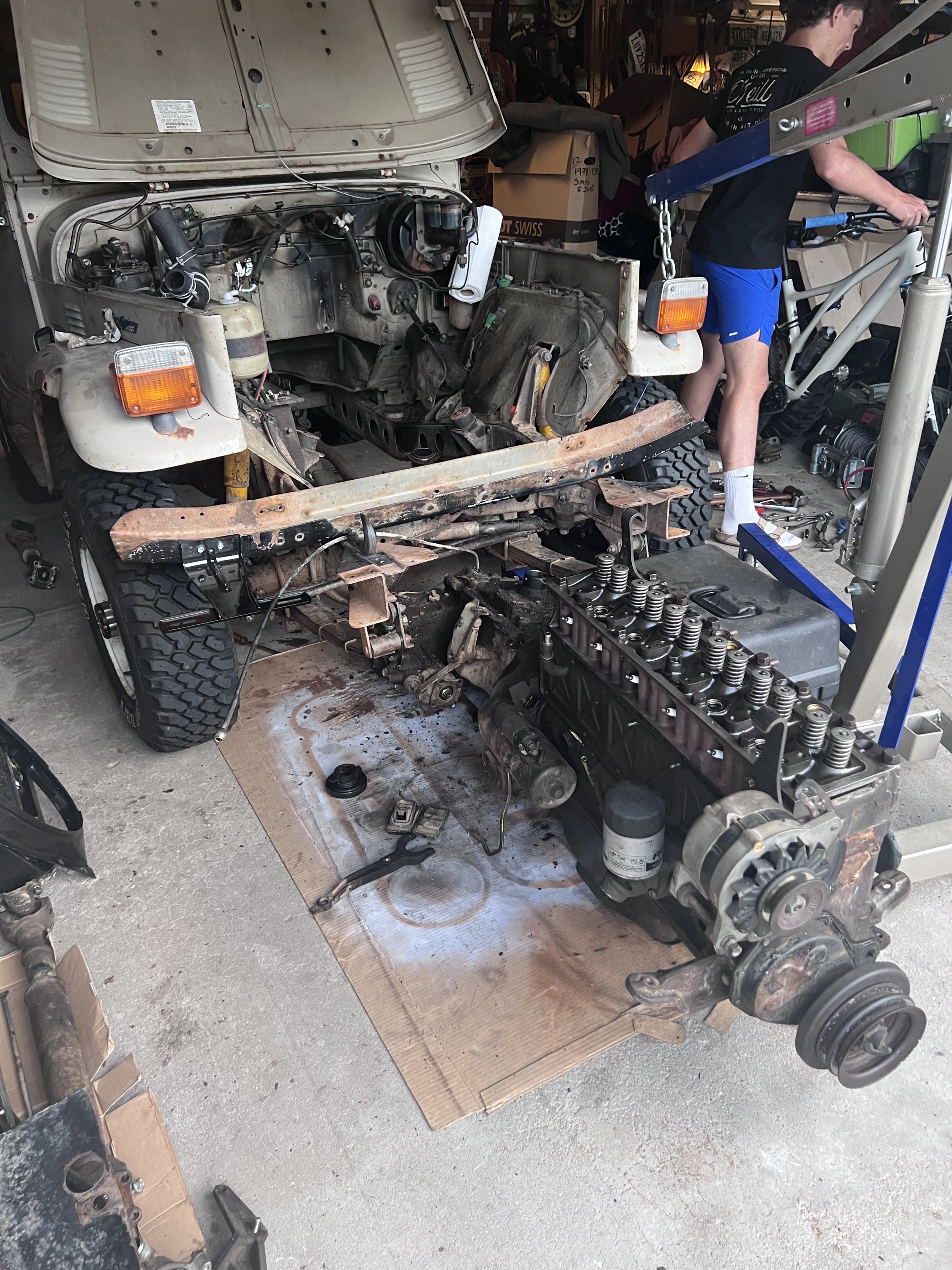

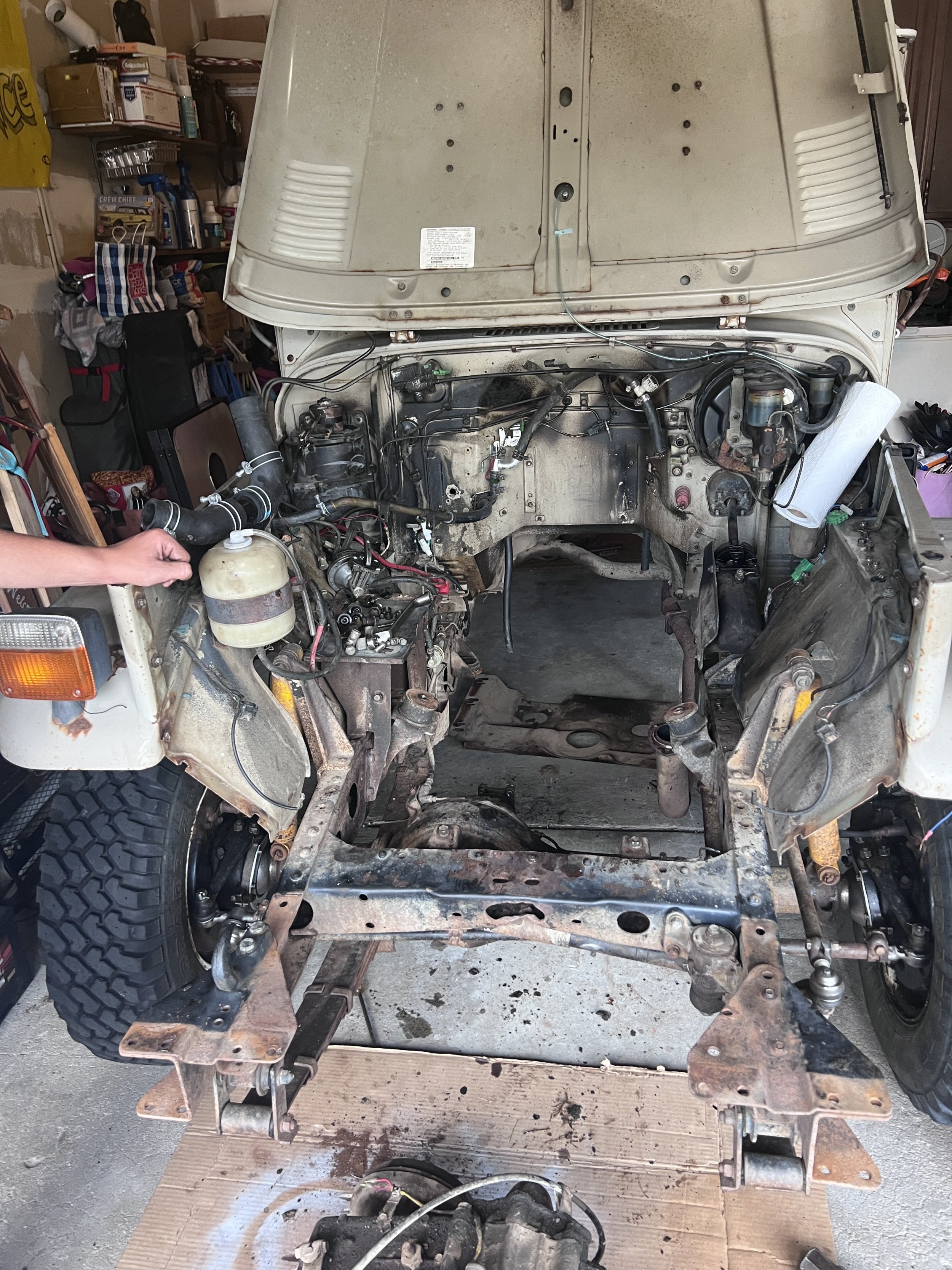

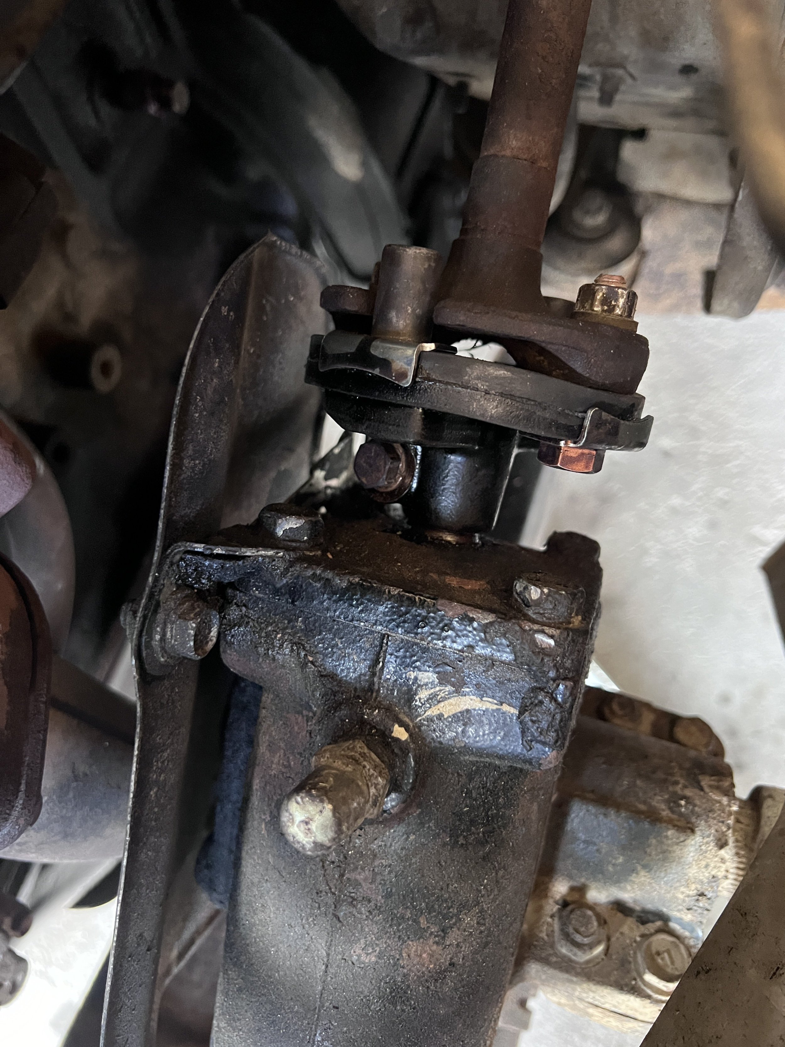

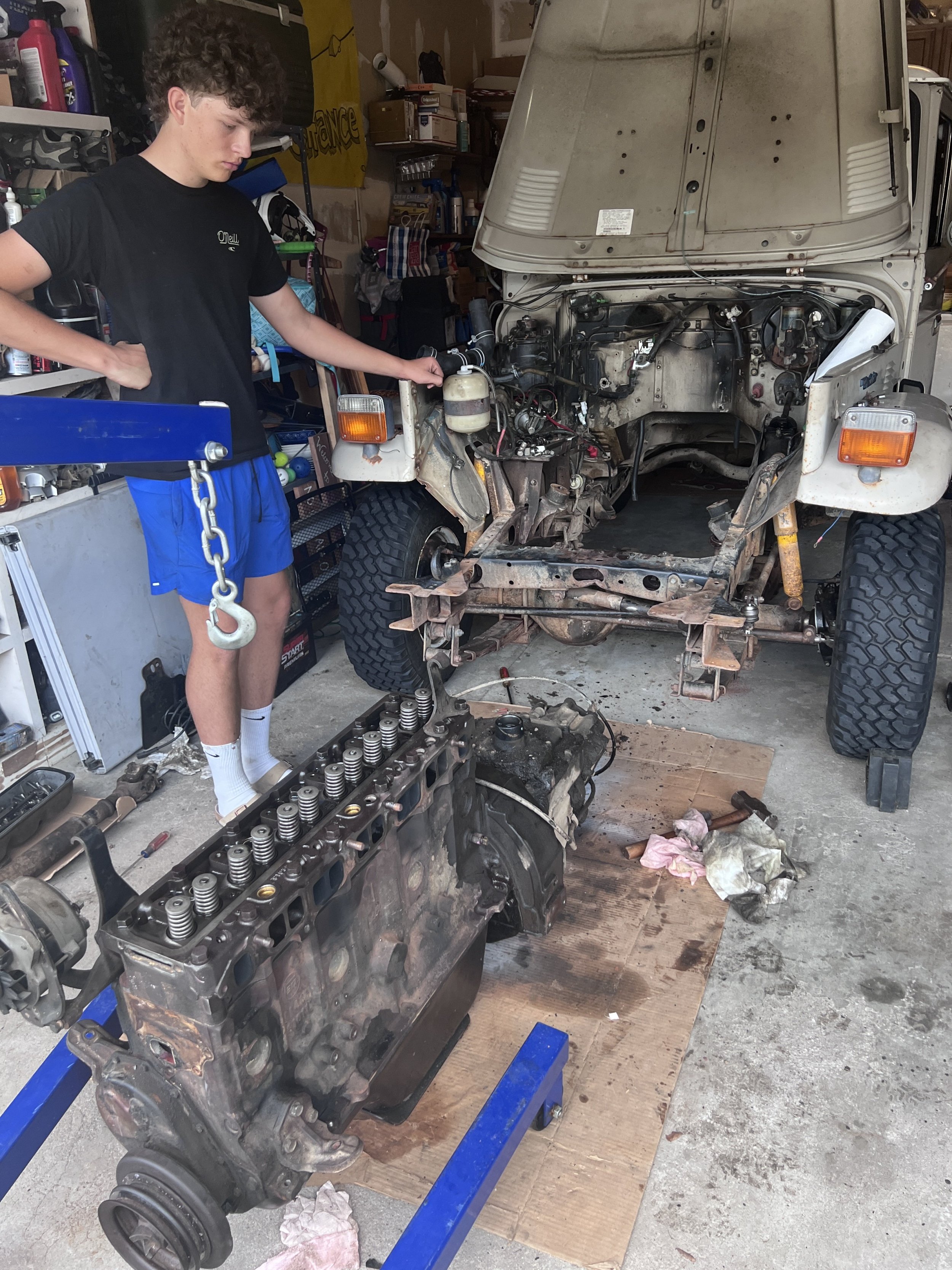

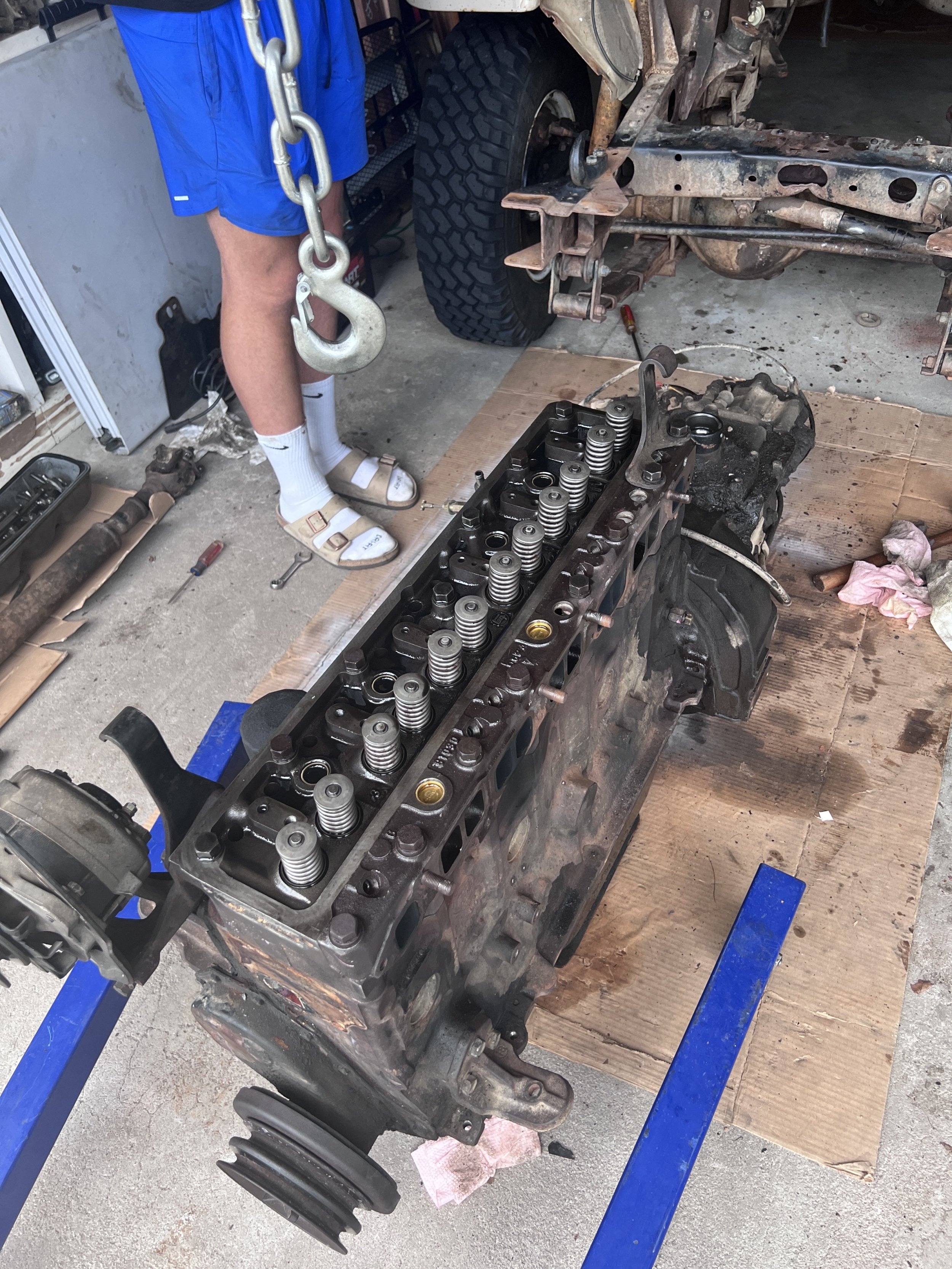

And it’s out. Trans separated, gitr done

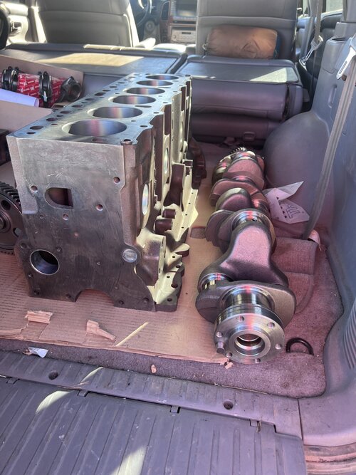

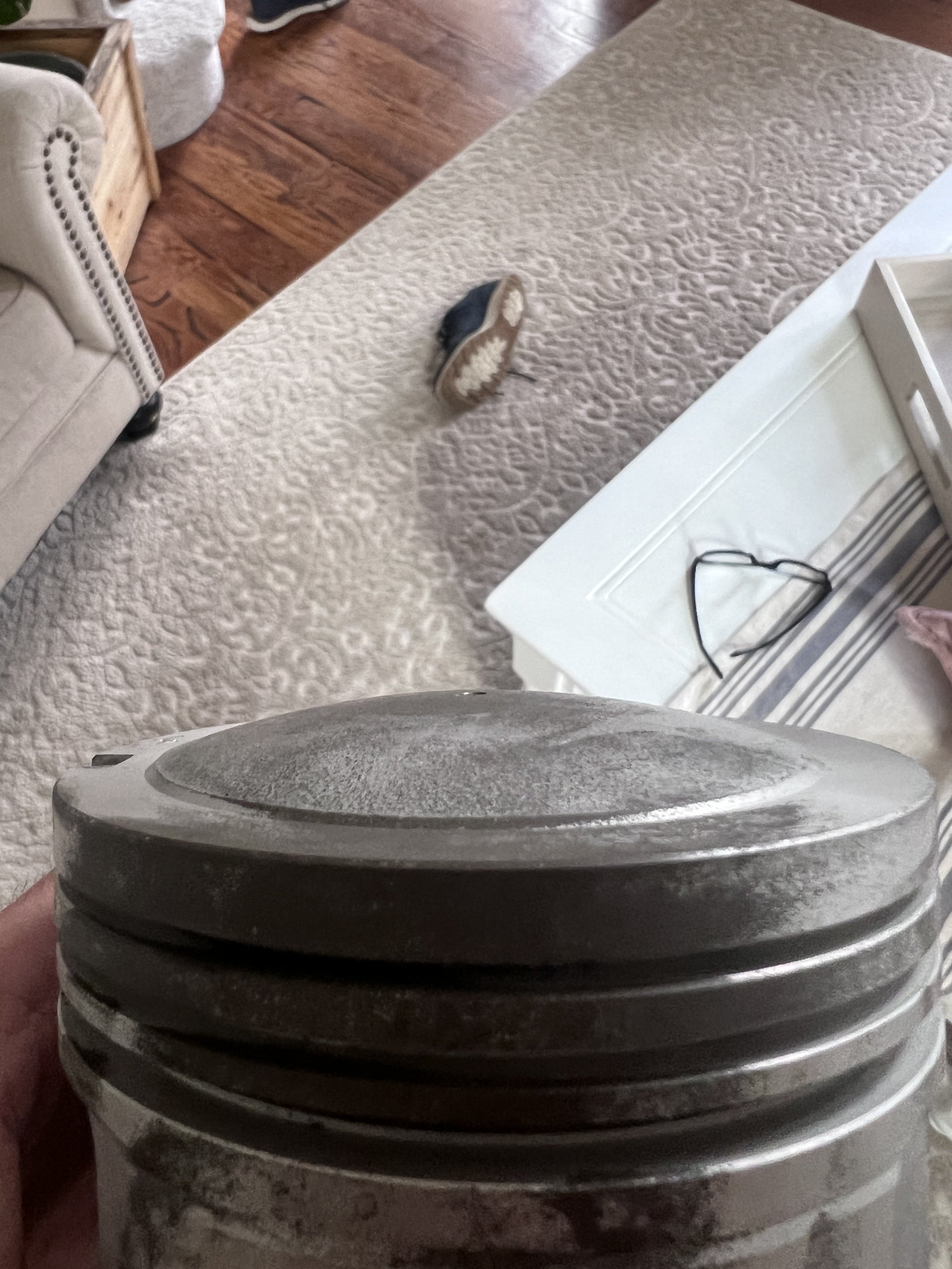

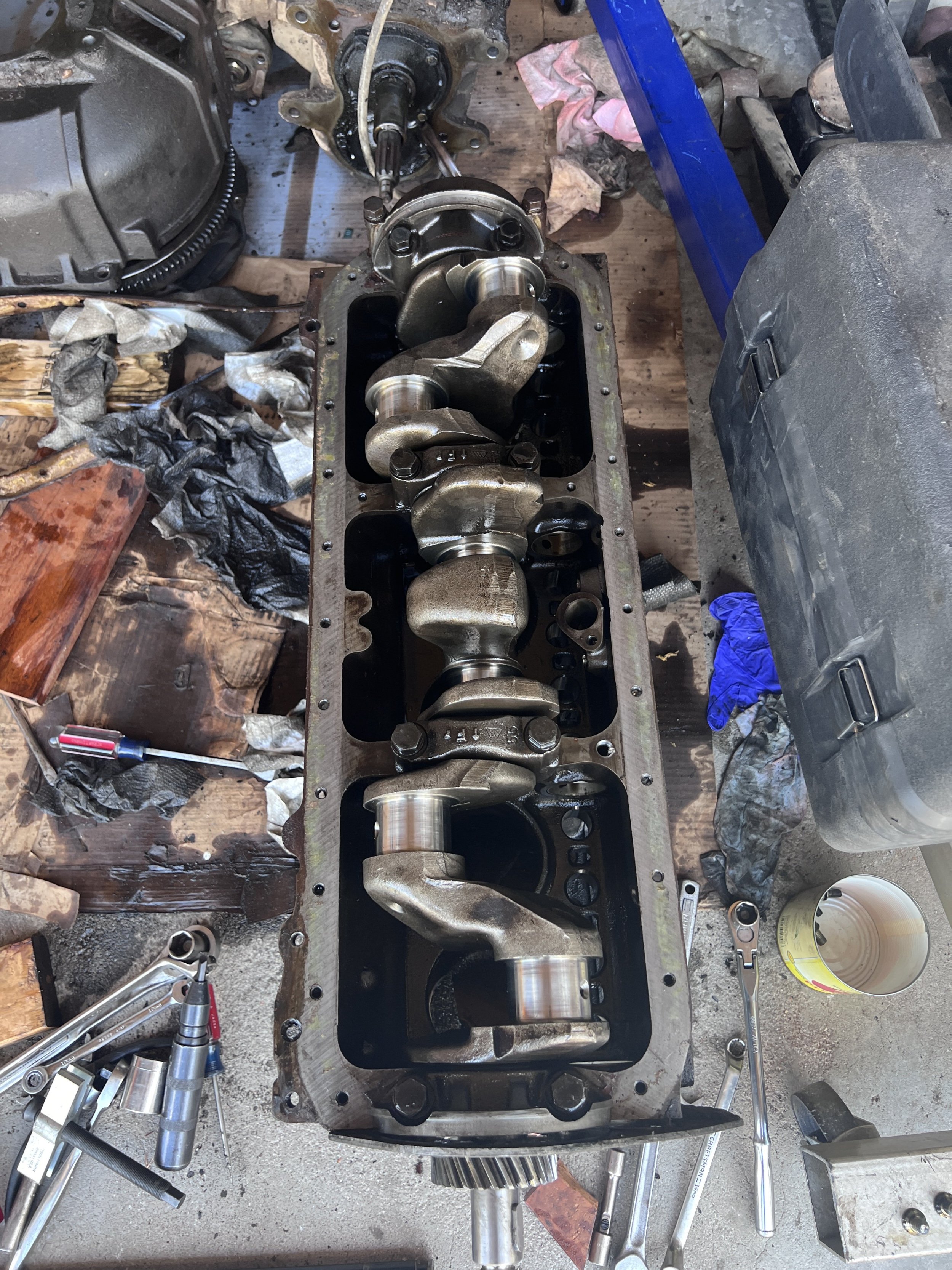

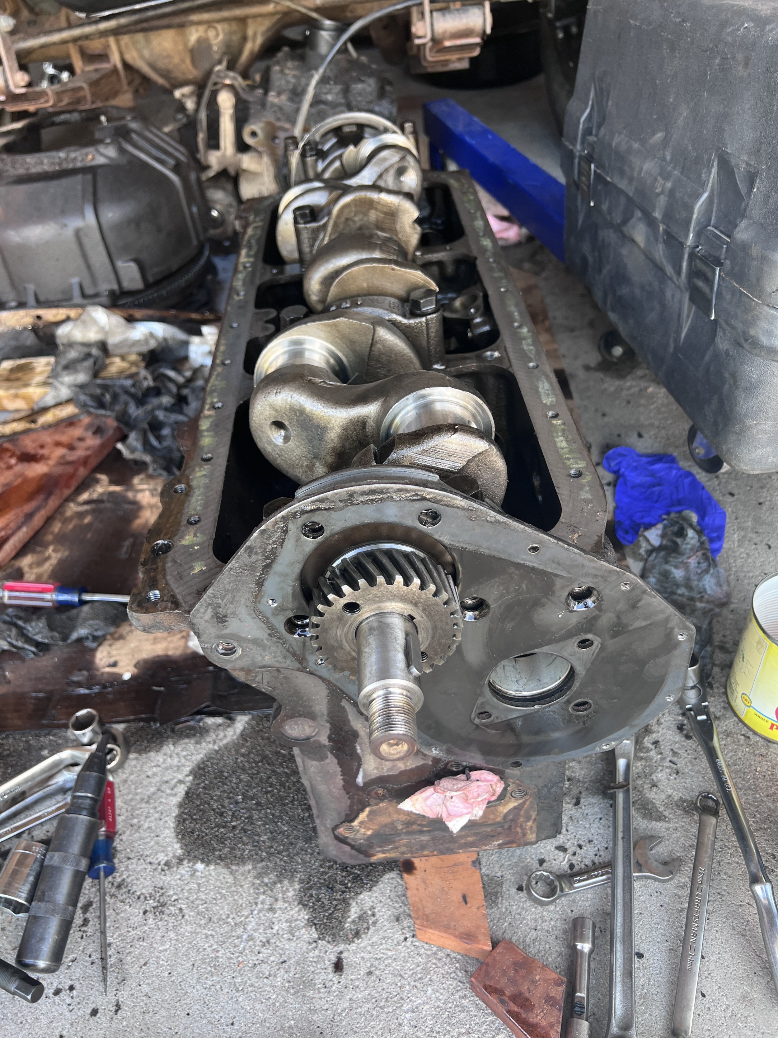

Forgot to post pics of disassembly. I’m not sure why I didn’t run a dingleberry hone down the cyl but that’s why my rering didn’t work. The cyl were glazed. I had compression up to 120 with new rings (up from 70-80) but blew oil by. Gunn all but confirmed that. It’s ok being in for a rebuild. It would have been on the bottom end of a tired motor. In the end we'll have a great running 40 that will go anywhere.
Everything is at Gunn. Block, crank, pistons, cam, flywheel, intake/ext manifolds. New cam and clutch ordered.
Hope to hear next week after cleaning and mix what the plan is and the .050 nos pistons work.

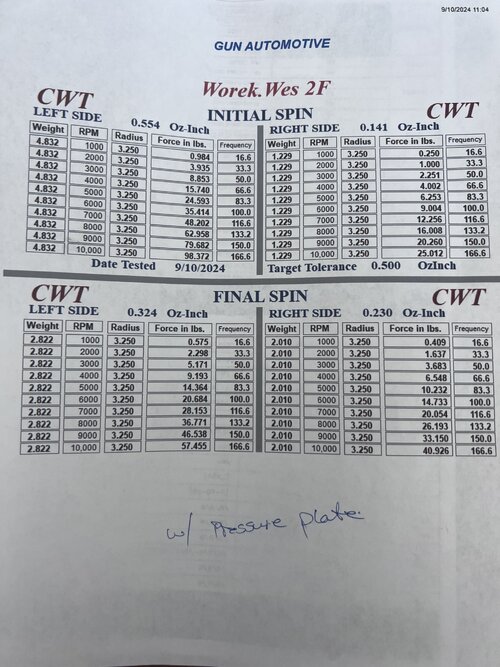

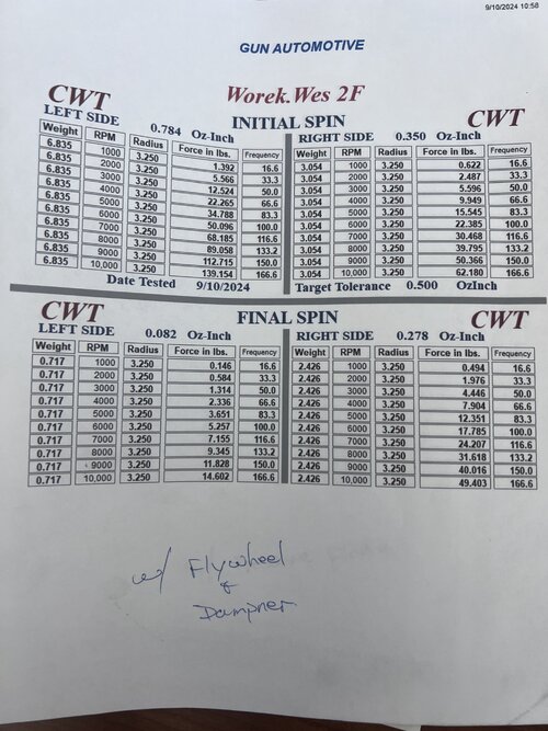

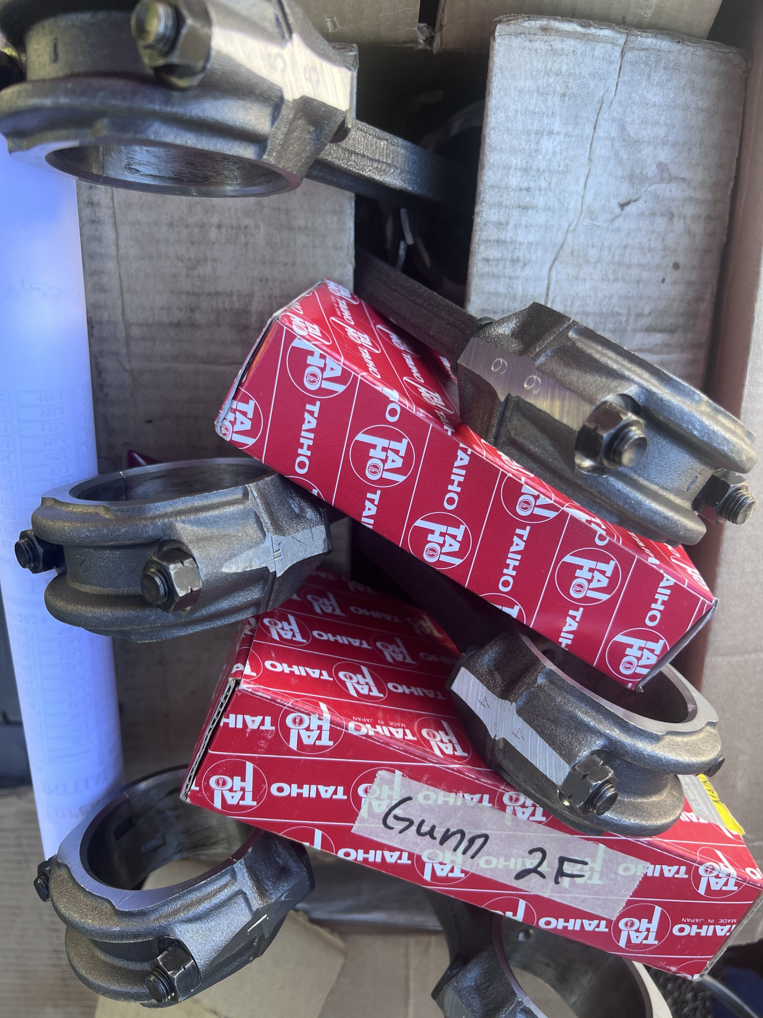

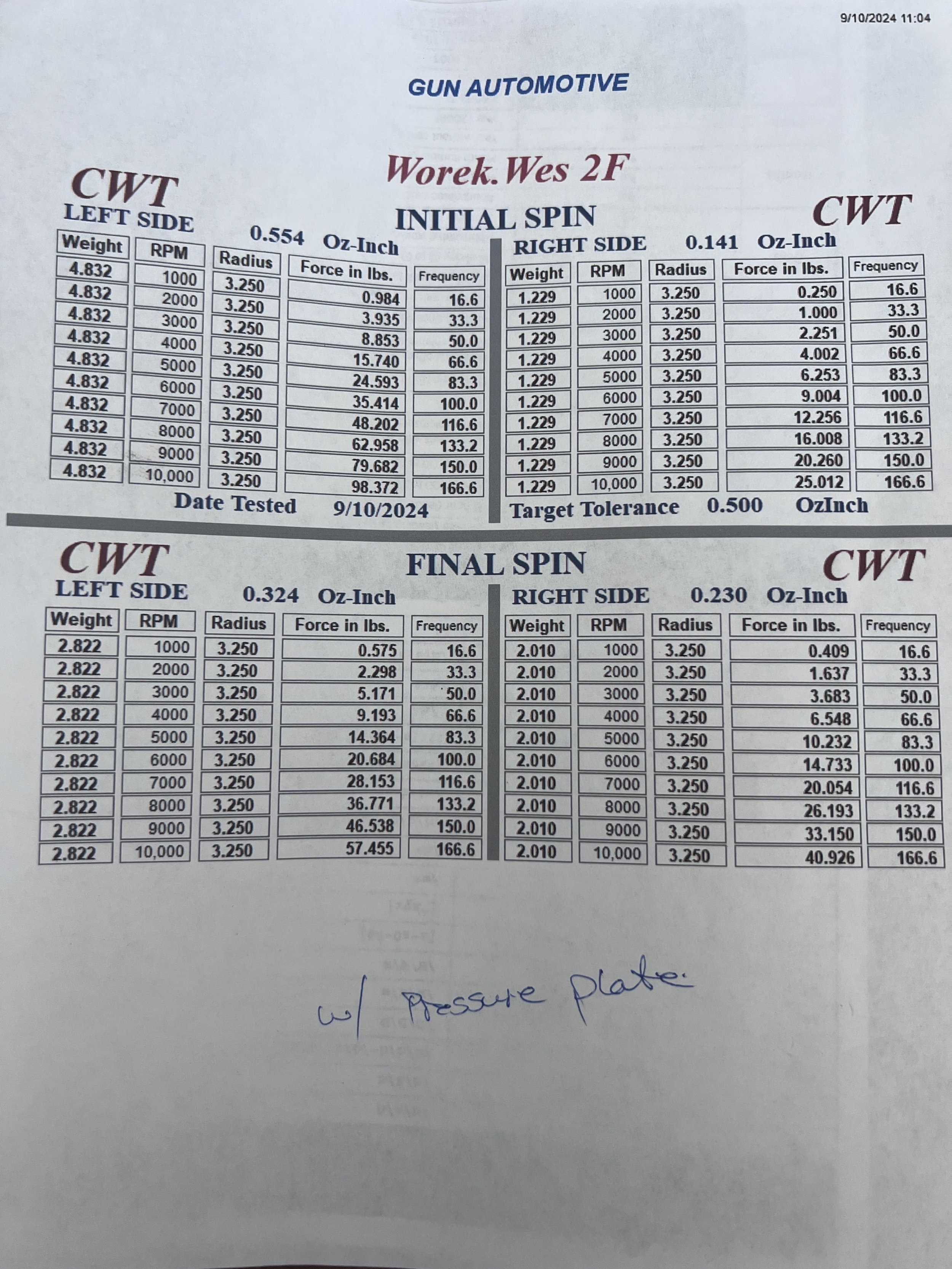

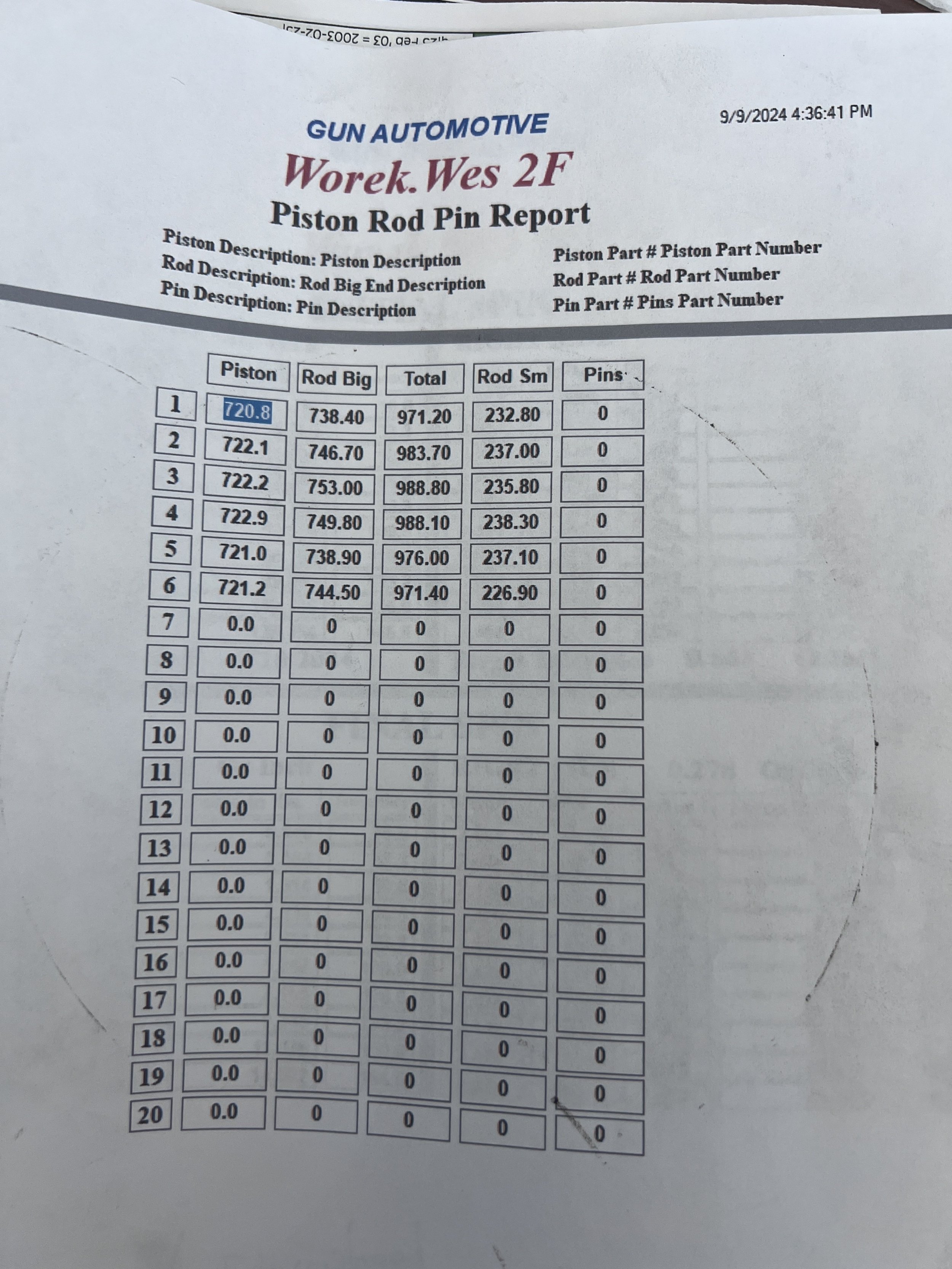

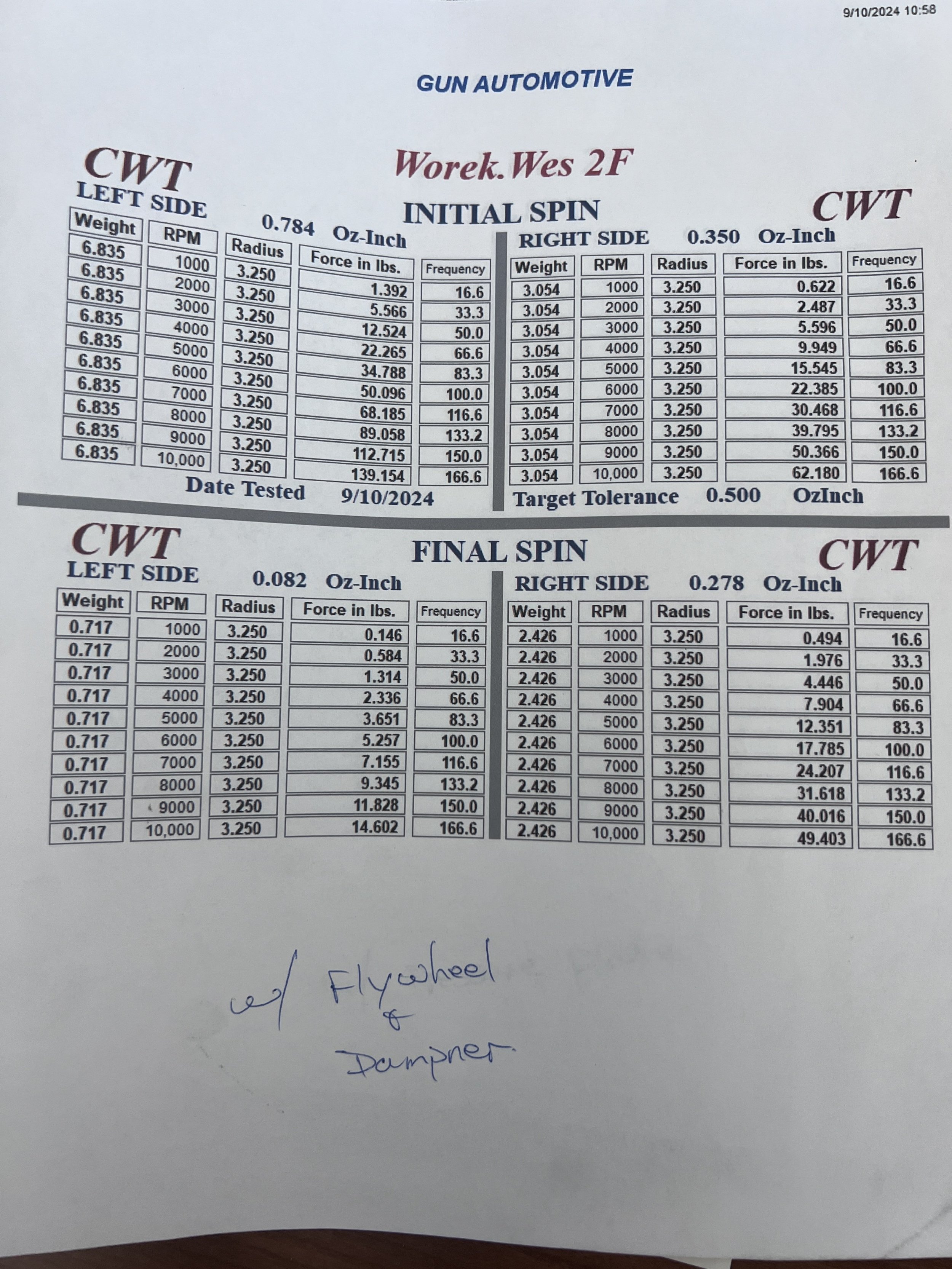

Almost ready to assemble. Maybe this Saturday when we a full block of time. Fully balanced with flywheel and pressure plate. All the pistons marked.
8,997
in da house
Balance sheets and cost
Block - $1765
Head - $644
I supplied the pistons, all the bearings, cam, etc.
