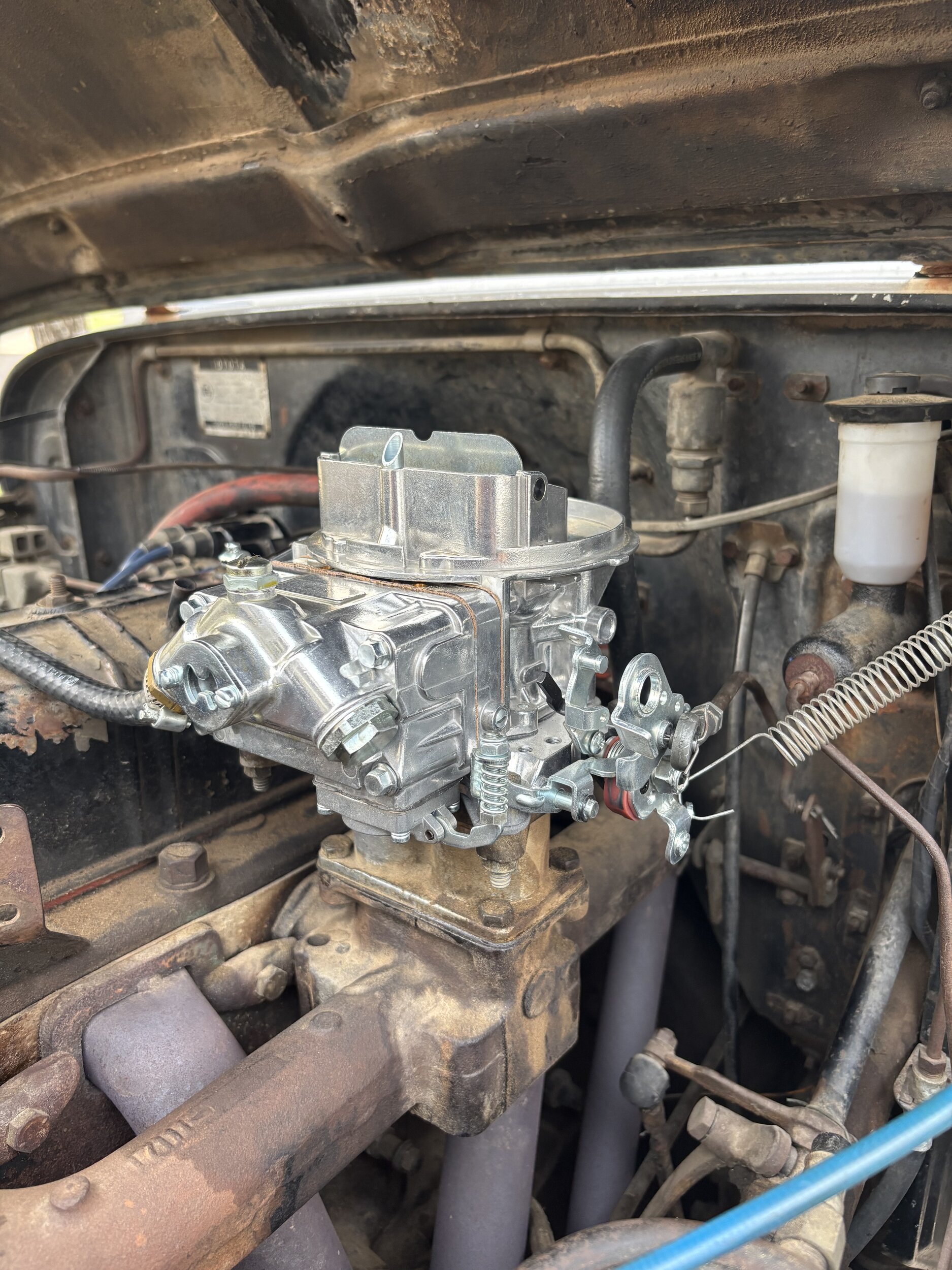

I just bought a 1963 fj-40 off of Facebook marketplace. It was not running when I got it and had a new carb on it with no brand. I got the car running and idling well and the timing set to 7 btdc. Whenever I give it gas or when it’s under load it starts sharply popping out of the exhaust. I thought maybe the mechanical advance wasn’t working but after taking the distributor apart I can’t really tell. It does move but doesn’t really spring back like other distributors I’ve seen. I don’t know if I’m on the right track with timing or not.

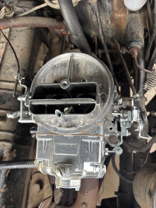

This is the new carb that was on when I bought it it also came with a Holley carb that looked nearly identical that was on it previously. I am going to set the timing more advanced tomorrow. Does anyone know anything about the small dial that sits on the shaft of the distributor?

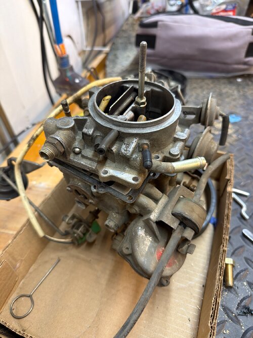

It should look kinda like this…emphasis on kinda… this is my spare 60 carb.
The stock carb for a '63 is single barrel IIRC. It's also going to be super simple as that was before any kind of emission controls.

That’s a holley 2300 copy. Lots of people run those with success but an aisin carb will be better. Sounds like a timing issue for sure.

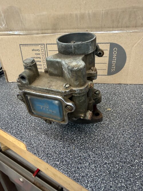

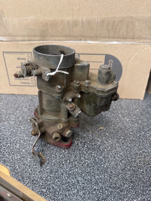

The correct SD single barrel is a rarity, on mud people ask between $500 and $1,000 in original /needs rebuilt condition. I have one I took off my 63’ fj45 to run a holley 350cfm when i was younger. (It will stay with the truck) Tuned right the Holley ran well. That may be a 500 cfm (far more common) Holley clone which might be a little hard to tune and tend lean (i.e. too much “air”).

Agreed I’d get a SD40 carb and either send it off to Jim C. or rebuild it yourself.
Here’s a SD40 rebuild kit:
As far as I’m aware they are the only seller of the SD40 rebuild kit currently.
