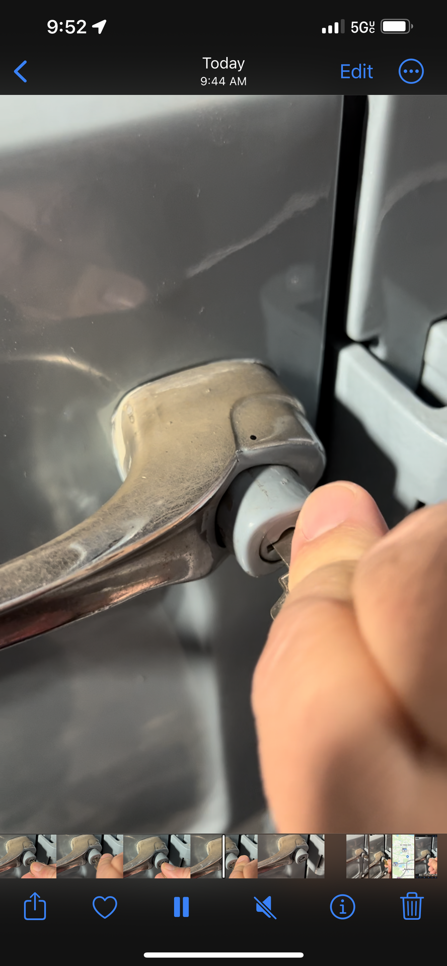

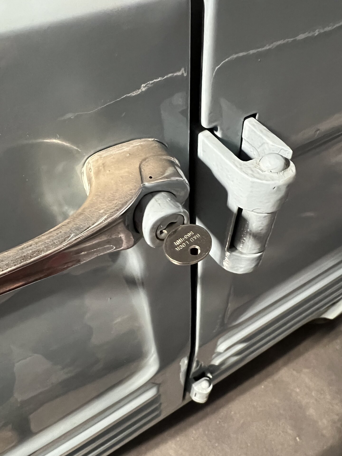

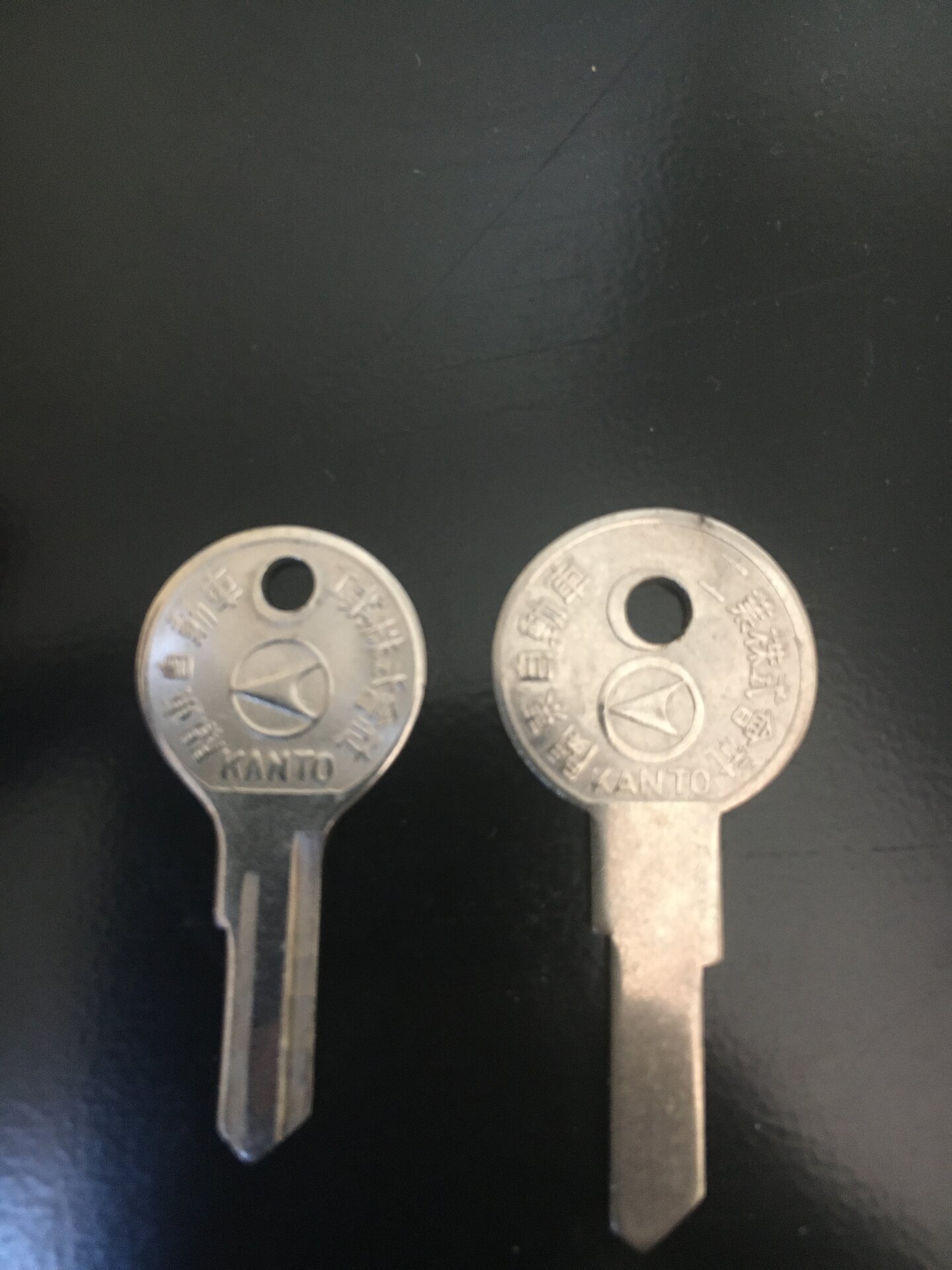

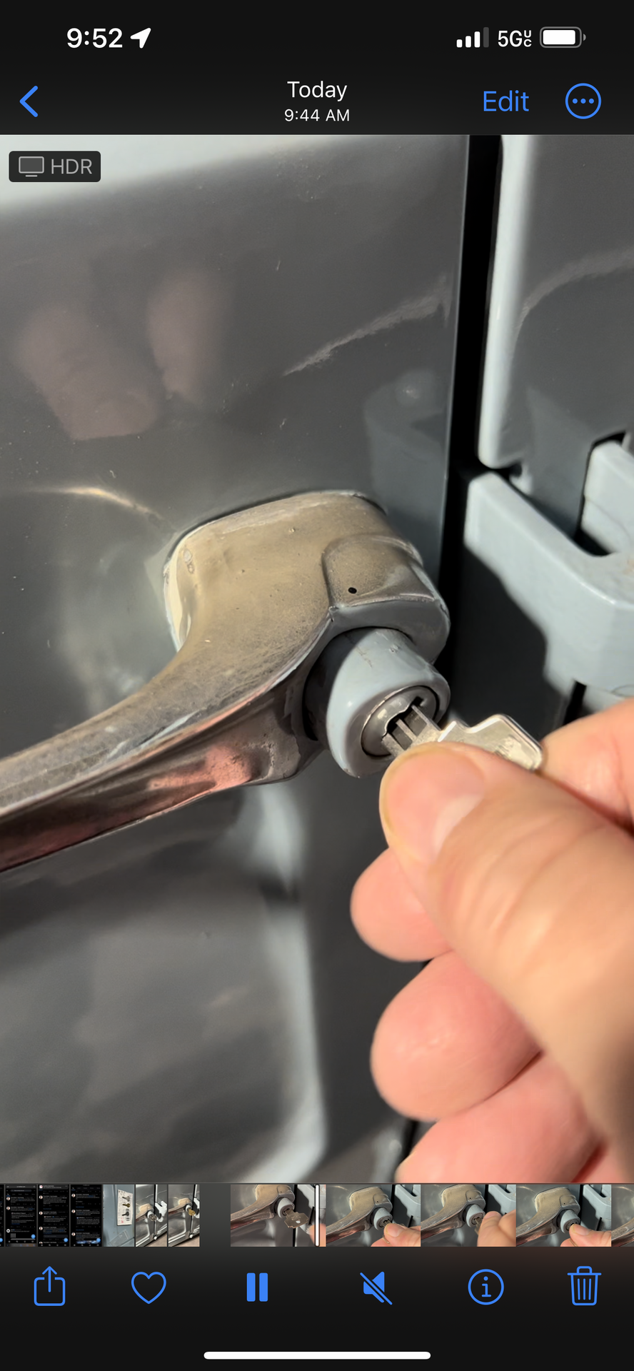

I have been experimenting with several different key blanks that would work on the LV since those blanks are NLA. The KANTO key blanks are completely different from the TOYOTA 1000-6000 series key blanks. I’m lucky to have an original KANTO LV uncut set (door, ignition) to base the blanks off of. I don’t currently own a LV but sent 3 key blanks I think will work to Jim aka @gonzopancho who has 2x LV’s. The pics are ones he sent me. Thank you Jim for your help!
ILCO K1122D BN1 (was used pic 3 & 4) or Curtis BN1 or SILCA BN1 works for the door lock and the key blank turns in the lock as can be seen in the pics.
ILCO 62DH or SILCA UNI 1 (pic 2) goes in the door lock but doesn’t turn it. We’ll do some more investigating and report back.
Once we figure out the key blank that works in the ignition switch I’ll post that info here.
