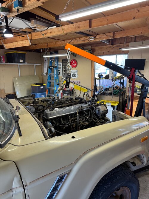

Thank you very much for the input! Sounds like I’ll go the easier route and pull the transmission and stab the it all in as one unit. I borrowed a load leveler which gave me a great deal of confidence in getting the engine to the right angle and such but I think I’ll be better off dropping the whole unit in. Should make for a fun afternoon!

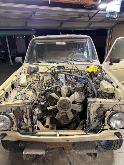

Looking for some advice. Got the rig “running” on the choke circuit, but as soon as I start dropping the choke out it wants to die. I’m 70% sure I got most of the vacuum lines correct an I’m leaning towards it’s still not happy with the bad gas even after I added 5 more gallons of premium to help offset the bad stuff. I was able to install and fill the coolant system and got a belt for the water pump. What am I missing with my no idle/only running on choke? I’m feeling more confident that she will be moving soon so that is a major benefit! The window on the carb shows gas, albeit brown/not champagne color. Should I dump the 10 gallons of gas I put in it and start fresh again?
RDub
Feb 9, 2021
480
Boulder, CO
Is this happening only at idle or also with the throttle open? Maybe the decel cut solenoid is bad? Clogged passages in the carb? Has it warmed up when the choke is closed, or is this when cold? If warm the choke gets disconnected once warmed up, and the choke only acts as a throttle control at that point. Lots could be going on here.
8,019
Did you drain the fuel tank to begin? If it was cruddy/rusty, you probably already sucked garbage into the carb so the idle circuit is probably clogged. How does the fuel filter look?

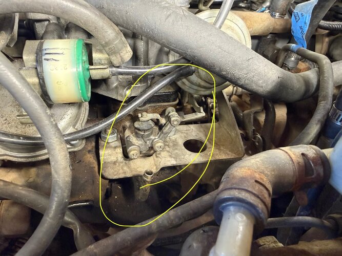

I drained any varnish I could from the tank before adding new fuel. The filter (replaced with a cintered bronze filter) definitely had some gunk after running for a bit on the choke. I took the top cover off the carb, cleaned and blew out the jets and the accompanying portals, this gave me a no change situation. However, one thing I did notice is that this plunger is leaking when I blow carb clean through it.. I’m not sure what its purpose is and there’s not much in the way of information on the interwebs about it. Nothing looked overly filthy in the carb.
Issues at this point: runs rough, but could be attributed to varnish breaking loose with the addition of high test gas and sea foam.
Will run by itself with no interference from me on choke but as soon as I kick the choke off it stumbles and dies.

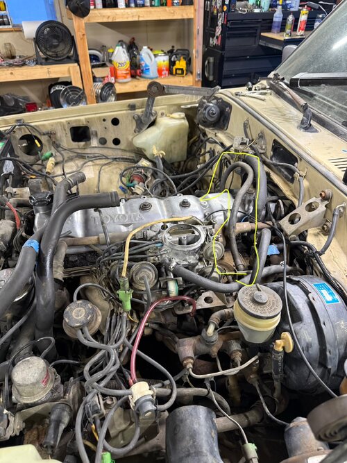

I got her running and actually idling pretty well. Just as I was about to throw in the towel for the day, she gave me a little glimmer of hope. I know it's gonna run rough for this tank however it no longer only runs on the choke. I replaced nearly all of the vac lines, and noticed a line that goes over the engine and to the other side, initially I thought it was a breather but then I remembered it carried over to the other side. Pics related! Also, I’m fairly new to the 80s era of cars what’s the valve that’s attached to the end of the line highlighted? As soon as I put that on it idle and I have a full range of power from the carb! Super grateful for @timmbuck2 for allowing me to run over to his FJ60s for misc parts and for things like reference pictures. The emissions control manual came in clutch but I’m still lost when it comes to each parts purpose. Time to have a cold drink and watch a movie! 🍻
The yellow circled affair is the PCV valve and hose - 'positive crankcase ventilation'. The hose and valve maintain a vacuum on the crankcase to pick up vapor and blow-by from the engine, keeping the oil clean. The system also prevents liquid oil from being sucked up the hose into the intake.
The PCV valve (which is press-fit into the side cover and has the hose attached to it) should rattle when removed and shaken, and should pass air in only one direction. The system is pretty bulletproof on 2F engines, but should be left in place and not deleted. The valve can be cleaned, but if extra scuzzy, should be replaced.
Good writeup on the history and science of all this: https://en.wikipedia.org/wiki/Crankcase_ventilation_system

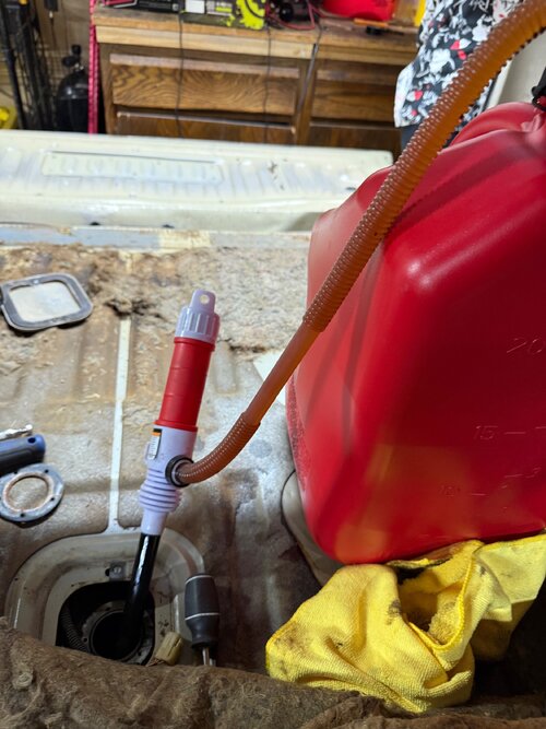

Took a little break from the 60 since returning to work yesterday. Tonight I popped the fuel sending unit out and it’s totally fried. Now the grand question, where do I dispose of 15 gallons of absolutely gnarly gasoline?

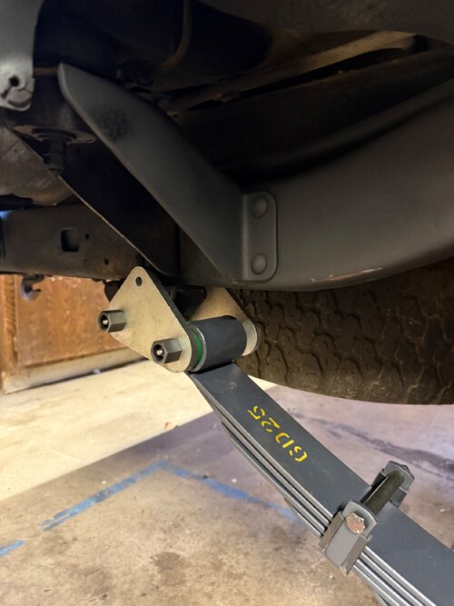

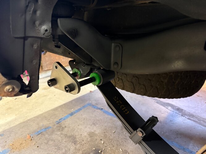

Alrighty! The fun stuff.. I’m working to install my OME CS001R on the 60 and for the life of me I cannot get the rear shackles to align properly. No matter how hard I try, even jacking into the frame with the spring it just won’t align properly. I’m at a loss here.
RDub
Feb 9, 2021
480
Boulder, CO
Are you talking about fore/aft or lateral alignment? When I installed my OME springs on my 60 I did it by myself and battled the rears for hours before finally getting both hung. Unfortunately, I can’t remember how I did it or what the issues were, I just remember being immensely frustrated by it and feeling totally worked at the end of the day.
LoafNvi733
Wincher
Nov 17, 2025
73
Well, after more digging and a lot of b*tching i learned these springs are not for a 60… but they fit a 40… what’s even more frustrating is I verified with the VIN that these would fit. This is the closest I could get before calling the part shop I bought from.

RDub
Feb 9, 2021
480
Boulder, CO
That explains it! Sucks, a lot of work down the drain. Sorry, man.
