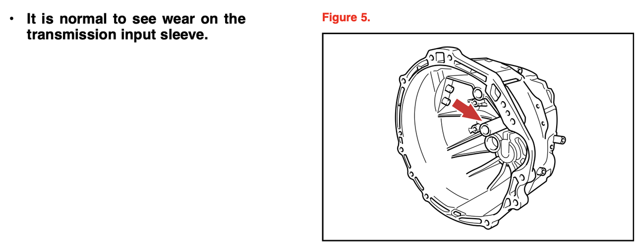

Knowing gear ratios aren't important to the gear whine, if that's what it is. I'm not convinced what you're hearing is really whine but some sort of yet indefinite mechanical noise. Gear whine is a fairly specific thing and you really can't "fix" it without addressing the gear faces and shims, some which is just the way the gears are cut in the end. All gears could be more noisy if they're new breaking in, exceptionally worn out, the lube is low.
Like the transmission and t-case, axle gears wouldn't just suddenly start making offensive gear meshing noise. For the bulk of their life they just make the noise they make.
Something has to change, a tooth breaks, bearings fail, synchros wear out, you run dry, etc for a sudden change in sounds. It can happen. Yet you changed the suspected offending element, so it shouldn't be the clutch, transmission gears or bearings. Unlikely, not impossible though, to have a defective new part or subsequent damage due to a mistake. You'd think none of this is the first time for these mechanics on this. The issue goes back to 2005 on the Tacoma.
I don't know anything about the TSB year updates on the clutch. If it doesn't cover your model year then it means it's not a potential warranty issue but like you say at this point the issue is at least a decade old and endemic to all RA6x and they should know that. Why it would matter if you're paying for the work I have no idea.
That said, the TSB isn't really helpful on the wear and says it's normal without defining any criteria to judge severity. A little bit isn't an issue so ultimately it's left to the experience of the mechanic to know if the grooving is bad or not. I'd think the dealer would not be interested in aftermarket solutions here such as the repair sleeve.
FWIW I also attached the most recent revision of the needle bearing TSB for your reference. Lift is a red flag for suspecting that IMO.
I went from the stock needle bearing to the ECGS sintered bushing and recently went back to the needle bearing. I didn't get any more miles (about 50K) from the ECGS solution than I did from the stock needle bearing ultimately. It's more of PITA to get the ECGS bushing out than the needle bearing so the repair is easier doing it the stock way.
