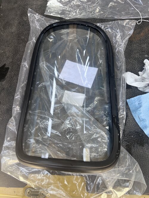

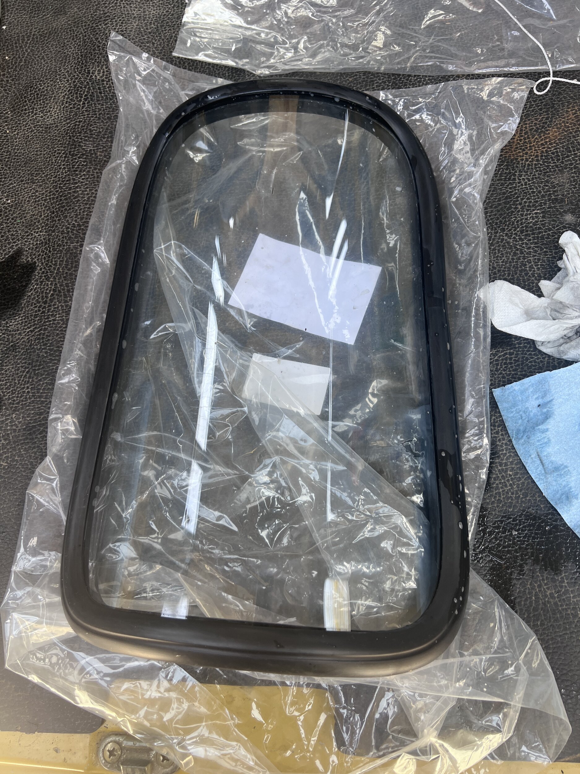

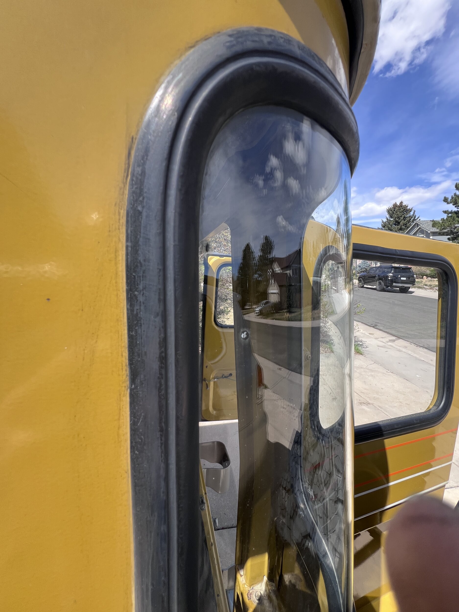

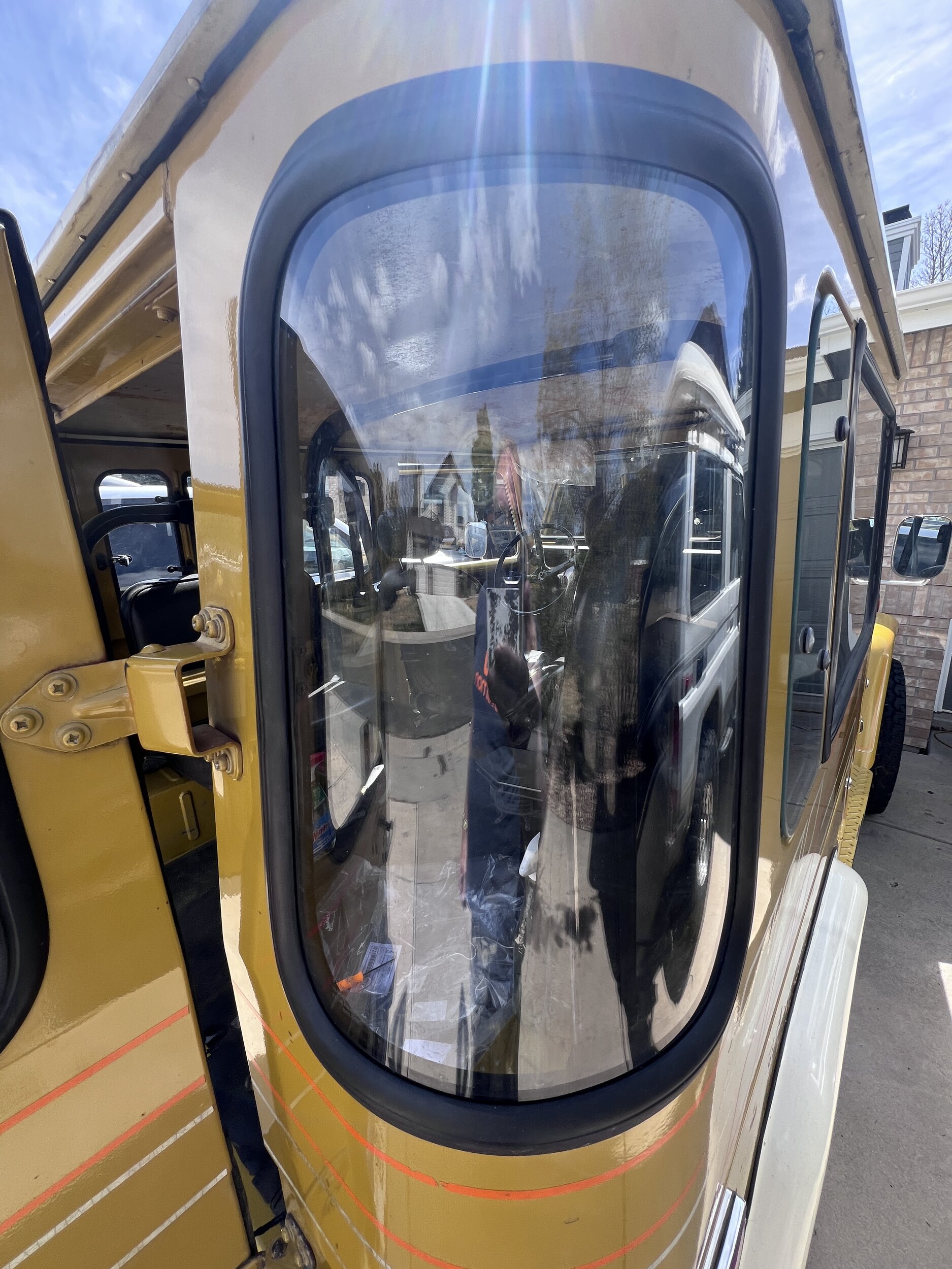

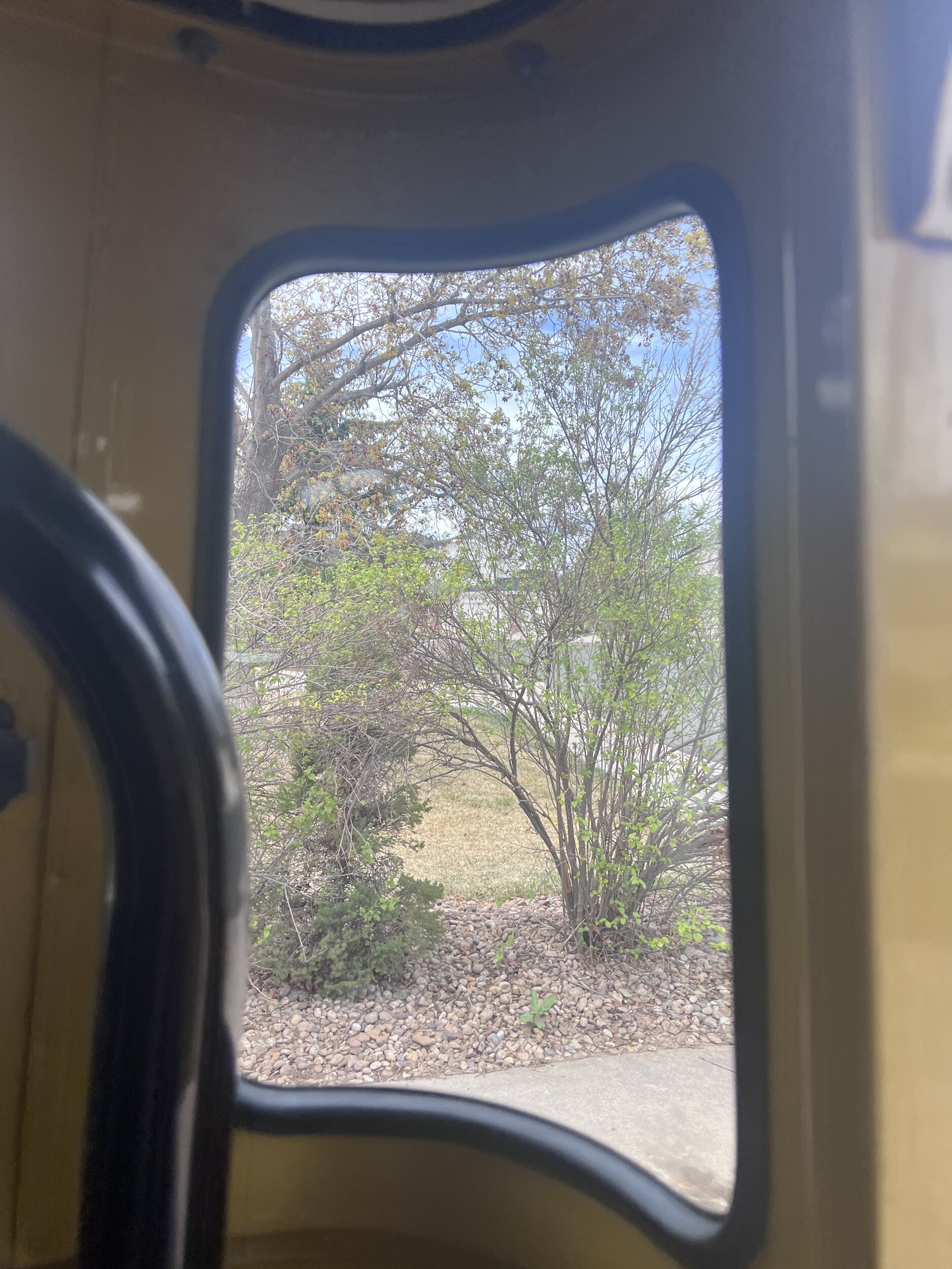

I replace the corner window rubber gaskets. All the rubber gaskets are deteriorating. Corner windows up the anti keeping the rubber on the window and then inset vs flat glass. But, overall I did it without help.

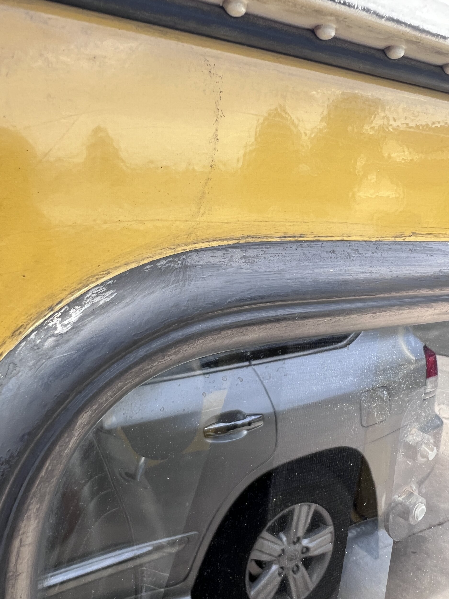

You can see how deteriorated the rubber is and touching it gets all over. Next up is the side windows once I get them in.

That rig is gorgeous! Nice work on the windows.
5,476
Fresh rubber on the corners is a special treat. That 40 is so nice!

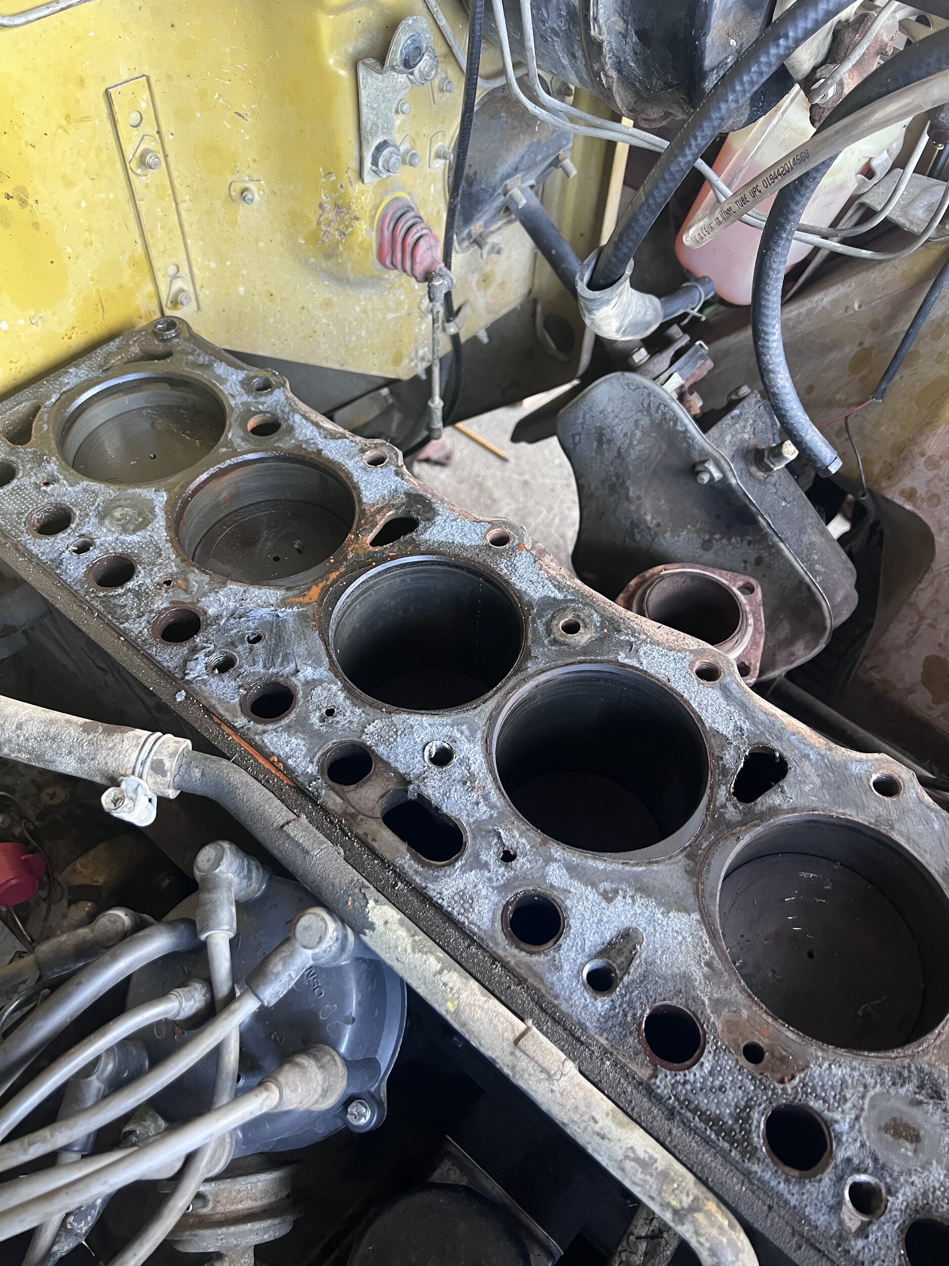

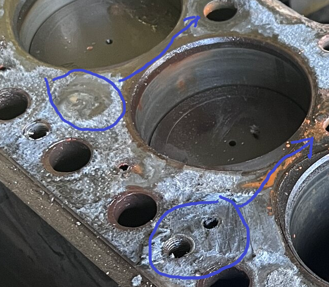

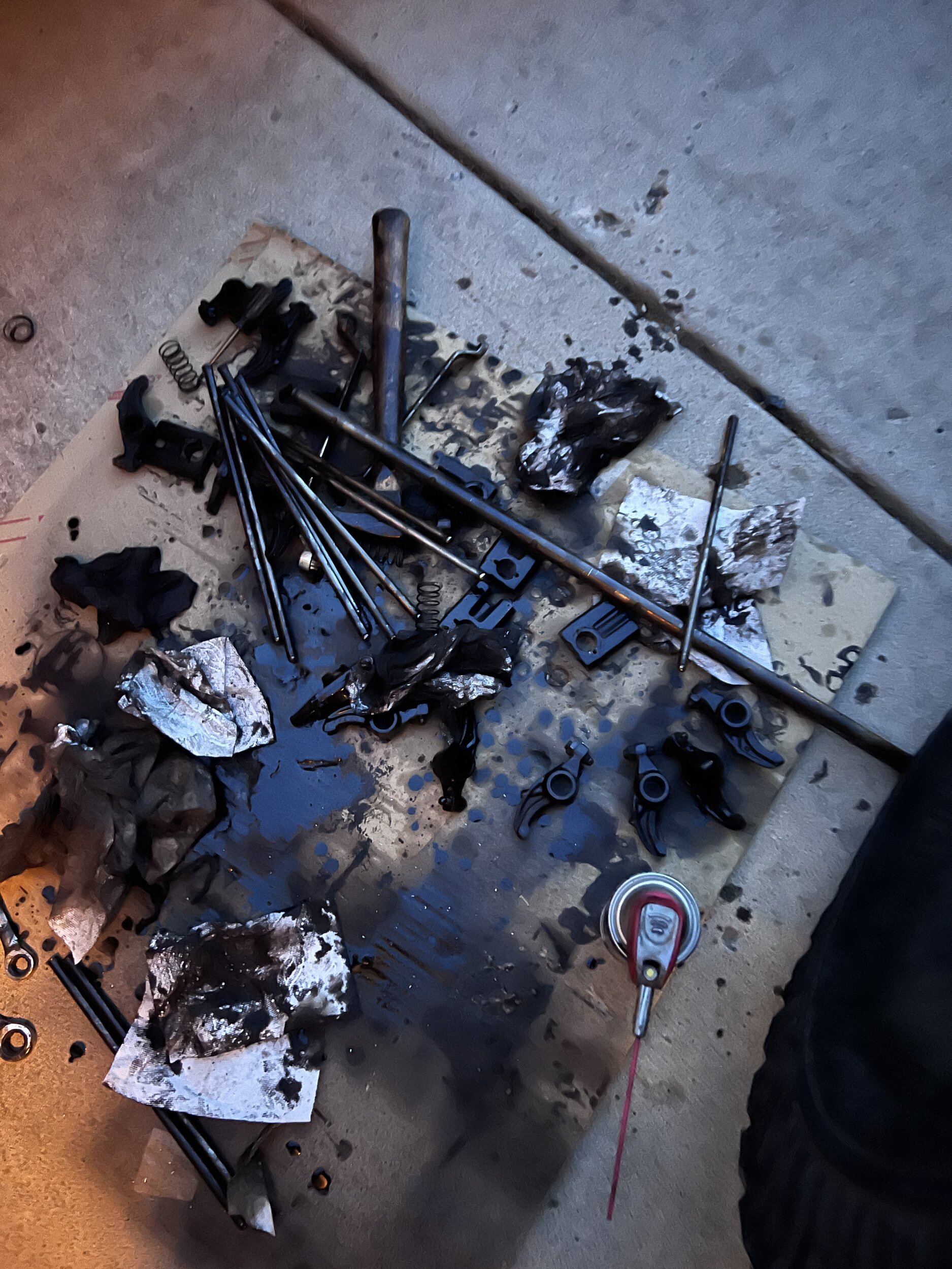

Well, I have some weatherstrip and fun stuff to show but before that… two steps forward one step back. Anyone spot the Issue?

Cracked head between 4 and 5?
RDub
Feb 9, 2021
521
Boulder, CO
5 and 6?
8,960
in da house
Correct, The bottom circle is the oil feed to the head so the head gasket was installed incorrectly previous to me. If you look between 2-3 you'll see the correct relief for the oil feed...

Glad you caught it. Frustrating to have it happen. Did you end up pulling the head because the rocker arms were a little louder than normal or did something get stuck?

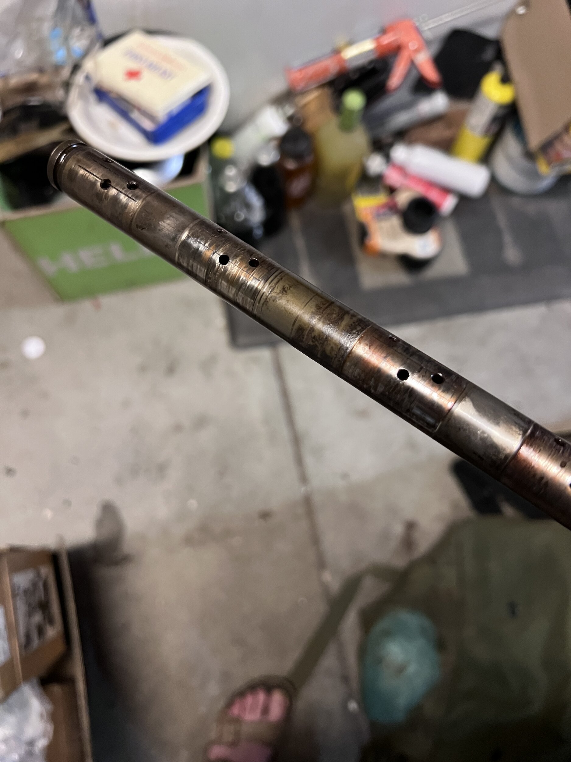

How's the rocker arm assembly look?
