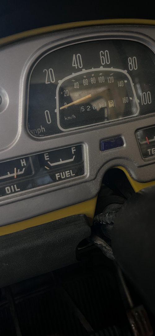

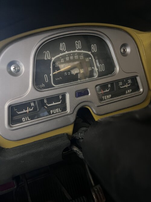

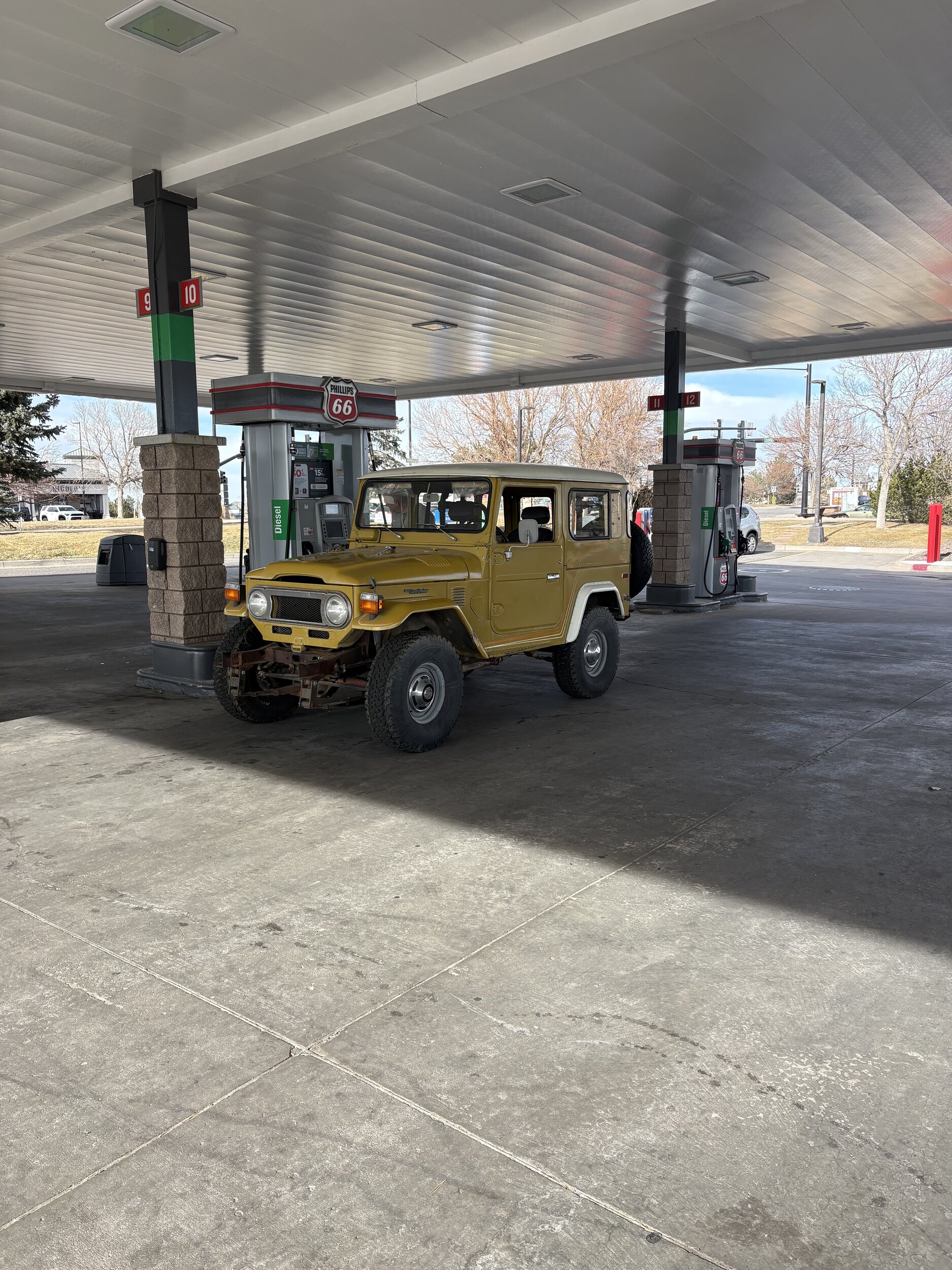

Maiden voyage to the gas station
Out of the garage for the first time

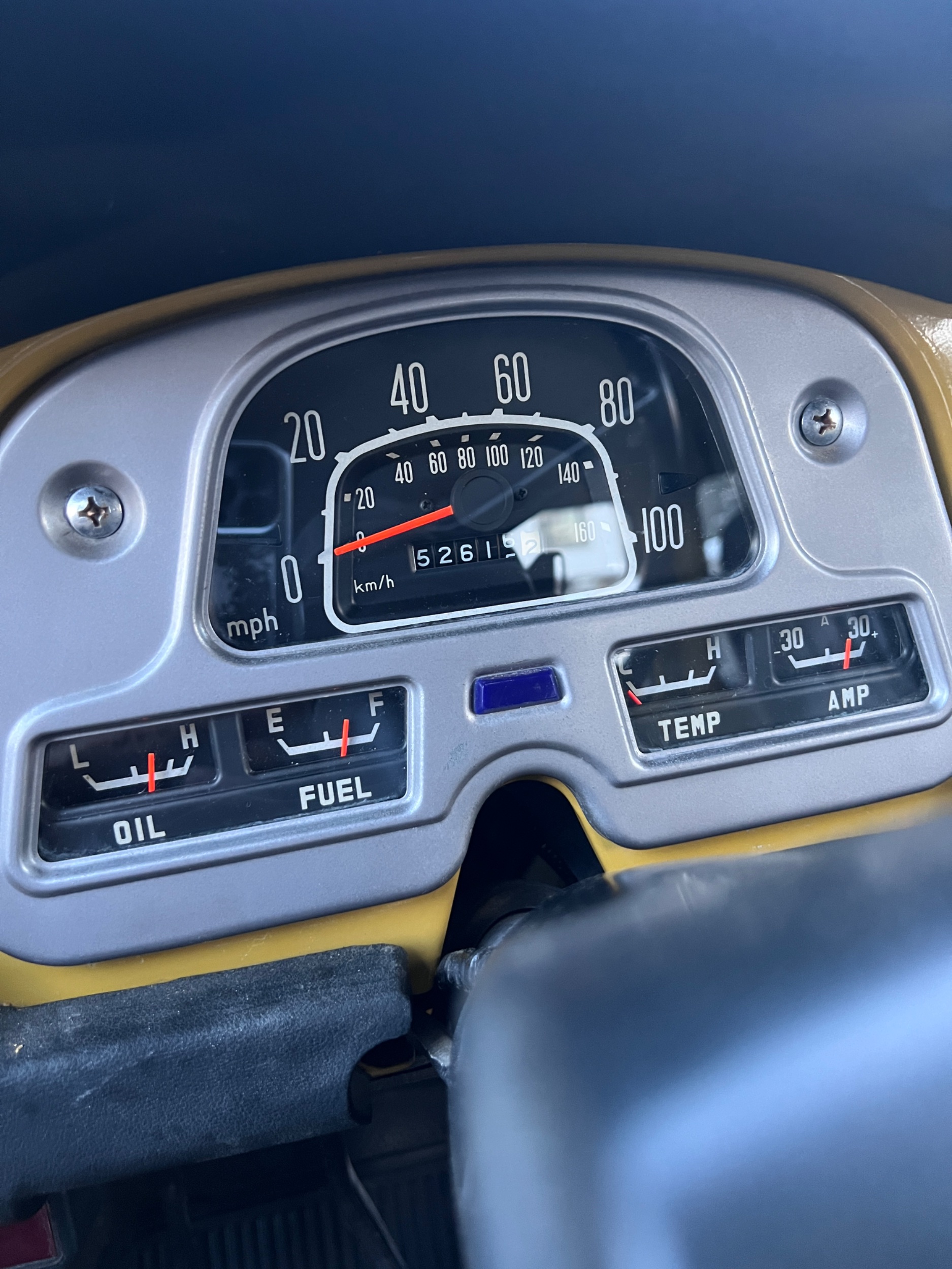

Good oil pressure and temp gauge working.

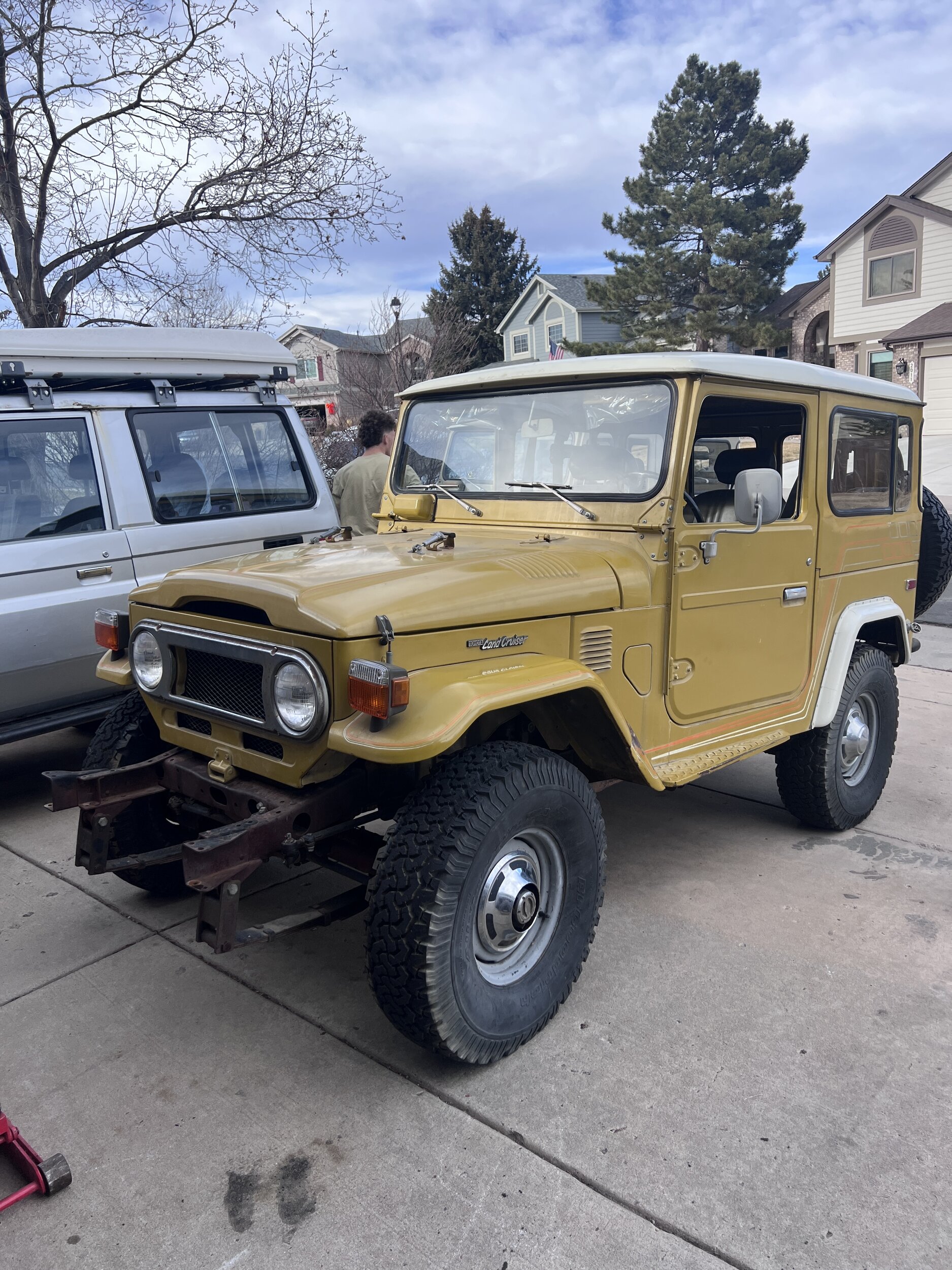

Well, Wyatt thinks I like working on them more than driving them. I really did like this project because I was using a later 83 2f but making it look period correct and grafting them together. The plan was to use 1977 ignitor and distributor but I could not deny how much nicer the big cap dist is and it's better matched and more efficient to the later flat top piston engine. I'm happy I kept that slight change.
I still need to tidy a few things up in the engine bay. I need a short side rad support rod, fan shroud, mesh to put the TOYOTA emblem on. Fix the turn signal wiring on one side. I should replace all the vacuum hoses.
I have door and ambi door weather stripping to install. That's mostly next.

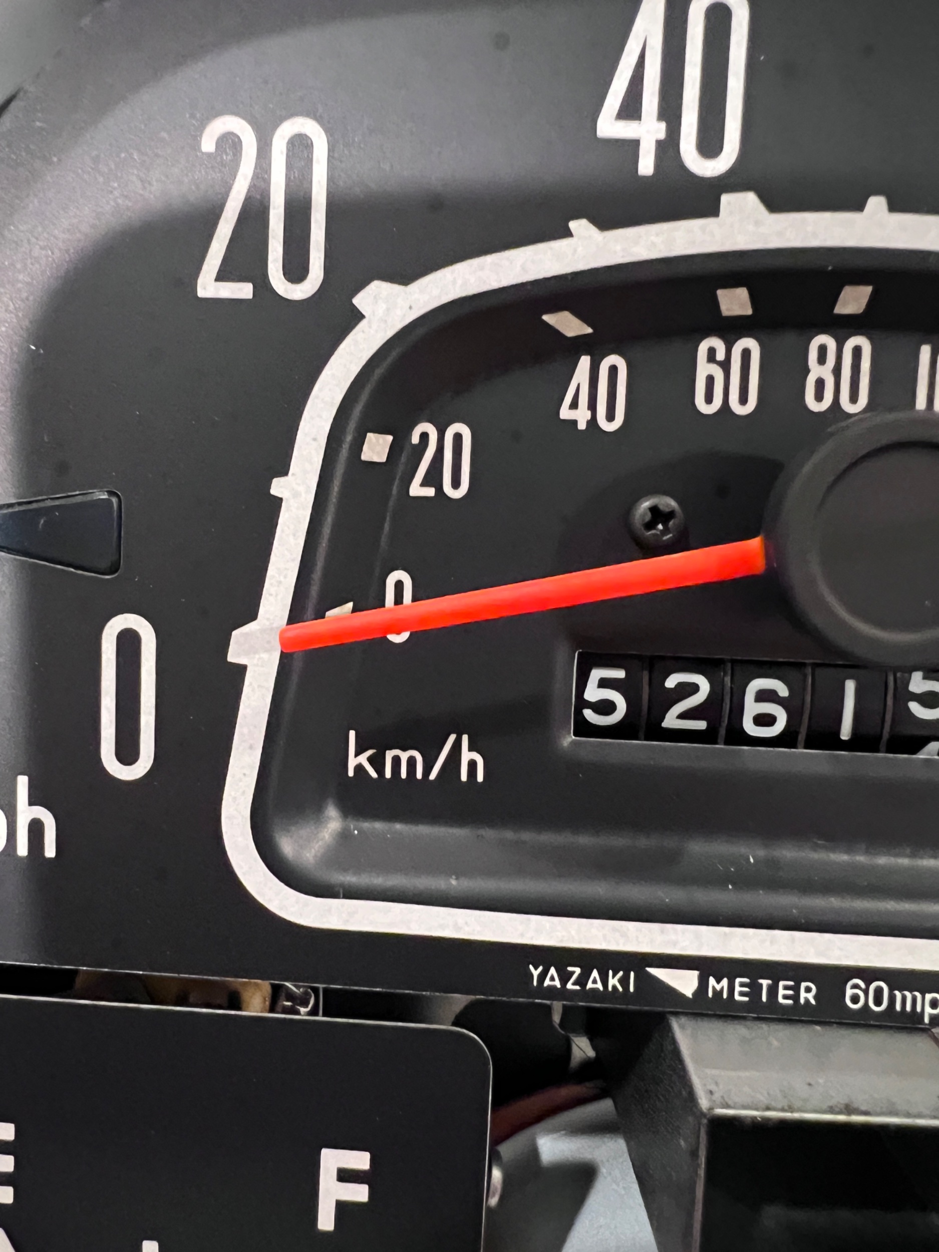

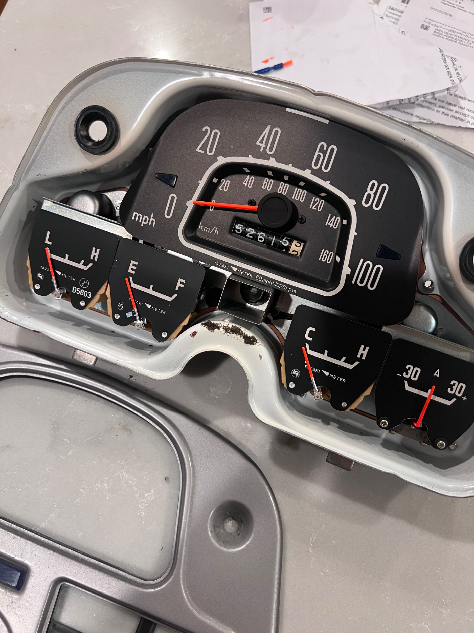

I'm on the fence about painting the instrument cluster needles. It's a balance of patina and cleaning things up.

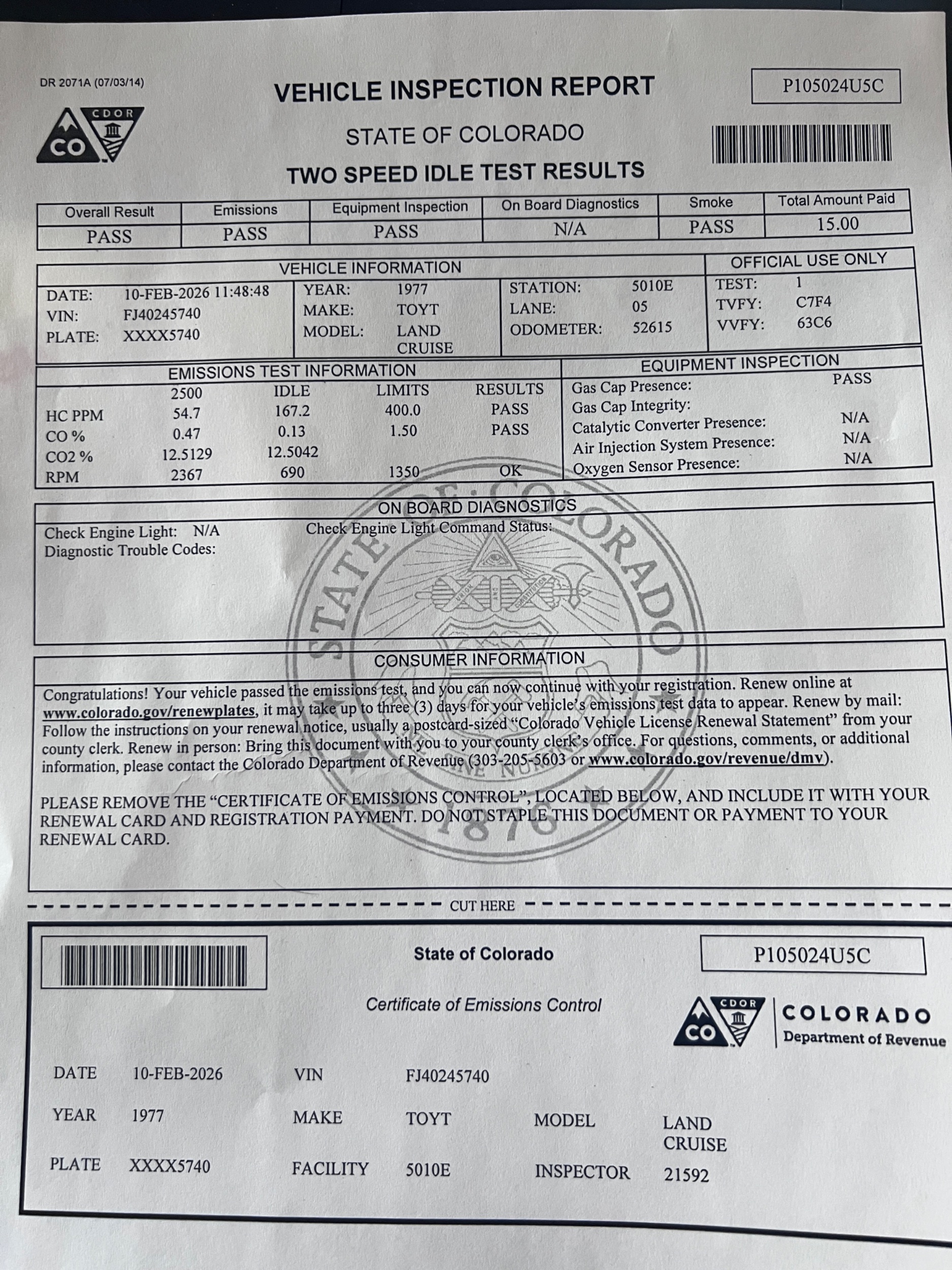

He’s legal.
Got lucky, this engine runs really well and I set it at 7*tdc for emissions test. It was a little advanced before hand. The vacuum guage reads 16 steady which is a good indication of health as well.
I can confirm they didn’t lift the hood for any visual and they only verified the presence of a gas cap before the 2 speed idle test.

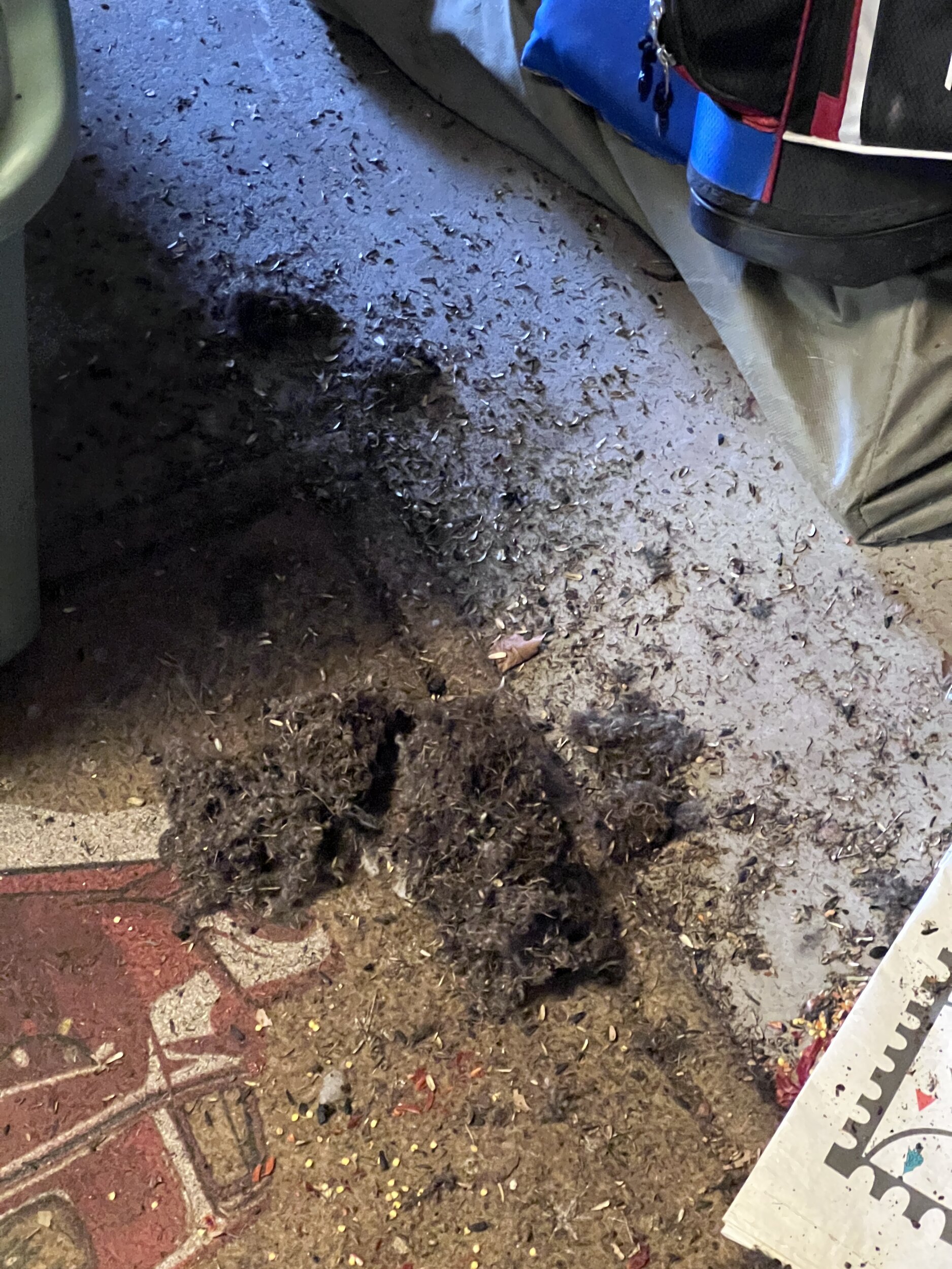

I think I need to clean the heater core. It’s a wonderful mouse 🐁 piss smell 🙄. I guess the 2 speed sniffer doesn't test for hantavirus...

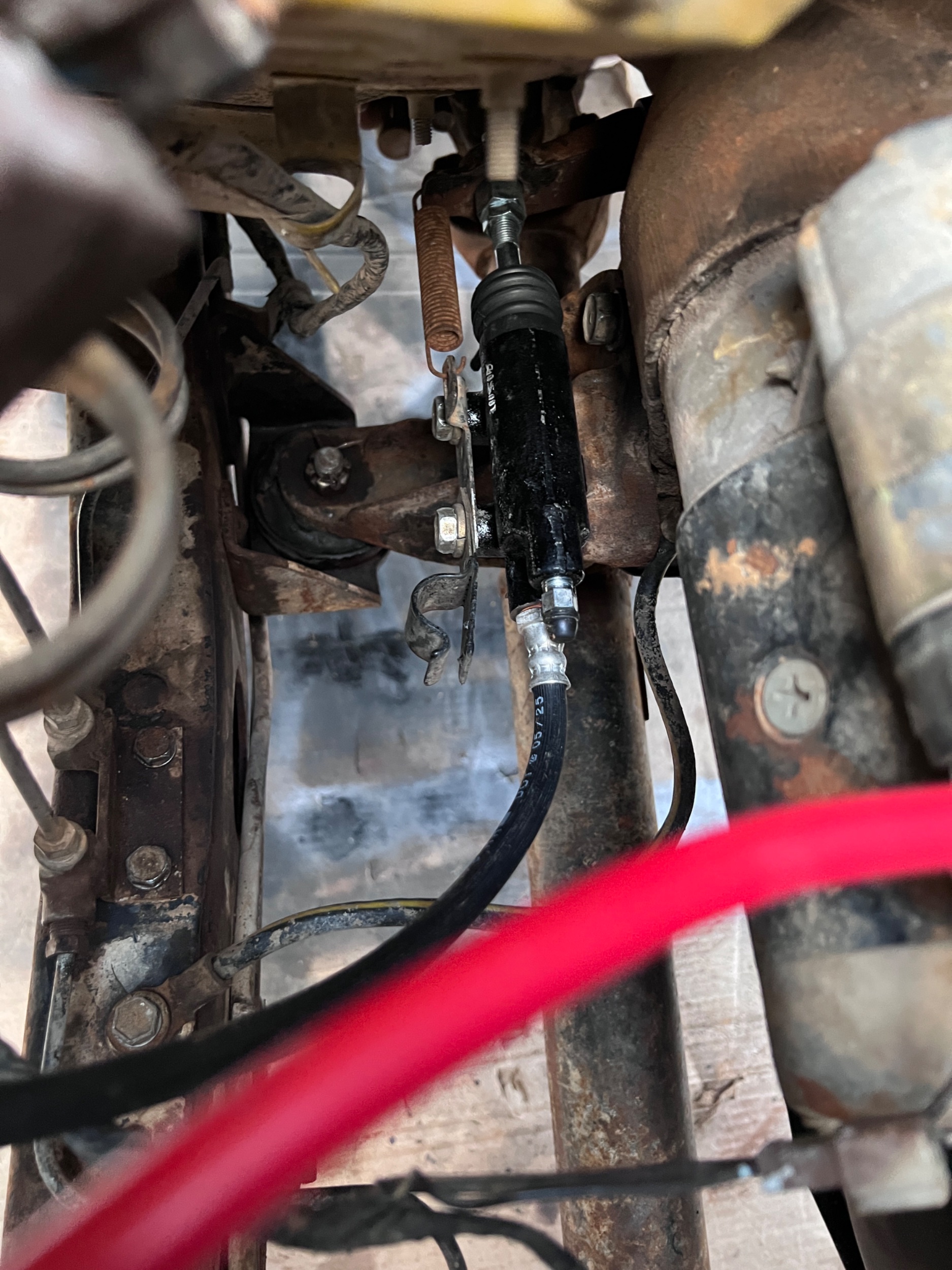

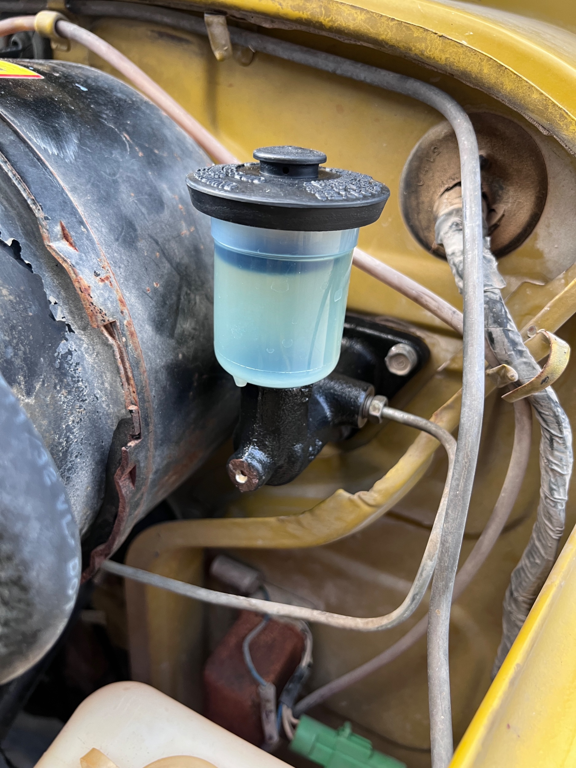

It only took a week for the slave to go out. I tried to clean it out but it kept leaking. The clutch master started to weep just slightly as well so I replaced the master, slave and hose with aisin.

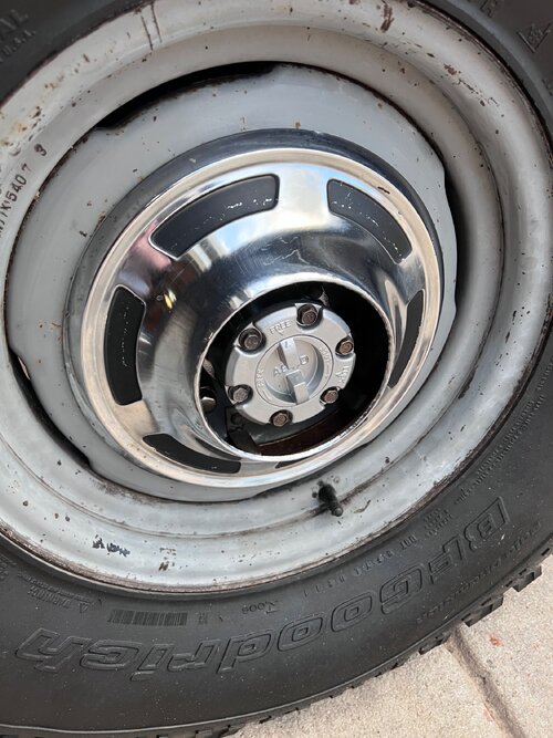

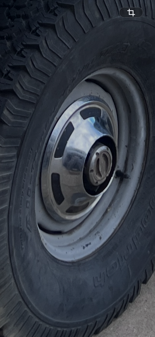

The warn hubs were missing nuts and a few Allen bolts on the cap. The cap came off on the road and I went back and picked it up but it got run over and squashed a few springs. It was a good time to upgrade to some city racer long body repro asco’s

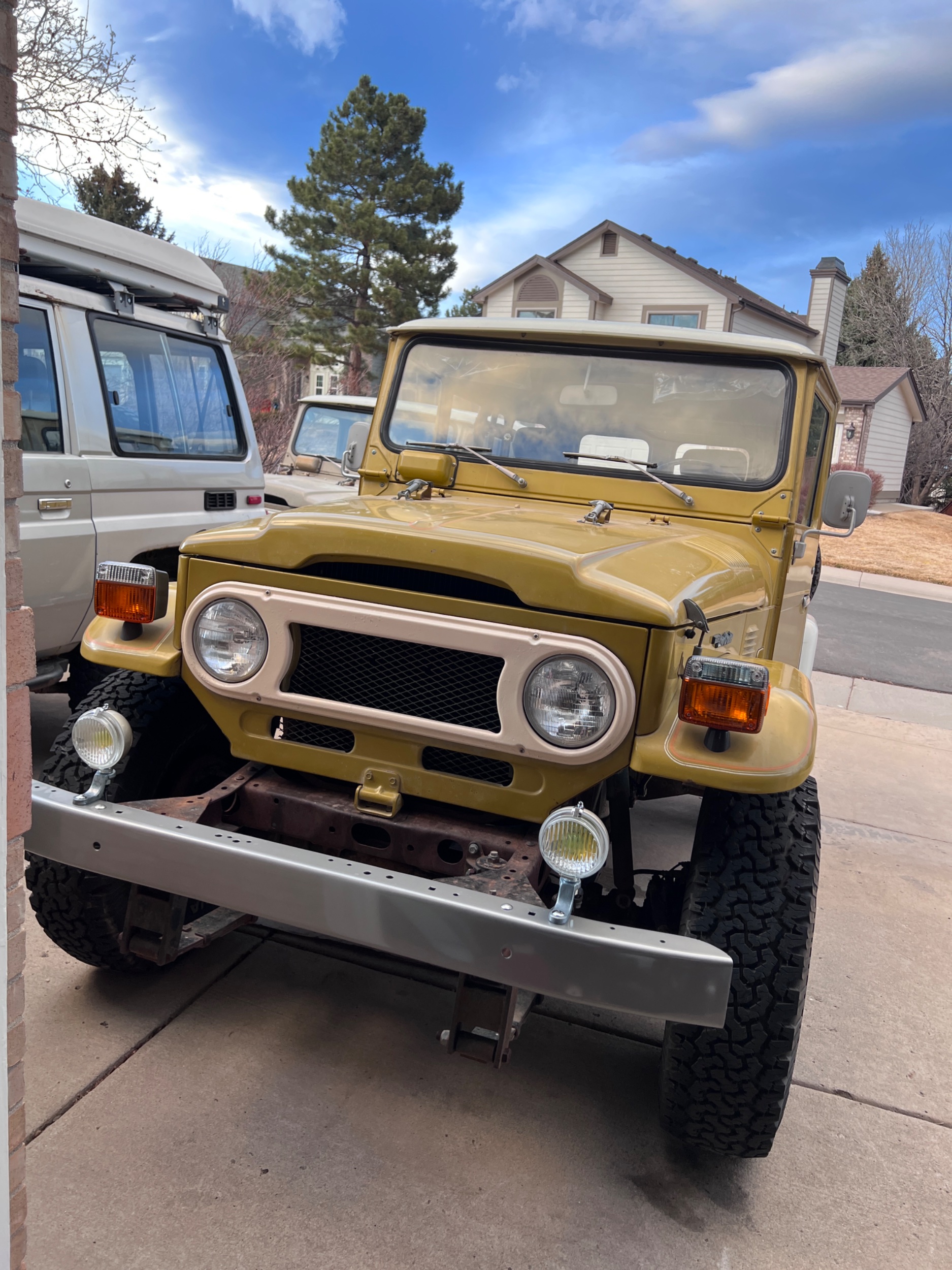

I have some OEM fog’s with an OEM bumper to see how it all looked. We had an extra bezel that was black from the green roller. I tried some rust oleum shell ivory on it. Seems a little creamier than oem and the cygnus would probably match the top and flares better. Long term I'd like to get rid of the flares and weld some metal to get back to stock fender openings but that is further down the road.
