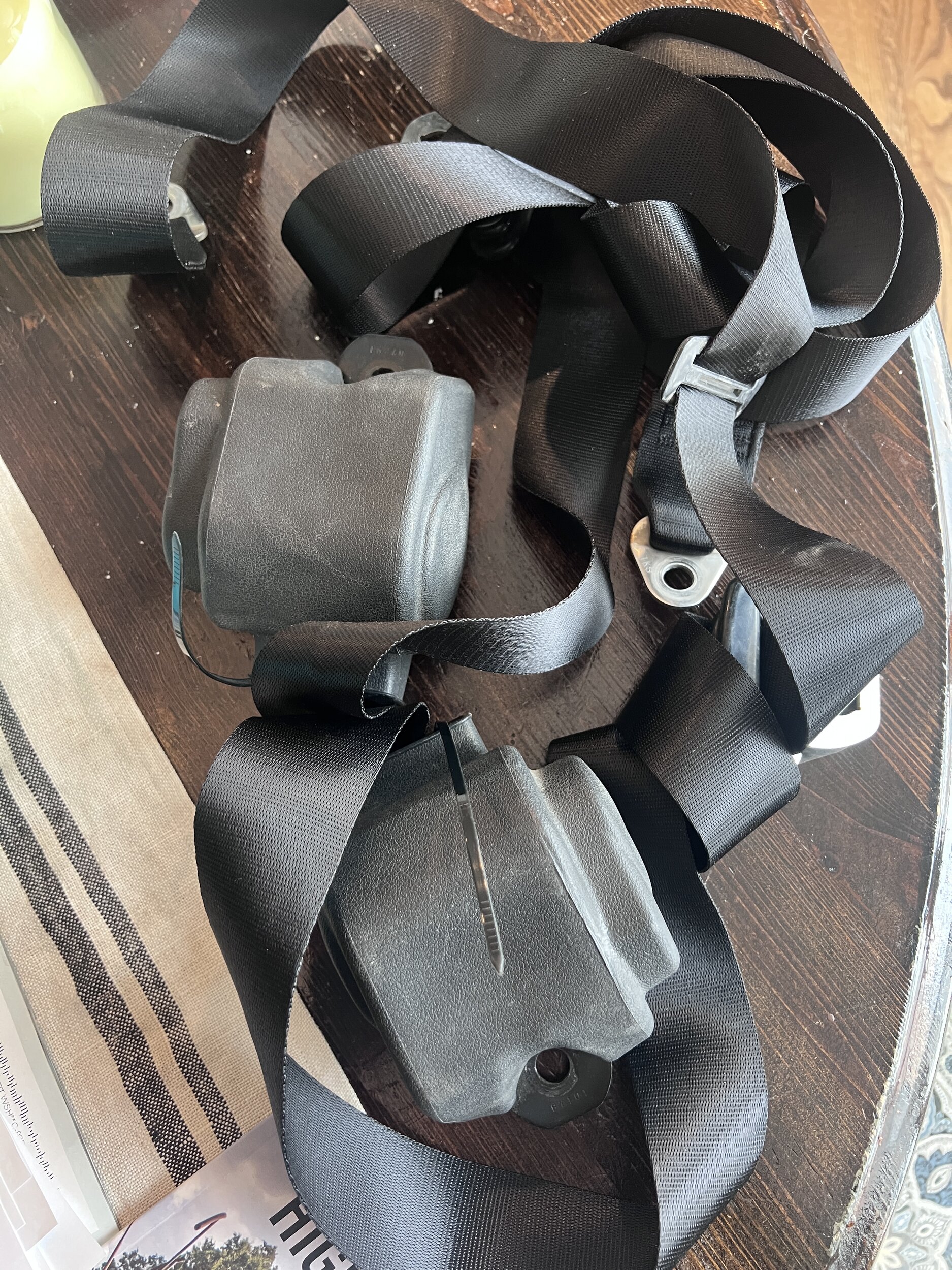

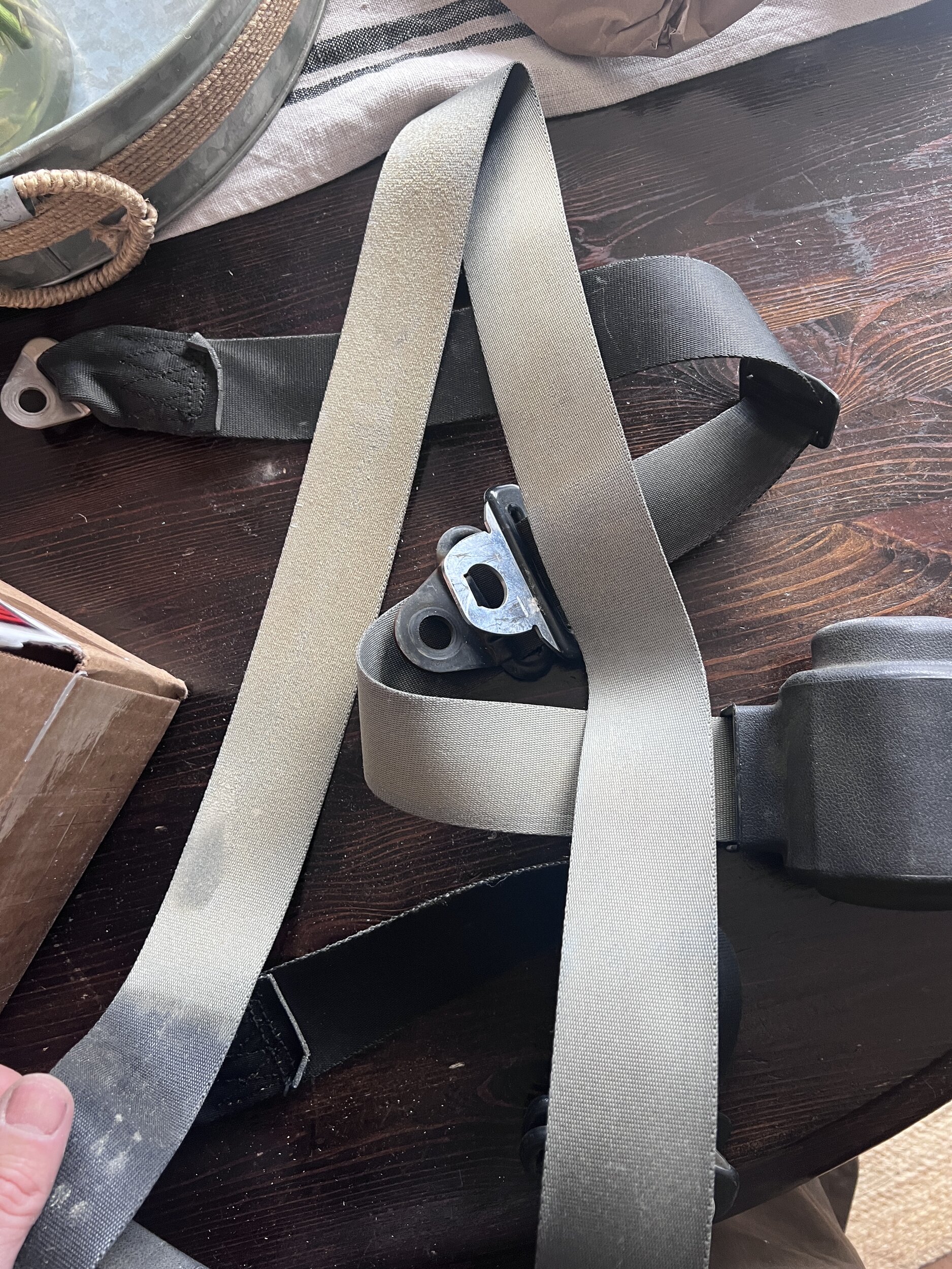

New seat belt webbing. You can see the old ones were toast. It was actually melting and dried crusted up.

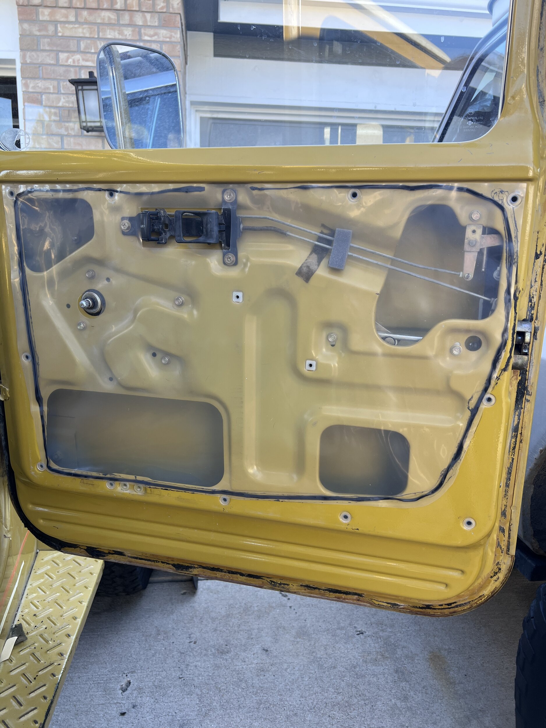

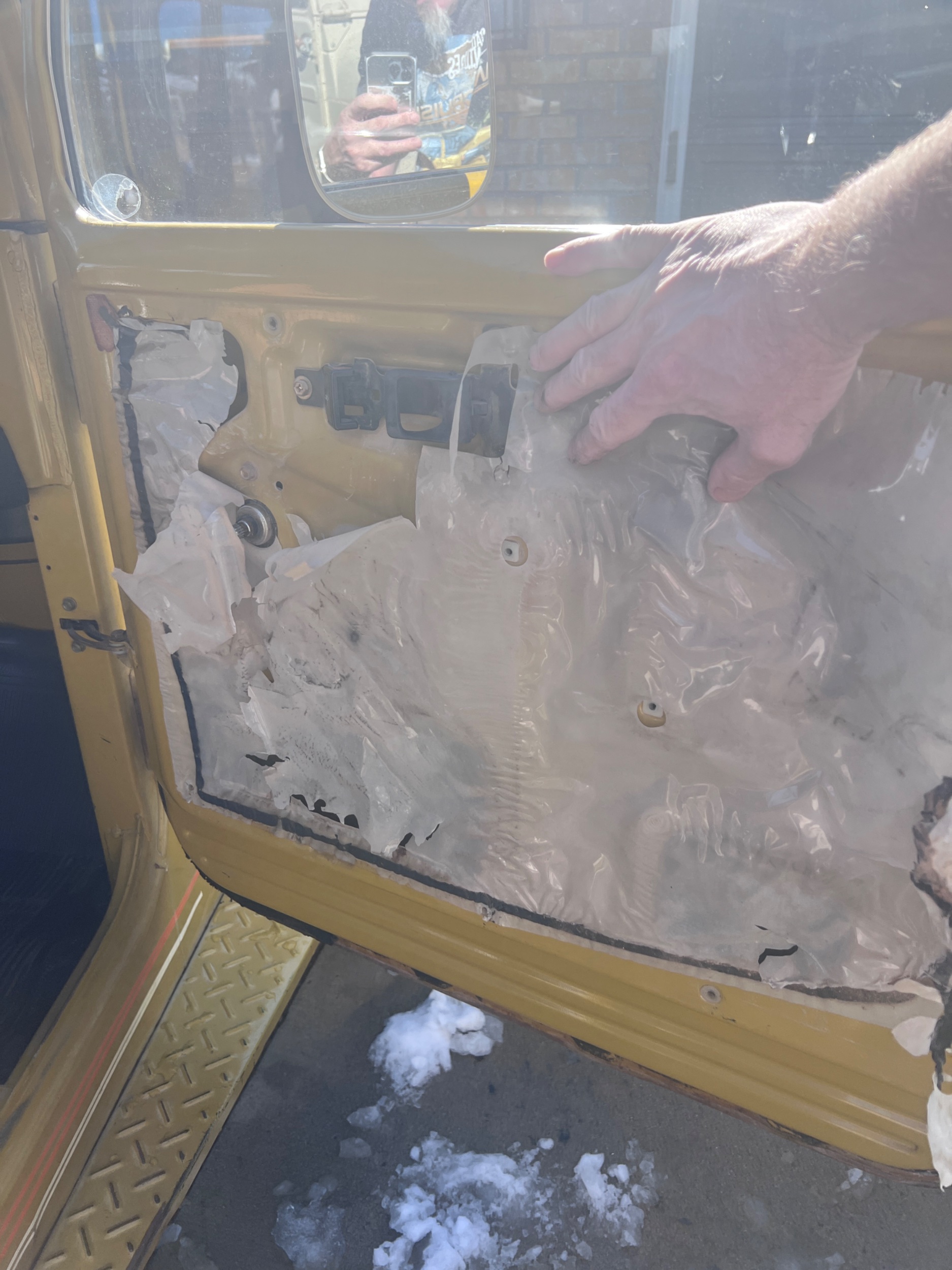

Working on the doors. The cards are in rough shape. There was probably 1/2 inch of dirt built up in the bottom. The vapor liners disintegrating. Cleaning it all up for runs and new seals
8,960
in da house

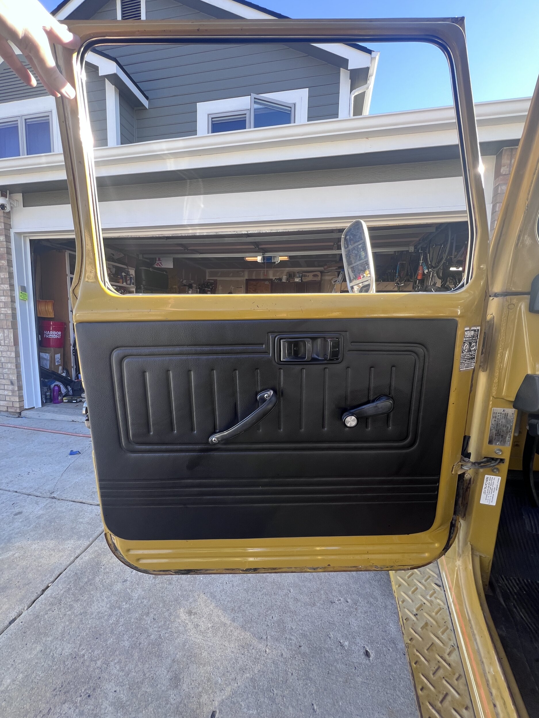

Where'd you get your door cards? Those look gre
These are the legions. I wanted to stay OEM black on this build. We used the grey Toyota OEM on Wyatt’s build. These are very nice and I’m happy with the quality. I’ll have to snap a pic of the vapor liners from GA Architect on mud

New OEM plastic retainers for the door cards, new foam silencer too.
New Vapor liner from GA Architect on mud

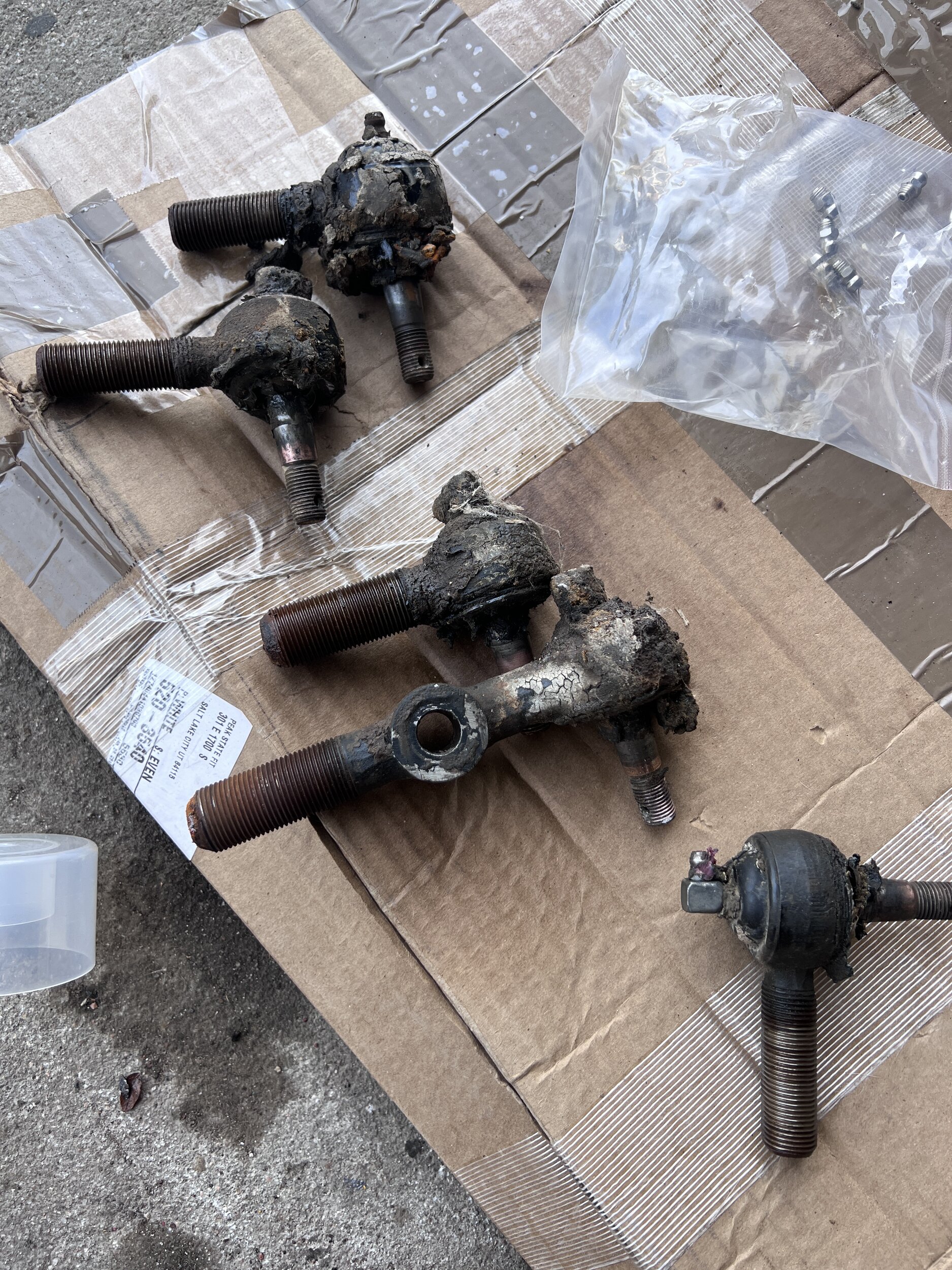

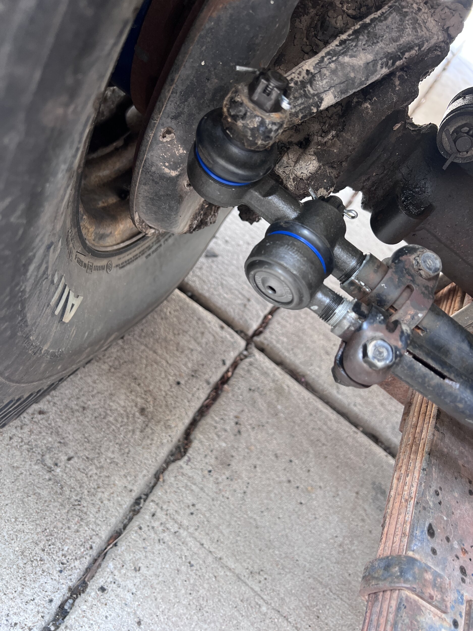

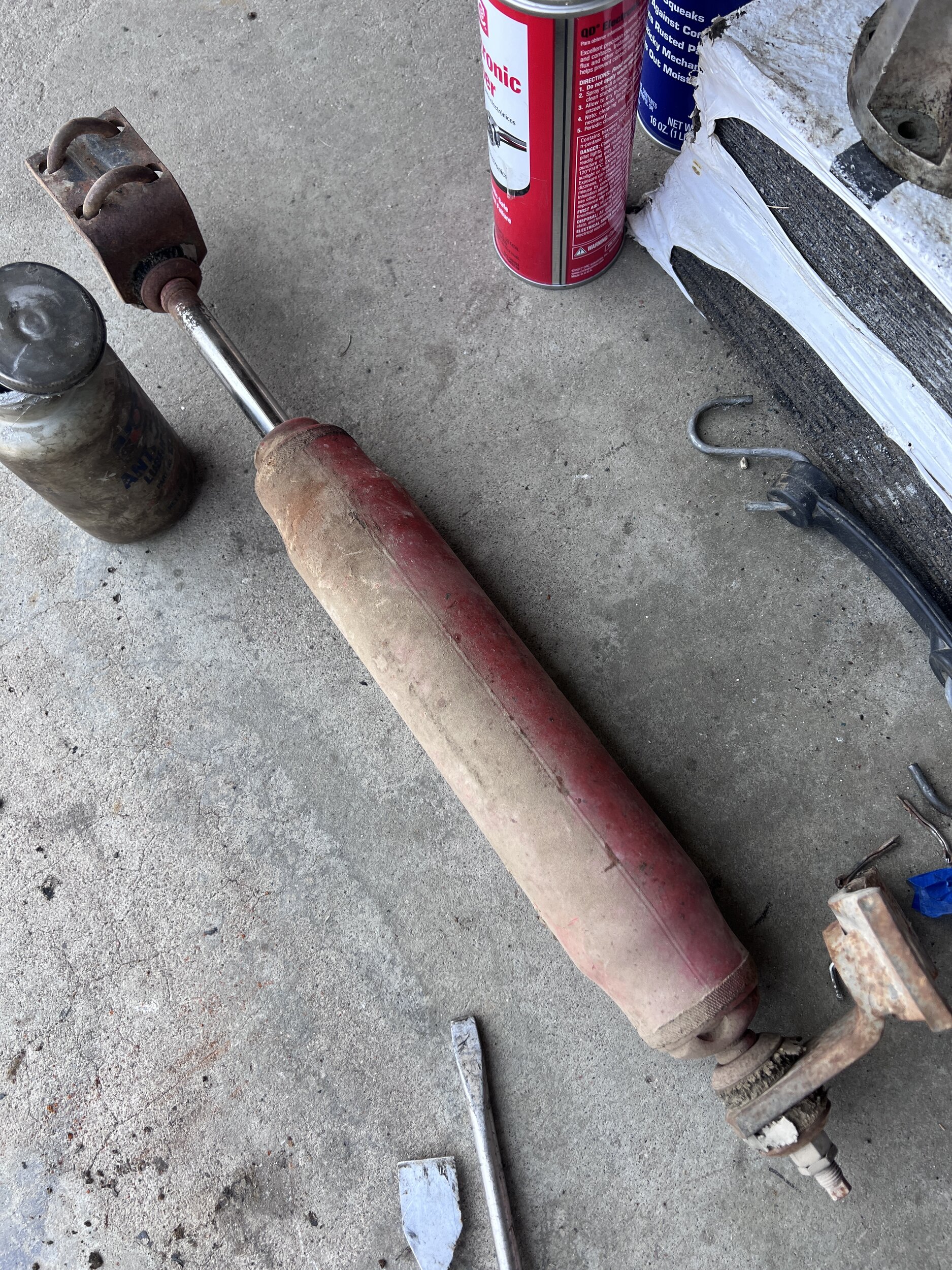

Replaced the Tie rod ends and removed the additional steering stabilizer. I did clear the tre this time.

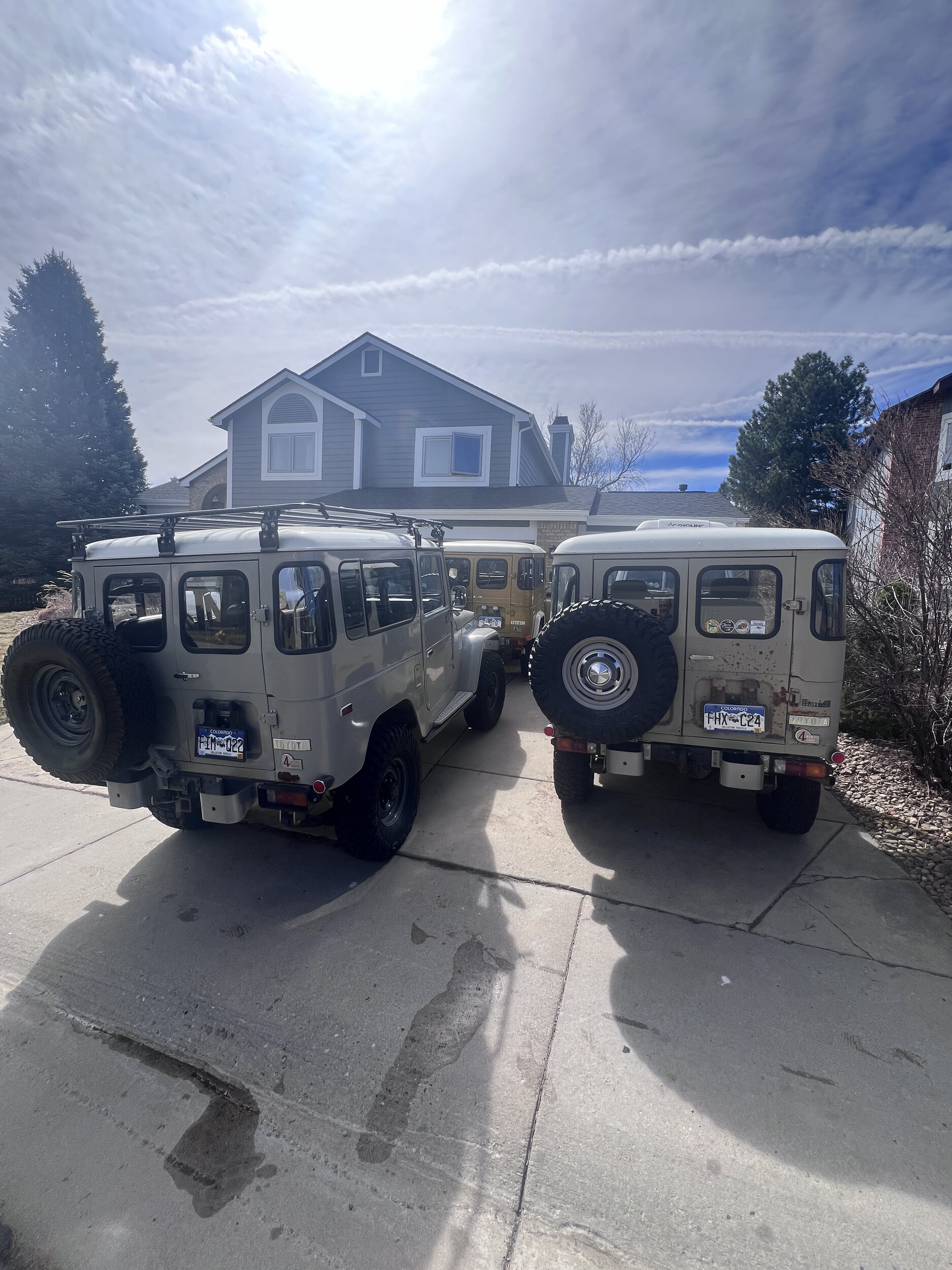

Another 40 stopped by, 76, 77,78 next to each other.

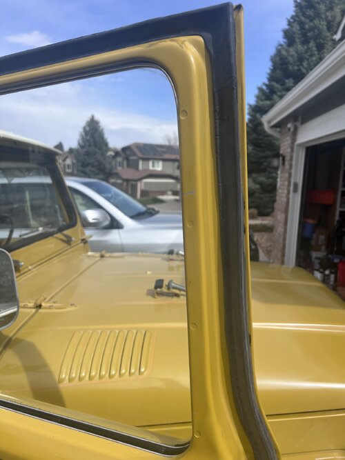

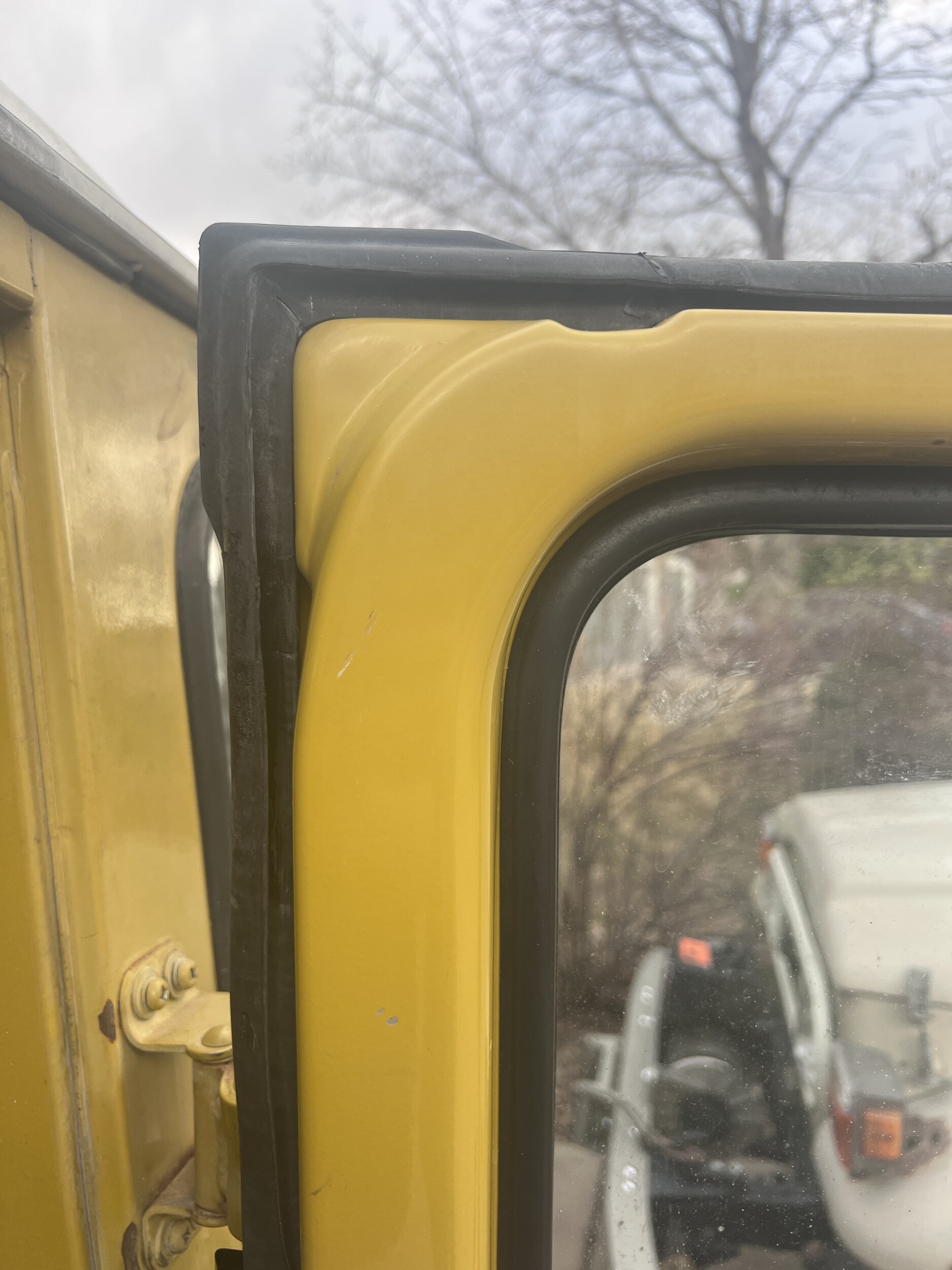

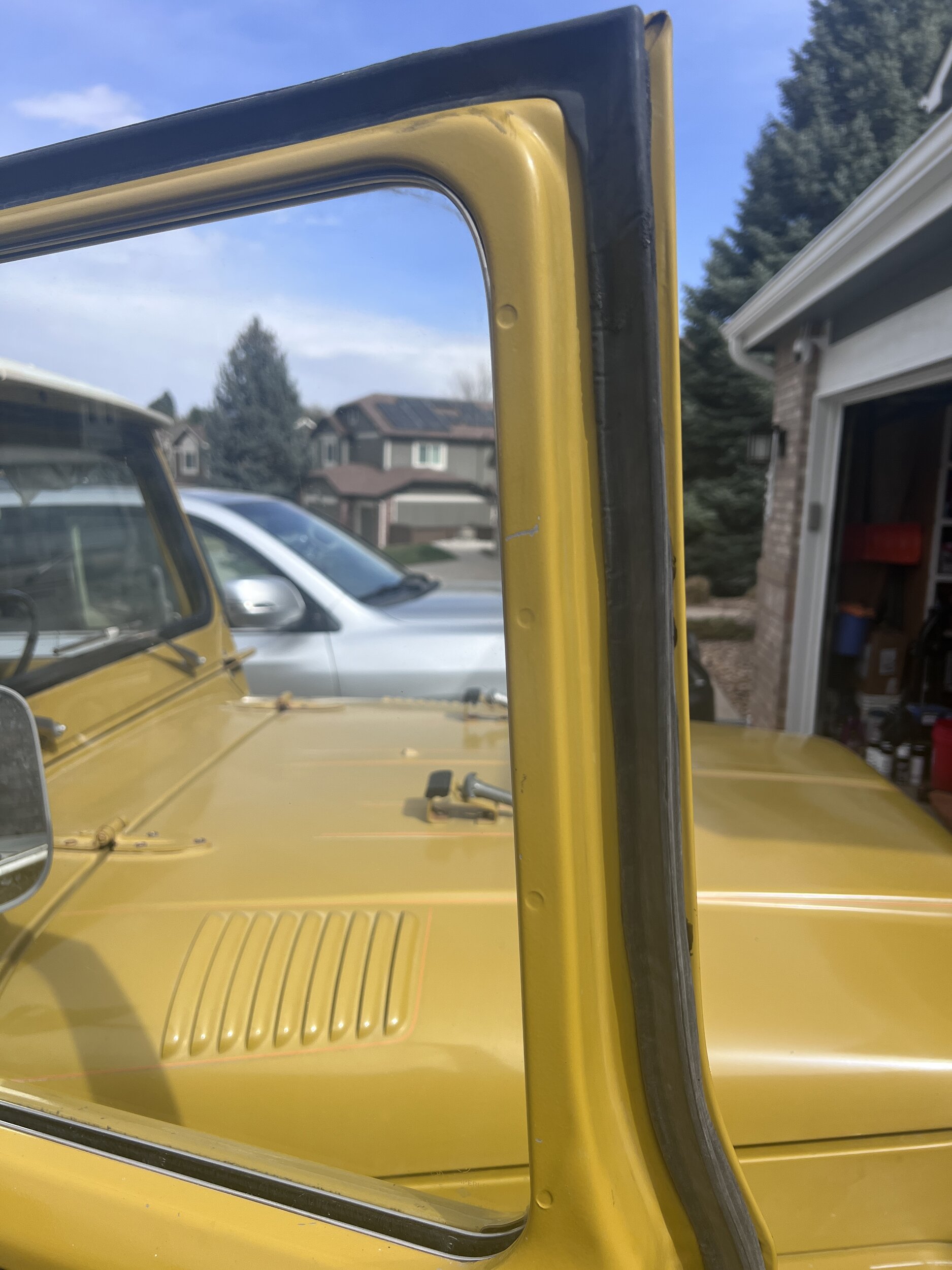

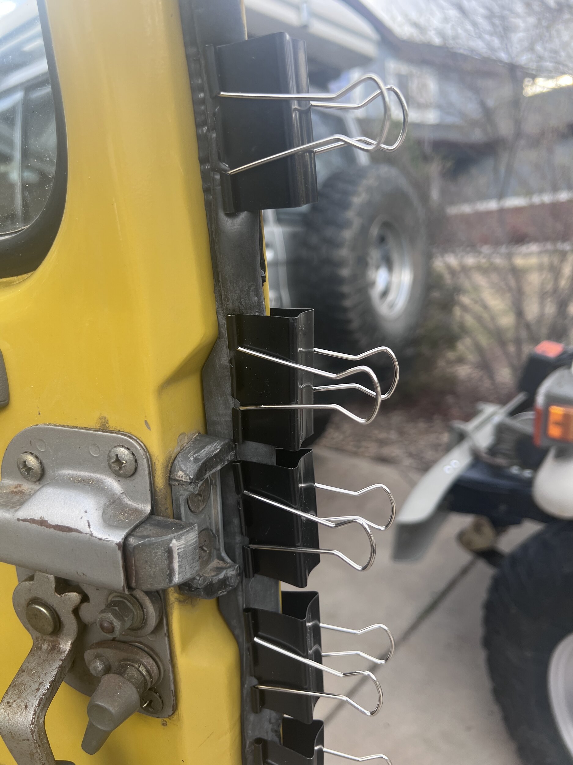

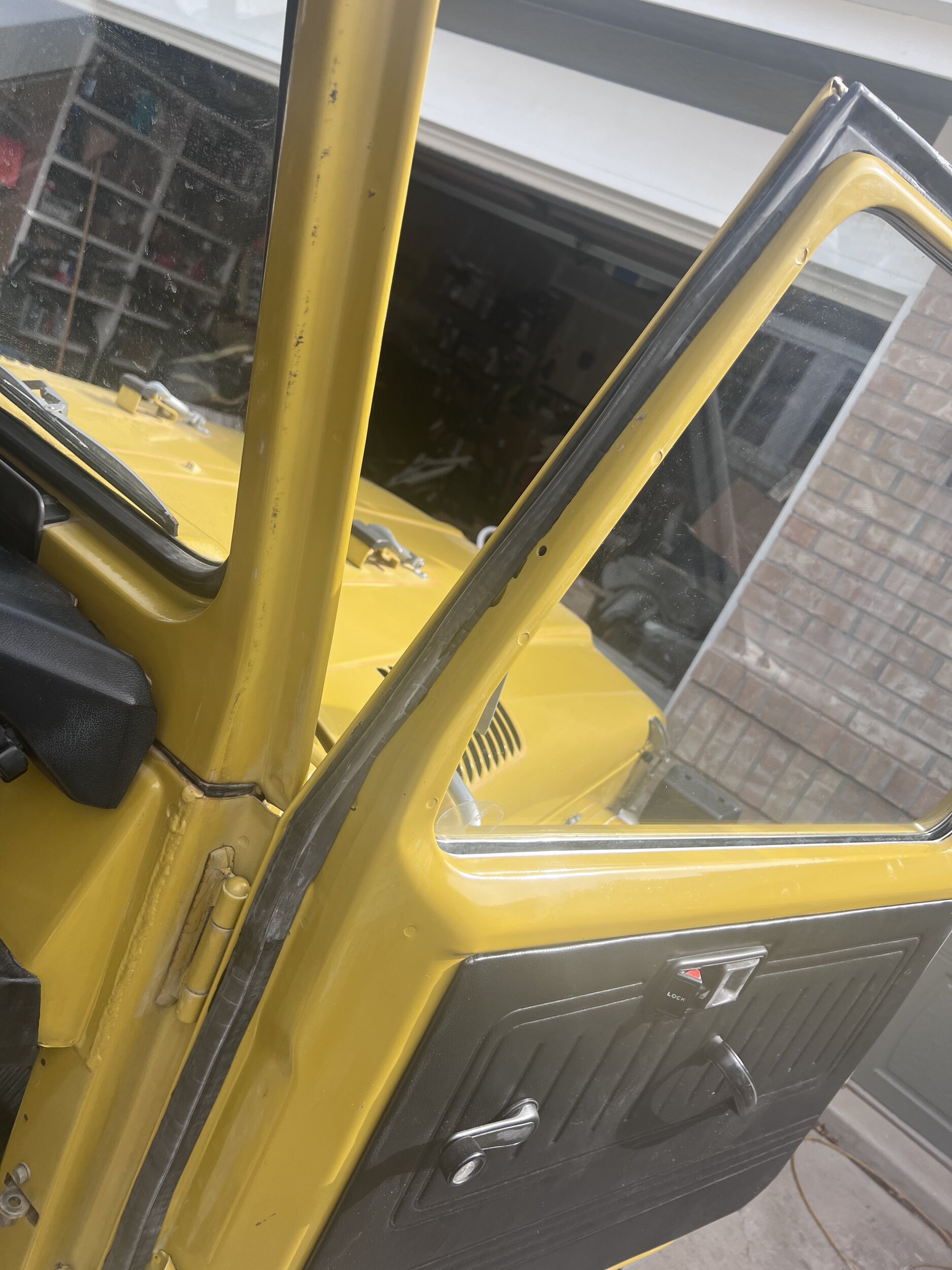

New OEM weatherstrip on all 4 doors. Finally got good on the last one, lol. All the doors are tight and quiet. Previously I have used 3M. This time I went with IC-2000 Cyanoacrylate glue. I prefer this over the 3M stuff now.
8,960
in da house
The applicator bottle you can cut the nozzle to be very fine. One thing I've learned about gluing weatherstrip is less is more. I used the 3M on wyatt's door seal and parts of it are coming off. It was a mess going on which was probably a user error with the 3M but, I've seen more people using this glue lately.

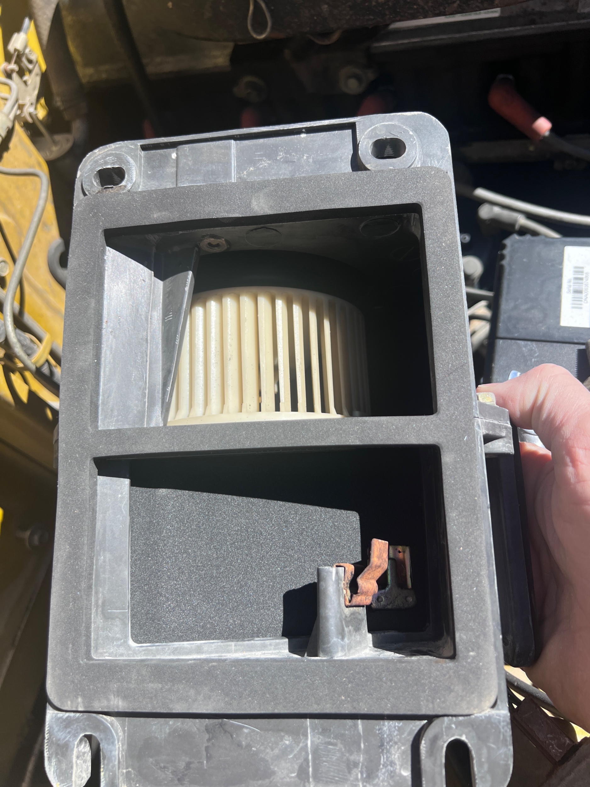

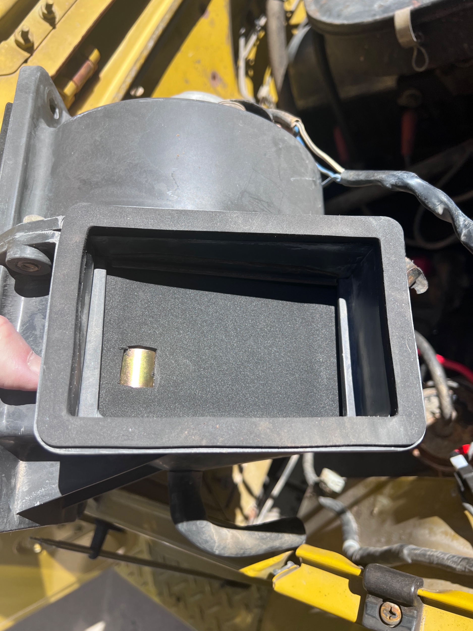

I cleaned up the blower box and replaced the foam and on the tube. Up next is the heater core but I have to drain some coolant. For Wyatt’s truck I used SOR. The foam was too cheap. This time I used partspuzzle on eBay. Very nice precut 1 piece foam. I would highly recommend this kit.
