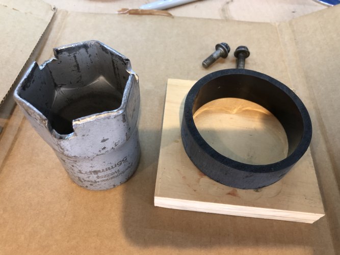

Made two SST's: modified 55mm socket for locknut (works great!) and 4" ABS for inner seal SST - block of wood to spread load, and finished repacking the driver side rear wheel bearings. Passenger side next!
