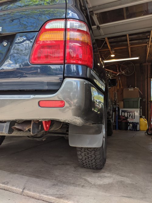

I swapped out the bushings on my steering rack in my 100 series to poly. The rack only has about 30,000 miles, but the previous owner ran 35" tires with Hutchinson beadlocks (~118lbs a corner). It took out the factory rubber bushings quickly. Ultimately the bushings still looked good, but there was just a little bit too much play. This led the rack to be able to shift about 1/4" left or right from center. I have heard mixed reviews about the how long poly bushings should last, so we will see!

Man, that color is AWESOME. :)
Makes me want to bedliner the new 100... but the prep work...ugh. :ROFLMAO:

Do it! I'll help sand. Haha
I still have nightmares about the prep I did on my last 100 - it came out pretty well, but man, the taping and sanding was awful. I need to get some more pinstripes on my current 100 before I go down that road again. :ROFLMAO:
