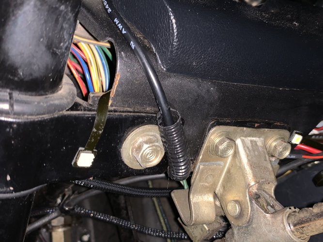

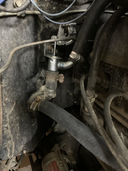

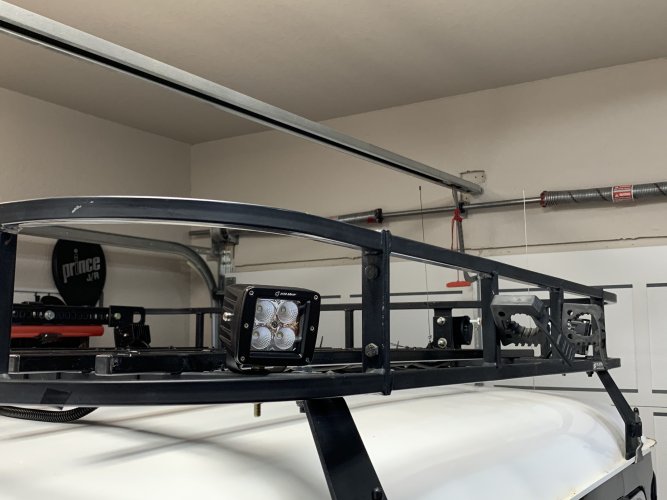

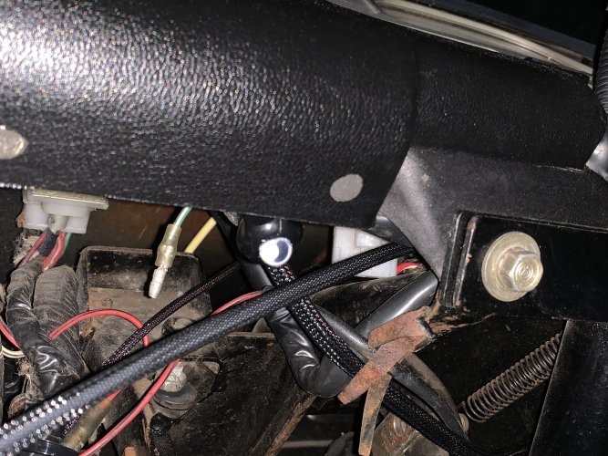

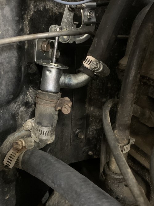

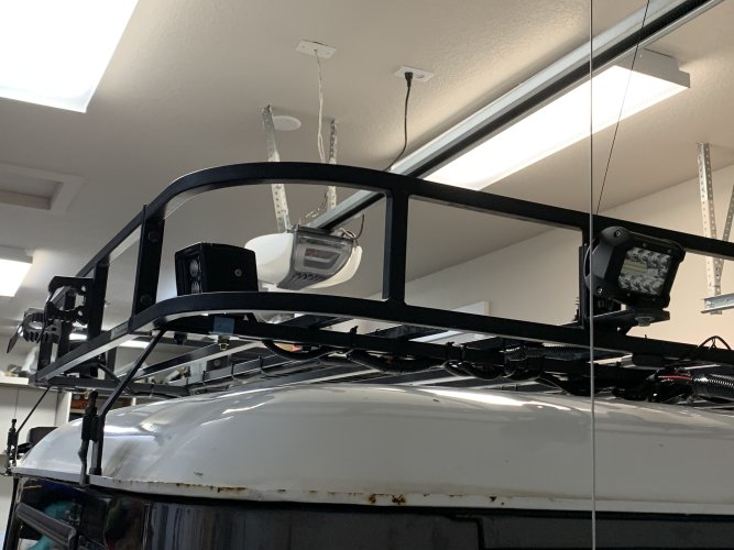

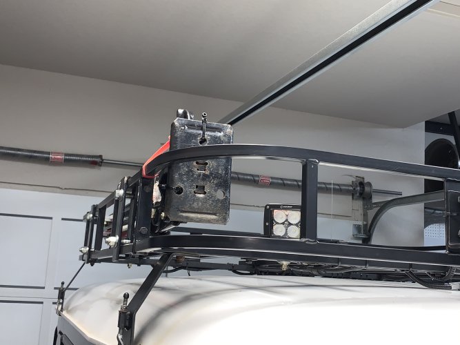

Given the 40 some 12v love and maintenance. Changed out frozen heater valve (warm pull knob is next) as well as Adding rack lighting and interior lights interior lighting Should be done tonight. I used these suuuuuper small adhesive LEDs. You can see the little white squares in the photos.
Where do you get those?

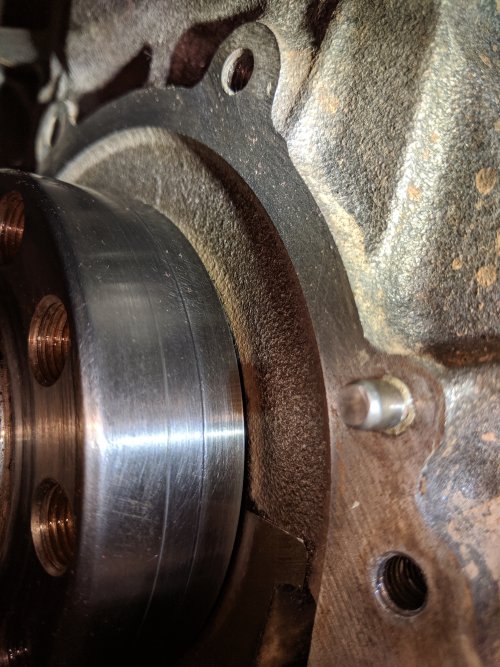

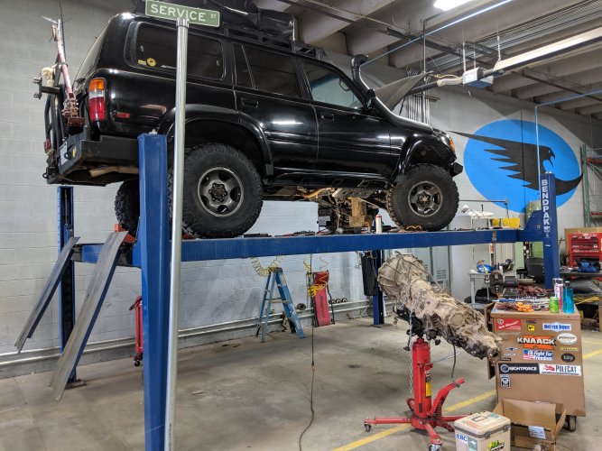

Working on swapping in spare transmission and rebuilt transfer case.
Hit a snag while changing rear main seal. Need a speedi sleeve.
Bummer. What is it that we are seeing at the rear main pictured?
Looks decent to me... if that groove is what yer seein’
It's a groove the same way your axle shafts get them.
I can feel it with my finger nail. I'm reading it's hard to find a speedi sleeve so I'll just put the seal in a different position.
Yeah I wouldnt worry much about it but that's me. Looks pretty dang good.
