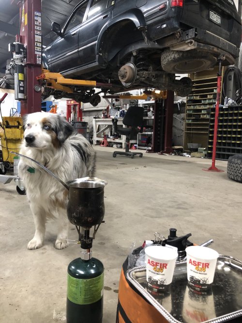

Friday, with professional assistance :robbie::

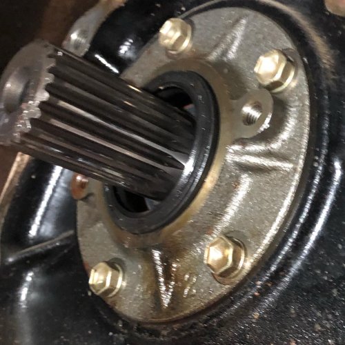

  • R&R the T-case to replace the transmission rear output seal which was working its way out. After only 325,000 miles. Sheesh! While in there, replaced the output bearing, and on the T-case replaced both front and rear output bearings and seals. Held a viscous coupler in my hands and now understand how they work.
While on the lift:
  • Transfer Case gear Oil
  • Grease both driveshafts
  • New CDL breather hose
  • Front brake pads
  • Speed bleeders all around
  • Flush brakes
  • Parking brake shoes & adjust
  • All rear wheel studs (after one broke off during removal)
  • re-wrapped transmission wiring harness with loom and tape
  • rotate tires
  • make coffee

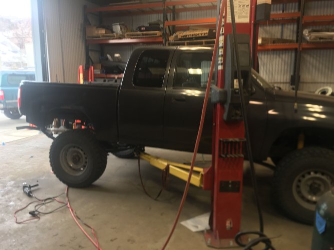

Got a bunch done on the t100 thanks to Steve and Adam Prosise. Bobbed it 14” got the 80 rear mocked up and buzzed down, and started mocking up the hydro assist... good weekend.
I dig the steelies on it. Are those from an FJC?
