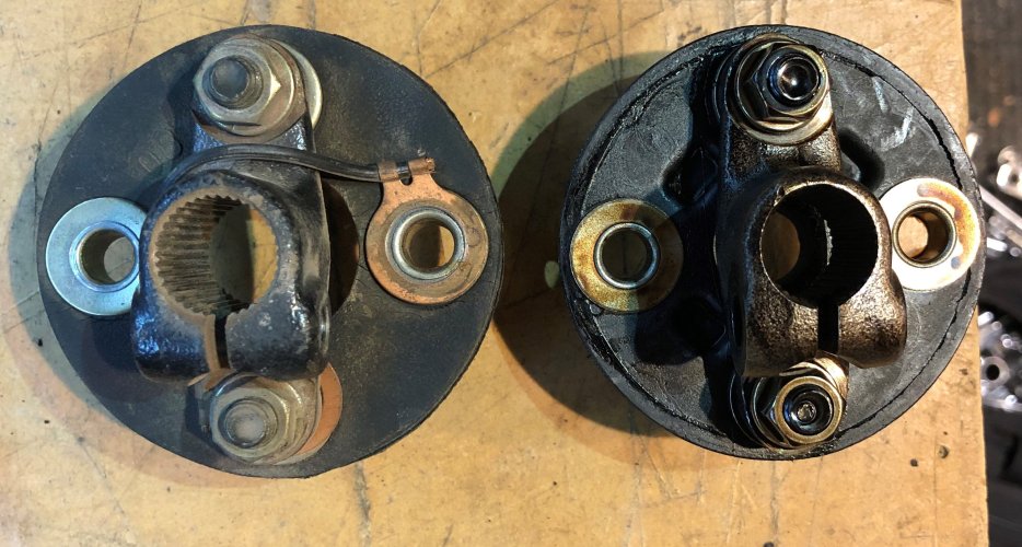

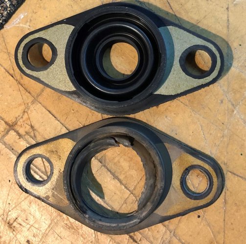

Firewall gasket was worn out! rubber flex joint was ok, but I sometimes get a knock feel at the steering wheel, so I figured I'd replace it. I had no idea of its condition.
