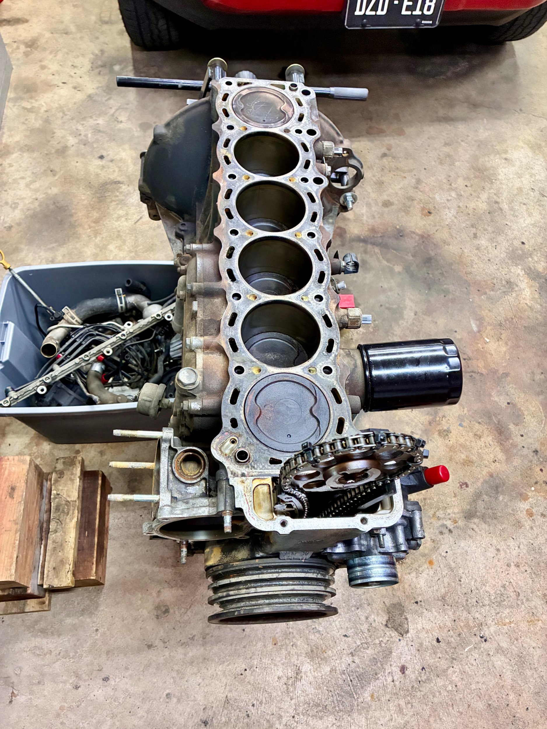

My son and I tore down his replacement 1FZ over the weekend. This engine will be replacing the one in his 95 FZJ80 that burns a bit of oil and has a HG leak (coolant only). Head is going to Gunn. HG kit will be purchased from Cruiser Outfitters. Injectors will be cleaned by Fuel Injector Specialist. I need to make a list of all the misc. seals, gaskets, and belts that are not included in the HG kit. Maybe this time I'll actually create a spreadsheet with Toyota p/n's so I don't have to recreate the list each time. He is going to install ARP head bolts because he has dreams of a turbo in the future.

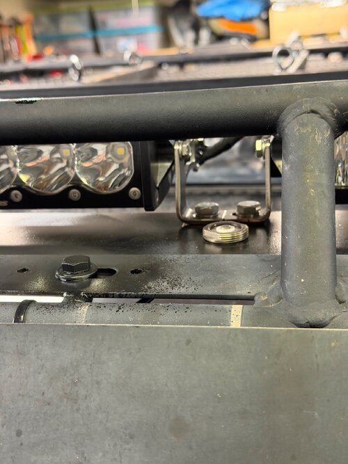

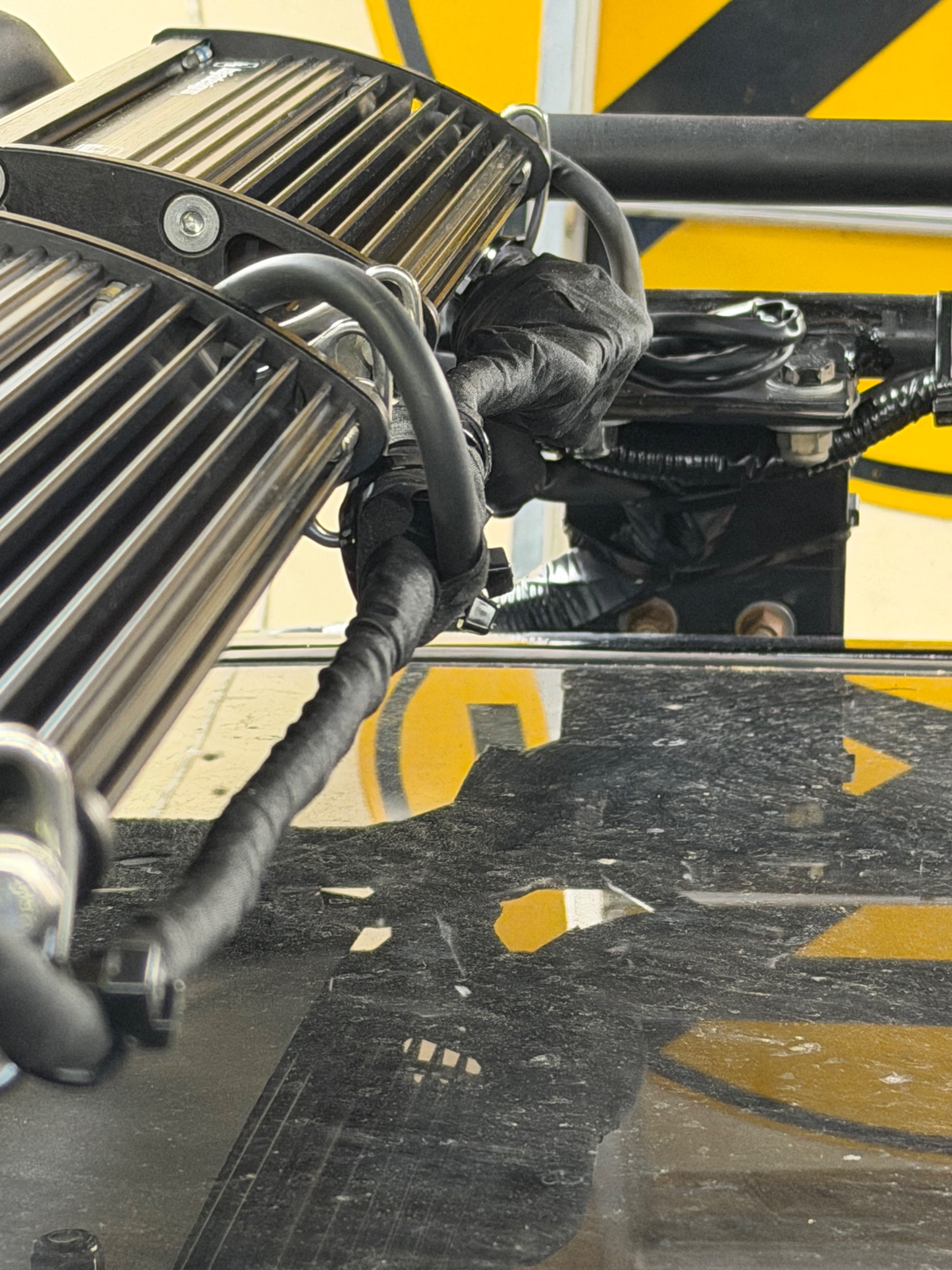

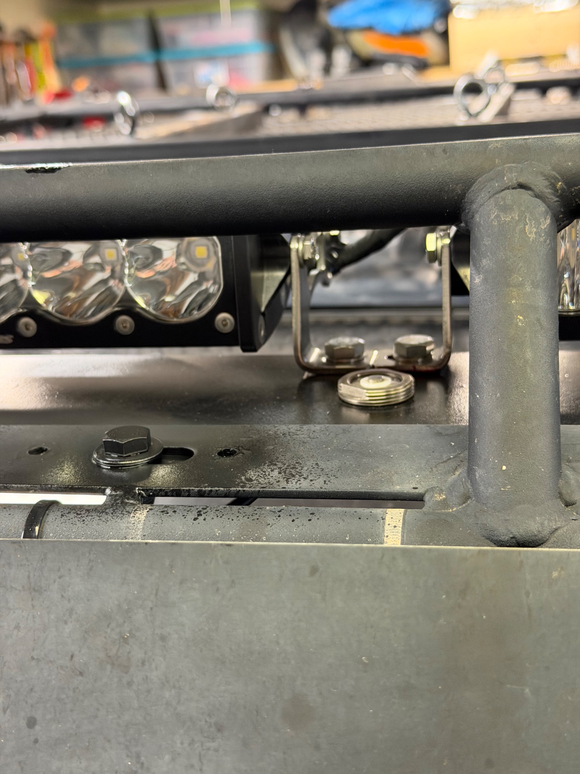

Install an S2 side light. Reinstalled fairing after putting on these Baja Desings OnX6 10” light bars the past two weekends, on a metal plate I made, which includes the new ham radio mount. Cleaned up some wiring.

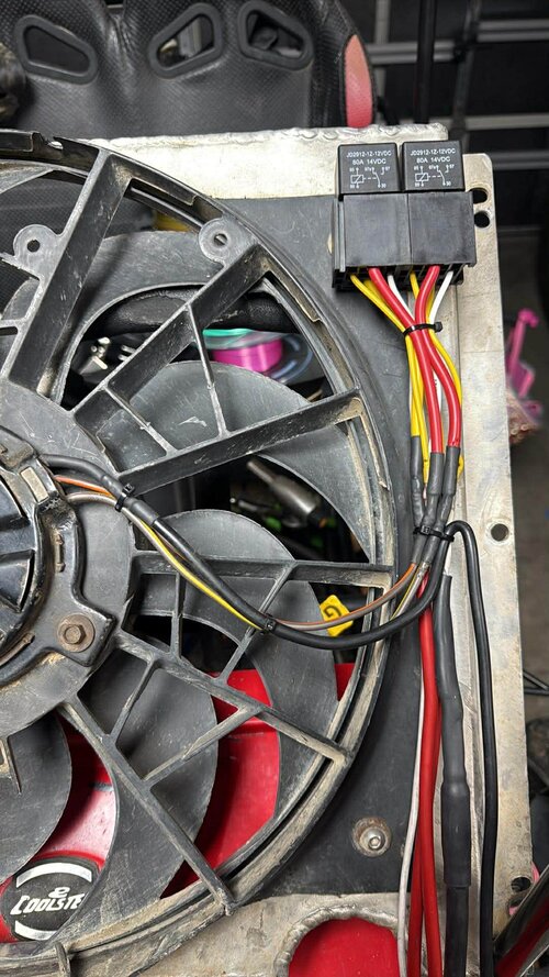

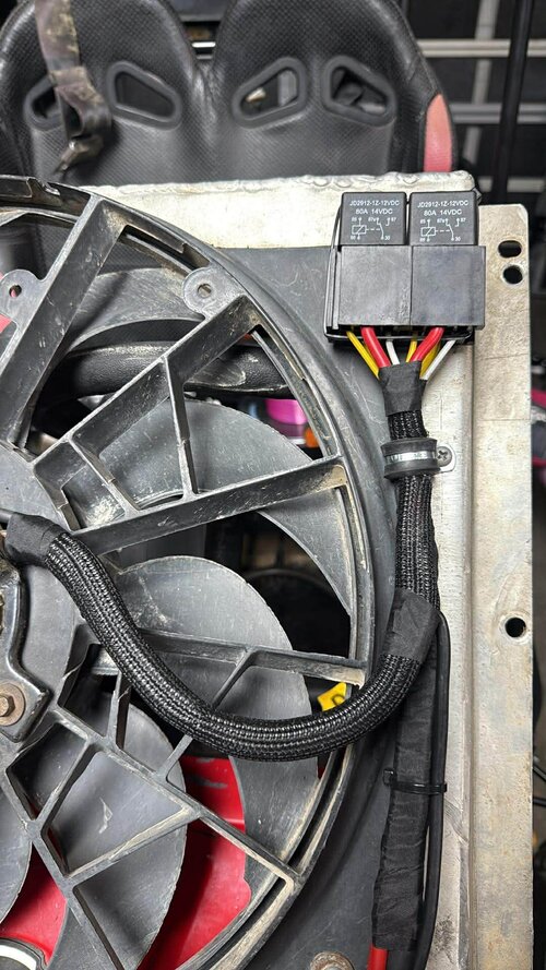

Wiring in a 2 speed Taurus fan in my friends fj40.

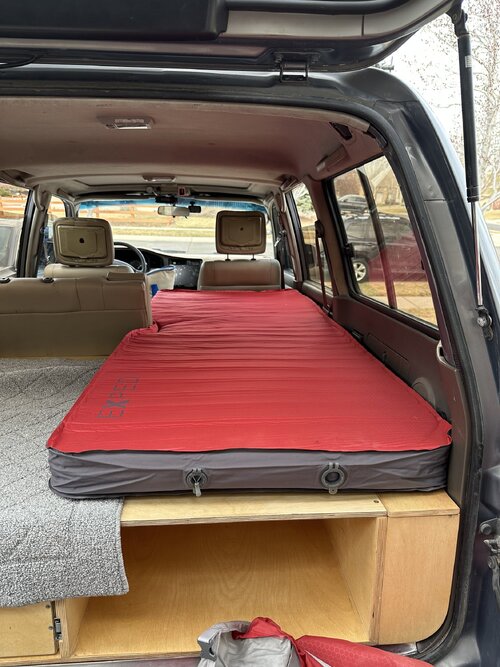

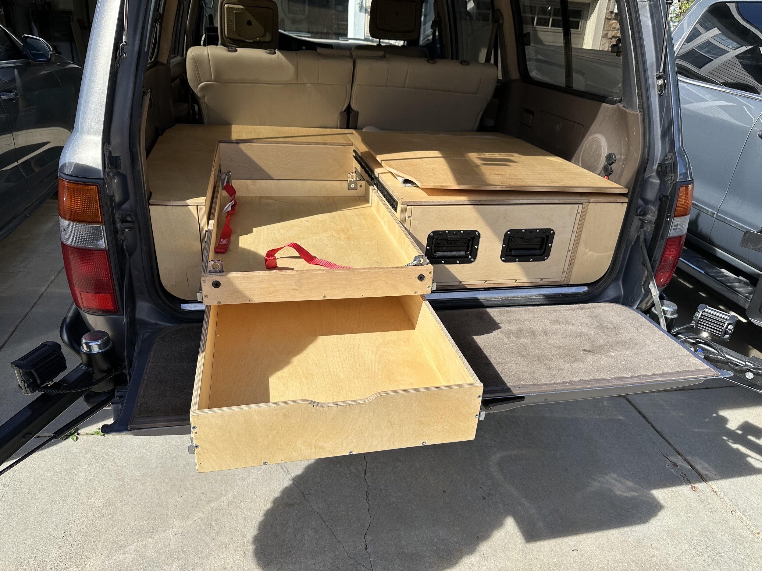

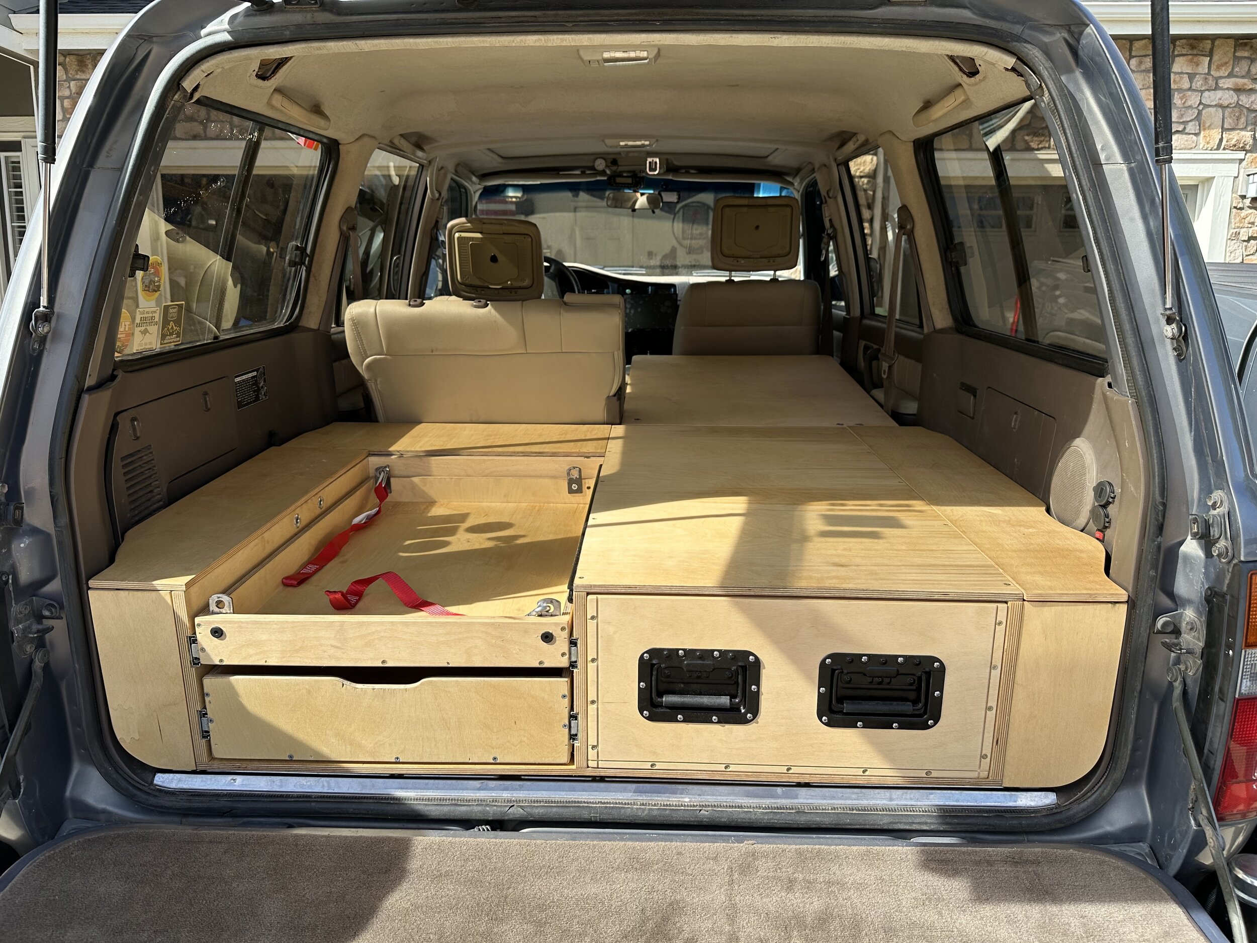

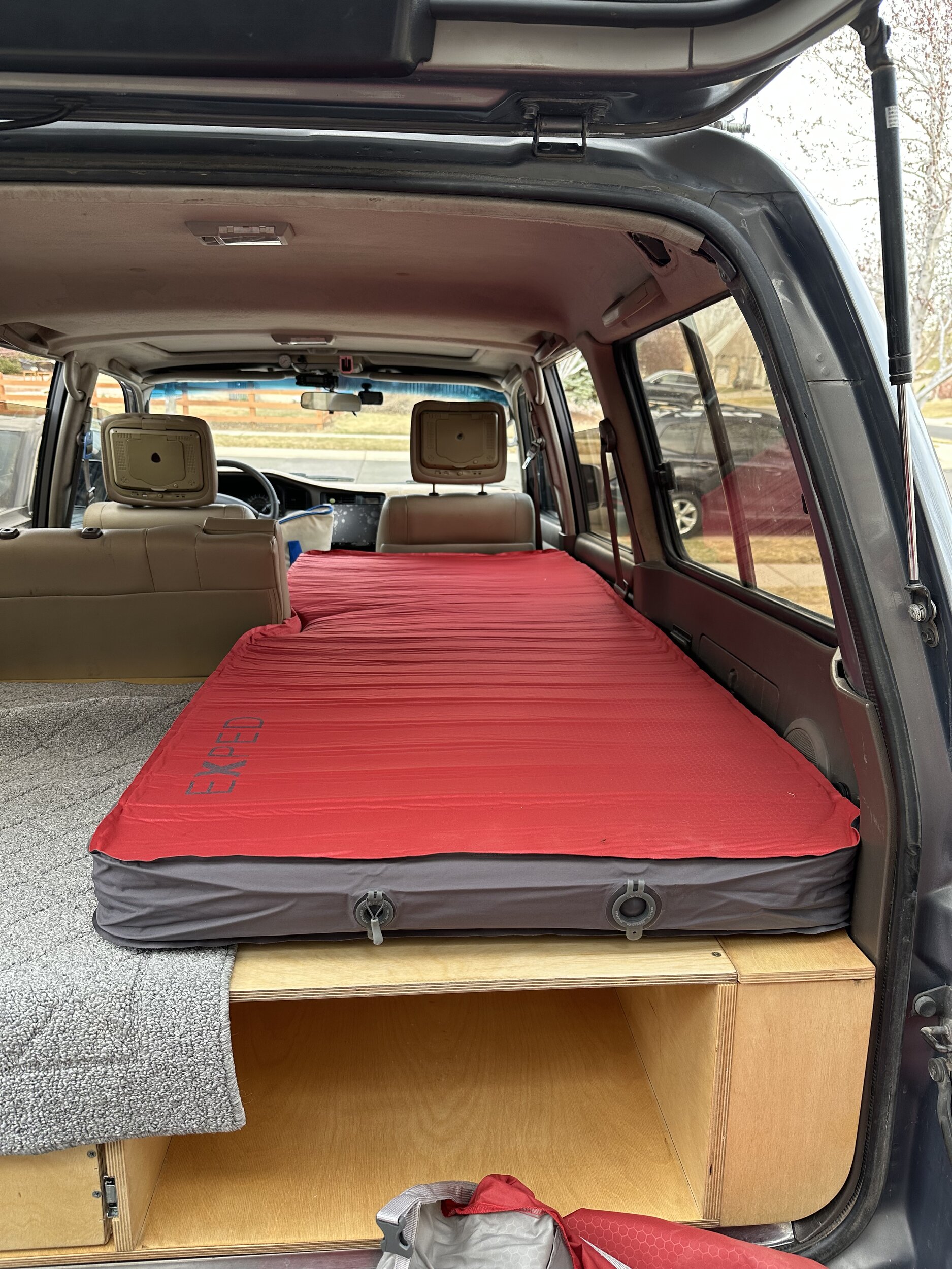

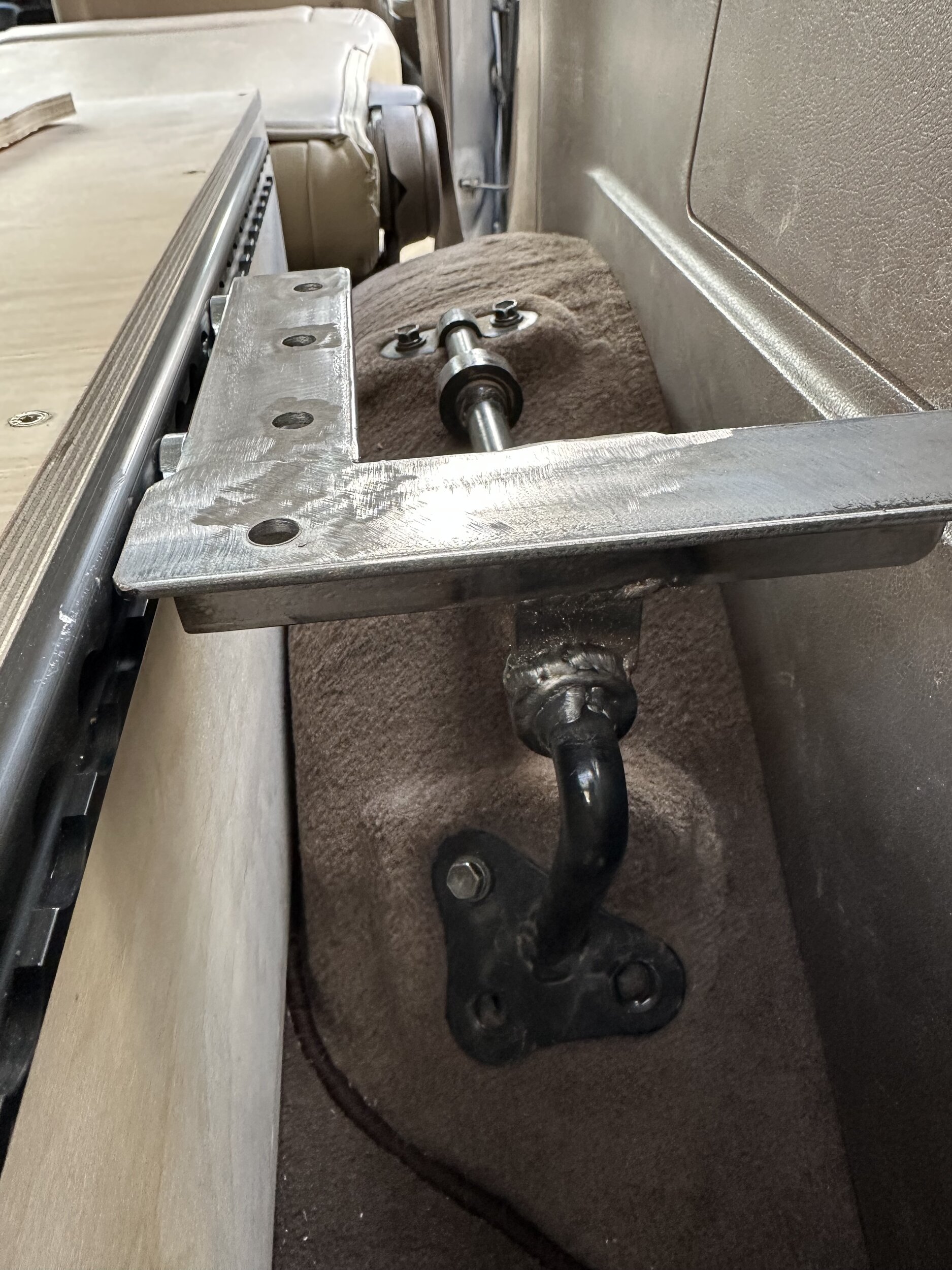

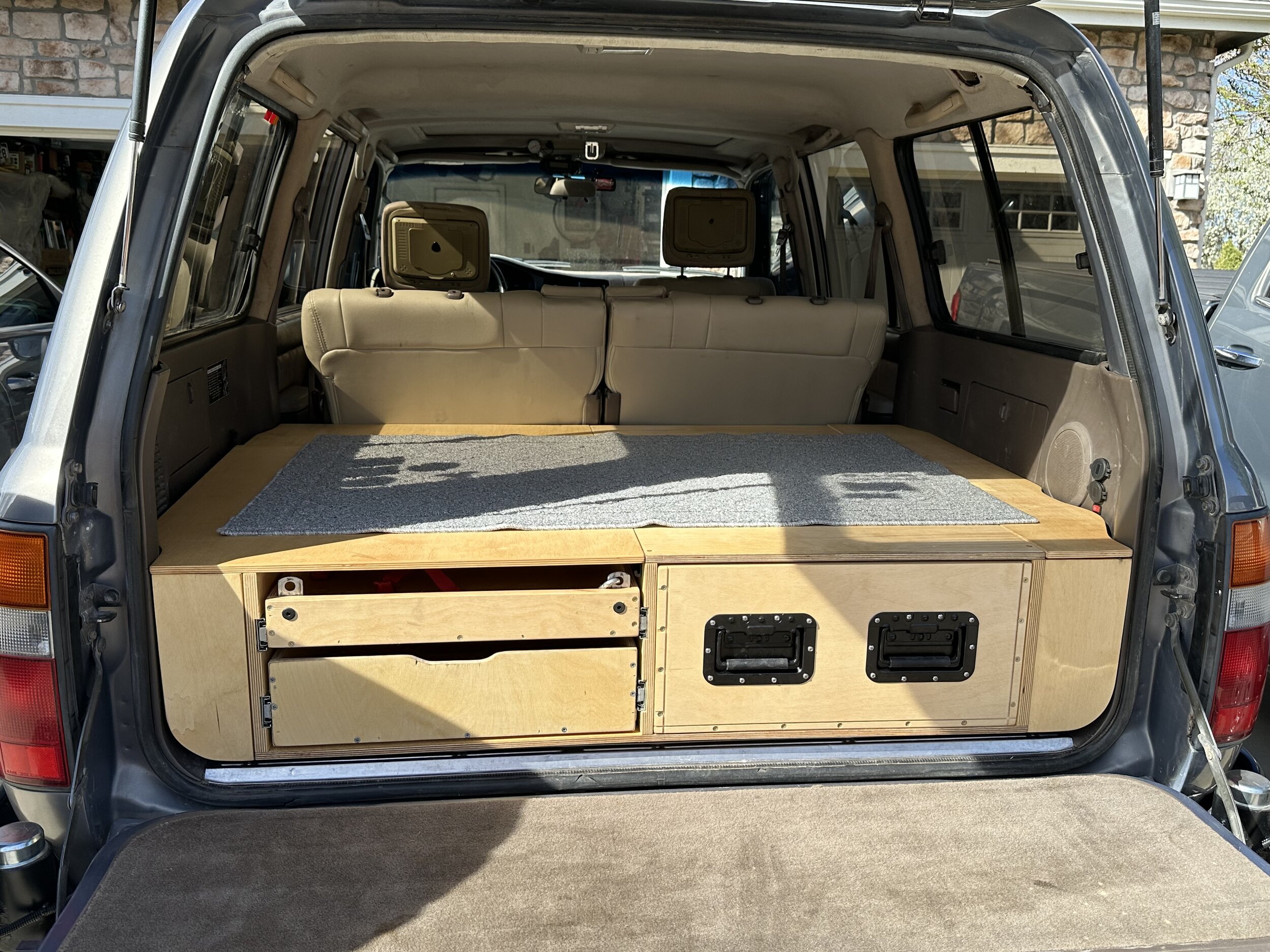

Well, I wouldn’t say that I did all this today, but maybe the past few weeks. I decided to make a rear drawer system and sleeping platform for the 80. Not sure why I didn’t just buy one but here is the final version:

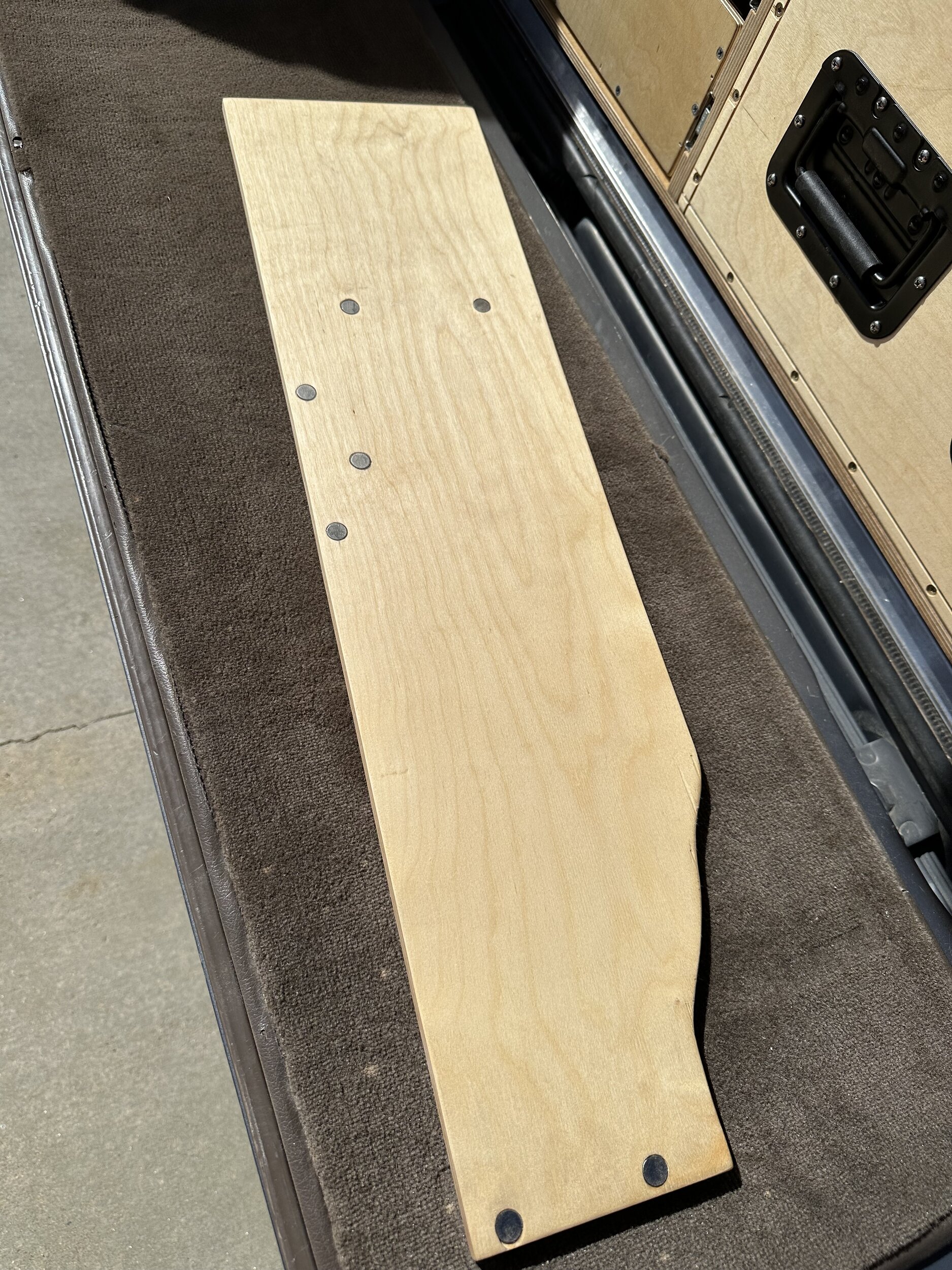

The sleeping platform is 80” long. And there is a front storage compartment that fits an AR 15 ;). With the drawers out I can lift it into the truck by myself. And the side pieces pop off using just super strong magnets.

Nice work! I like the design!
