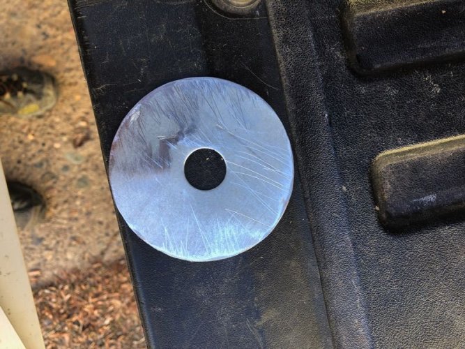

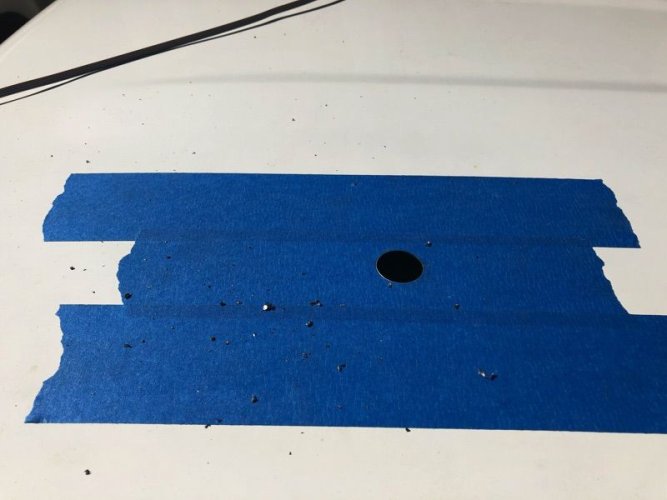

Finally dug in and punched antenna holes in the roof.
The sheet metal is really thin in trucks now so I made these disks from some scrap 24ga sheet I had around. Wanted to use something a bit thinner but it is what it is.

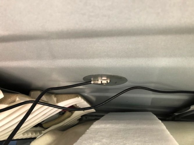

Dave, Nice work on the hole. how thick did all the metal end up being with that spacer? How does the outer threaded ring of the NMO line up with the center part?
14,135
I didn't think to measure actual thickness but my estimation is that the roof on a 2008 Tacoma is about 26 ga. So I'd estimate about 0.045" or so.
I had to file the NMO ears to get it to grab both thicknesses and keep everything centered. Apparently Larsen makes their mounts (I used the NMOK-HFUD like in the image above) for exactly 24 ga sheet and it would walk around in the roof hole otherwise.
I tried epoxying the disk to the underside of the roof but it popped off as soon as I flexed the roof a little. So I need to research a better adhesive, perhaps some sort of industrial silver epoxy that'll be conductive, too.

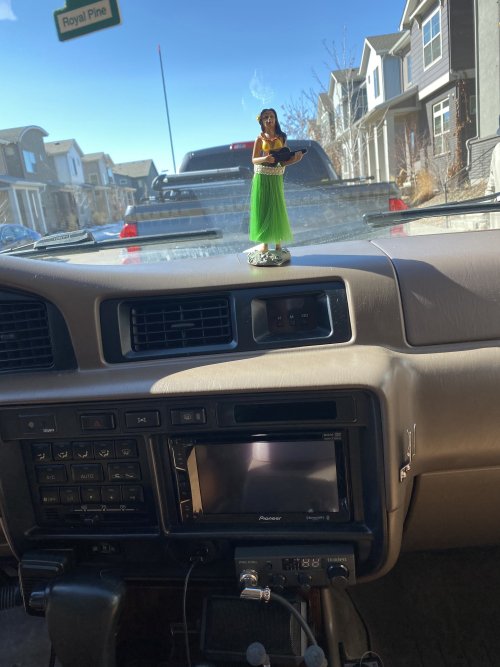

I added this finely crafted statue to the dash of my 80.

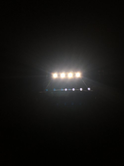

Finally got rid of the old 30” LED light bar and replaced it with four 4.5” round LED pods. They’re very bright, they look better, and they don’t reflect off my dash and make it impossible to actually see when using them.
Those look bright which ones did you choose?
