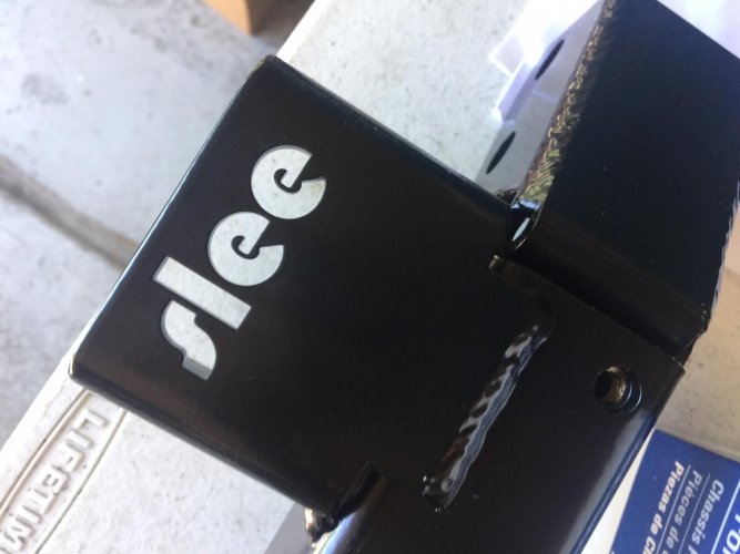

Popped in a Slee Diff drop. Man Christo's stuff drips with quality. Easy and my CV's thank me and look much more level than I expected from a 3/4" drop.

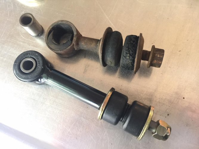

Also, replaced my front sway bar end links with 325k miles on them... I splurged on a set of Trail Tailors extended links to put the sway bar back at the factory angle... makes a noticeable difference.

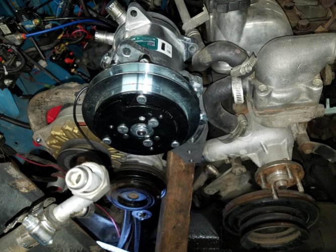

Got my vintage air a.c. installed. Been nice on the hot summer days we've been having. I am running dual a.c. compressors and a smog pump. It's a tight fit. I also went with a gm alternator since this pic.

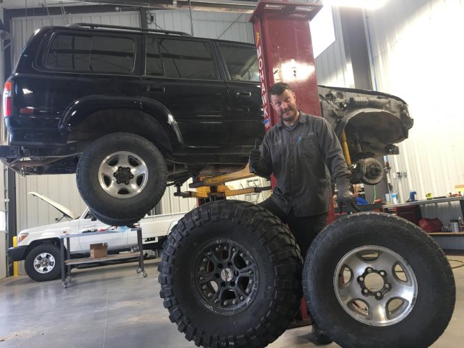

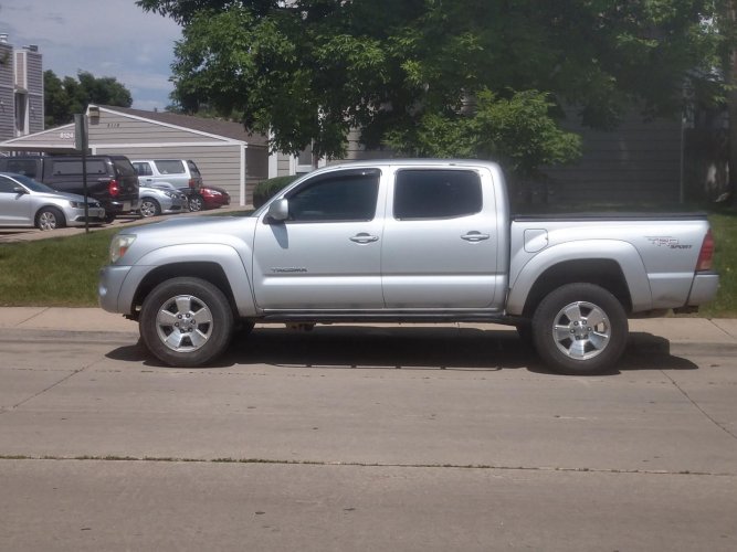

I bought this.

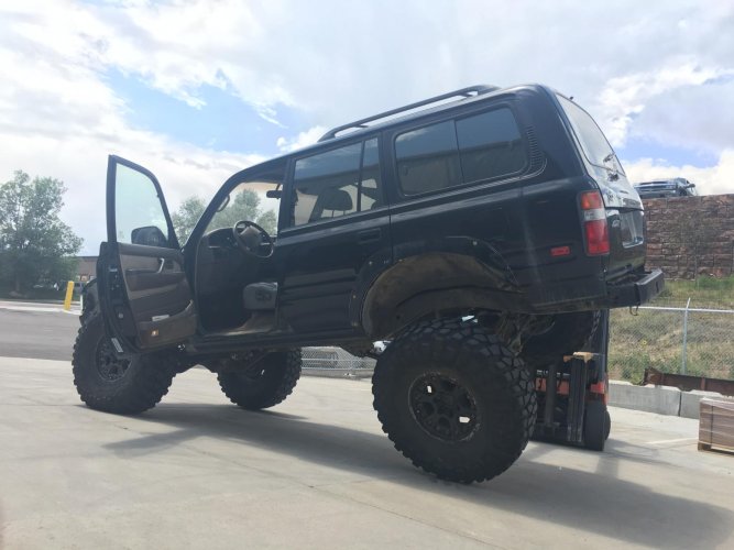

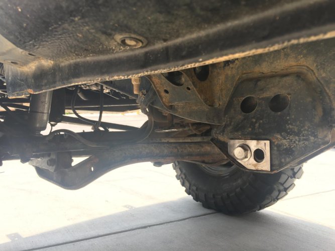

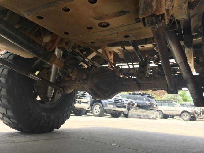

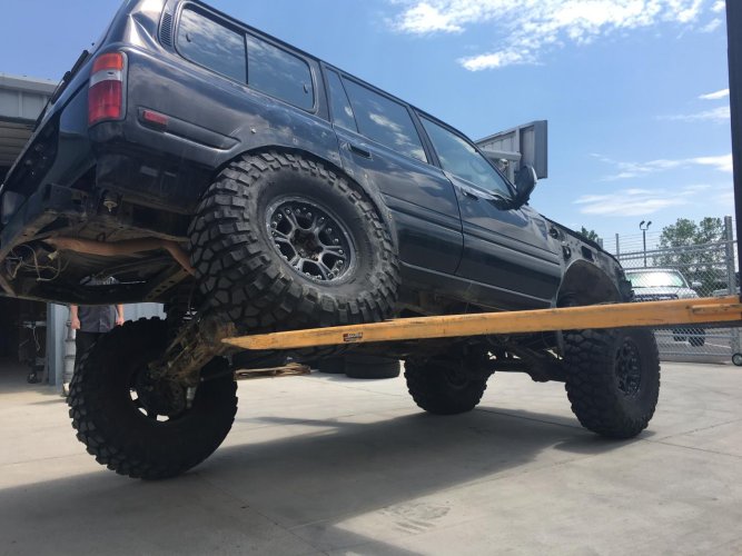

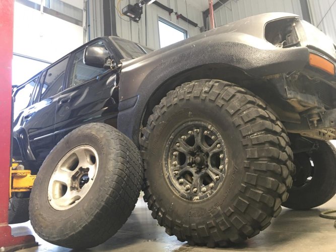

Tested out the suspension tire combo today. We moved the front forward 1.125” and the rear back 2.25”
We had about 4.5” still to the rear bump stop. Got some more sawzalling to do.

Jackson...what the....
Crazy! Did you have to lengthen rear DS?
Yes.. kinda. Hoping to find an early fj80 ds.... trying to do this right and kinda cheap. Budget including the truck is 8k (truck was 900)
