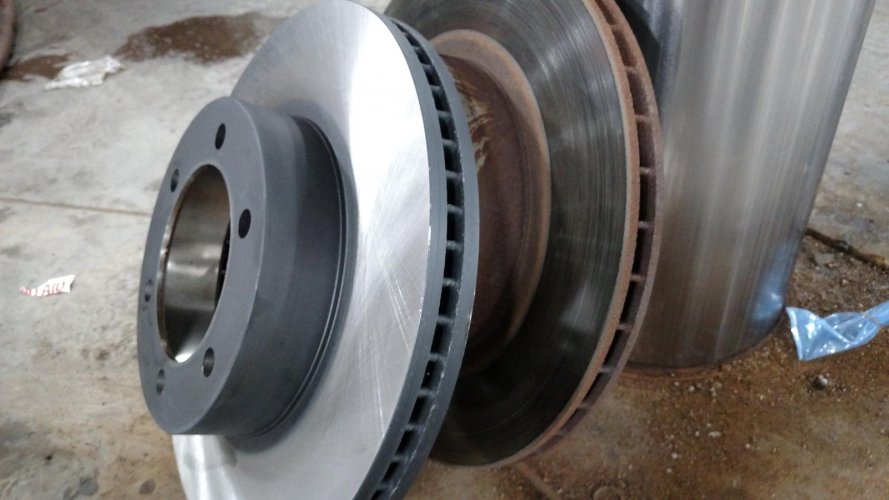

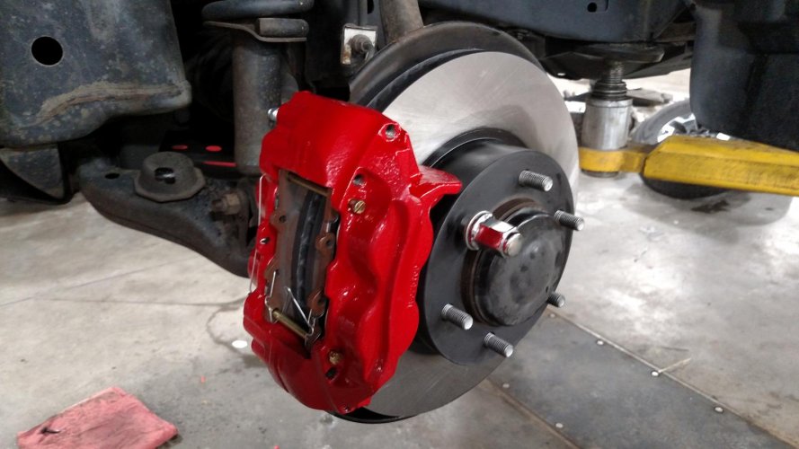

Out with the old, in with the new! Installed the 199 Tundra brake upgrade on my 99 4Runner. Aftermarket calipers with OEM pads/shims and rotors. Night and day difference in braking power, and no more pulsation.

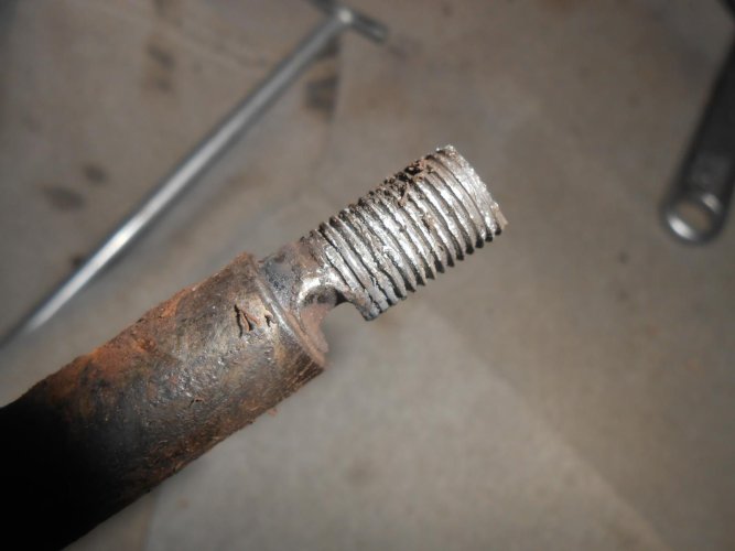

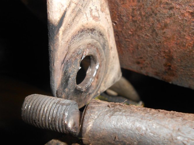

Finally took apart the egged out RR front spring hanger on the '78 FJ40 and discovered that the pin is shot, too. Poly bushings (installed in '91) were in good shape - this is just a function of 160K miles.

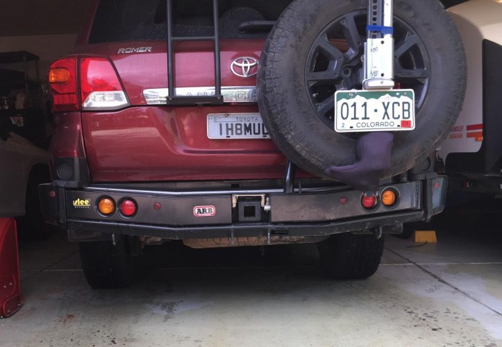

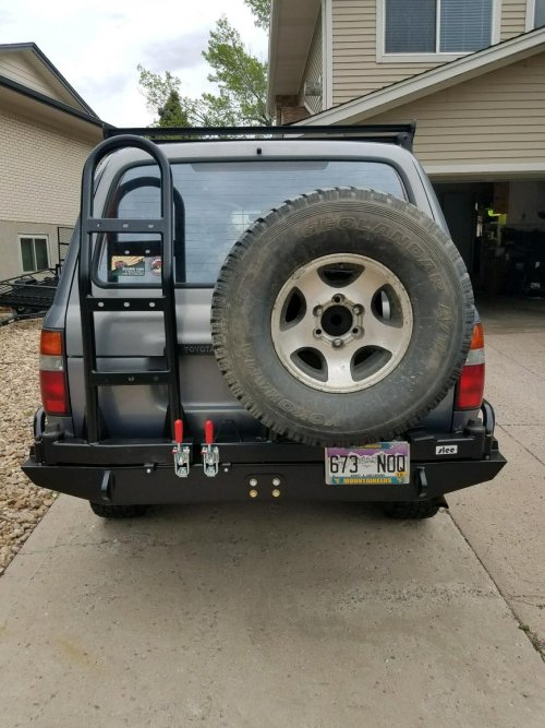

Got her lifted 2.5” and a rear bumper/tire carrier installed at Slee last week.

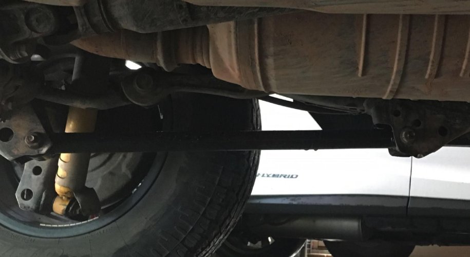

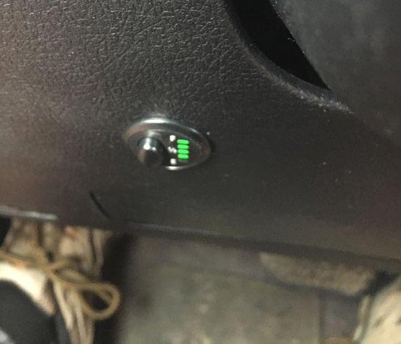

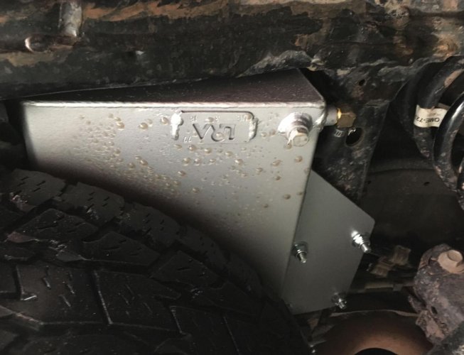

Installed a 13 Gallon Aux tank and SPC Lower Control Arms. All installed by Christo's shop
Yes I am running two spares

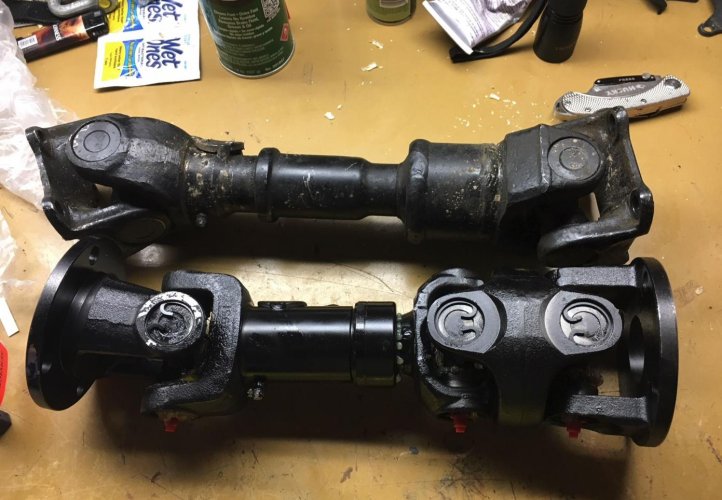

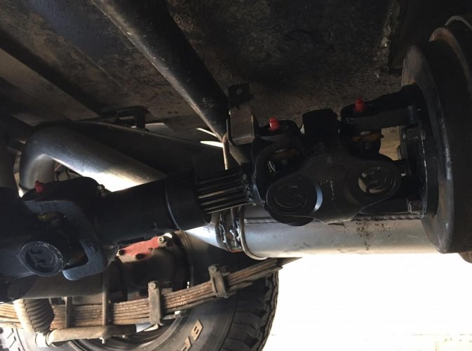

Was feeling a slight vibration in the driveline at 60+ mph when I took my foot off the gas, so I called Tom woods I bought a CV driveshaft. Picture was before I took the red caps off
I removed the 4 deg shims to point the rear diff at the Tcase
Drove it around on the highway and then rechecked the bolts. Can't really get a torque wrench on the tcase side so tightened as hard as I could by hand with a wrench. I know its supposed to be 65 lbs

That's a nicely made driveshaft. Curious about the slip yoke. My uncalibrated ruler to the screen method makes me think there isn't much length of splines engaged. I guess I don't know how deep are the engaged splines inside the yoke or if there's a risk of it separating. I assume the splines on the old one could be longer since there was more length inside the tube for them.
