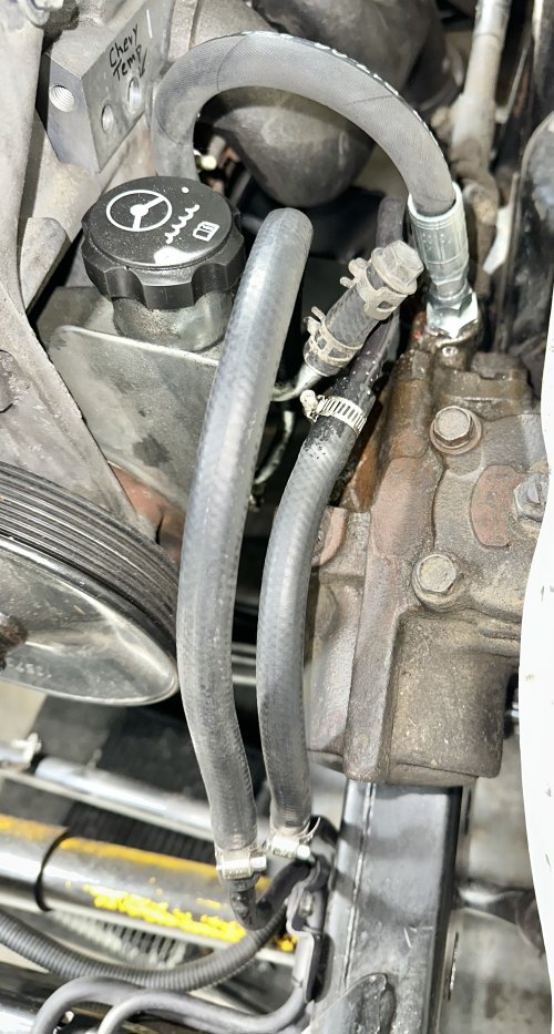

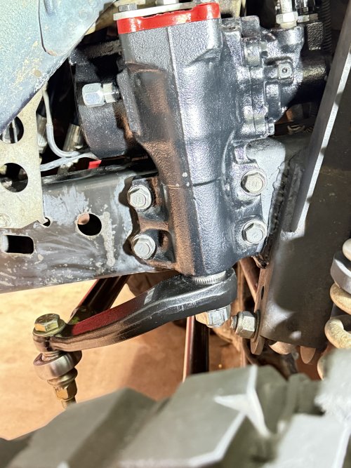

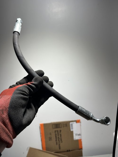

Power steering all connected. 3,000 psi working pressure industrial hose - 12,000 psi burst strength - with AN ends to adapters. One to GM pump. One to Toyota gearbox.

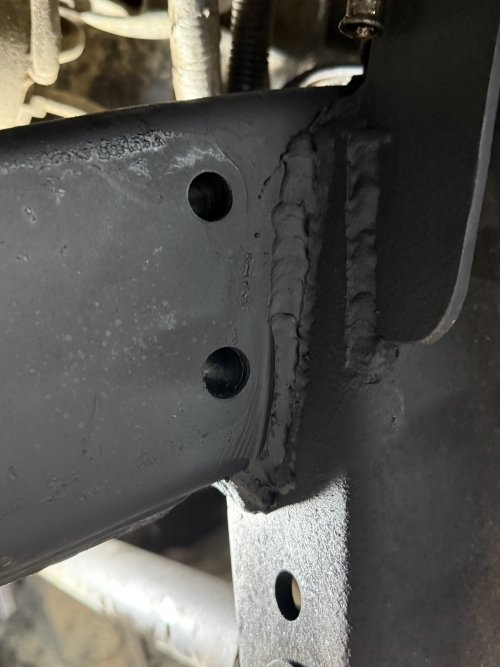

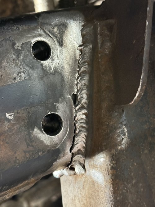

So, death wobble is sorted. This seems to be what the problem was.
Cleaned the weld up best we could and had to stack some welds. The old bugger welds are from when I tried to fix it last time.
Also installed the Redhead. Need to take some measurements so I can get my PSC ram and get the assist going.
If these welds break, I’ll be time to cut off the panhard mount and start over.

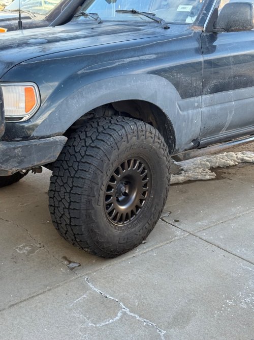

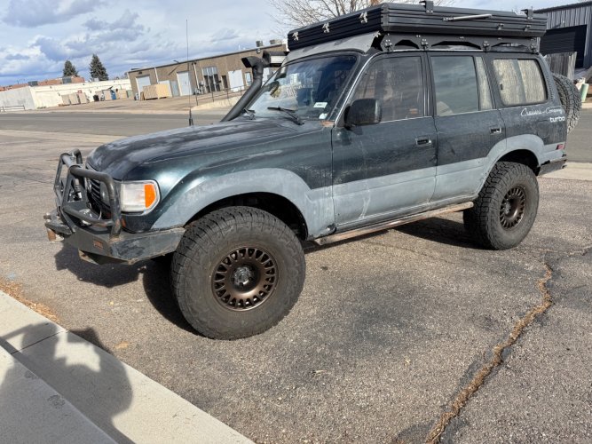

New shoes (315/75r16 AT4W’s) and wheels (Nomad, Sahara copperhead 16x8 -10 offset). Now time to clean up the rest of the cruiser. New bumpers sliders and maybe a wrap before Cruise Moab. Any one wrap a cruiser with crappy paint and dents before?

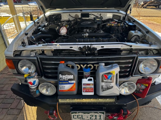

Isn't 50/50 good to -34°F?
I remember in the winter of 82/83, my FJ40 still started and ran when the bank thermometer across the street was showing -25°F!
Sorry, I didn’t mean 50/50 literally - that’s on me for not being accurate. It’s a mix, heavier on the water.
