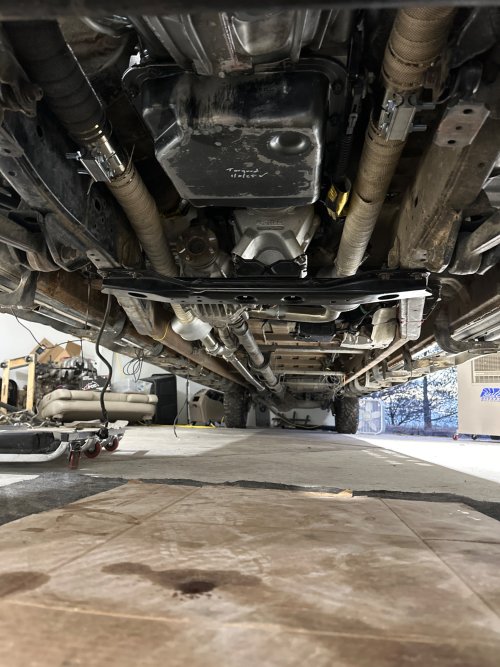

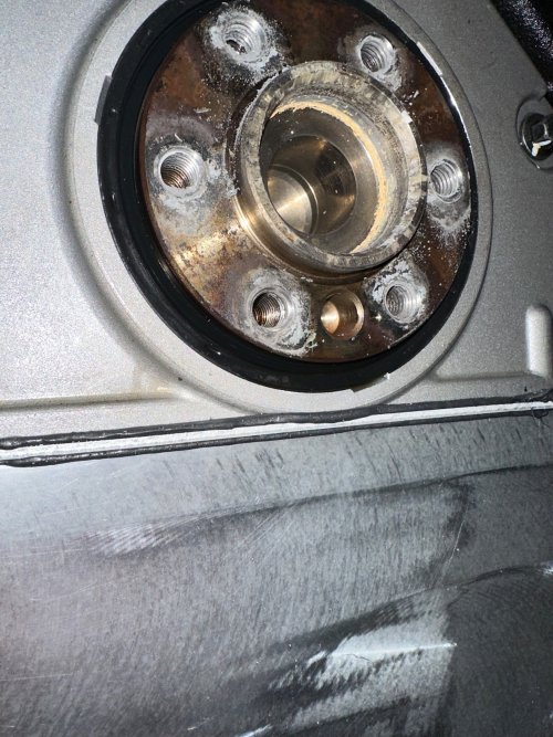

The leak is a steady drip after about 10 minutes of idling. I have used dyes for slow AC and coolant leaks. I have checked everything I’m aware of except the rear cover and crank seal - which are covered by the bell housing. IMG_2556.jpeg
Pardon if I'm asking something you've already done. I really am trying to follow both threads. It seems you're focused on it being the transmission fluid but that looks more like engine oil. Have you given it a good smell or, I'm not completely kidding, taste? Rear main might explain all the clues pretty well.

The first most obvious drips were transmission fluid. I have clearly identified it coming from the transmission pan gasket which I will replace because tightening did not stop it completely. Since it was already a new gasket, I’m gonna use some of the permatex on the new transmission pan gasket.
Shortly after the transmission fluid appeared, the engine oil appeared. And it was dripping worse. 😞 everything that is not hidden by the bell housing has been checked. Sure, I could’ve missed something still. Hopefully I just did something really dumb when I installed the rear main seal and cover on the engine stand.

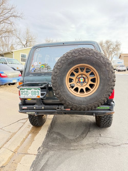

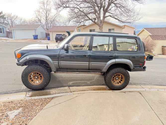

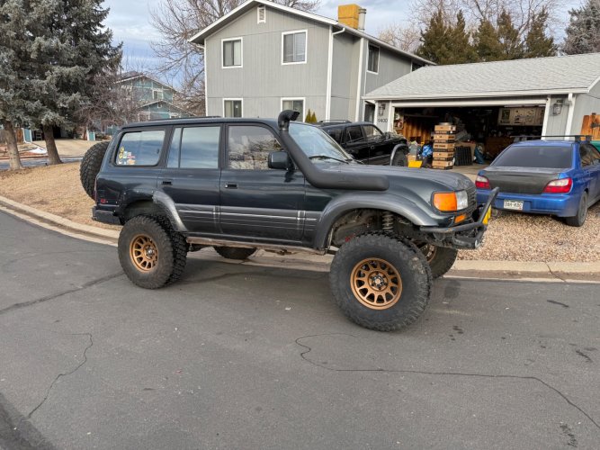

New wheels finally on.
Thanks @IoN6 for taking the lip off so the wheels would fit over the hub!
IMG_0419.jpegIMG_0420.jpegIMG_0417.jpeg.

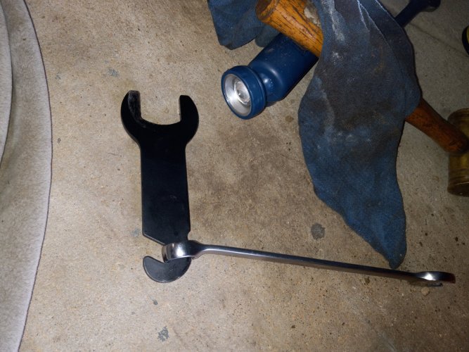

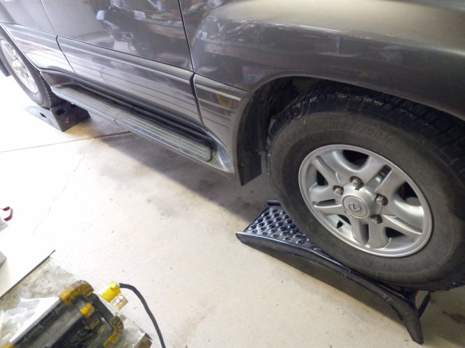

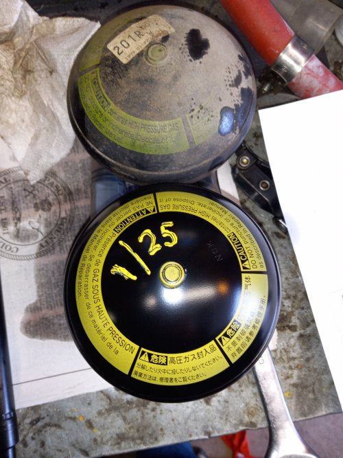

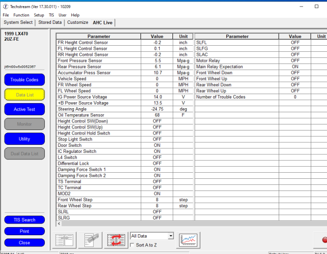

Replaced all 4 globes yesterday (Japan-shipped set) on the '99 LX470. Put truck in the air on 4 ramps and lowered AHC to lowest setting and used a minimal-fluid-loss method (but bled a lot out anyway). Used a 36mm Ford fan clutch wrench set and various hacks to unscrew the globes. Old globes dated 1/99, so they were original at 336K miles. A messy job, but not difficult.
Bled, flushed, measured pressures with Techstream. Front pressures are too low - presume I need to dial back the torsion bars to let the AHC pick up more weight. The ride is improved over small pavement cuts.

Dang that looks good
I did end up running spacers. I didn’t like how close the tire was the the coilover reservoir when just turning lock to lock.

Dang, they have them in an offset that would work without 'em?
4,149
They would probably be fine, but I didn’t want to chance it.

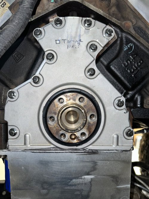

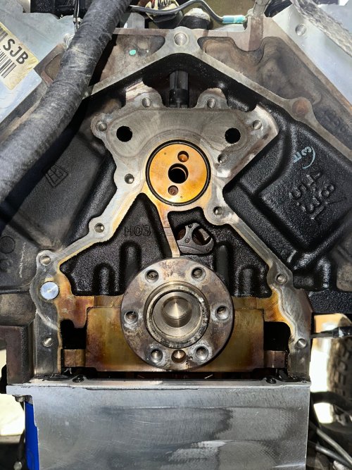

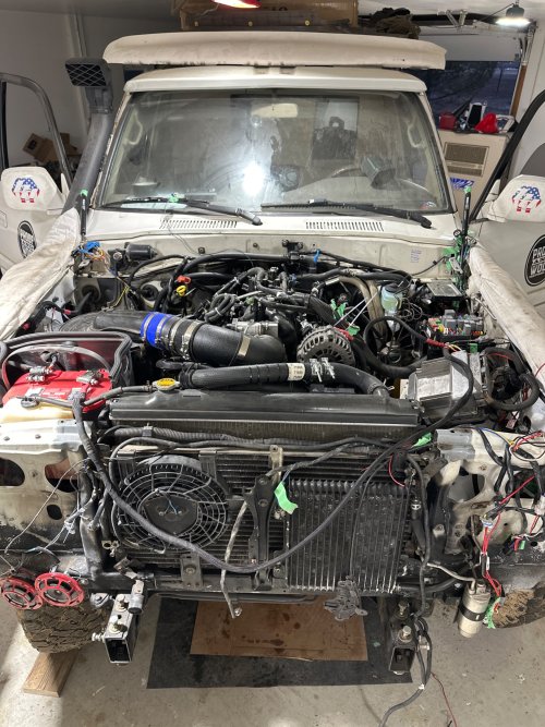

Removed and replaced the transmission and transfer case to get to the rear crank seal. I had definitely installed that sucker too high, which either tweaked the bottom ability to seal or left the gap at the top. Since the oil dripping didn’t start till it was warmed up about 15 minutes, I’m guessing top but don’t really know. Any event, new gaskets and seals in using the alignment tool and confidence is high.
Could not have completed it without @satchel
Actually, couldn’t have done any of this project without him, but he physically worked on it today.IMG_2563.jpegIMG_2567.jpegIMG_2568.jpeg

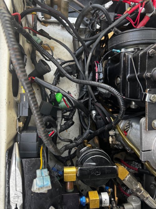

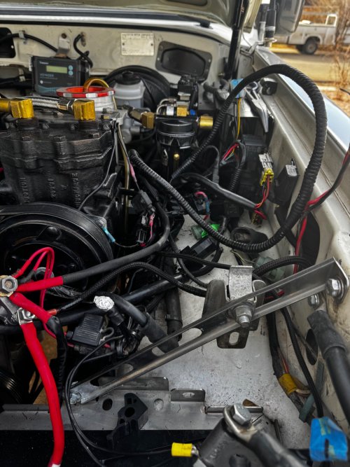

Did a search on Spaghetti wiring here. @FireMike had a pic. Decided I only had some noodles things going on, I’m slow af doing things, but decided I’ll try. Smirks i got from a very costly Pro didn’t sink in until about now nor did their comments of PO and swap installer ref either.
Me and electric is about as dangerous as smoking filling up gas at Station (no,not me).
What was left me is what I’m going to try to fix. Not until it works will I share/update this again maybe.

image.jpgimage.jpgGot the transmission and transfer case back in yesterday and today finished reconnecting a whole bunch of stuff. Just ran it for 30 minutes and no oil drip. Tiny drip of transmission fluid from the front edge of the pan so maybe I need to buy a new pan maybe this one’s bent but that’s not a big deal so I’m gonna keep putting it back together!
