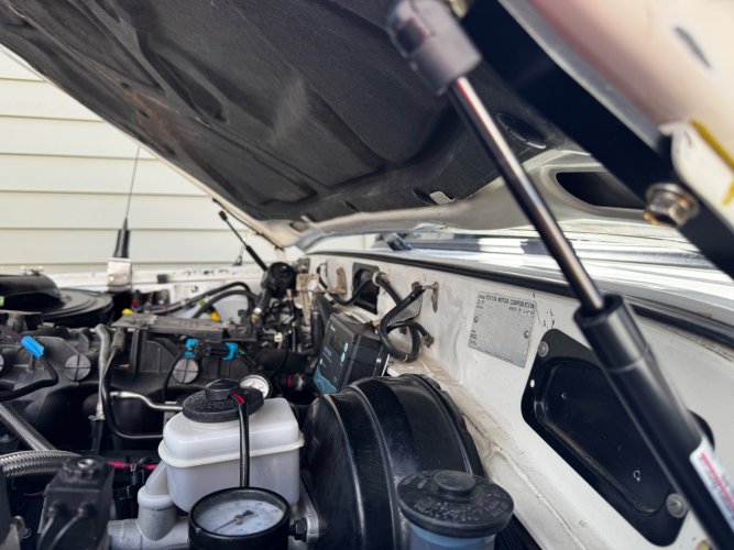

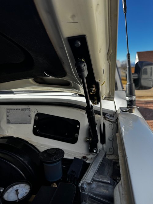

Got those hood struts installed on the 80 no photo for proof you’d have to come help me put the front clip on to see these sweet hood struts.
Over torquing master, had to drill and retap both lower bolts to firewall side. But done, so I assume something like this?

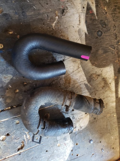

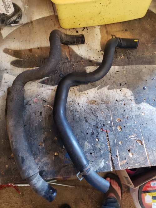

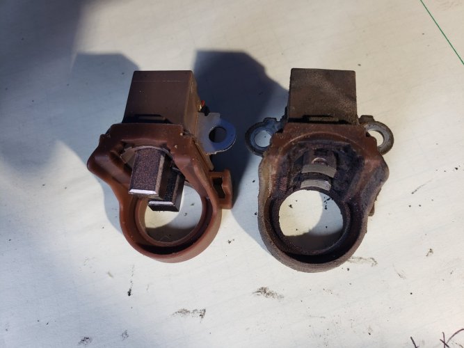

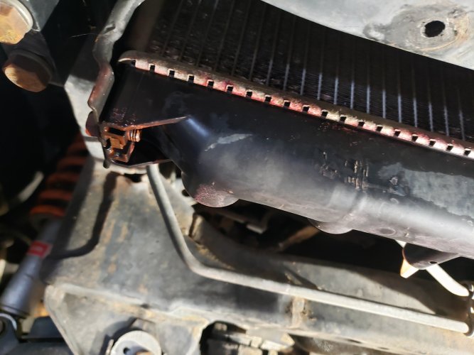

Been a while since I posted anything here, but haven't had much time for working stuff. Radiator finally cracked though, so figured this was a good time to replace oil cooler seals and hoses too (man that was a pain), and do the alternator brushes while the alternator was out (picture attached of old and new). Hopefully putting everything back together today without any leaks but we will see...

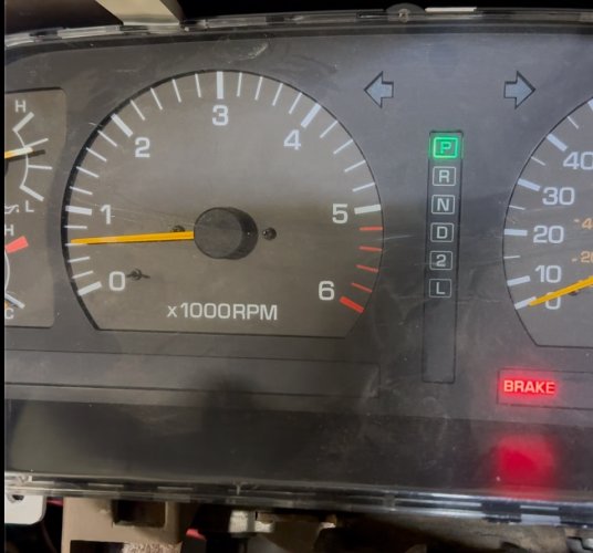

Notice: Tach is not on zero and “P” is illuminated. :-)
Nothing is impossible if you throw money at Dakota Digital and spend hours. 😵‍💫
Oil pressure was loads easier.

I feel like there was someone in Russia that was making custom(ish) speedo and tach inserts on FB or 'mud.
8,515
Yea, I'm just going to find out where the rev limiter hits and go from there.... (FYI should be 5500 so the 80's 5,000 will be fine)

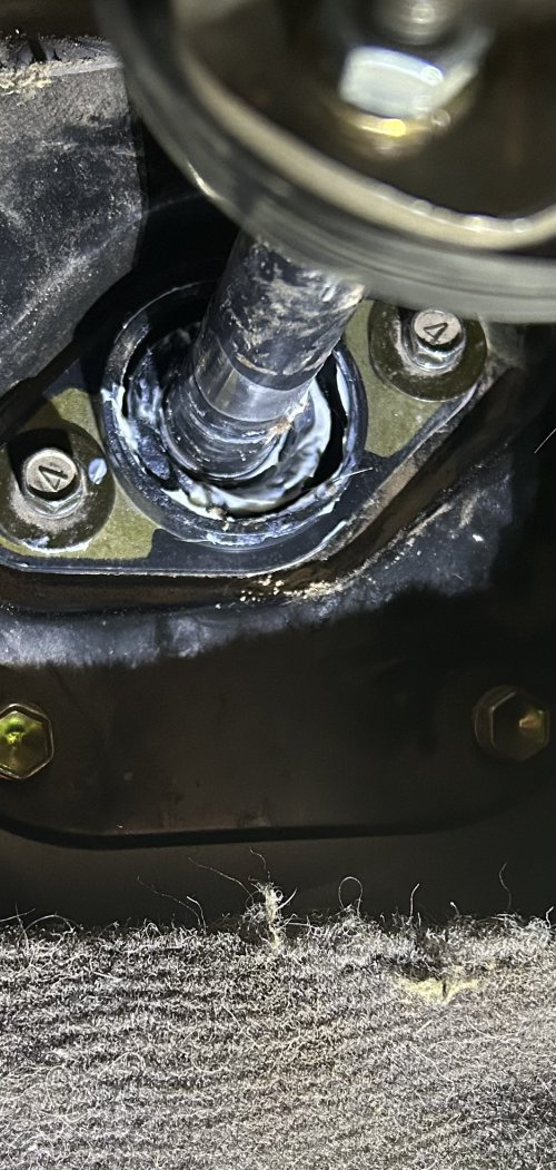

I bought a seal, maybe 10 years ago now? Still haven't put it in. Pulling the steering shaft seems like a PITA. I saw that Solve Function offers a 2 piece split seal that is installed wo/ pulling the steering shaft.
I did it on the 80 and I recall it was actually very simple. Just disconnected the shaft in the cab. There was a single bolt keeping the spines tight.
