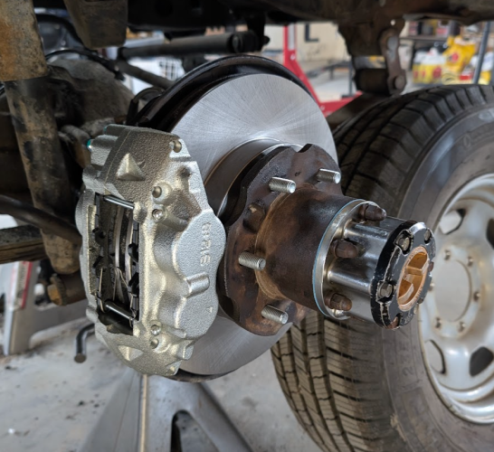

Finished knuckle rebuild and new brakes on not-my-rig. Its back on the wheels and hopefully done with axle stuff. Now on to re-sealing the transfer case. Engine should be back soon, so I need to start shopping for a rebuild kit.

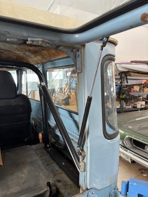

So a minor project today, replaced the back hatch struts on my daughters 40. Fun fact the 94 80 series gas struts are the same length as a 1970 40 series rear hatch. Just took a few new fasteners to hold the struts to the 40's brackets and no more getting whacked in the back of the head when you don't get the compression nuts tight enough on the old spring struts.

That's a good idea! I keep a vice grip handy in my '71 to secure the strut so I don't get whacked in the head :ROFLMAO:

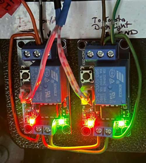

I have modified the cruise switch and added a relay module to make cruise control work.

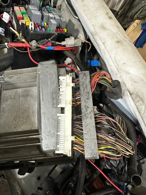

I added a pin to the PCM to control an auxiliary pusher fan on the AC condenser.

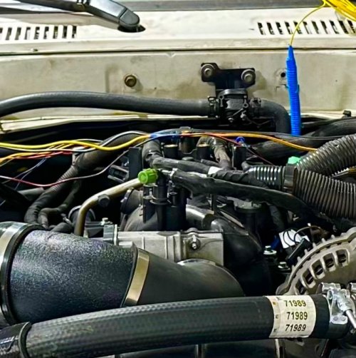

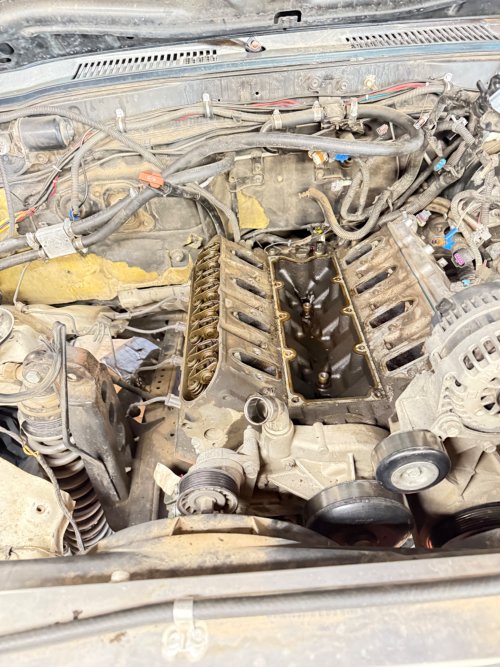

I fixed a broken headlight tab and found a broken screw to drill out (it will be easy). Today I will receive delivery of a machined part to relocate the evaporative purge solenoid from intake top where it was hitting the hood. (The green thing is 1/2 too tall!)

Very satisfying to get this messy job completed, eh? Good job!!
