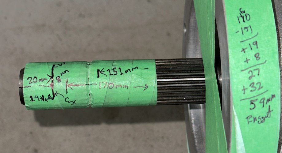

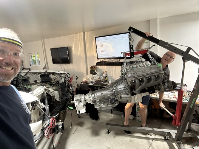

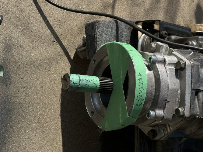

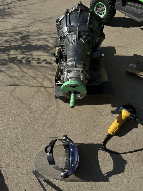

Cut the transmission output shaft. There is a backstory of why I am doing it a second time that can be traced to Advance Adpaters having 13 year old Marks adapter instructions on their website. Suffice it to say that this second time around I am gaining about 27mm more spline engagement which results in around 57 mm total. The a343 has 55 mm engagement. (Measurements you see in photos are from the first part of the three part spacer.)

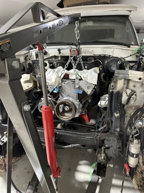

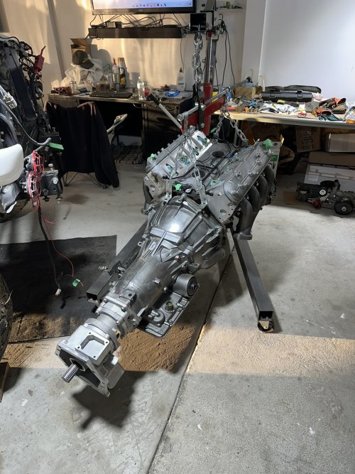

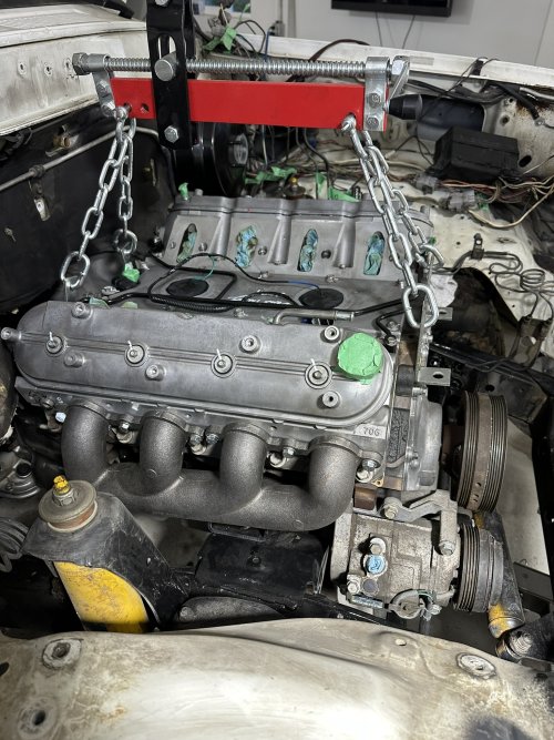

Installed torque converter to transmission, mated transmission to engine
Did a test fit! Glad I bought the bolt-in engine mounts! LOTS of room. The LS looks so small in there.

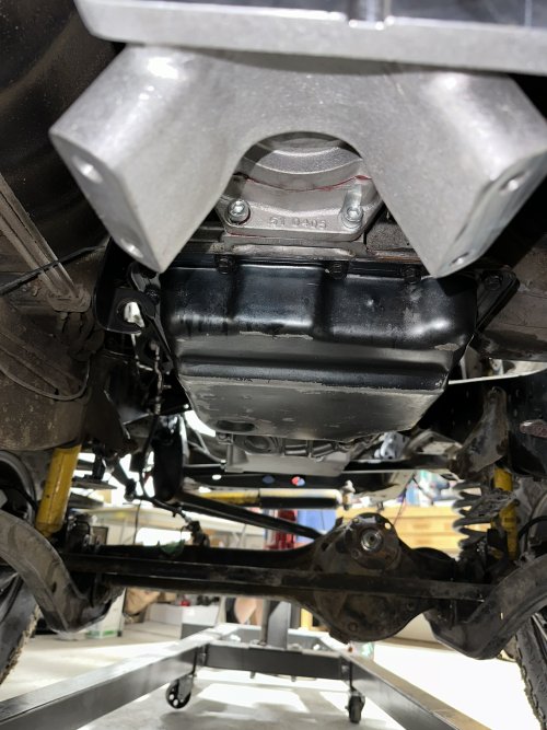

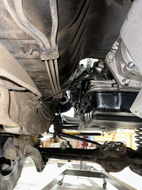

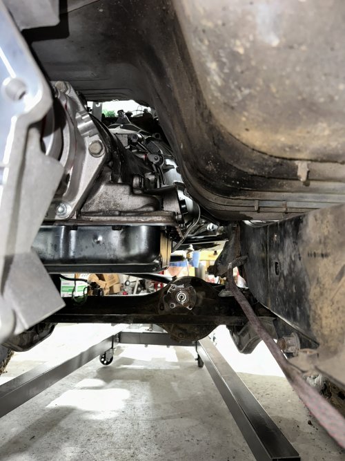

Attached the transmission cross-member. Beauty of the Advance Adapter and Selkirk Off Road mount combo is that it was supposed to take all the guesswork out of engine and transmission placement, retaining the original T-case location so no drive-line components need changing.
AND IT WORKS!
Tiny bit of forward slotting the two transmission isolator to cross member holes - like 3/16"
Vertical location of engine looks great for AC compressor. Slight bending of the PS low pressure return inlet hose and it clears the steering gearbox.
I figured the engine will go in and out a few times as I fit and attach stuff so its not fully bolted yet, but there is lots of room around the engine and transmission so maybe I get lucky, but for now the hoist stays attached.

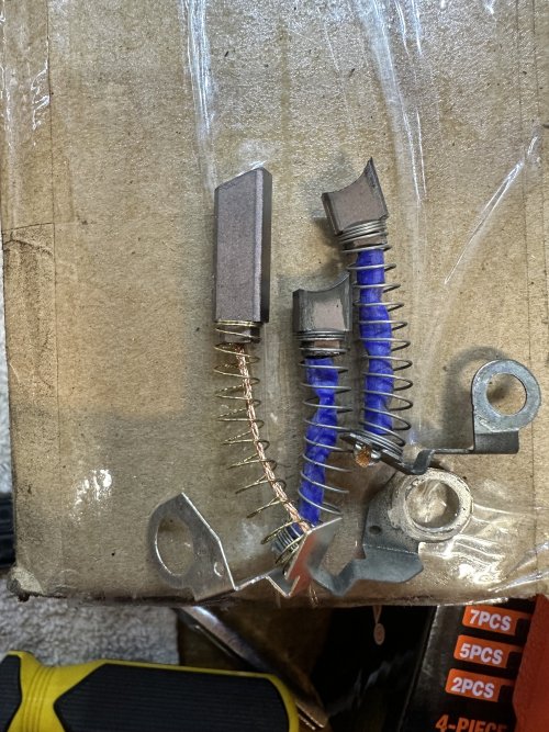

Had my GM alternator tested earlier this week at D&D Auto Electric in Wheat Ridge. Old school shop.
He showed me where it was engraved 145amp. That’s cool.
He got it to output 122 A at idle rpms.
I asked and he said “yes the brushes are replaceable”.
He charged me $10 for the testing and a set of brushes.
Seems I dodged a bullet! Kinda worn!

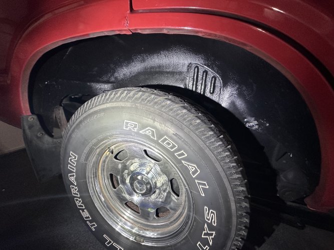

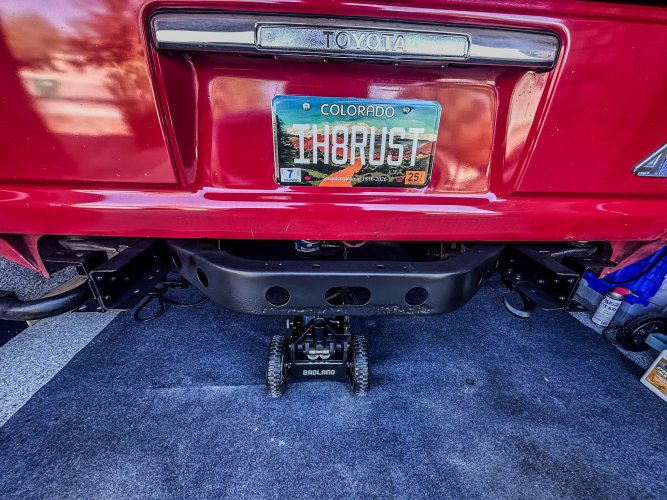

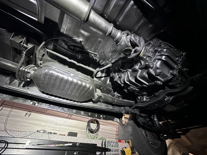

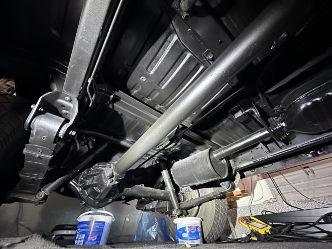

Eastwood says you only need a quart, but I've exhausted almost a whole gallon of Rust Encapsulator Plus. I got myself a cheapo air compressor and their HPLV contour spray gun and went nuts, and I mean nuts, exhaust pipe, and all, so I can suck in the fumes while I drive; that's a joke. I still have to hit it with the 2K spray.
Joke aside, my new motor will include a new header and exhaust pipe, and I will either sandblast or purchase a new catalytic converter, so the shotgun blast method was fine by me.
I still need many touch-ups, so I have arranged with Cruiser Co. to let me hit the hard-to-reach spots when they drop the old motor and transmission off. Johnny is awesome.
Side note: DO NOT buy the Rust Encapsulator Plus Aerospray; that stuff will not dispense the whole can; it's just a piss-poor design. Also, my garage is a mess; the floor has a paint outline of where I covered it and didn't. Also, also, my lungs.
