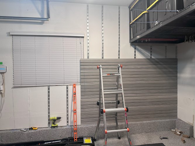

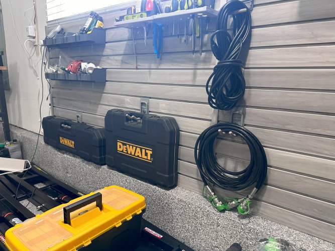

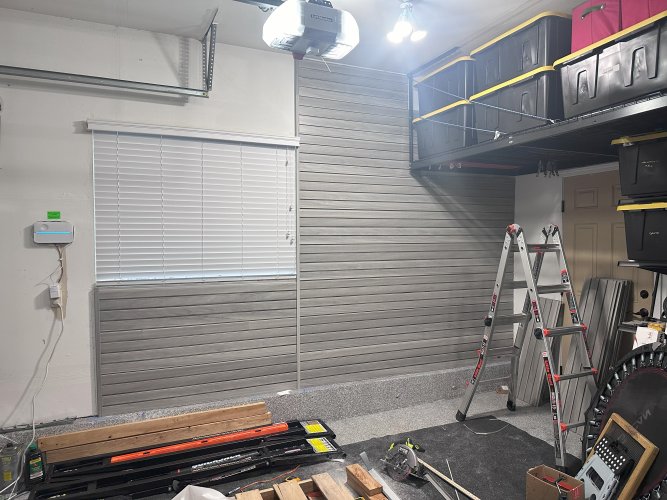

This weekend is indirectly related to the rig but with more focus on cleaning up the garage space in anticipation of the winter months to make it a little less miserable. Installed a Slatwall, organized Quick Jack (next to the wall) tools for the suspension install, and collected and sorted out the nuts and bolts.

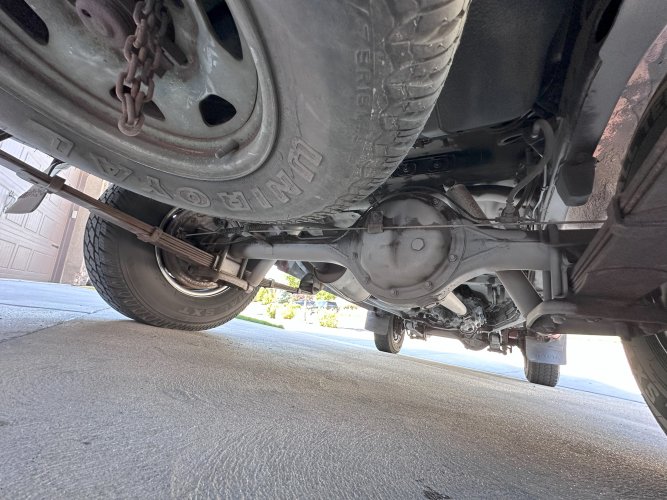

Today I pulled off my Taco's Asfir skid plates to make it easier for the local dealership to drop the engine next weekend. Supposedly that's necessary to change the timing cover gasket that's been slowly seeping a lil engine oil. I'm lucky the $4300 cost is covered by the soon to end warranty 😆 idk. We'll see how it goes. They're lending me a Tundra for the loaner. Will take before & after pics.
Two days ago I also had the alignment done. The shop struggled to read the instructions for doing the job for the suspension upgrades. They seemed to get it. But their service just felt poor, and they're the first to chew into the alignment tabs. The tabs are flimsy and likely best to beef up or maybe SAS. Pics are after the alignment job.

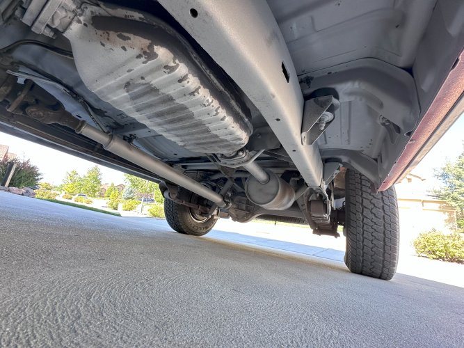

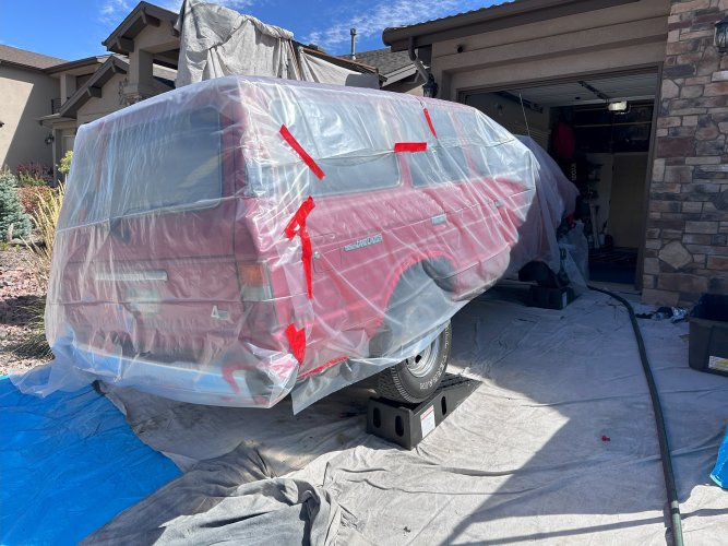

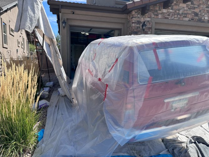

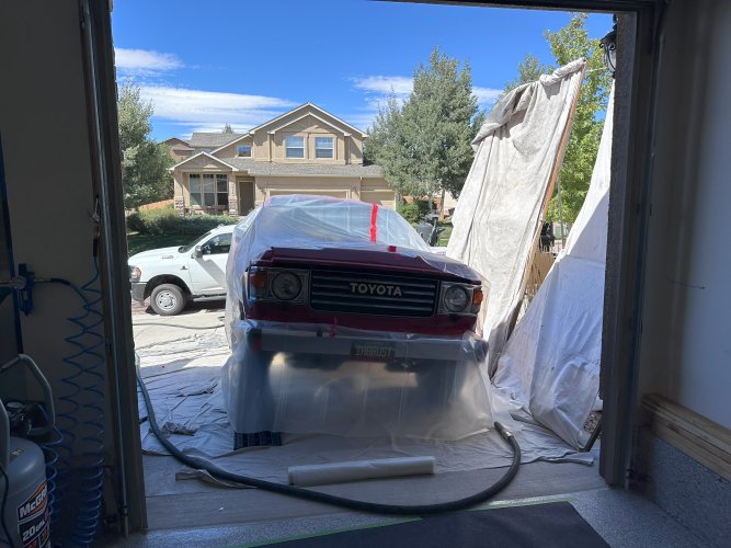

Head start to the weekend with a driveway sandblasting session. My neighbors love me right now, and IH8RUST.

Wow! Did you rent a big compressor and sand blaster??

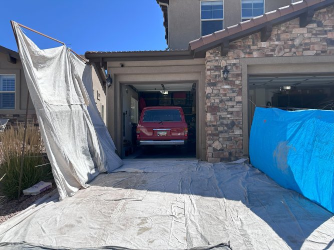

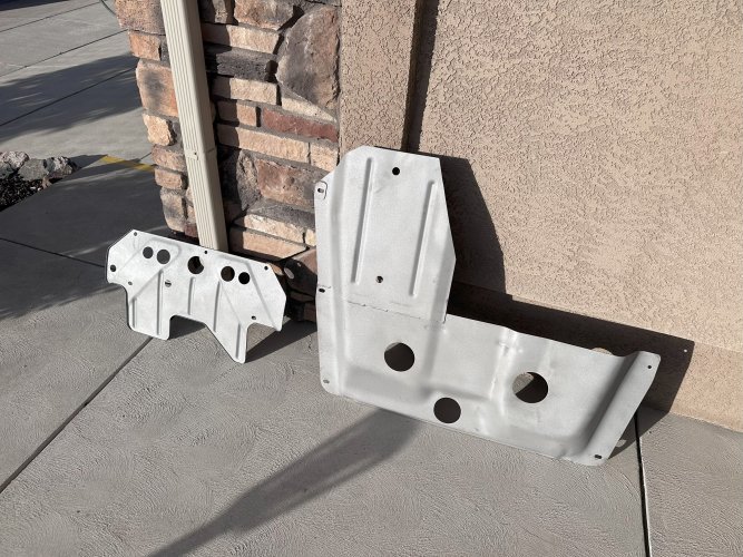

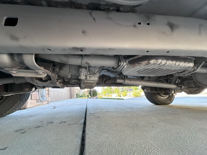

Oh no. I tried looking for a place, but I felt that was out of my depth. I found a mobile crew that does this. It's a father-son crew; I prepped as much as possible, and they showed up and blasted as much as they could, about 80% of it. I still have to get in the nooks and crannies to get the rest myself. I've attached a picture of the aftermath and skid plates. I'll post more of the frame after I get the dust out; there is a lot of it.
You know when you go to the beach and get sand in places you never thought of? I am here.

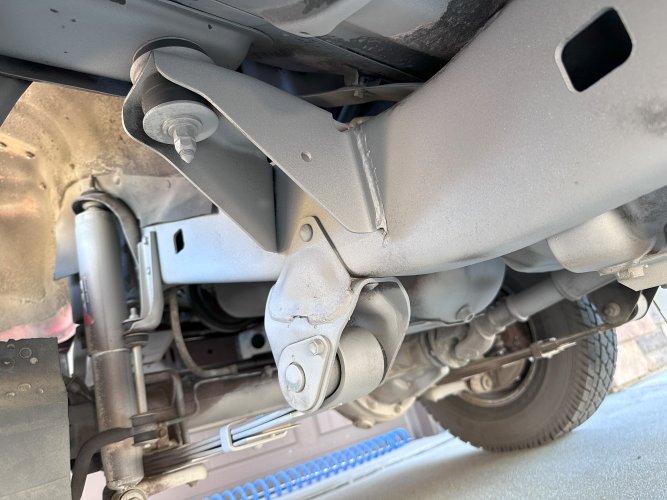

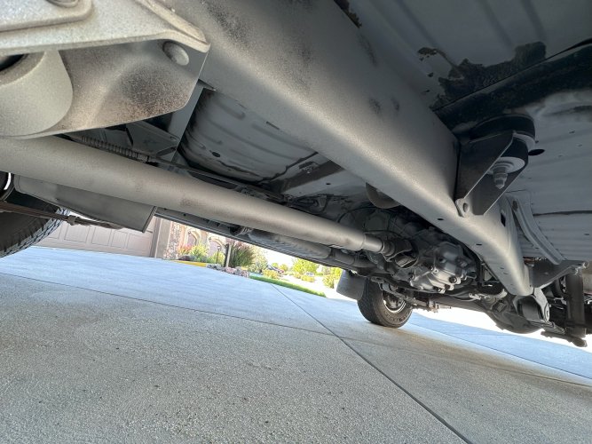

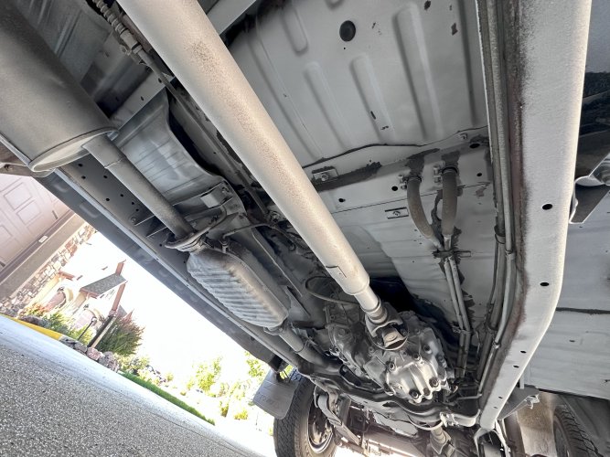

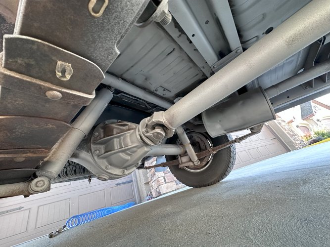

If I were a smart man, I'd have taken the bumpers off to hit that part of the frame before we started, but I'm not, and I didn't do that, so it'll have to be done the good old-fashioned way. Also, I did not have the spare tire rod to lower it, not that it matters. I have a brand new OEM tank sitting in the garage for the project's next phase.
80% descaled; the rest is up to me; wish me luck.

It goes in the garage now to keep it as dry as possible while I wait for my new motor/5-speed transmission to be built;
  • Goes up on the lift so that I can crawl under it comfortably;
  • I need to air out the remaining media from inside the frame, as well as other areas;
  • Going to place some dehumidifier to keep the moister (the essence of water) to a low;
  • Take the bumpers off, descale and remove the rust from that part of the frame, and wire brush the hard-to-get areas;
  • Wire brush and surface tool on everything;
  • Finally, POR-15 (what else? :) degreaser, metal prep, and coating to finish it.
I'm open to suggestions, tho. POR-15 seems the default, I also thought ENVIROLASTIC® 940 DTM, but POR seems the safer choice.
