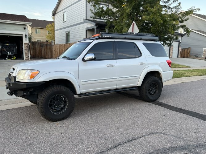

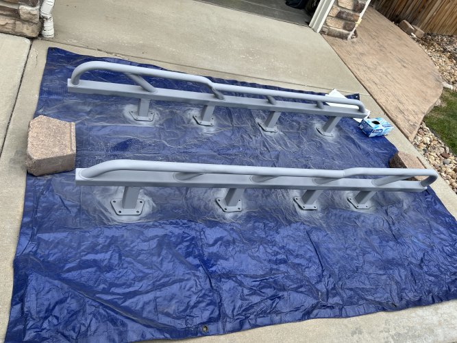

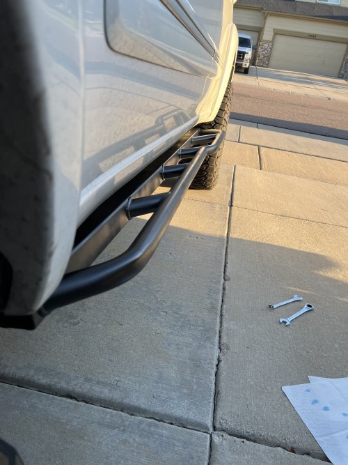

I just installed my sliders from Brute Force Fab onto the Sequoia. I would like to thank Axel Fabrication for welding on my brackets, if anyone is looking for a great welder, fabricator Lars is awesome to deal with. I ended up painting these sliders as they are bolt on, I had a few issues with my powder coated sliders on my 100 so trying something different. I cleaned them up with soap and water, rubbing alcohol, 2 coats of Rustoleum automotive primer and then painted them with Rustoleum semi gloss protective enamel.

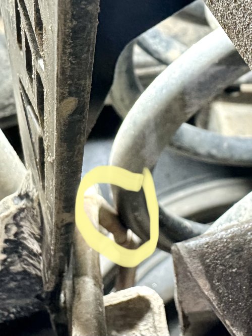

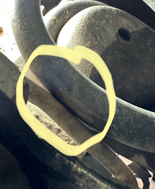

Tracked down and resolved a squeak! If you ever have, you know what a relief that is!

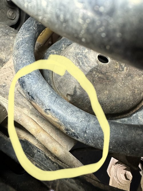

This one was hiding between the left rear coil and the Delta panhard bracket. Finally it got loud enough that we could bounce the 80 and make it squeak. It was the metal protective cover housing the ABS wire. Fortunately harmless and easily bent for clearance.
Also tightened windshield wiper arm nuts and installed a new dash cam. Turns out it is very easy to tuck a USB cable under the interior windshield gasket
Pretty sure I have a very similar squeak with my rear upper spring perch.

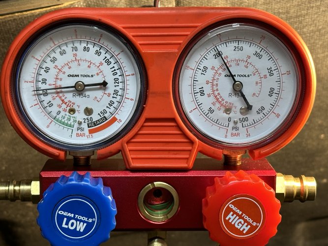

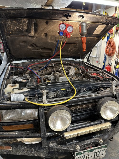

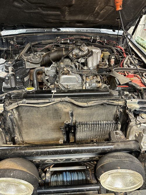

Just in time for cool weather - new AC compressor and evaporator. Belt was slipping, and compressor was squealing a bit. I think a bearing was getting ready to go.
FREE Leftovers:
  • If anybody is interested in a used but probably perfectly fine condenser and used but questionable clutch / compressor. They are free for the taking.
  • I accidentally ended up with a extra receiver dryer which I don’t need and it’s not worth the trouble to return. Also free.
  • Finally if you are planning on doing this job, I have plenty of extra O-rings, nylon sealant, and PAG 46 oil free for you.

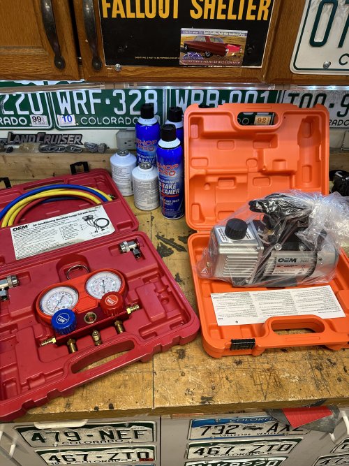

I used the free loaner gauges and vacuum pump from AutoZone. The gauges were missing the R134a can tap but I was able to get one of those on Amazon overnight for 10 bucks.
This is the second time I got into my air-conditioning system and the first time I did the vac and charge myself. It’s not difficult to work with.
