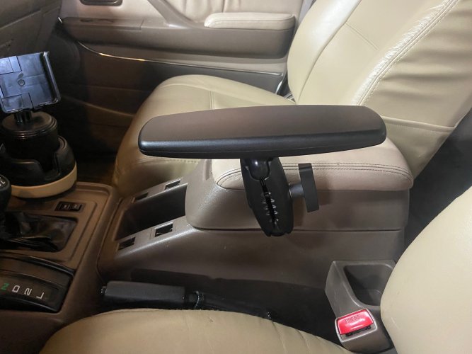

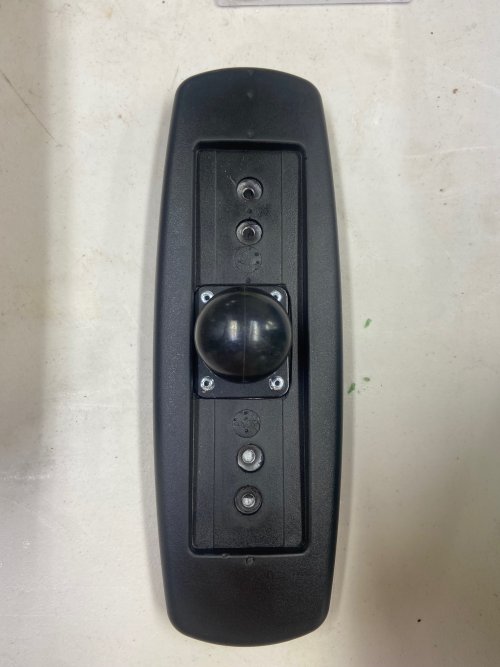

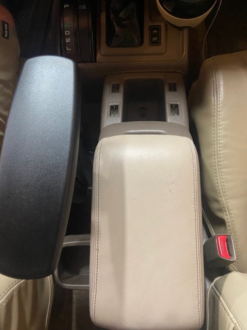

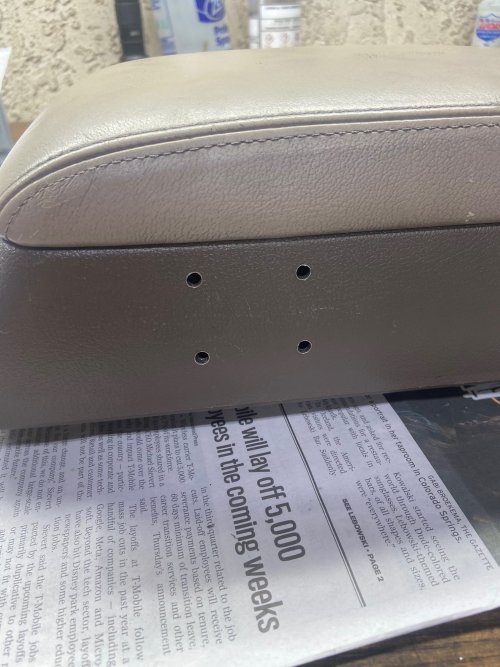

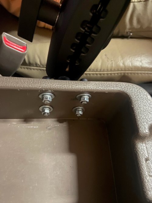

Searched around the web until I found the parts to make this arm rest for my 97 FZJ80. The ball and sock allow for infinite adjustability. I'm so used to resting my arm while driving that I couldn't stand not having one.

Who makes the armrest?
I bought the 8.5" aluminum pedestal from tackform.com and the office chair arm rest from Amazon. Connected the two with 1/8" rivets. The pedestal was sorta spendy but still not bad total price of about $75 bucks.
