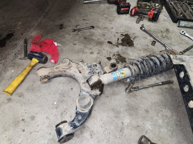

Last weekend started the project to replace my 23 year old LCA bushings. Found a leaky shock, ordered new shocks, found leaky oil seals on my cv shafts, picked up new seals today (there goes the birthday cash). Got the cams out with relative ease! Could get the front bushing out of the passenger with the hot stick and a 20 ton jack. Front one refused to exit the venue. Just pulled the drivers side off. Broke the shock bolt. The broken bolt won't come out. About to take the oxy/ acetylene tool to it. Going to smoke the bushing. Shocks are "supposed to arrive" Thursday. Made an appointment for an alignment for Friday a month ago. Fingers crossed the shocks get here Thursday and I can toss the last one on and drop off the next morning at the shop! I am digging out tools I forgot I had to get this done! Going to make an attempt to remove any finicky bushings at the Jordan residence tomorrow. If that doesn't work with the proper press set up, it's going to meet the grinder, torch, Sawzall, chisel, and hammer.

Nothing ever goes as planned.
14,133
Save yourself some grief / time.Get a carbide tipped blade for your sawsall and cut that shock bolt off in between the mounting ear and the shock.
If it's been a long time since it was touched then that's sometimes the best plan on this one and the long one in the upper. Then lots of anti-seize on the new ones.

My brother is gathering tools and his Sawzall and heading down this way. I am about to throw the kitchen sink at it, get online and a buy new lca! But I am too cheap for that, it's coming out one way or another!

Keep in mind when ordering parts that if that bolt is rusted in place that the sleeve in the bushing of the shock will have become one with the bolt. So it could be two cuts to get it free and the bushing sleeve will be ruined, too. But you're replacing the shock so that shouldn't be a problem.
