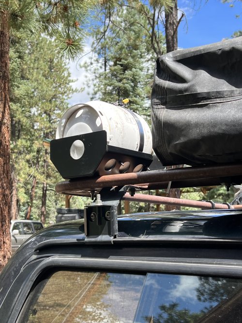

Last piece for a min on the 4Runner. The Star Wars duct tape did its job nobly for like 5 years or something. 😁
Is that OEM? Should have updated it to the 99+ intake so you can replace the MAF with a denso part that is still available. If you want a spare older style MAF you are welcome to buy mine.
4,207
It is and it’s fine. All is well with this little machine.

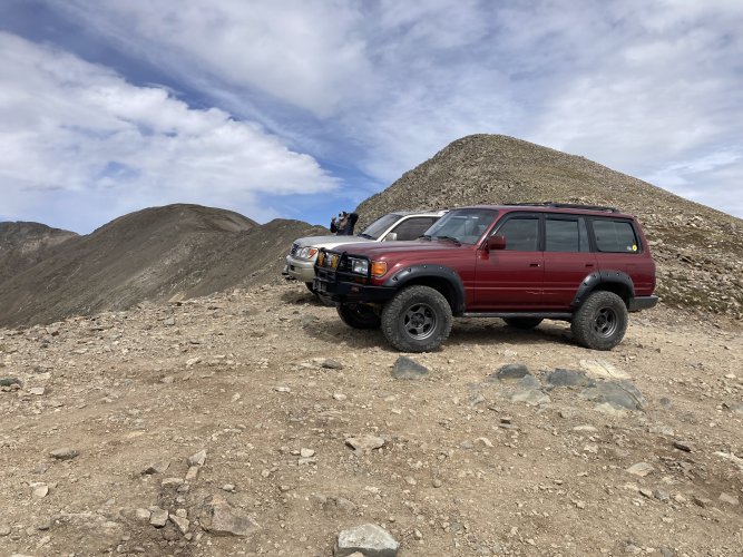

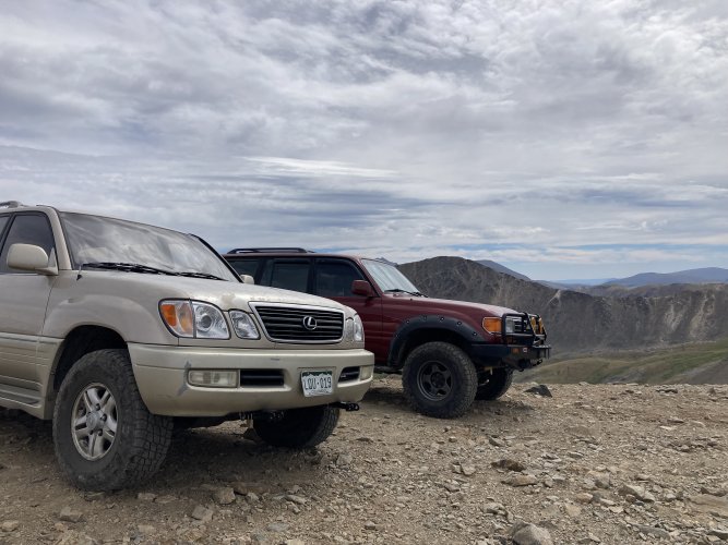

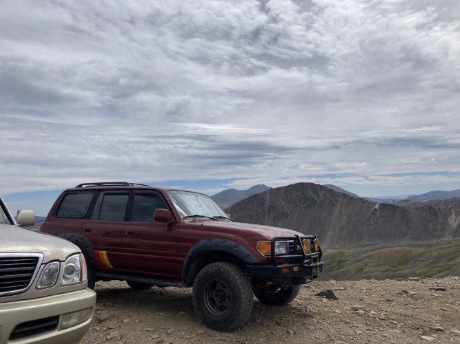

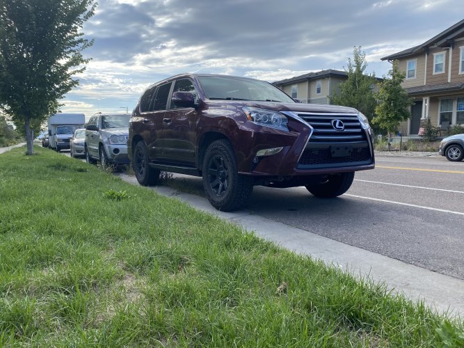

Just running mosquito pass w/ a few people. Nothing hard. Eating tacos in Leadville, then headed home.
Nice, too far to drive in my pickup looking for something close here on the front range. Depending on how I am feeling.

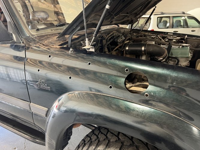

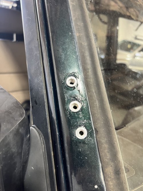

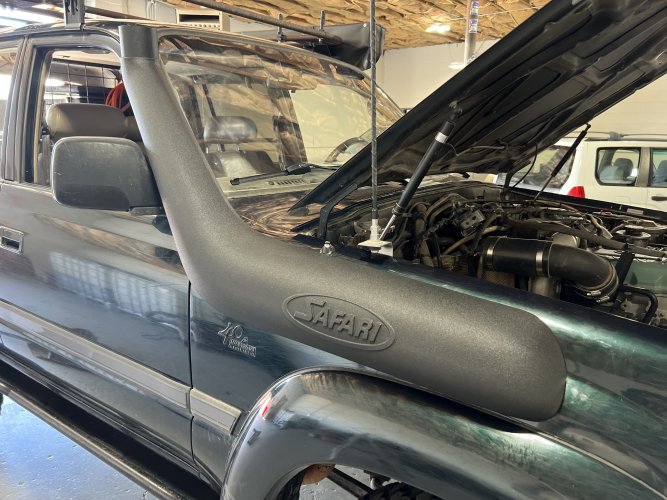

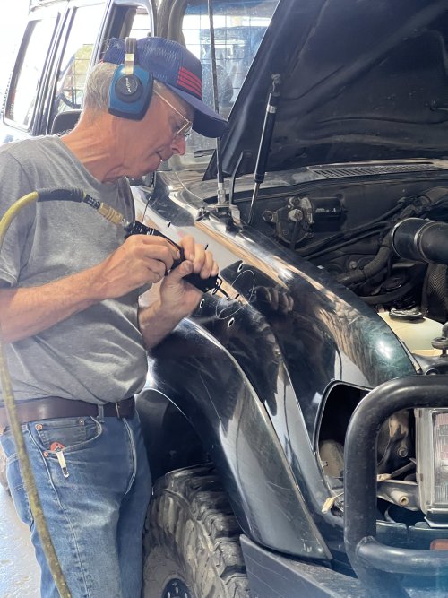

Dorkle install at the Cruiser Day Spa (Bill’s Toy Shop)
My turbo has heat soaked the air box so bad that the air filter element is melted and fused to the bottom. Removal of that will be this weekends project.
Intake air temps of the OBD2 monitor showed a drop in temps on the way home. And some seat of the pants power gain due to increased air density.

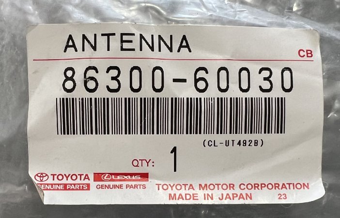

Also installed an OEM manual am/fm antenna to replace my broken power unit.

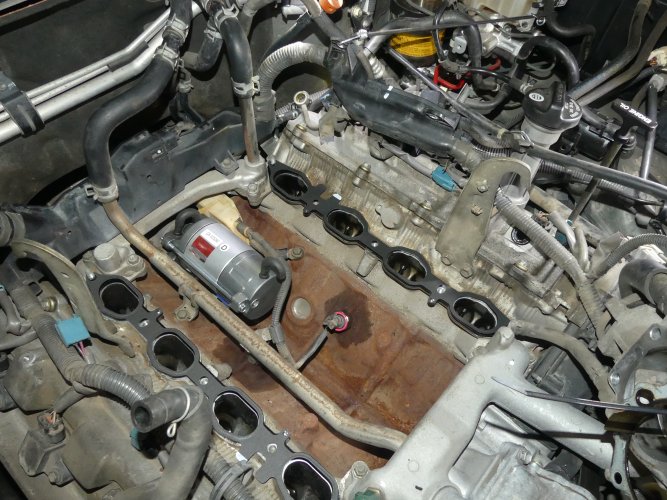

'99 LX 470 - installed 2 OEM knock sensors (got a code on #1) and a new starter and intake gaskets. Many trips in and out of the engine compartment! Found an mouse nest under the manifold, but no rodent damage. So far, no codes have shown up.
