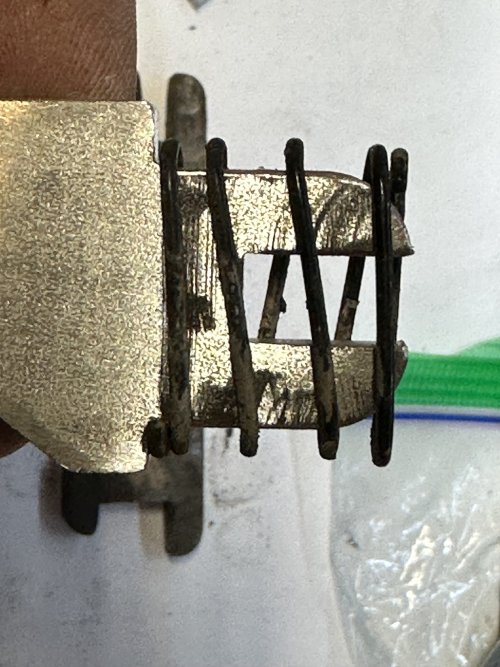

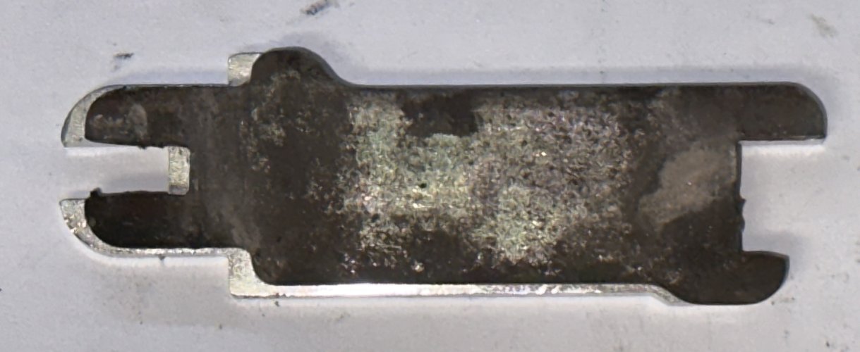

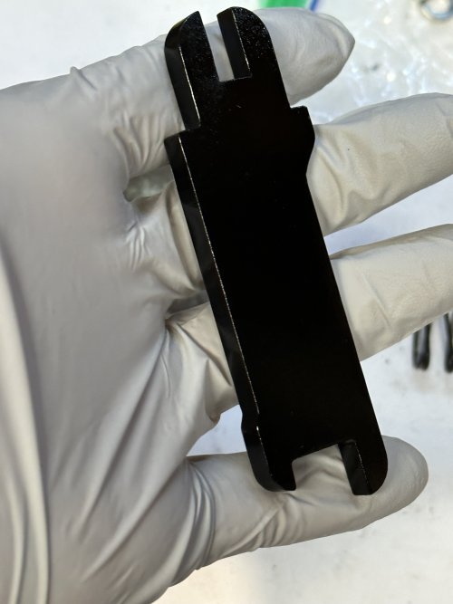

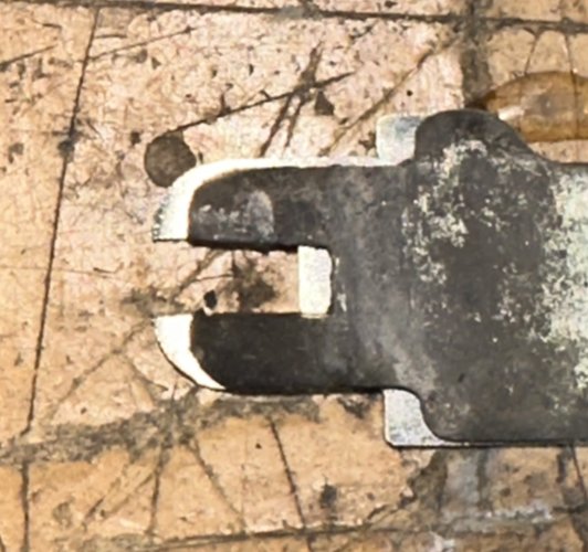

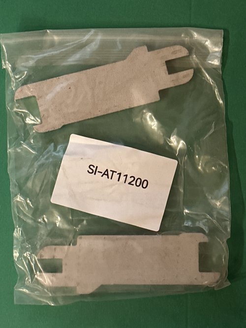

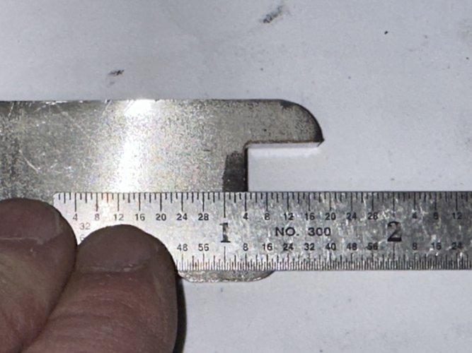

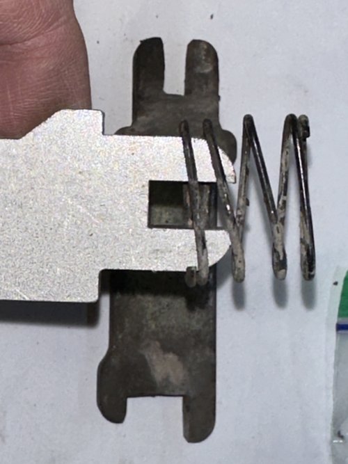

Installed extended handbrake dog bones. At $18 on Amazon, worth a try.
80 parking brake never stays adjusted.
These 1/8" longer dogbone gets the top closer to the drum. I smoothed all the edges of the new part and then the old spring slid right over. Then I cleaned and painted.
Right away I noticed 1) it takes only three adjuster detents to go from tight to free-spin, 2) the cable nuts at the handle needed to take up very little slack to get to 6-7 clicks was tight, and 3) handle feels firmer. Only time will tell.

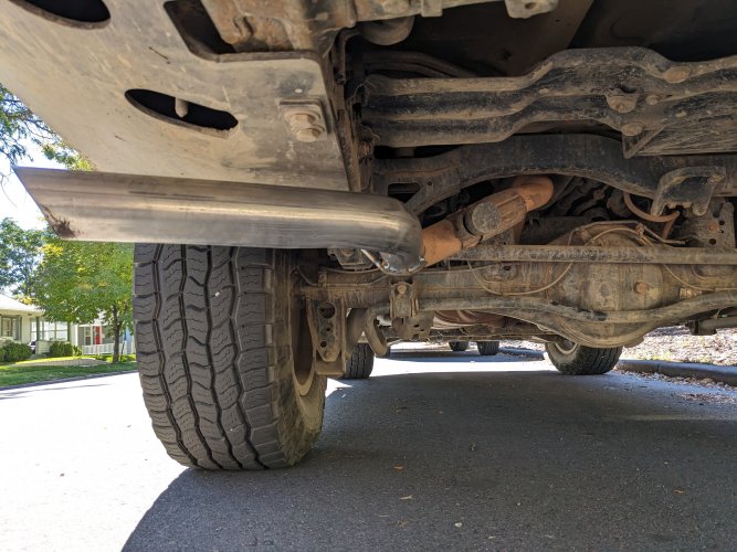

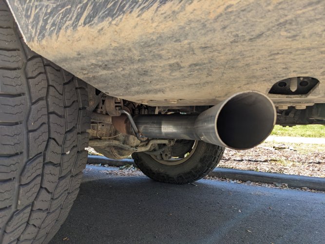

Finally got the resonator delete done on the LX570. Looks and sounds much better, heck it even has a little more power. I kinda crushed the tip in Moab... :rolleyes:
I'll post a pic soon, but House of Mufflers and Brakes (Evans and I-25) did a great job, $140 out the door, took a couple of hours with no appointment.PXL_20231009_175725071.jpgPXL_20231009_175735340.jpg

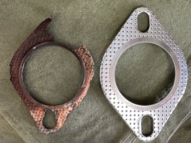

I just now replaced an exhaust gasket. I think it was ready for replacement. This was a rare job that went smoothly. I even had big 10.9 bolts on hand to replace the ones that came out. Every penny, I spent on the half inch Milwaukee impact was worth it for this one job. If you don’t have a half inch Milwaukee impact start looking for deals and plan to buy one over the holidays. Lots of times there’s great sales. I got mine for 50% off last year.

Got some custom exhaust work done after years of pinching my exhaust tip. (Heh heh... Exhaust tip.)
